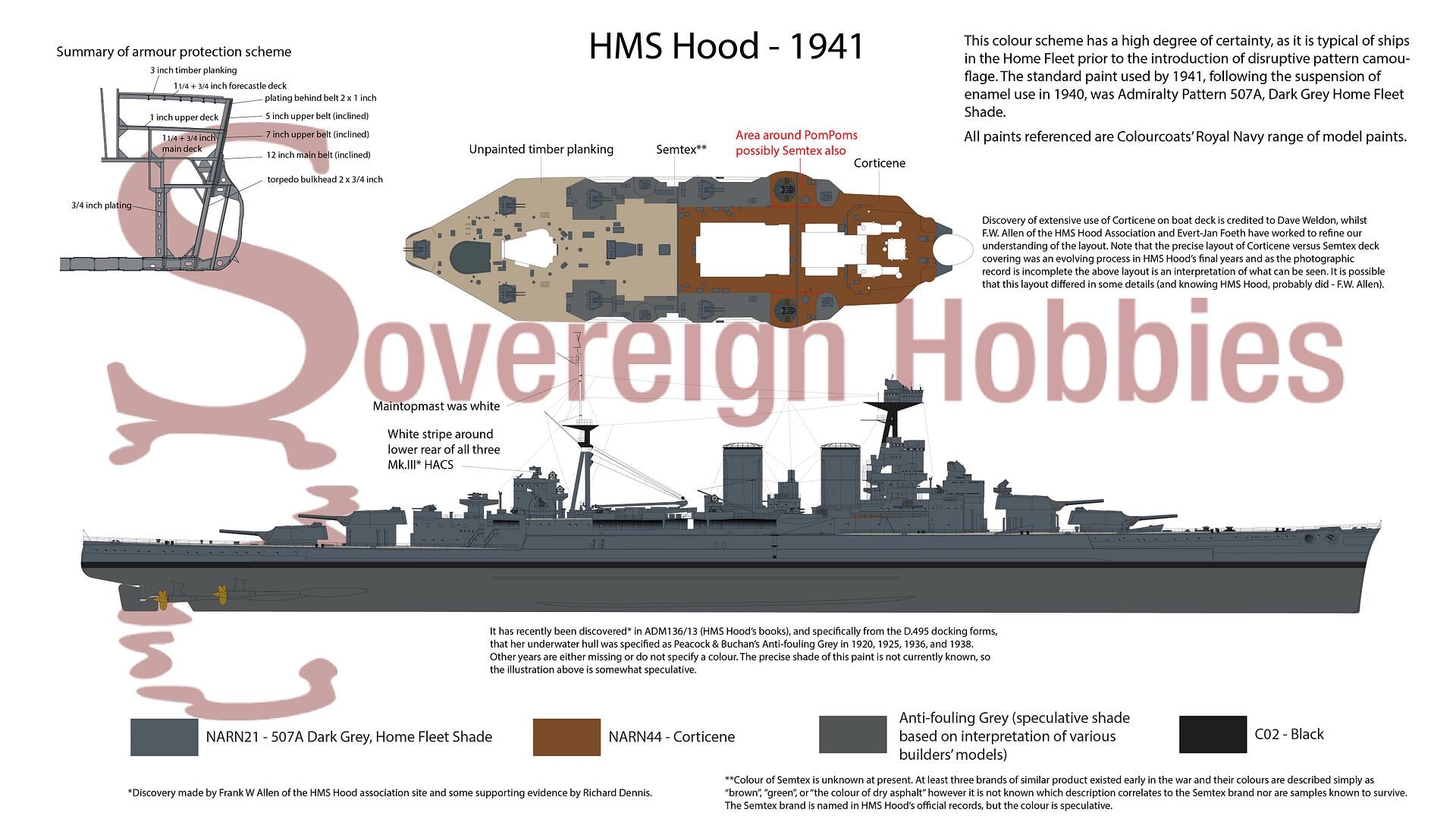

Jamie @ Sovereign Hobbies Posted April 25 Posted April 25 On 4/23/2025 at 9:51 PM, ArtickWarspite said: So @Jamie @ Sovereign Hobbies while we're on the subject, this ship is going to require some paint - presumably you know what the correct shades are and where they can be purchased? I do know the first part For anti-fouling, I'd use US04 - 5-D Dark Gray. @beefy66 would need to advise on whether or not any progress has been made with finding a new importer in the Asia Pacific region. 4

ArtickWarspite Posted May 4 Posted May 4 On 4/25/2025 at 11:38 PM, beefy66 said: As yet no but I have a couple of contacts I will be getting in touch with over the next couple of weeks thing might move forward then. Keith Thanks, there's no immediate rush on this as my wallet is still some time away from giving the green light. I used to get them from Creative Hobbies in Australia, though that was about 4 years ago. Presumably that has now changed? I have a few pots of NARN20 which would do the trick left over from the Nelson. Is there a significant difference between the NARN20 and NARN21? They both appear to be home fleet greys from the same era? If I may suggest a contact down in New Zealand - you could try Toymod Ltd as that is where I used to work and they a few years ago and they used to carry the Testors Model Master range. Don't know if they would be interested, but you could give them a go. www.toymod.com Thanks again! 1
beefy66 Posted May 4 Posted May 4 8 hours ago, ArtickWarspite said: Is there a significant difference between the NARN20 and NARN21? They both appear to be home fleet greys from the same era? Well to me a 58 year old grey haired bloke not that much difference but the spectrophotometer tells me NARN 21 Is the darker colour of the two. Learning a lot about 500 shades of grey not just 50. Thanks for the link will have to try an get in touch them. Stay Safe Keith 2
Jamie @ Sovereign Hobbies Posted May 5 Posted May 5 Hi, no there isn't a big difference. 20 is a slightly faded version of 21. 20 represents Home Fleet Grey at the lightest of its recorded Reflectivity Factors of 13%. 21 is the strongest and darkest at the darkest or nominal recorded Reflectivity Factor of 10%. If I didn't have either and needed to go get some then personally I'd choose 21 as I prefer the stronger bluishness that comes through, but 20 is fine. 3
