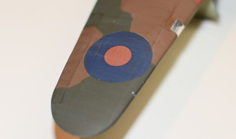

Caerbannog Posted August 22, 2016 Share Posted August 22, 2016 I recently tried True Earth products (Light ageing I seem to recal) on a Hurricane with good results. I will take pictures and post them here if you like. You can brush it to get a streaked effect or air brush it if you want to have a more uniform ageing. René 1 Link to comment Share on other sites More sharing options...
RMP2 Posted August 22, 2016 Author Share Posted August 22, 2016 I recently tried True Earth products (Light ageing I seem to recal) on a Hurricane with good results. I will take pictures and post them here if you like. You can brush it to get a streaked effect or air brush it if you want to have a more uniform ageing. René If you have photos to hand, that would be great to see. Link to comment Share on other sites More sharing options...
Caerbannog Posted August 23, 2016 Share Posted August 23, 2016 If you have photos to hand, that would be great to see. I took some pictures this morning and posted them here: http://www.britmodeller.com/forums/index.php?/topic/234985124-1-48-airfix-hurricane-old-tool-gn-a-james-brindley-nicolson/ Thought this would be the better place as they became more than one picture. But here is one close up of an upper roundel with True eath filter brushed over: I opted for a fainter effect, but you can create a very worn effect by using more filter on the brush and by adding more than just one layer. René 1 Link to comment Share on other sites More sharing options...
