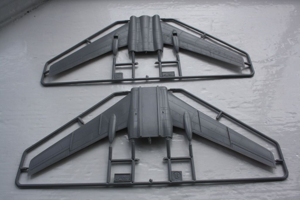

Wing sprue

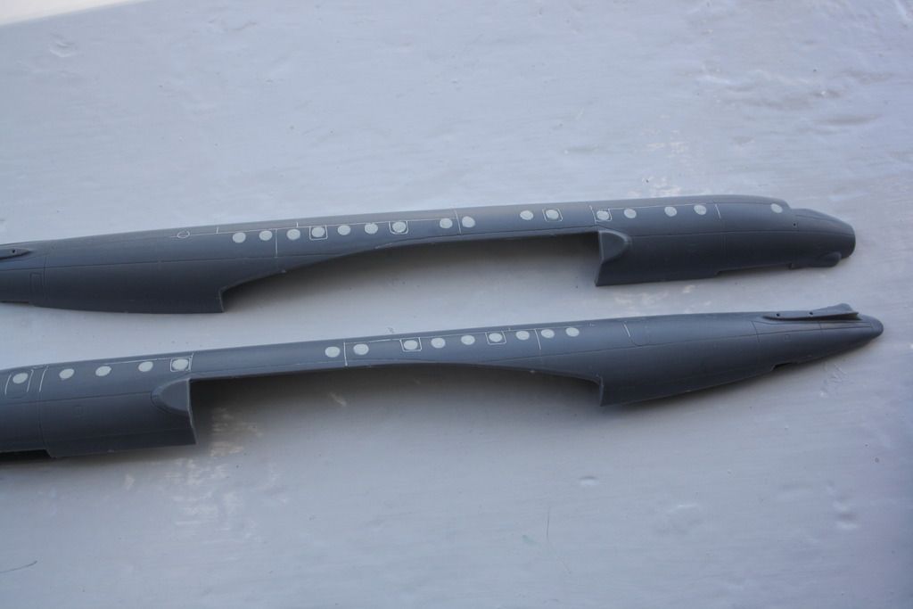

Fuselage and kit decals

Suprisingly big airliner I thought even in 144 scale, although the box could have been half the size! The recessed panel lines might be a bit heavy and some are a bit wonky as eveidenced by the close up pic! Decided not to use the kit decals as I dont think they have a good reputation. so BOA decals purchased. I have done no research on the kit itself, I just like the airliner with its glass nose, but I can see straight away that I will have to fill in the windows and some of the scribed window postions, as these will be dealt with by the decals.

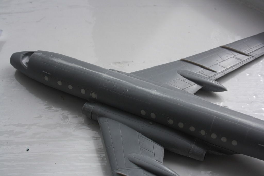

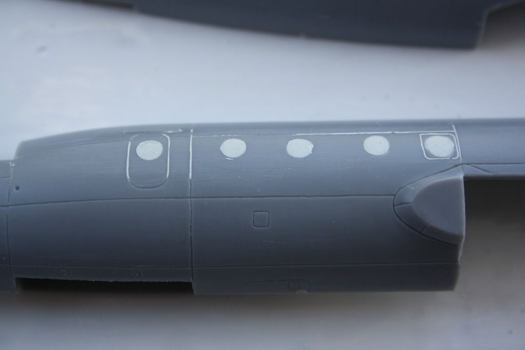

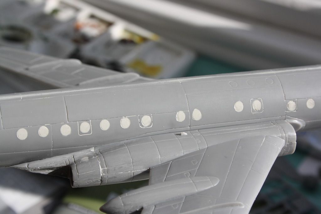

Started at last! First job is to fill the windows along the fuselage to suit the decals i have - I used Apoxie Sculpt last time so here goes again. Its a two part so need to be mixed - two 'suasgaes' of each then twisted together to make a completely mixed strip. This I pressed into the fuselage behind the windows to fill the hole, then pressed back and then cut off with a scalpel. Takes a few hours to harden
This is the result after sanding back
Have pics of the sequence if needed!
Some minor surface filling to complete the job and the same for the scribed window locations.

I really need to try this method of filling windows, looks like it work well.
Yeh, I agree, it looks very neat. Much better than my last attempt of pouring casting resin into an A320's windows - it only filled about 10% of them...!!
Keith
Link to comment
Ray it does work well and is quite easy
Keith[/quote
Keith yes its very neat and if I had taken more care would require zero subsequent filling. As I say Apoxie Sculpt is the name of the stuff but i guess other fillers would work in a similar fashion.

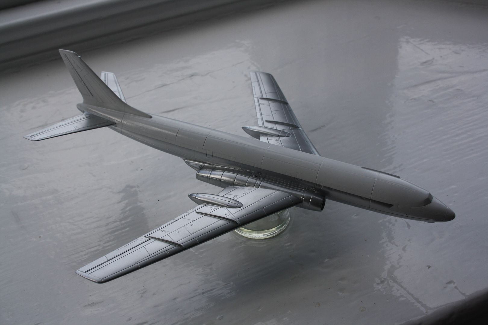

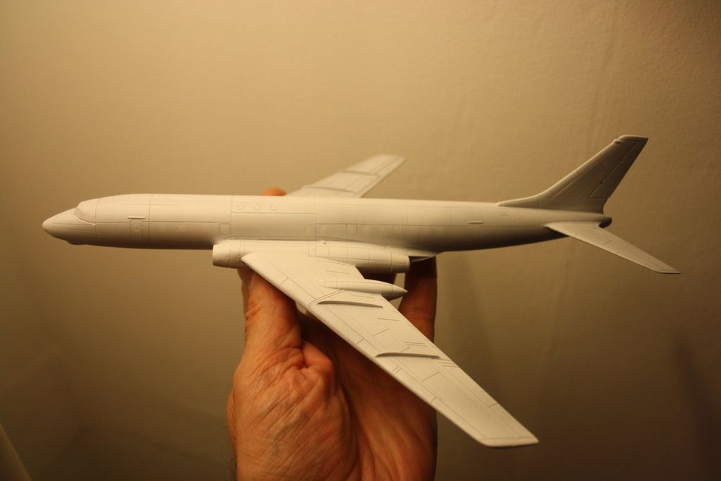

Brief update - fuselage joined and wings on with the help of a bit of filler as usual.
Fuselage joined, nose weights in - an air;liner essential and wings dry fitted
Wings attached to fuselage - the sun/camera picks out every blemish!

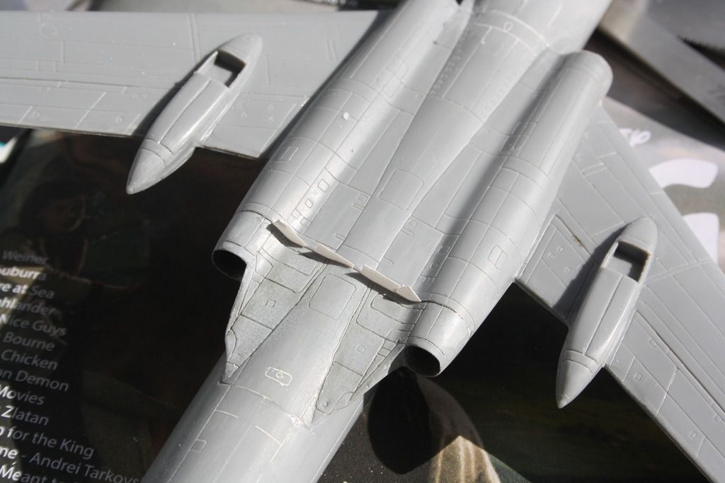

Underside showing very thin plasticard shims to fill a gap and make sure the glue held this time! Now trimmed off and filled/sanded.
The fit is OK, but many dry fits required and gentle sanding of the different components to get everything to sit correctly. The Apoxie Sculpt for filling the windows fouled up the fuselage/wing joint so had to be trimmed back - my usual way of working! ie the next one will be better!
Next stage is go over the kit for any further filling, re-scribing and final sand with fine grade paper before priming. Happy with my 2 week progress.

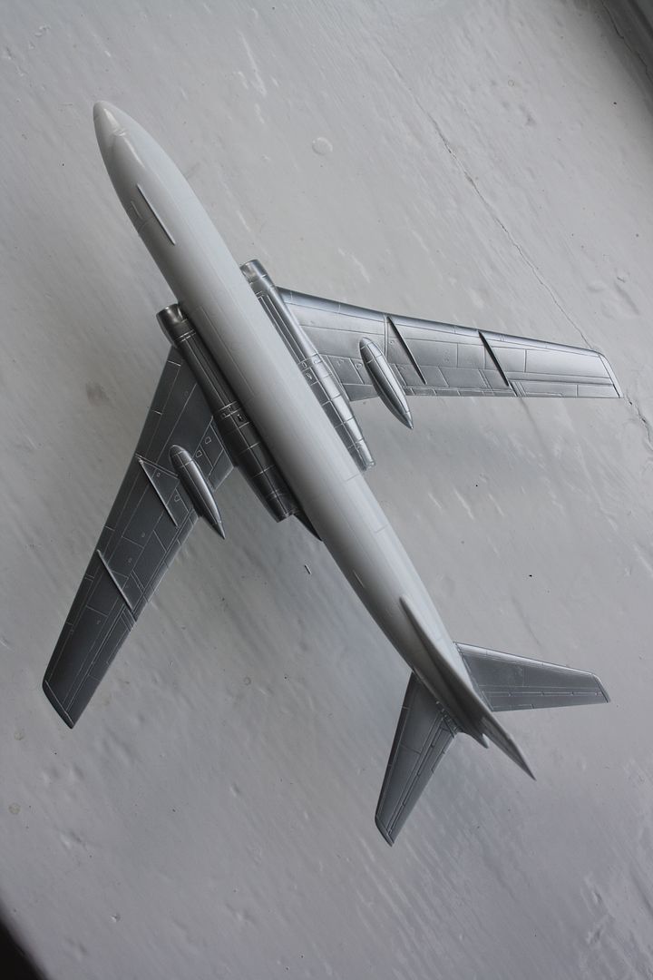

Quick Update - first coat of primer on after the usual filling and cleaning scribed panel lines. Engine intakes and exhaust require a bit more work, but quite happy with this so far.
Apologies for indoor lighting!

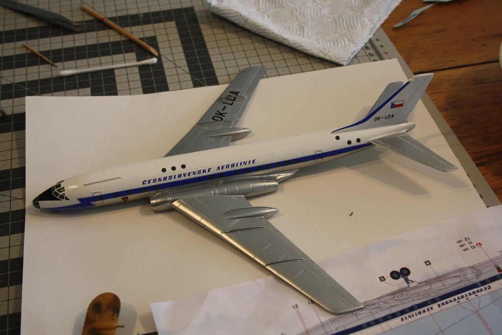

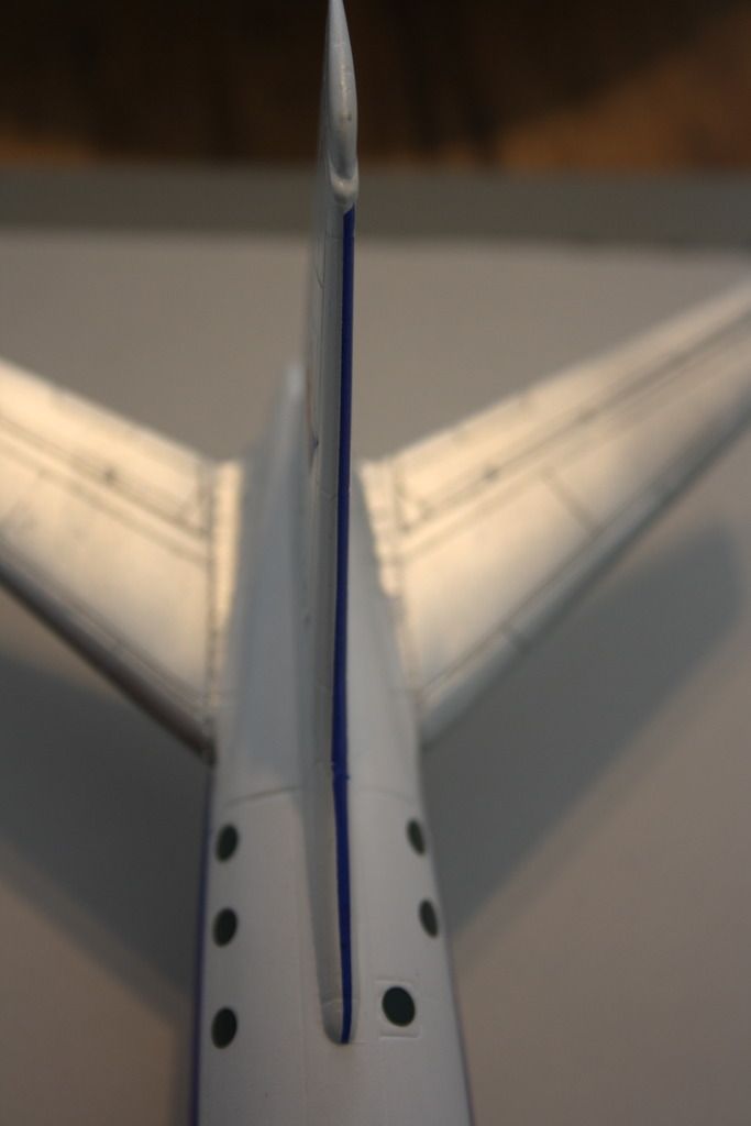

Decalling stage - quick couple of shots
CSA colours - although I cant find any pics of this colour??
Tail half decalled
Waiting for the decal to fully dry before applying the other half
Hopefully finished this week!
Then I'm thinking of another russian airlier - 4 weeks to build it??
  • Like 10
