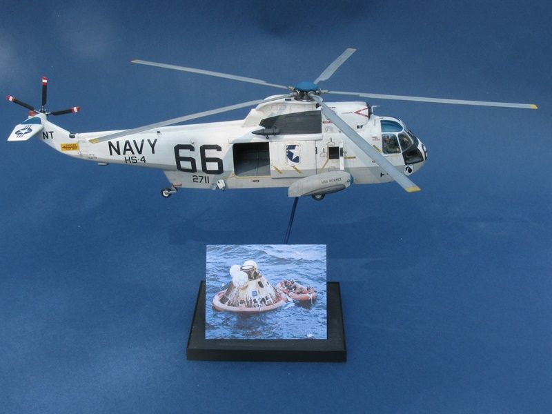

AdrianMF Posted July 15, 2016 Posted July 15, 2016 (edited) Hello All, I built the Airfix old mould (1969) Sea King for the Helicopter III GB. It's on a stand measuring 3" by 3 1/2" and there's a picture of the Apollo 11 Command Module on the stand to give it some context: The mission here is to build a vignette of the scene shown in the photo, with the helicopter hovering above. The stand is a 1/4" thick balsa block with plastic card around the sides. So I need a command module, floatation bags and figures, and some ocean! For the command module I have seen some very expensive kits on Ebay, which include the LCM and/or Service Module, which I don't need. So for the capsule itself I thought I might get away with building a plastic card model based on a paper model pattern available freely on the web: It's for a 1/48 model, so I printed it out at 66.7% to get 1/72. Placed on the stand, it looked a bit too big, so I tried making a half-scale copy of the original 1/48 size one to give me 1/96 scale: This looks a lot more manageable and gives a bit of "forced perspective" to the scene. It's also about the same size as the one in the photo, so that works well. For the floats and dinghy I will be using two-part putty I have a choice of two-part advanced wood filler (too fast, no good for modelling), milliput (could do) or a strip of two-part filler in blue and green halves that you knead together until it is a uniform colour. The last one doesn't go entirely rigid and is hard to sand, but I think it would be the easiest to use. I will probably make my own figures for 1/96 scale, and I'd like to put one or two in the helicopter doorway too. Thanks for looking, Adrian Edited October 23, 2016 by AdrianMF 13

Mjwomack Posted July 15, 2016 Posted July 15, 2016 Oh my days! , It's the casual, 'I'll make my own figures in 1/96' that has finished me off. Can't see this being anything but brilliant and love the idea using forced perspective- something I'd like to get an angle on one day 5
Miggers Posted July 15, 2016 Posted July 15, 2016 Hi Adrian and welcome to the Vignette GB. What a great idea for a vignette! I remember watching the Appolo 11 mission with great interest. Kind regards, Stix You and me both 'Stix. I can clearly remember my Dad getting me up at,what, 4 in the morning was it?,to watch Neil Armstrong and Buzz Aldrin make their decents down those famous steps and Neil utter that historic line. All heady and exciting stuff for a nine year old. My Dad was brilliant like that,he'd always make sure I saw any kind of historic occaision of that type. Damn good idea for a vignette Ade,old 66 has certainly scrubbed up well. 3
AdrianMF Posted July 15, 2016 Author Posted July 15, 2016 (edited) Thanks chaps. ... It's the casual, 'I'll make my own figures in 1/96' that has finished me off. ... It's not quite as bad as you might think. Because of precautions against "moon germs" the divers and crew all wore sealed overalls with hoods and face masks and spent a number of days in an isolation unit on USS Hornet. So the figures will be comparatively simple - and if it gets too hard I will just have the divers bobbing in the water!! You and me both 'Stix.I can clearly remember my Dad getting me up at,what, 4 in the morning was it?,to watch Neil Armstrong and Buzz Aldrinmake their decents down those famous steps and Neil utter that historic line.All heady and exciting stuff for a nine year old.... I fell asleep on the sofa somewhere around 2 am . There were a lot of tired kids in assembly the next morning!Regards,Adrian Edited July 15, 2016 by AdrianMF 2
