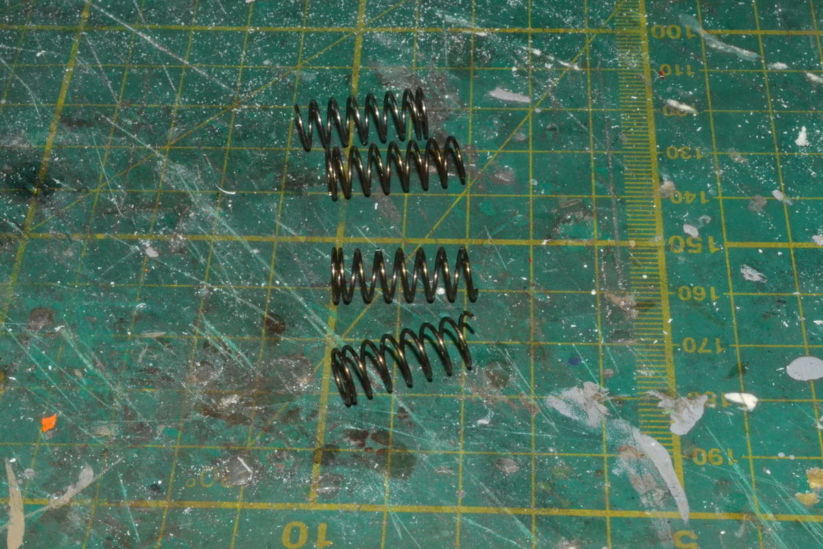

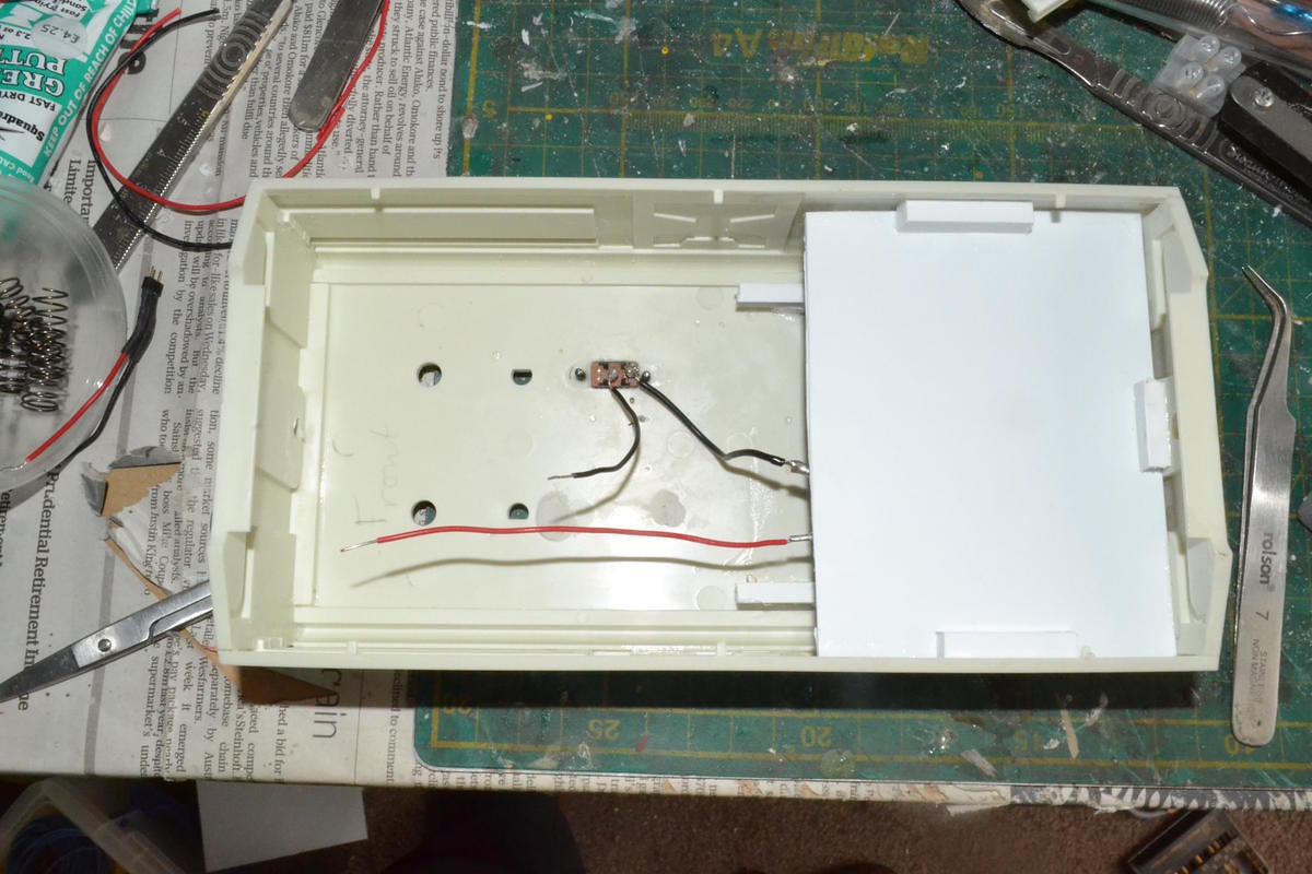

Kallisti Posted July 18, 2016 Author Posted July 18, 2016 Progress has stagnated a bit recently with other things getting in the way, however I have managed to make one small but important modification... the springs that support the legs! The original springs that come with the kit are a bit to long.strong to the effect that the completed model sits about 1cm higher than it should. In my earlier build I left them as they are but I promised myself on this build I'd fix that problem. Bakc in February when I built the first I attempted to cut the spring but even with tin snips, I couldn't cut the wire. I didn't waste too much time on it back then, but since then I'd been advised to use a file to cut away part of the wire to make it easier, so this i did using one of my needle files with a sharp edge to cut a V-shaped slot in the spring wire and lo and behold it became trivial to snap a piece of the spring off, so now I have springs shortened by two loops of the wire Sadly I forgot to take a "before" shot, but here is a photo from my earlier build that shows the full spring As for further progress, the spine has been assembled and the upper panels of the passenger pod with windows in have been added to the PP. I'm hoping to get more progress this coming week... 4

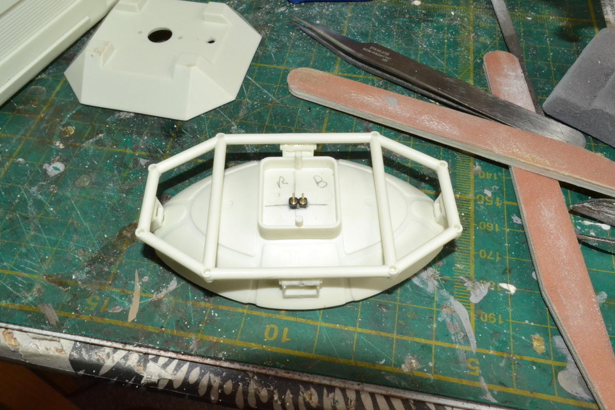

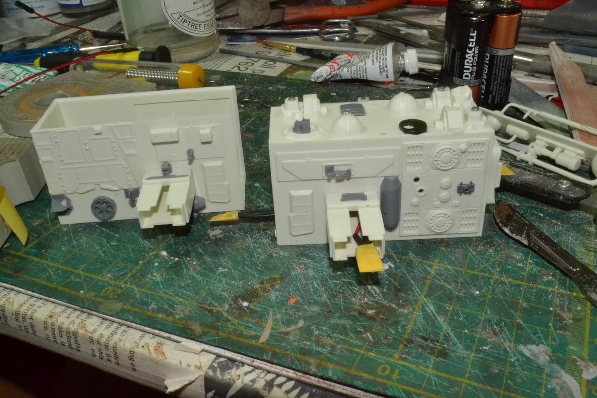

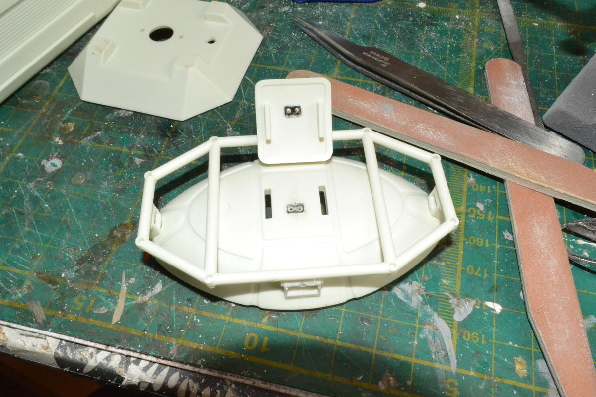

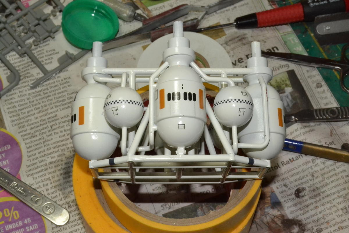

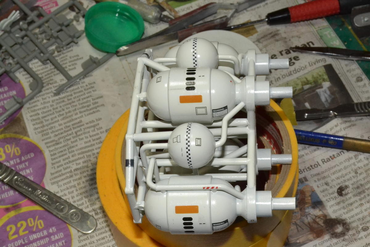

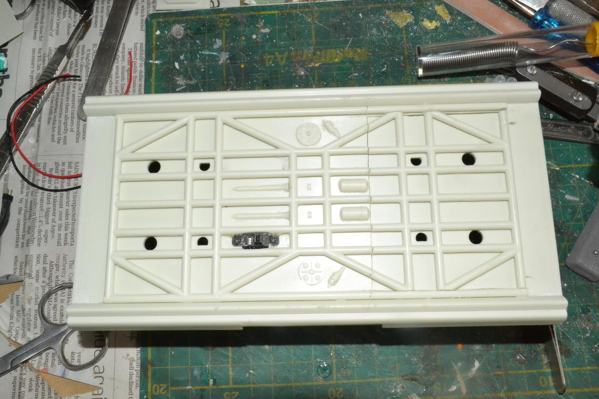

Kallisti Posted August 13, 2016 Author Posted August 13, 2016 Well this build is taking its time... to be honest I'm struggling with motivation at the moment Anyway, things have slowly been coming otgether. I decided to add some extra details to the front and read walkways This is the rear one, fully assembled and wired up ready for the lights. You can see the additions I've made. The rear engine assembly as gone together without too much trouble - this is probably the single most complex part of the assembly. Finally in this update, the four shelves that fit on the walkways. These were taken over a week ago - since then a lot of painting has taken place and things are progressing... slowly... 4

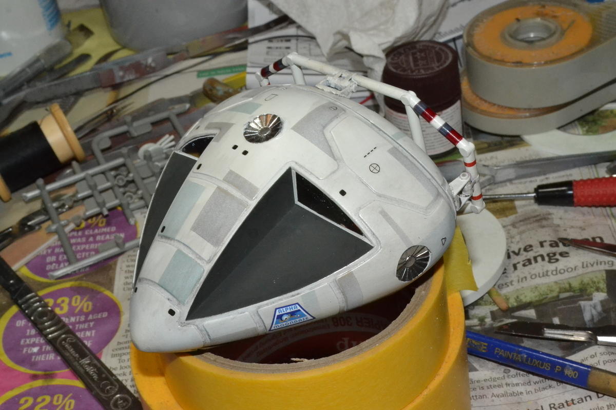

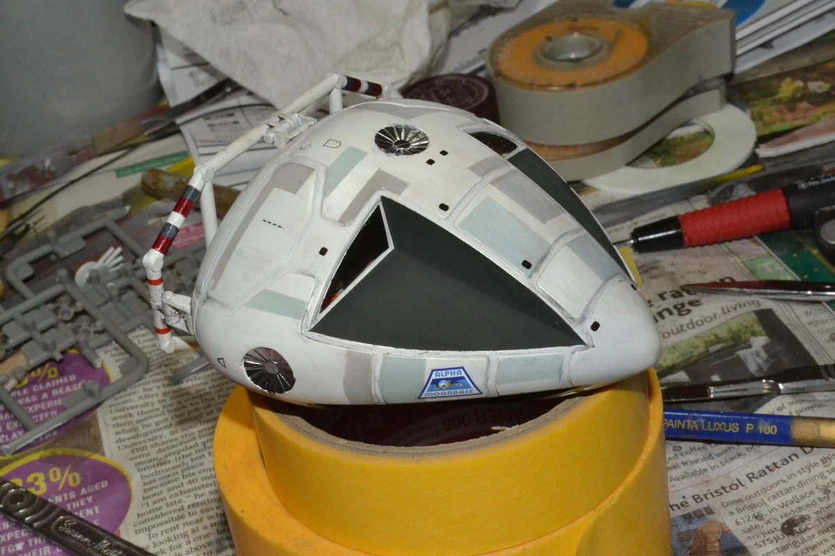

Kallisti Posted October 26, 2016 Author Posted October 26, 2016 (edited) Onwards and upwards!  The command module is essentially complete, with panels, decals and weathering all applied:    I painted the black areas rather than use the decals provided in the kit. The sensor disks have been painted with Alclad and are plastic not metal. I've tested the LED in the cockpit and its a bit dim. I think I may have the wrong resistor in the circuit - unfortunately that is now behind the cockpit bulkhead in the cockpit and although I havn't yet sealed upt he CM yet, it will still be difficult to access without the risk of causing damage. I'll see how this pans out - I may end up adding a second LED in parallel with the first which may add more illumination...  Next the walkways have been finally assembled with the detailed shelves from before, decals from several sources added and weathering using a dilute MiG dark wash:    Next the engine block has had more decals applied. This still needs a weathering wash and a matt coat.     (blast, just noticed the two dashes on the top engine are crooked  ) The passenger pod has had panels added and now needs to be weathered   Finally, the spine has had lots of stripy decals added to give it some more interest   Th enext job which should take the res tof the week is to start masking the 4 leg pods to add the coloured panels... Edited October 28, 2016 by Kallisti 3

Kallisti Posted October 27, 2016 Author Posted October 27, 2016 Well, investigating why thecockpit LED was too dim, Â I managed to get the cockpit bulkhead released and got access to the resistor for that LED and lo and behold its a 1k ohm resistor. I checked the calculation and it SHOULD be 220 ohm (well 190, but that closest), so no wonder its dim. I don't appear to have any 220's in my stash so had to order some so hopefully when they turn up all will be hunky dory! 1

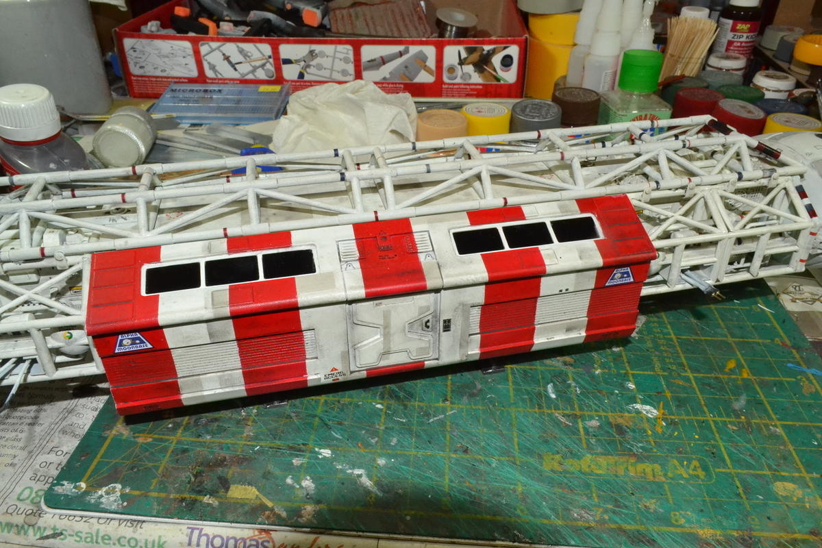

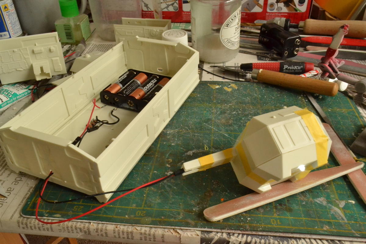

Kallisti Posted October 30, 2016 Author Posted October 30, 2016 (edited) I've had a couple of days off work and been able to get quite a lot done in that time. First thing was the leg pods. There are 4 of these and each needed masking for the grey panels and then remasking for the bluish panels. Once that was done some panel lines were drawn on with H pencil and then it was decaling. There are LOTS of decals on each pod. I reckon overall each leg pod takes about a day's worth of work, but the results are quite impressive. Most of the decals come with the kit, I only added a couple of extra ones per leg.    Next, the passenger module has been comprehensively weathered with washes and weathering powder. It has also been attached to the front and rear walkways and the spine. The electrical connections between the battery pack and the walkaways means this is now permanently fixed - I won't be able to take the module out like I can with the first build.    You can see the wires ready to connect to the leg pods! The problem with the command module lighting was eventually solved by putting two Surface Mount LEDs inside, both further in the nose pointing backward to the pilots. In this pic,   In this pic, the cockpit beak is just a push fit onto the front walkway. Its a firm fit so won't need to be glued and means it can be detached for ease of transportation.   The spine has also had a dark wash applied to dirty it down a bit. The engine bells have been attached to the engines and the engines themselves give a mild dark wash and some weathering    Remember, these are Alclad painted engine bells, not the ridiculously priced aluminium ones! The leg pods have had a spray of matt varnish and when that is dry, the feet will be added and the pods given a dark wash before fitting to the main body... almost complete!   Edited June 9, 2017 by Kallisti 2
Kallisti Posted November 1, 2016 Author Posted November 1, 2016 (edited) I can now say that the build is complete - the leg pods had their matt varnish and were then weathered with washes and powders and then installed into the main body. I did a trick on the black thruster panels and weathered them with a lighter coloured pastel chalk to give the impression of exhaust staining. The front pod electrical connections were with 2 pin plugs and sockets which were trivial, but the rear two had to be soldered. They all went together with a bit of coaxing and then came the moment of truth captured in this short video...   and here it is with its older sibling with some Thunderbirds and Stingray trying to photobomb in the background...   I'll take better "Ready for Inspection" photos when I can get out into the conservatory in daylight later this week. Edited November 1, 2016 by Kallisti 3 1
