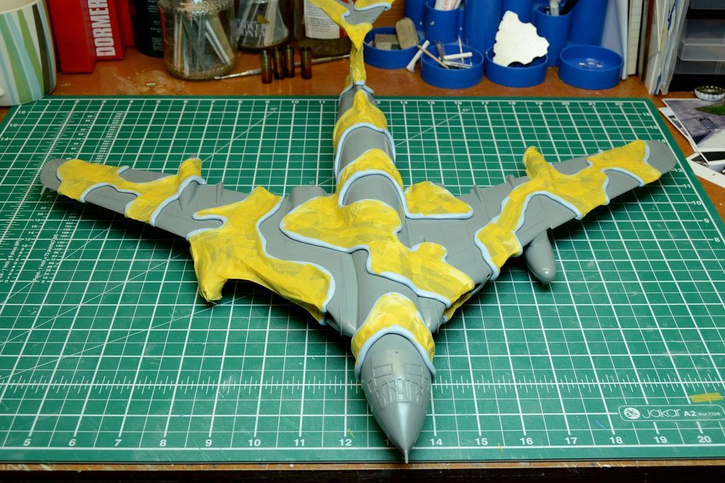

gazza l Posted November 16, 2016 Author Share Posted November 16, 2016 Hi all, On with the painting. This begins with a mammoth masking session, the intakes in particular were a nightmare to mask Then I pre-shaded with Alclad black gloss Followed by a coat of Xtracolor medium sea grey, which sprays on super glossy the only downside is it takes days to fully dry. Whilst the grey is hardening off it will give me a chance to finish of all the little bits and pieces. Cheers, gazza l 7 Link to comment Share on other sites More sharing options...

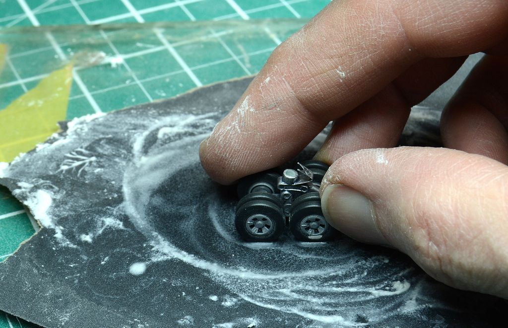

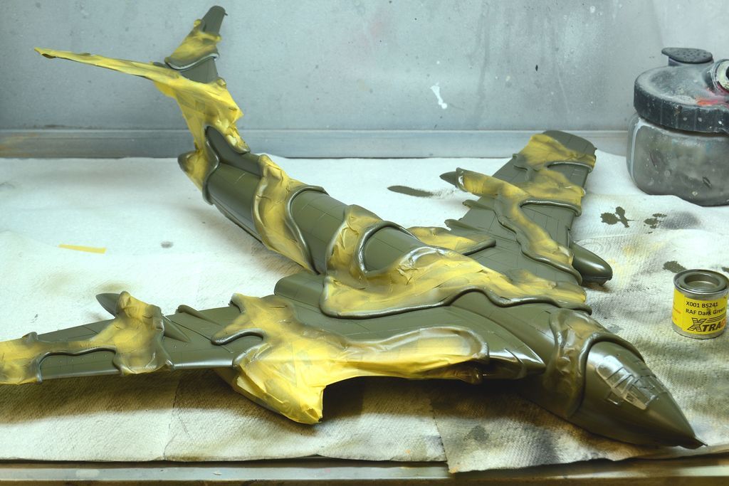

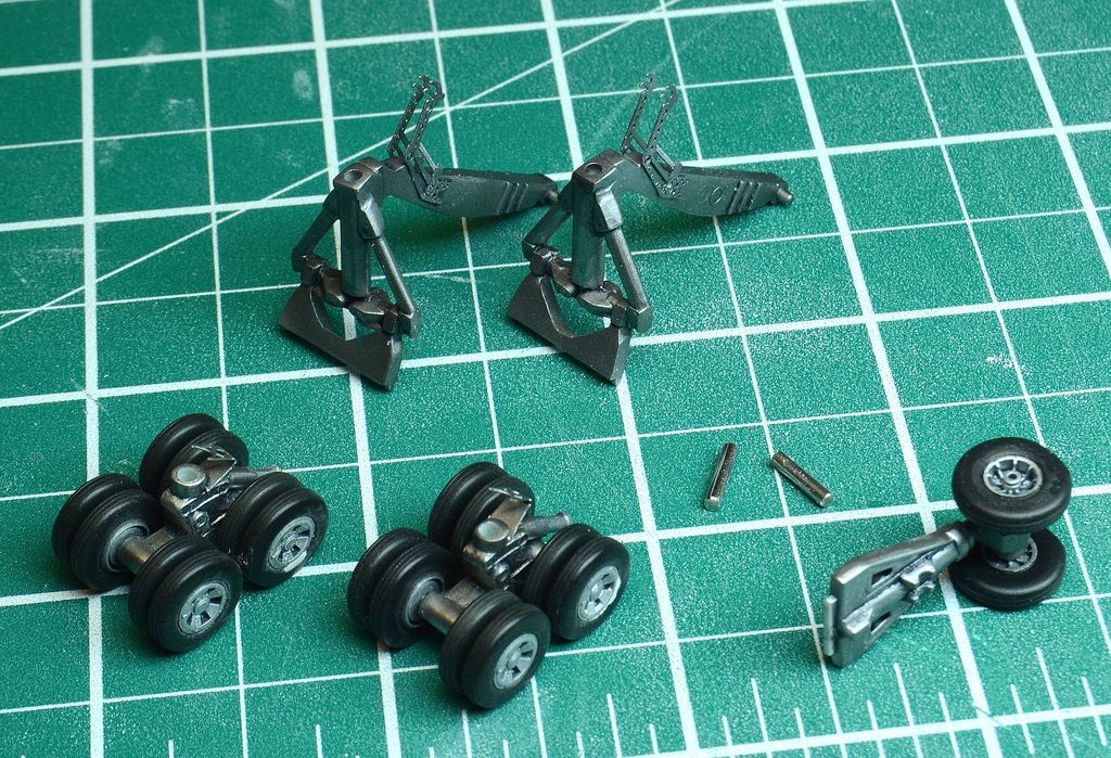

gazza l Posted November 19, 2016 Author Share Posted November 19, 2016 Good evening, Now that the Xtracolor grey has finally hardened off I can get on with the masking for the green. For this I used my favourite method of Blu-tack sausages infilled with Tamiya tape. Pre-shaded again with Alclad gloss black, this time going quite heavy in an attempt to darken the green topcoat. Then on with the Xtracolor dark green... the greens tend to dry quicker than the greys for some reason. While the green paint dries I worked on the undercarriage. Photo etch added and the assemblies painted with Alclad Aluminium followed by an oil wash. The two pins are for the oleos, these are made from sections of stainless steel welding rods and give an appearance of chrome plated shocks. Then finally the resin wheels were super glued on. Once the wheels had cured I carefully rubbed them on a sheet of wet wet'n'dry to ensure all the tyres will sit flat on the ground. Thanks for looking, gazza l 10 Link to comment Share on other sites More sharing options...

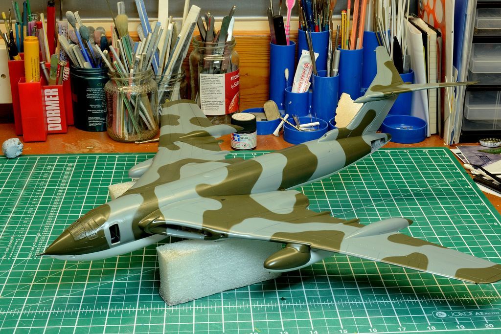

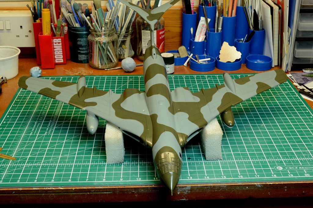

gazza l Posted November 20, 2016 Author Share Posted November 20, 2016 Ok chaps the waiting is over, all of the masking is off. She didn't turn out too bad, I just need to touch up a few areas of overspray/underspray. The intakes were a bit of a disaster though, the masking tape has pulled of large areas of the white paint right back to the resin... I think I'm going to make use of those photo-etch FOD covers. gazza l 9 Link to comment Share on other sites More sharing options...
