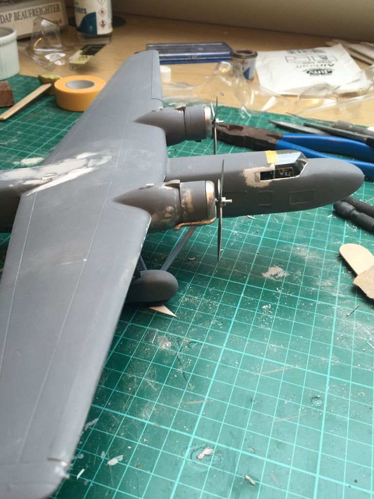

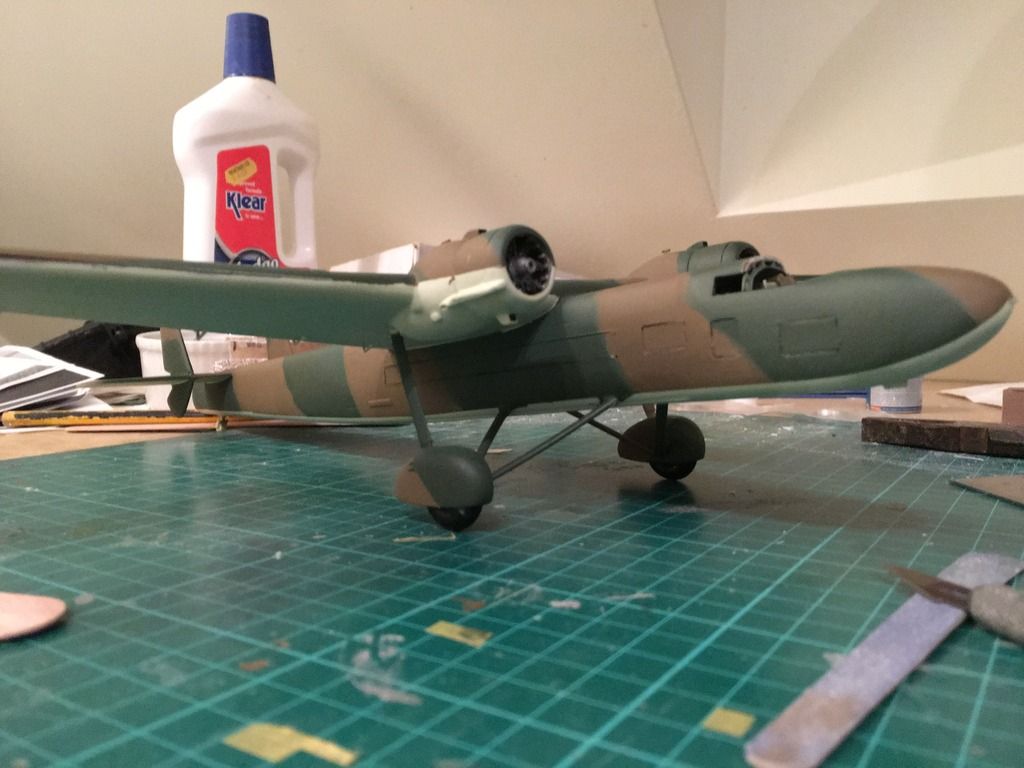

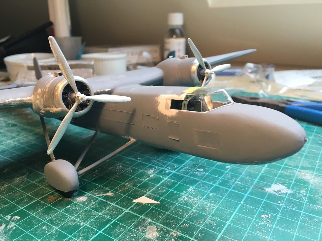

bristol boy Posted October 3, 2016 Author Share Posted October 3, 2016 Fast getting to a point where some serious painting can begin.. but first I need to plunge mould a new canopy, I overcut the original and ruined it! There was enough left to make a shape and plunge it into some clear plastic heated over a large candle. Cut to size it seems to fit, just needs a little more trimming. Note number of rejects lying on the table, plunge moulding is not an exact science.. not in my hands anyway. John Aero engines look great with some aluminium silver paint and a black wash, props need more work yet and are temporarily fitted. The opening in the side of the glazing will be fitted with sliding panels like this... Final shot showing a few details added that I can see in photos, still need to do the aerials. Next stop the paint shop! 6 Link to comment Share on other sites More sharing options...
perdu Posted October 3, 2016 Share Posted October 3, 2016 That's great moulding work there and a very fortunate save from the first one Funny how when I'm making mouldings it's usually the first one I make that works and all and sundry redo efforts get wasted Still there is always one that works, exact science? It must be because Falcon make some magnificent vacform canopies But even they get fails, my Royal Navy set has two copies of the Sea Venom canopy with the main one crossed out in black marker pen and another one cut out and taped to it for use I do really like (too) the collector rings in slightly burnt steel just on the turn to really burnt It looks really effective unlike those who just bung on a coat of copper colour nice! 2 Link to comment Share on other sites More sharing options...

Cees Broere Posted October 3, 2016 Share Posted October 3, 2016 Forgive me for noting but it seems the windscreen has a reversed triangular windscreen frame similar to the Halifax in your accompanying photograph Cees Link to comment Share on other sites More sharing options...
bristol boy Posted October 3, 2016 Author Share Posted October 3, 2016 33 minutes ago, Cees Broere said: Forgive me for noting but it seems the windscreen has a reversed triangular windscreen frame similar to the Halifax in your accompanying photograph Cees Hi Cees, Didn't know you frequented this forum, more familiar with your posts on Historic Aviation. The canopy on the model needs more trimming and isn't quite the right shape as it has a triangular rather than vertical junction between the side and front. I hope this is what you are getting at and the scissors will be used to trim the canopy to appear more like the real thing. 1 Link to comment Share on other sites More sharing options...

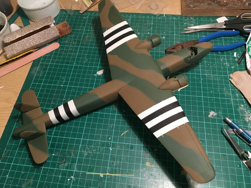

bristol boy Posted October 13, 2016 Author Share Posted October 13, 2016 A little more progress and finally some paint on.. Big decision now on D Day stripes! My understanding is that after about a month ie July onwards stripes were removed from the upper wings and fuselage as the threat from friendly fire from other aircraft had pretty much passed. The photo below shows the subject I am doing in September '44 and if you look carefully at the wings it looks like the stripes have been painted over. My thoughts are that no matter how well (or badly) I do this it will always look like a mistake so I intend to back date to a point when the aircraft had full stripes top and bottom. What colour would the U be..red? Please don't look too hard at the camo, its bled more than usual and needs tidying up! 7 Link to comment Share on other sites More sharing options...
Martian Posted October 13, 2016 Share Posted October 13, 2016 Regarding the stripes, go with what you decide is correct, its your model and you are the one who has to look at it the most. Martian 2 Link to comment Share on other sites More sharing options...
JWM Posted October 18, 2016 Share Posted October 18, 2016 Interesting, that strips looks to be overpainted from top only with brighter colour (DK Earth I think). Cheers J-W Link to comment Share on other sites More sharing options...
rob85 Posted October 18, 2016 Share Posted October 18, 2016 If they have been painted over (which looks a definite in the photo) then they were there in full at some point?! So go nuts.... That said I like the idea of trying to get them as per the photo also looks like a well used AC! Rob Link to comment Share on other sites More sharing options...

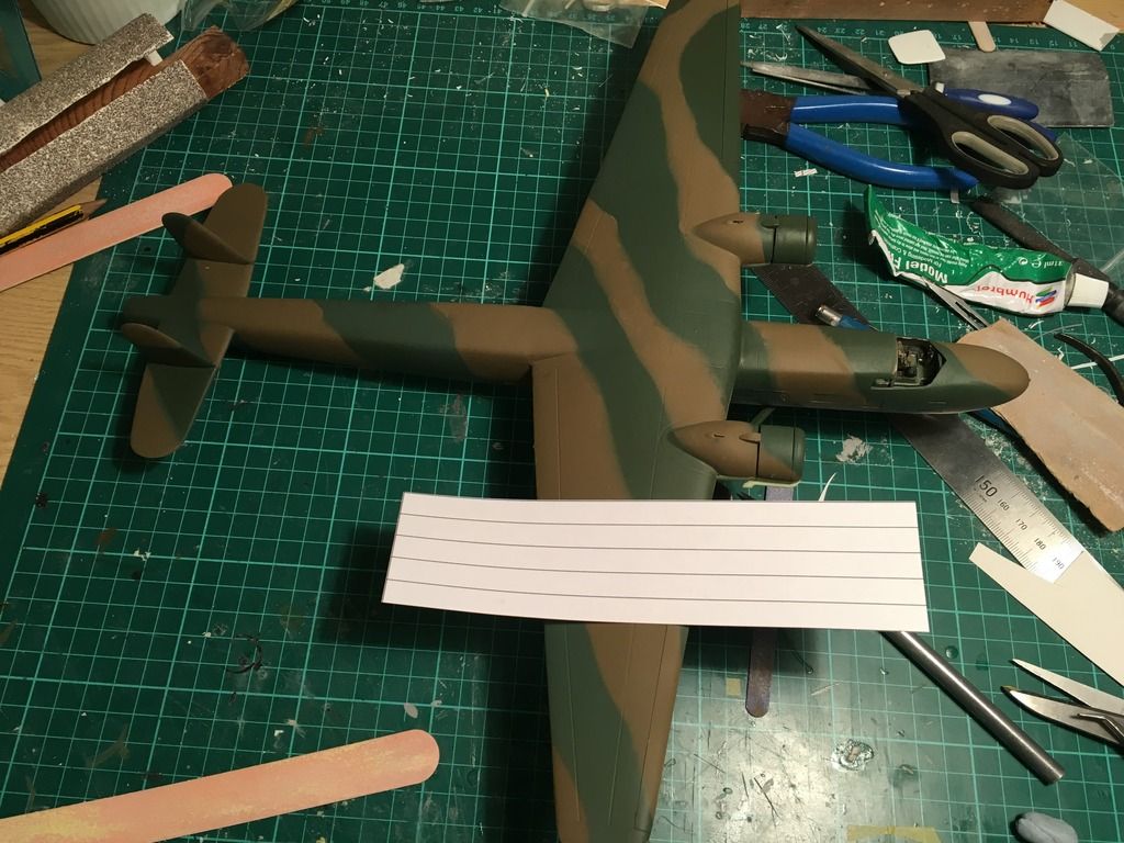

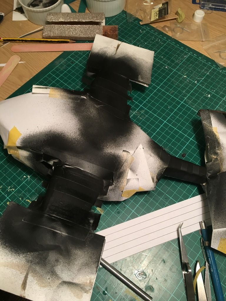

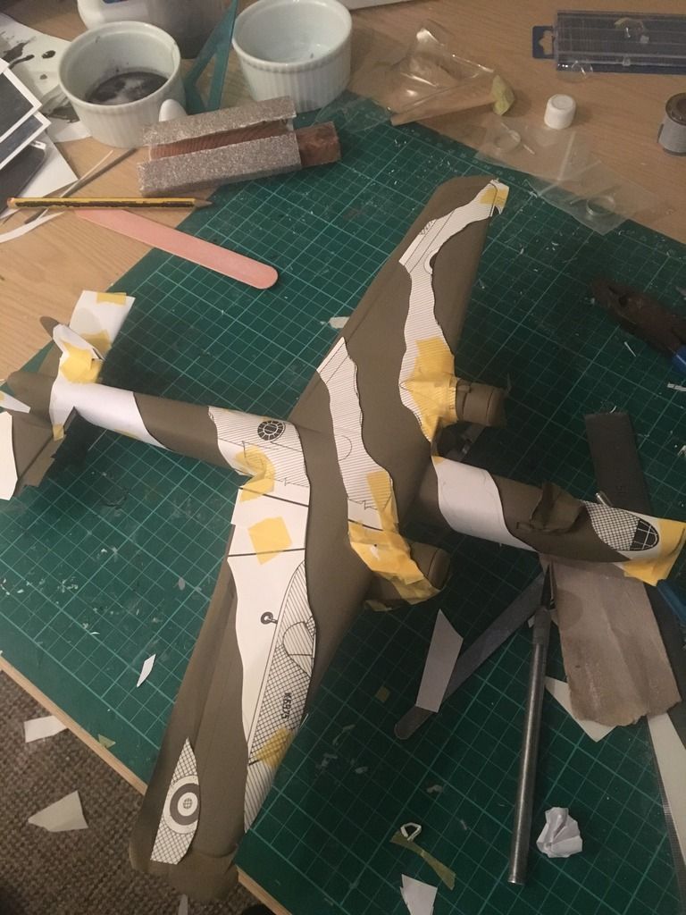

bristol boy Posted October 19, 2016 Author Share Posted October 19, 2016 Decision Day; full D Day stripes top and bottom. First drawn out to scale at 24" wide (61cm apparently) on a strip of paper which was invaluable in setting them out. Then wrap entire thing in paper like an oven ready sparrow leaving the full width to be sprayed white, then mask for the black stripes. Like so... I have since tidied up the slight bleed on the white and the camo edges which are far too soft. I now know what Cees was talking about earlier.. On 03/10/2016 at 7:47 PM, Cees Broere said: Forgive me for noting but it seems the windscreen has a reversed triangular windscreen frame similar to the Halifax in your accompanying photograph Cees The front windscreen has an inverted triangular piece, so back to the drawing board with my plunge moulding which has a defined line down the middle and is based on the supplied Contrail item. You can see the triangle in this shot.. For those that are interested in the new Valom Harrow release on Rumourmonger it is worth looking at the sprue shots; I can't tell if their clear parts are correct or not. 1 Link to comment Share on other sites More sharing options...
CedB Posted October 19, 2016 Share Posted October 19, 2016 Nice job on the stripes BB, they look very neat and you'll have the bleed touched up in no time... For the canopy, how about sanding a flat bit and then using some tape or foil for the frame? It'd save making another one. If you sand through the plastic, Clearfix or Krystal Klear? Bit of a bodge possibly, but you know me... 1 Link to comment Share on other sites More sharing options...
bristol boy Posted October 20, 2016 Author Share Posted October 20, 2016 19 hours ago, CedB said: Nice job on the stripes BB, they look very neat and you'll have the bleed touched up in no time... For the canopy, how about sanding a flat bit and then using some tape or foil for the frame? It'd save making another one. If you sand through the plastic, Clearfix or Krystal Klear? Bit of a bodge possibly, but you know me... Thanks Ced. Glad I kept the mould for the canopy and sanded a flat triangle on the front last night ready to plunge a new one...just short of suitable clear plastic at the moment! Link to comment Share on other sites More sharing options...
