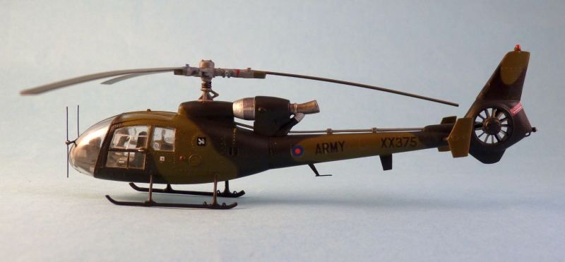

JamesP Posted November 7, 2016 Share Posted November 7, 2016 (edited) Hannants do two Helo Greens Xtracolor X027 British Army Helo Olive BS220 Xtracolor X028 RN Hello Helo Olive Drav BS298 The thing is, it appears the the RN Olive is the correct one to use on British Army Helos such as the Gazelle and Lynx, or is at least the better of the two to use. This my Gazelle in X028 Just found this note in my build thread Quote ...I can only find reference to BS298 being used with Black in the early scheme and BS220 with the Medium Sea Grey in the later scheme... Edited November 7, 2016 by JamesP added note on camo Link to comment Share on other sites More sharing options...
