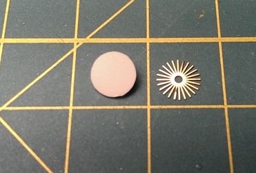

First I took the following part off the sprue. This part is installed under the large port-hole on the aircraft's spine and has moulded detail which is to be replaced by a PE part. So, it had to be filed away, as shown in the second picture:
The following pictures show the plastic and PE parts side by side and, finally, the PE installed:

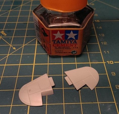

Starting with the wing tips, these are made up of two parts each:

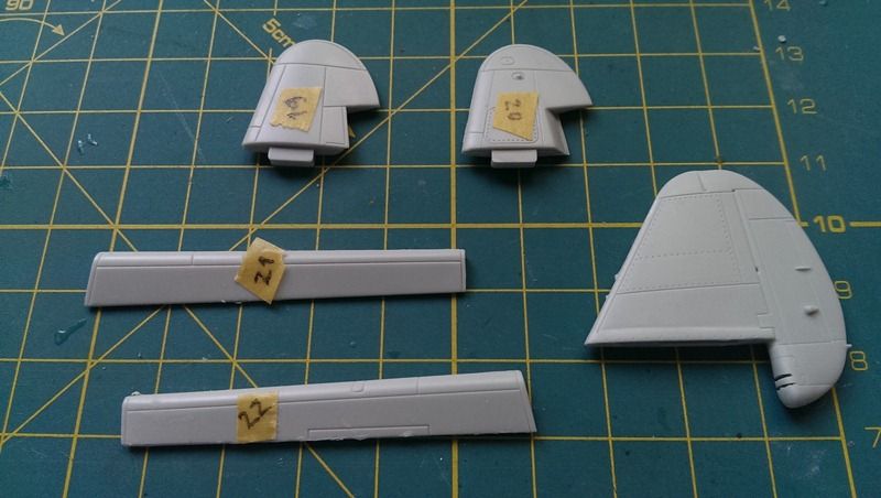

The ailerons and tail fin are also made up of two parts each. The parts for these sub-assemblies were glued together and held by pegs while the glue cured overnight:
Here's the result:
The plastic that oozed off the joins still has to be cleaned. I did this on purpose, to serve as filler for the joins and minimise the need for putty.

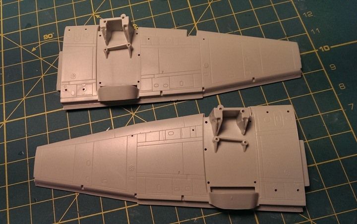

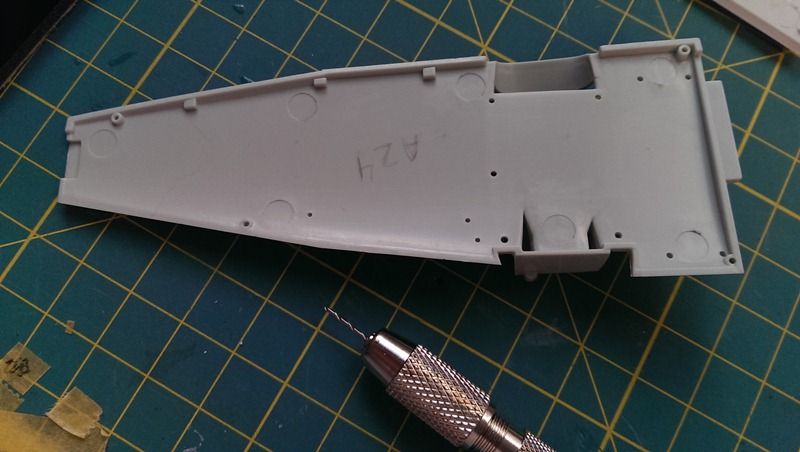

Next, I had to drill holes on the underside parts of the wings for the bomb holders and dive breaks:
The result is shown in the following picture. There are four 0.9 mm holes inboard of the landing gear area, for the bomb holders, and two 0.7 mm holes outboard of the landing gear, along the leading edge, for the dive breaks:
The wing parts were, then, glued together:
Resulting in this:

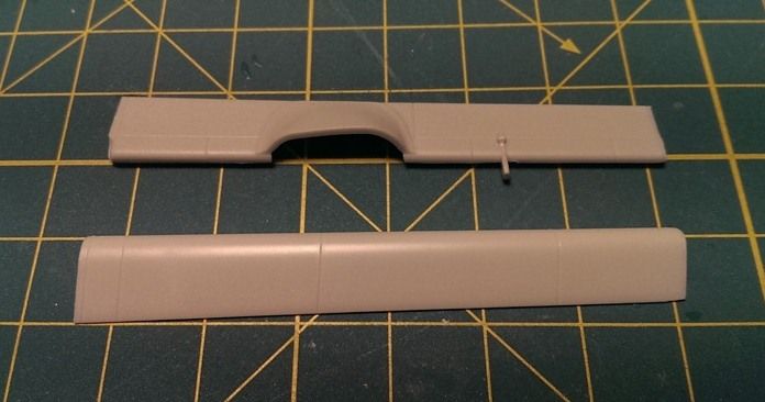

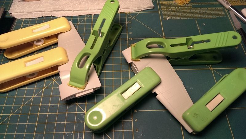

The flaps are also made up of two parts each:
The flaps were glued together (pegs were also used while the glue cured), resulting in this:

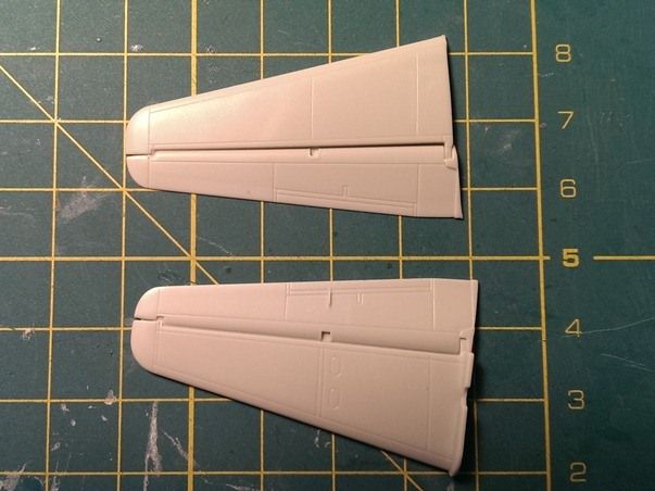

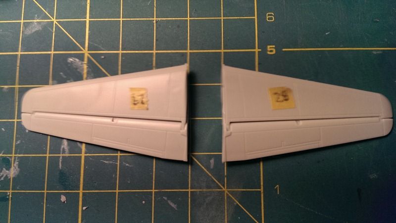

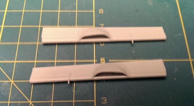

Here are the two parts that make up one of the horizontal stabilisers:
After glueing the parts (once again, pegs were involved), here's the result:

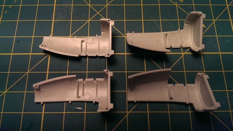

Finally, I took the parts that make up the landing gear wells off the sprues. Here they are after cleaning the remains of sprue gates:
I still have to treat several ejector marks on the insides, as they are visible through the well openings:

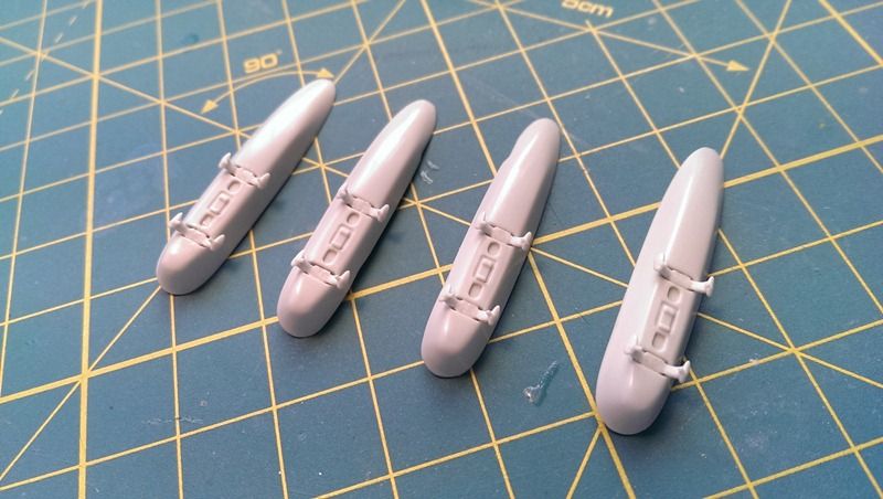

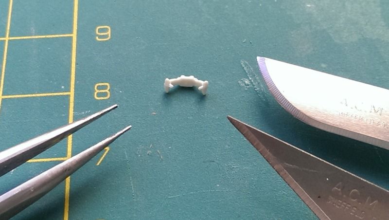

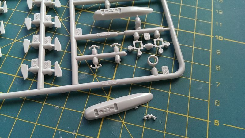

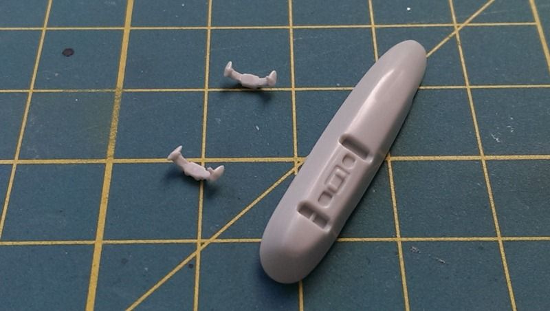

This time I turned to the bomb holders, of which there are four, each one with two claw-like grips to hold its respective bomb. The following picture shows one holder and one grip already off the sprue, but still with excess plastic to be cleaned off. In the sprue we can see another holder and four grips, as well as the bomb fins, which won't be used, as they'll be replaced by PE:
The grips are so tiny that I opted to saw them off the sprue, in order to not break them. Then, I cleaned the excess plastic and moulding lines with a combination of a nº 10 and nº 11 blades:
Here we can see one bomb holder and two grips already cleaned and ready to be glued together:

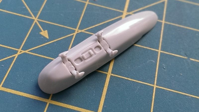

And here they're already glued together:
After more than two hours taking parts off the sprues and cleaning them, here are the four bomb holders finished:

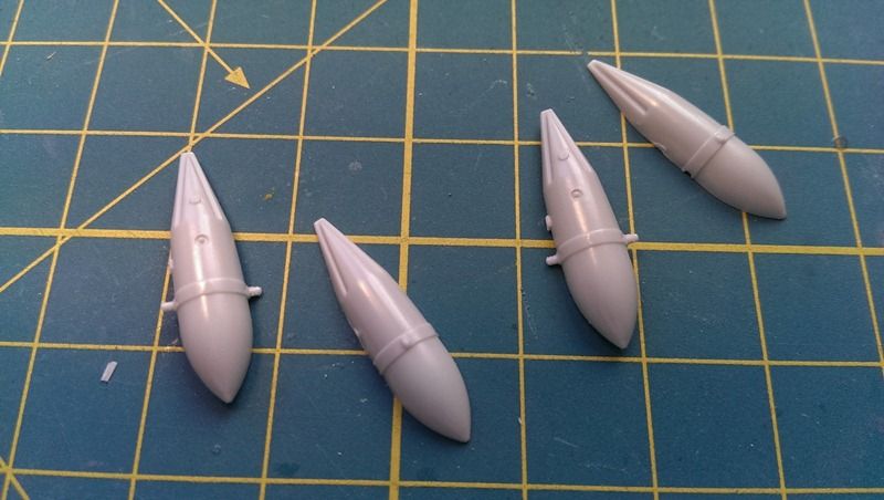

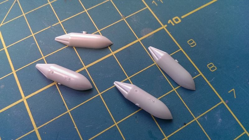

Next, I turned to the bombs. I'll be loading the aircraft with a pair of 500 kg and a pair of 250 kg bombs.
These are the parts for the 500 kg bombs:
And these are for the 250 kg bombs:

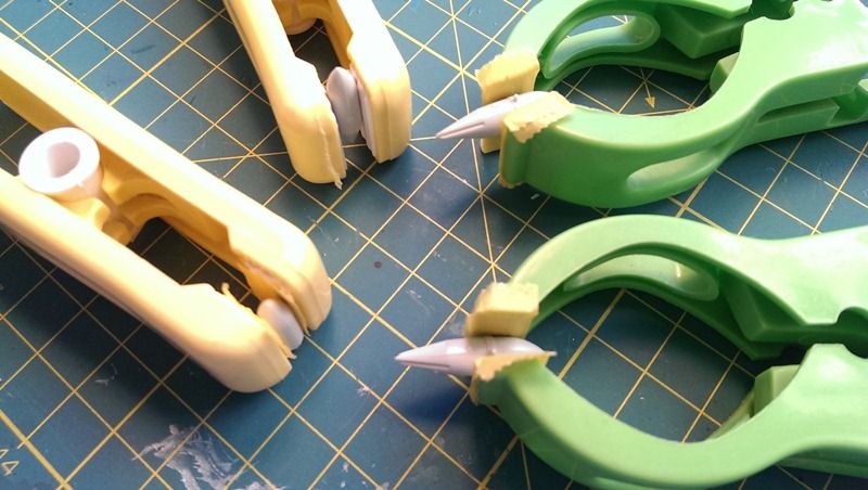

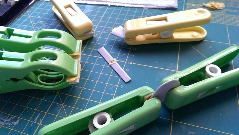

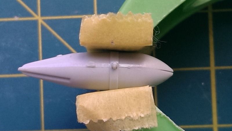

The parts where glued together and held by clothes pegs while the glue cured:
Unfortunately, the fit of the 500 kg bomb parts is not good. There's a huge gap on the front, which I later filled with CA:

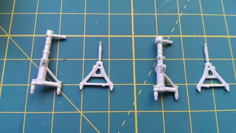

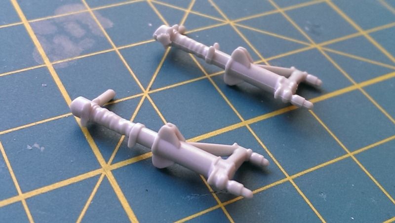

After this, it was time to take care of the landing gear. Here are the parts for the landing gear legs:
These parts had to be cleaned, as they had quite noticeable moulding lines. Here we can see one of the legs already cleaned (the front one) and the other still with moulding lines:
The excess plastic was removed with a nº 11 blade and the moulding lines were scrapped away with a nº 10 blade. The cleaning process took a lot of time.

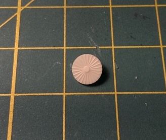

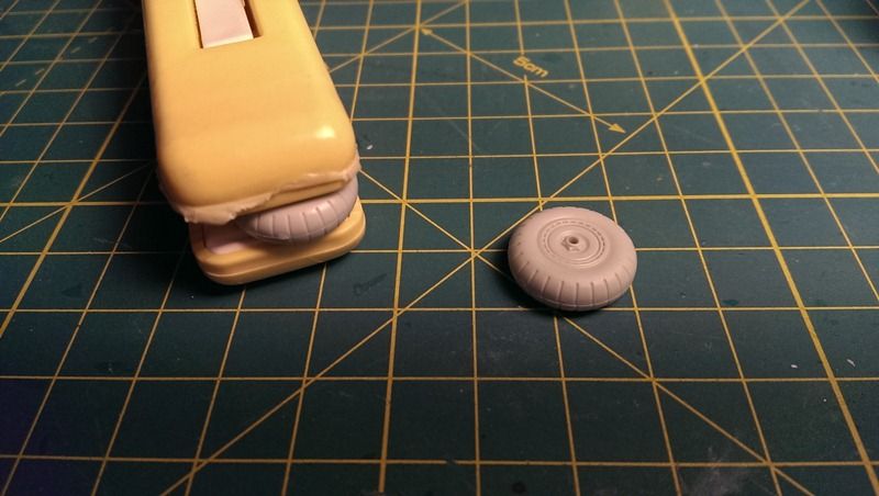

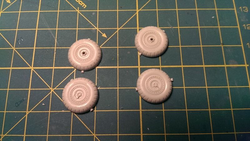

Next, I removed the main wheels off the sprues:
The parts were cleaned of excess plastic and glued together:

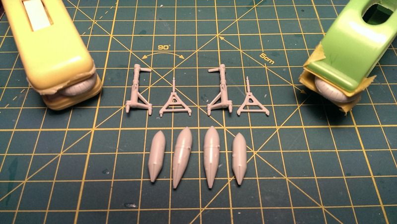

Finally, here are the bombs, landing gear legs and wheels:

Hello,Jaime - Great work and patience as always on your preparation of all the parts and sub-assemblies.i like the mini-clamps you use.They're much more sophisticated than my clothes pegs!! :D All the very best,Paul.
Stix, Paul,
Thank you both for your kind words and interest! It's much appreciated as always :)
Regarding the "mini-clamps", they're really just big-size clothes pegs. Their springs are not very strong but can put some not too excessive pressure on the parts.
I've ordered some more sophisticated clamps at my LHS, like those used by Ced. They should be here by the end of the month.

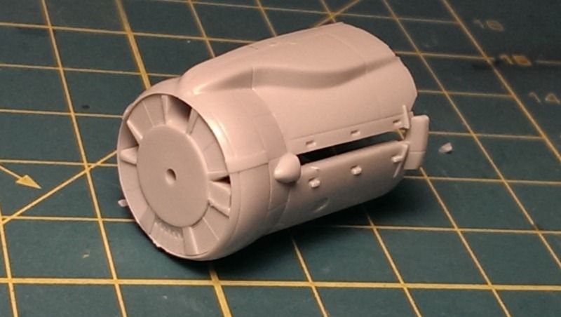

I removed the engine and propeller parts off the sprues, mostly using a mini-saw. Here they are, still needing a good clean-up:
I cleaned up one set of engine parts and did a dry fit. As can be seen in the following picture, fit is very good. The parts are holding together without any glue or tape:
I'll have to paint the insides of the cowlings with black paint, as there is an opening in the engine face.
I started cleaning up one of the propellers but I was already quite tired and didn't finish it.
