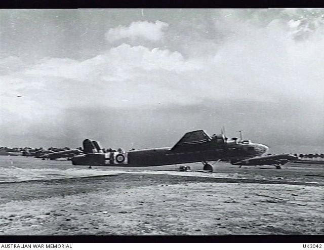

Junchan Posted April 14, 2016 Share Posted April 14, 2016 (edited) I also have a Contrail vac kit of Harrow, but never attempted to build this. Hope I would help your challenging project by sharing some information. Here is a photo of the Sparrow K6994 of the No. 271 Sqn from the book "Coastal Support and Special Squadrons of the RAF and their Aircraft" and a link to a color profile of this aircraft. http://www.rafweb.org/Squadrons/Sqn%20Markings/SqnMark271-299.htm Also these photos from Aeroplane Special, British multi-engined support aircraft of WW2 must be helpful. Finally a link to a interior photo of the Harrow from Flight Global. https://www.flightglobal.com/pdfarchive/view/1938/1938%20-%200585.html Some more photos from the IWM collection. http://www.iwm.org.uk/collections/search?query=handley%20page%20harrow&items_per_page=10&f[0]=mediaType%3Aimage Cheers, Jun in Tokyo https://www.flickr.com/photos/horaburo/albums Edited April 14, 2016 by Junchan 3 Link to comment Share on other sites More sharing options...
bristol boy Posted April 15, 2016 Author Share Posted April 15, 2016 Jun, Thank you very much for posting the photo I was looking for, it's very much appreciated. I think that is the aircraft I'll model but don't believe the colour profile matches it, the photo is clearly a Sparrow but the profile still has the Harrow front end, also it has black undersides whilst the photo has sky. In short I wouldn't trust the profile. There are a couple of photos below of another sparrow from the same squadron, code unknown but again with invasion stripes round the fuselage and the wing underside, your photo doesn't have them on the upper surface so I assume they weren't added for some reason. This will be quite some challenge as the kit is very basic but with patience it should produce a decent model. Thanks again for your assistance, Neil 2 Link to comment Share on other sites More sharing options...
Mike Starmer Posted April 15, 2016 Share Posted April 15, 2016 The Harrow in September 1944 is in day flying colours, hence Sky undersurfaces. The lack of upper wing stripes is due to the date, by then no wing stripes or upper fuselage stripes were required. Link to comment Share on other sites More sharing options...
Graham Boak Posted April 15, 2016 Share Posted April 15, 2016 (edited) The upper fuselage stripes were initially deleted with the upper wing ones, but were reinstated for transports and medium bombers in, I think, October. Harrow bombers were initially with Night (black) undersides, but the transports will have had Temperate Land (Dark Green and Dark Earth) with silver (Aluminium) undersides. The undersides will then have become Sky, as Mike says. By the end of the war they should have been in Temperate Sea Scheme (Dark Slate Grey and Extra Dark Sea Grey) uppersurfaces with Azure Blue undersides, but the photos (particularly the one above of K6994/U taken on ortho film) suggests to me that this may not have happened. Edited April 15, 2016 by Graham Boak Link to comment Share on other sites More sharing options...
bristol boy Posted April 15, 2016 Author Share Posted April 15, 2016 Thanks chaps, that's really interesting. I hadn't even noticed on K6994 that the stripes stop at a certain height on the fuselage. So if I did use that as a subject it is likely to be Dark Green/Dark Earth, Sky undersides, partial D Day stripes on the fuselage and on the underwing but not on top? The image I posted of another Sparrow is late 1945 with full D-Day fuselage markings and also on the wing underside, presumably not on the upper although it can't be seen. The caption for this photo says it is taken at an airfield near Brussels in June 1945 and is the last Sparrow that 217 squadron had left. I'd use this as a subject but reproducing the nose art puts me off. Link to comment Share on other sites More sharing options...
Graham Boak Posted April 15, 2016 Share Posted April 15, 2016 It's impossible to be absolutely certain when interpreting b&w photos, and sometimes difficult even to be fairly sure. This is one of the difficult ones. The panchromatic photos, such as the last one, are entirely consistent with TLS/Sky, so you might think that a safe choice. However, it could be consistent with TSS/Azure Blue too. TSS is very variable on panchromatic photos, sometimes having very low contrast and sometimes just what you see here. The orthochromatic photo, K6992/U, doesn't have the very high contrast between the colours sometimes seen with TSS. However, often there's very little contrast between DG and DE on ortho film, and that isn't true here. So is it in TLS with faded Dark Earth? This is very common and indeed very likely on these aircraft, if still in this scheme. There is something niggling at the back of my mind, that the TSS/AB scheme was intended for overseas transport aircraft, at least originally. The Harrow doesn't fall into this category - the Continent not counting as overseas in this context. Which takes us back to TLS/Sky as the likeliest scheme. That's a bit of a shame, as it would be nice to have a choice of schemes for the aircraft, particularly as I am going to have a Valom example to go with my Contrail. If the Contrail ever gets made, which is increasingly unlikely. Link to comment Share on other sites More sharing options...
Seahawk Posted April 15, 2016 Share Posted April 15, 2016 There is something niggling at the back of my mind, that the TSS/AB scheme was intended for overseas transport aircraft, at least originally. The Harrow doesn't fall into this category - the Continent not counting as overseas in this context. Same here. Link to comment Share on other sites More sharing options...
tonyot Posted April 15, 2016 Share Posted April 15, 2016 If you look closely at the photo you can see the D-Day stripes have been painted out on the top of the wings, so you could go with full D-Day stripes if you wished.. Also,.....weren`t most,....if not all Sparrows destroyed on Belgian airfields during the Bodenplatte raids of 1st January 1945,........leading to 271 Sqn`s Sparrow flight being re equipped with Dakota`s,......so they probably didn`t uirvive long enough to receive the TSS with Aure Blue undersides? Cheers Tony 1 Link to comment Share on other sites More sharing options...

Ed Russell Posted January 22, 2018 Share Posted January 22, 2018 Picture in Post #3. From a popular song in 1944. I have a slightly better image I have sent to Mr Valom. "Mairzy doats and dozy doats and liddle lamzy divey A kiddley divey too, wouldn't you? If the words sound queer and funny to your ear, a little bit jumbled and jivey Sing "Mares eat oats and does eat oats and little lambs eat ivy"" 3 Link to comment Share on other sites More sharing options...
Sheepster Posted April 22, 2018 Share Posted April 22, 2018 What was the serial code of Mairzy Doats? Link to comment Share on other sites More sharing options...
Ed Russell Posted April 24, 2018 Share Posted April 24, 2018 271 Sqn Ambulance Flight operated these Sparrows -Â K6937, K6943, K6970, K6984, K6987, K6993, K6994. The picture is reportedly (according to the caption)Â the last Sparrow extant with 271 and indeed you can see the field is full of Dakotas. So if you can identify the one struck from 271 last, then that's it. Link to comment Share on other sites More sharing options...
Graham Boak Posted April 24, 2018 Share Posted April 24, 2018 (edited) From memory of the K File, several were finally struck off charge together in May 1945 rather than staggering along individually. So you could reduce it to a small number, but not one? Not that the soc date is necessarily identical to the withdrawal date. Edited April 24, 2018 by Graham Boak Link to comment Share on other sites More sharing options...
