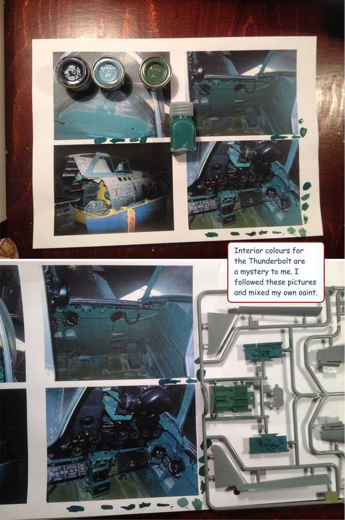

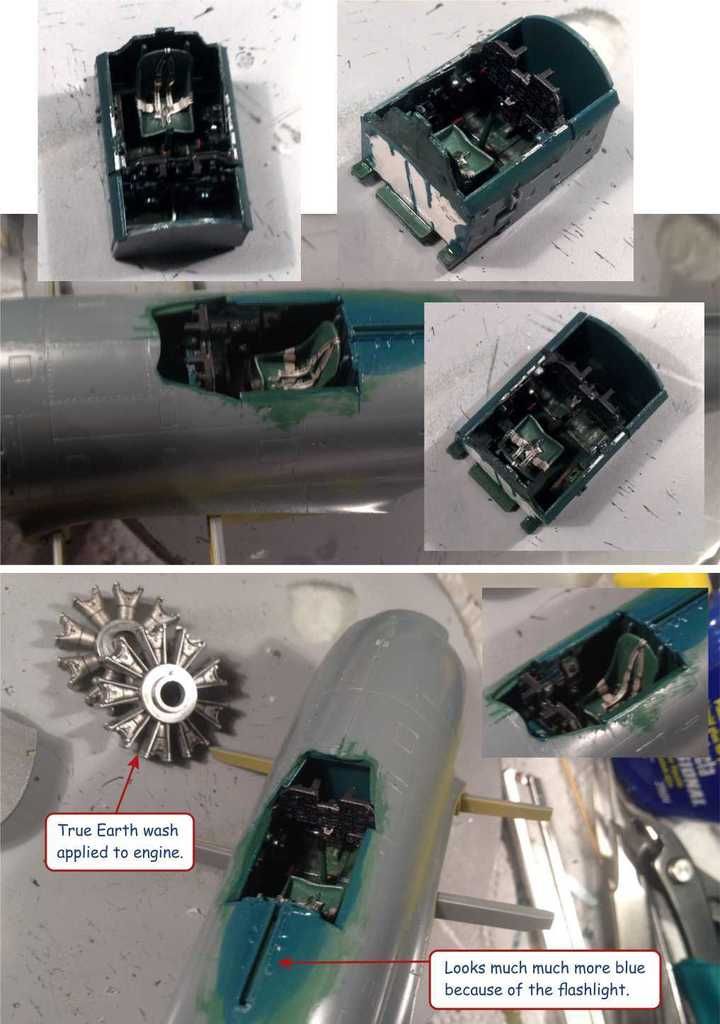

Caerbannog Posted March 12, 2016 Author Posted March 12, 2016 Some may have seen the post I made in the reference thread. Based on this I decided to give the pit sidewalls a somewhat vivid colour. Needless to say I had to mix it myself. Still I have no ide if this is what the P-47 colour looked like but it makes a nice variation from the usual green interiors: On Reynolds Bombshell the armor plate behind the seat was removed, so I scratched a new rear cockpit wall from sheet and aluminum tape. I did not went to town with this as most will be hidden by the seat... The instrument panel is from the Eduard Zoom set. Hmm - I forgot to take more pictures of the cockit before I assembled it and closed up the fuselage. But I tell you it look aaaawwwwwsome ;-) Rene 2

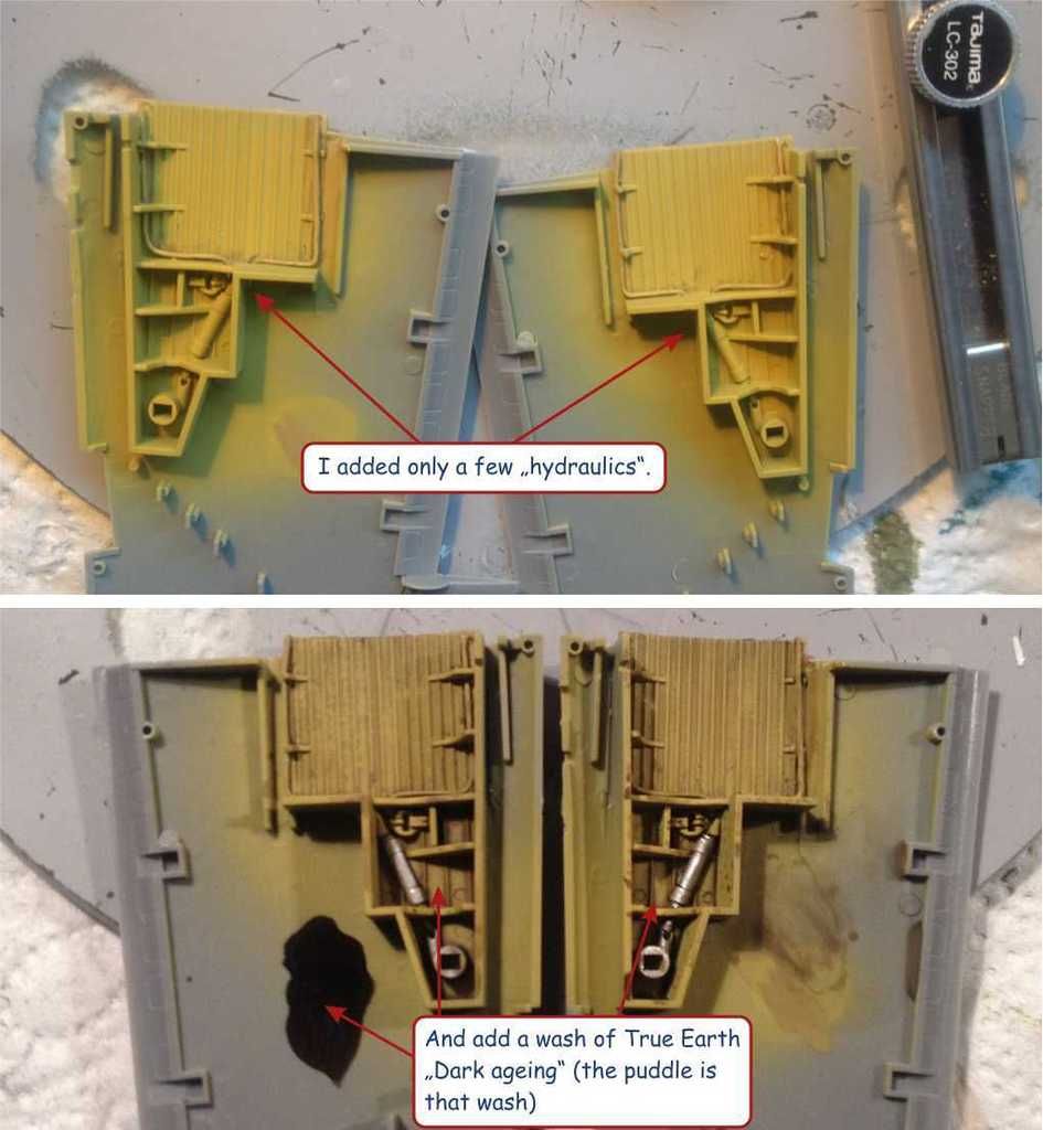

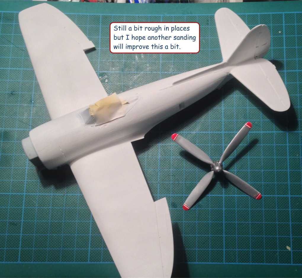

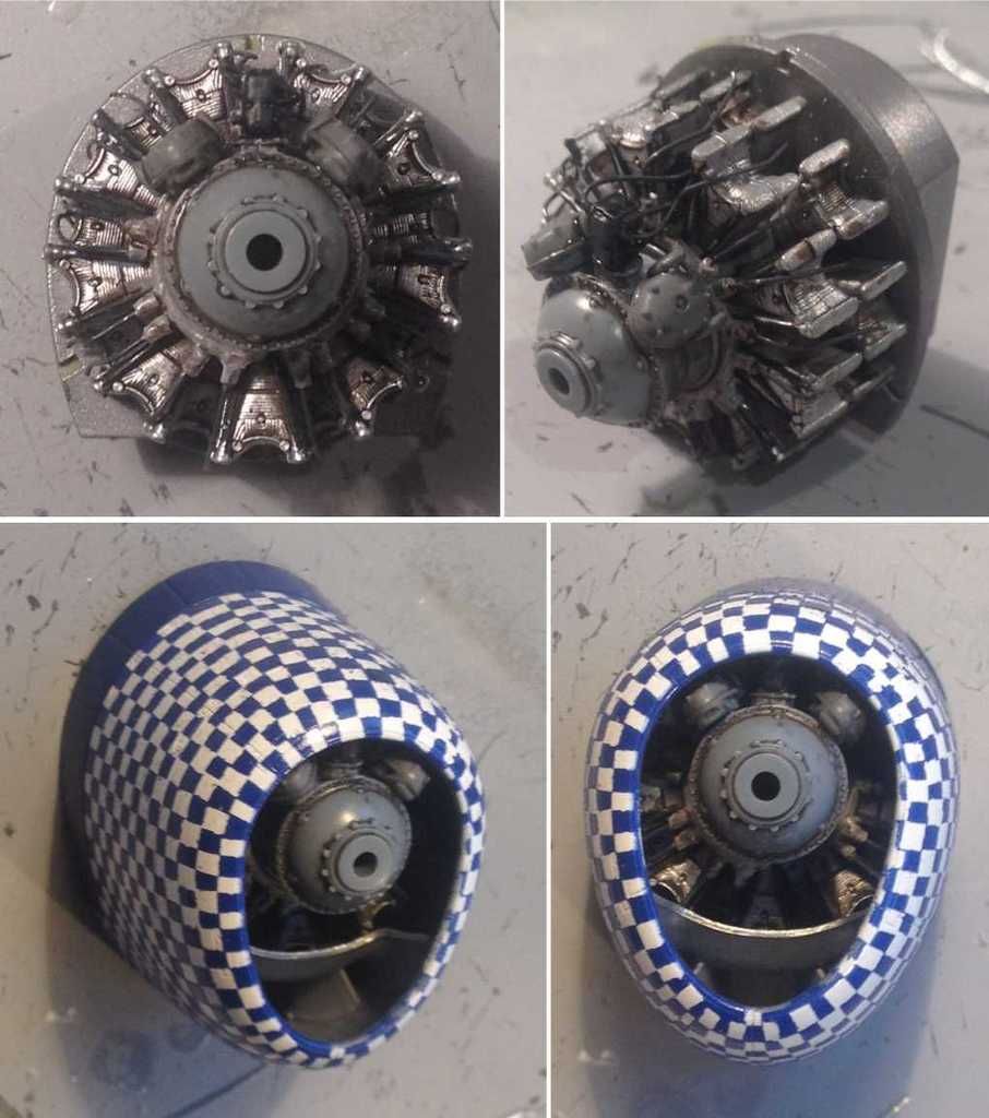

Caerbannog Posted March 14, 2016 Author Posted March 14, 2016 Major update today - all that has been done so far and over the weekend. Below is the masked and painted canopy. I used DIY vinyl masks for that. This was done before this GB started. "New" is only the aluminum colour inside the cowling which was painted zinc chromate yellow before: Now for the work from last weekend: And finally some work on the engine: I should really learn to check my reference when I build - I had he computer shut off and no pic of the engine so I build the ring and wires from memory which certainly differed from the real thing. I will however not correct it as the engine is deep in the cowling and not much more than a good impression is visible once assembled. This is what I will tell everybody. Next I will attached the wings which strangely need a bit of sanding or they will leave a small gap. Otherwise the fit of this kit is excellent and a real joy. I could already start thinking about painting but have to find a suitable place for this as my man cave is still in work - but I finally finished plastering the walls yesterday. Maybe I take chances and use a rattlecan outside. Rene 3

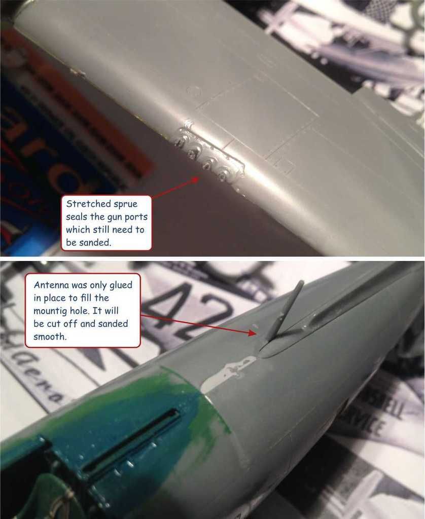

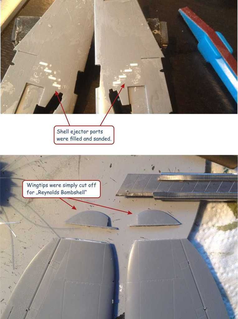

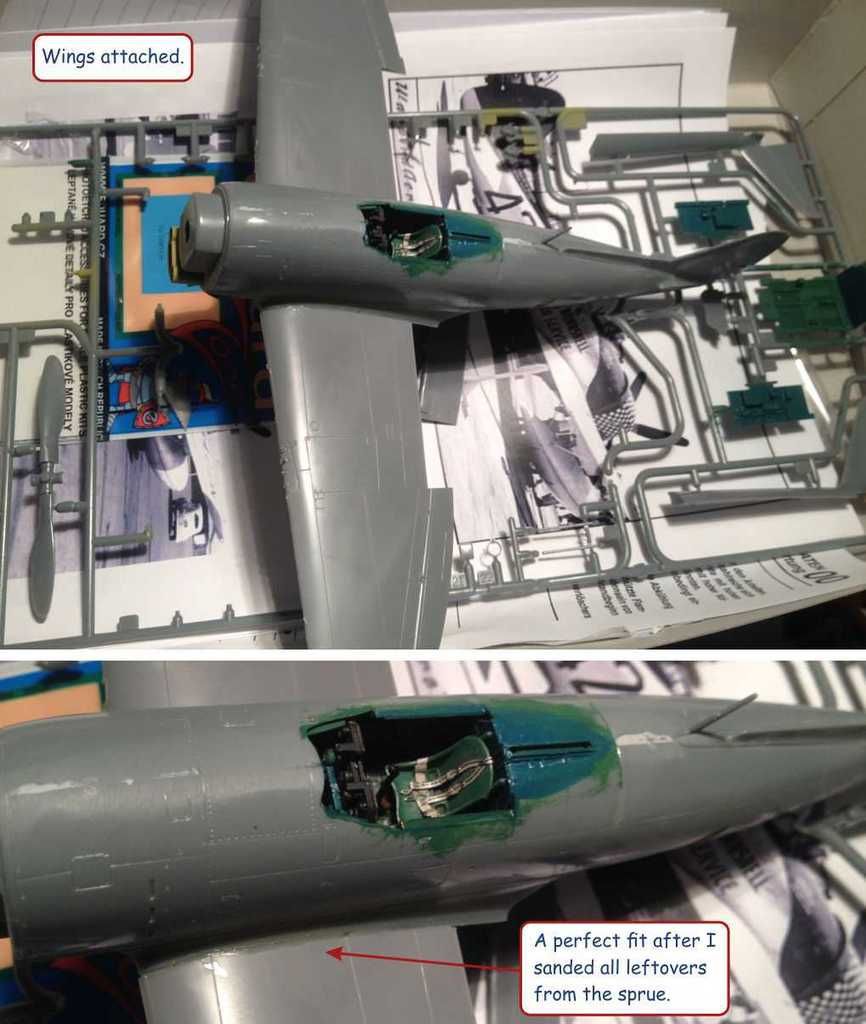

Caerbannog Posted March 15, 2016 Author Posted March 15, 2016 Thanks PlaStix. Yesterday I attached the wings - the "bad" fit (a slight gap) was caused by some sprue attachment points which were not yet sanded down and on of the wires for the wheel well plumbing which stood a bit to far out. After I fixed that the wing fit perfectly: Next I filled the gun ports with stretched sprue and also attached the antenna on the fuselage - only to fill the mounting hole. Both are now sanded and got a coat of disolved putty which is currently about to dry. I will now resume work on the 315 gal drop tanks. These huge tanks were used on some long range P-38 missions (like on"Operation Venegance" were Yamamoto was shot down) and on the F-82 Twin Mustang "Betty-Jo" which made a record flight from Hawaii to New York. There even existed an ambulance pod based on this drop tank which could be mounted under the P-38 to transport wounded soldiers. These pods had a clear front dome. However ther is no 315 tank available that I know of (also the Minicraft kit of "Betty-Jo" does not include one), so I have to scratch build these. The fun part starts when you try to get any information, drawings, dimensions on this but in the end I think I got what I was looking for and made sveral drawings and even tried to make a 3D file to print these - but I still need to learn to get a good result. So I returned to one of my earlier masters: As you can see above the end tip looks quite different fron the picture. I can either use Milliput here and start sanding or try to solve the shape issue by using the back end of the small kit tanks. When the master is finally done I need to decide wether I cast it or wether I make a vacuform mold. I actually prefer the latter option. Maybe I try both. René 2

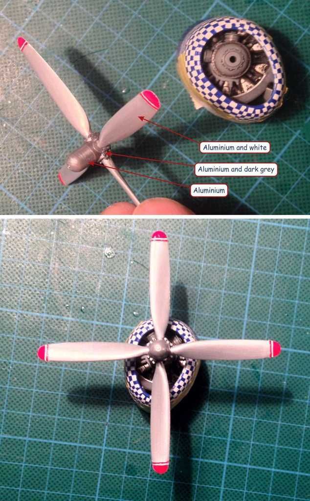

Caerbannog Posted March 18, 2016 Author Posted March 18, 2016 Small update. The engine was completed and installed in the cowling: The prop blades were sanded thinner and the prop was assembled (OK - it is just two pieces...): Rene 2

Basilisk Posted March 18, 2016 Posted March 18, 2016 Interesting build. And finally some work on the engine: I should really learn to check my reference when I build - I had he computer shut off and no pic of the engine so I build the ring and wires from memory which certainly differed from the real thing. I will however not correct it as the engine is deep in the cowling and not much more than a good impression is visible once assembled. This is what I will tell everybody. Next I will attached the wings which strangely need a bit of sanding or they will leave a small gap. Otherwise the fit of this kit is excellent and a real joy. I could already start thinking about painting but have to find a suitable place for this as my man cave is still in work - but I finally finished plastering the walls yesterday. Maybe I take chances and use a rattlecan outside. Rene Not only is the ignition cable assembly ring missing, but Tamiya also tells you to use the wrong distributor housing in the instruction! Here I changed them with the correct version which are as per your above picture of the real engine! Cheers, Peter 1
Caerbannog Posted March 18, 2016 Author Posted March 18, 2016 Thanks guys. Peter - were did you find the distributers? I realized that Tamiya instructs to use the wrong ones ("turtle type") and I thought the correct ones will be on the sprue with P-47M parts but found nothing there which looked like those in the picture. Or it was too late... Rene
Basilisk Posted March 18, 2016 Posted March 18, 2016 Hello Rene, The kit contains parts for the early and late R2800 engine including the early front part which does come with the ignition cable assembly ring which I added to the later front. The Tamiya M kit is basically the bubbletop D kit with extra parts for the M, so the correct distributor housing has to be on one of the M specific sprue. I read about this error in the instructions after I assembled the engine, but was still able to change it. Cheers, Peter 1
Caerbannog Posted March 18, 2016 Author Posted March 18, 2016 (edited) Peter I searched the trees right after work and did not find the parts. After your second mail above I decided to looked into my Razorback box in my stash - I was start thinking that I may have put some of the M parts in there. I finally found the parts on sprue C. That is the sprue which is two times in all of the P-47 boxes. I was looking for two parts but as it is on sprue C there is only one part on each of these two srues. The correct carburetor parts for the M engine are C 15. Thanks a lot for pointing this out Peter so I could correct this. I already dismantled the engine and will use C15 now. Pics will follow. Edit: Here is a pic of the revised engine: Regarding the drop tanks I pulled my F-82 Minicraft kit from the stash to double checked that the droptanks are not the 315 gal ones (knowing me I would find out after hundrets of hours work on my scratch tanks, that the Minicraft ones are a much better representation). Actually they are larger than the common 150 gal. tanks but not as large as 350 gal tanks must be. So I guess I have to continue the work on my scratchbuild ones. Again pics will follow. Rene Edited for the photos above and the typos caused by a malfuntioning laptop keyboard (I really need to replace it). Edited March 21, 2016 by Caerbannog 3

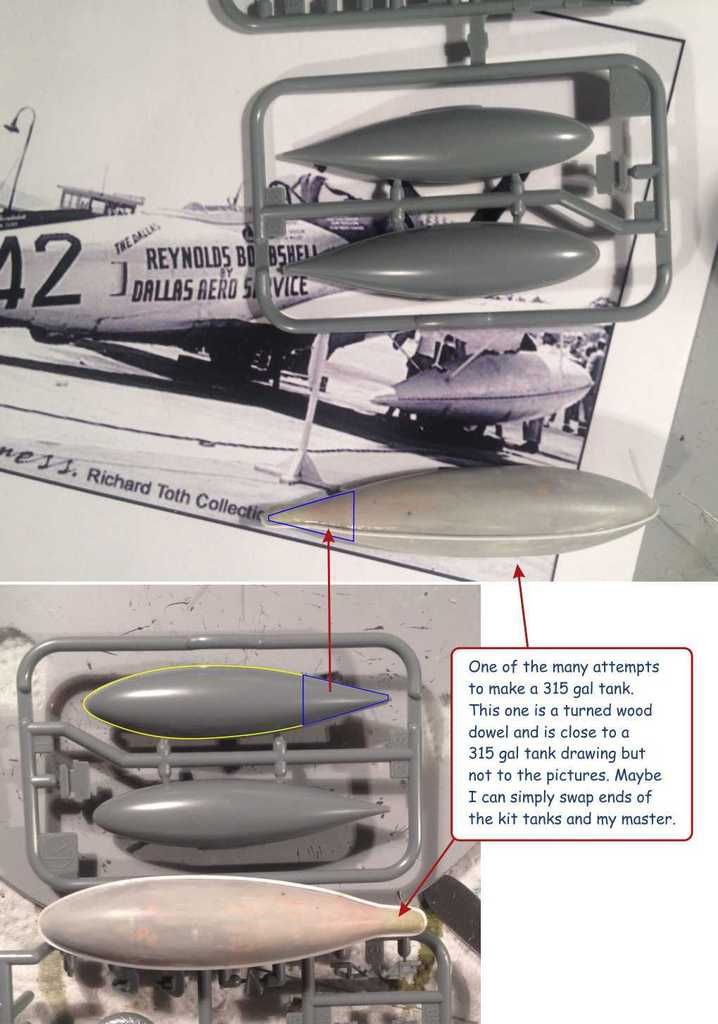

Caerbannog Posted March 23, 2016 Author Posted March 23, 2016 Went back to those tanks and followed my cunning plan: Thus encouraged I started to brush paint ( :shutup: :shutup: ) the fuselage in Tamiya flat white. Plastix shows such awsome results in metalic that I just said "what can possibly go wrong?". I am about to find out. If I spoil it I can still dig out my PaintKiller bottle. The reason to turn to the hairy stick is that my spray booth, airbush and so are still boxed because of my man-cave renovation. I fear I will not meet the dead line if I do not turn to desperate measures. While we are at it: Regarding the drop tank I will have to see wether I can cast it in resin as I found my RTV and resin to be a bit dated and I am not sure it will still work. I am also considering makeing a simply plaster mold for vacuforming - maybe this will be the better option anyway. So I will start with the plaster mold as this does not need further detailing on the master and after that I will check if a resin tank is still needed. Rene 2

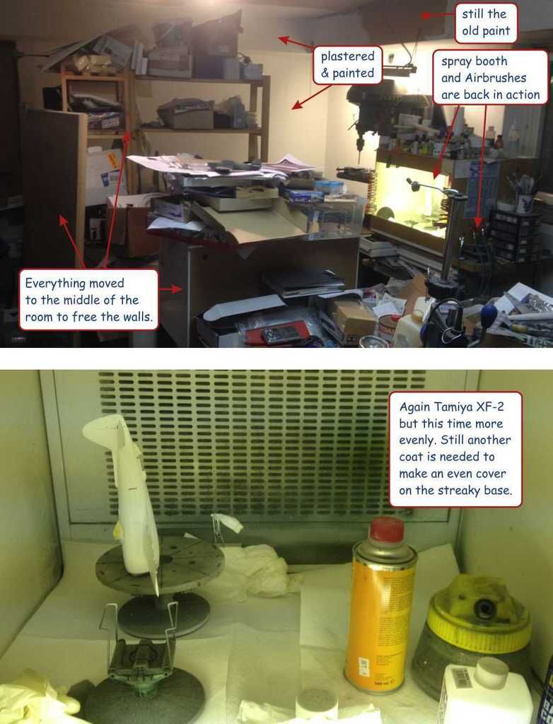

Caerbannog Posted March 30, 2016 Author Posted March 30, 2016 Thanks guys! I was looking to the paint as well Stix - but your brush painting skills are so much advanced... I have to say I failed - see below. Yes a card box and a rattle can were something I thought about Arnie - but I only have a white automototive paint which is a bit rough (I used it on a resin Sci-Fi kit last year) and if it went wrong it would be hard to remove so I chickend out. Would not be the first model I spoiled with the quick and easy solution No problem Rich - with so many entries I bet it is easy to miss some. AFAIK it is the only Thunderbold that was to be used as a racer as the common P-47 is a bit on the heavy side I assume. Well in the end even this never raced. Regarding the drop tanks I currently went the resin route as my tests with the RTV and my resin showed that both still work. So I cut very thin stripes of Tamiya tape to mark the datum of my tank master. Then I build a LEGO frame for the mold, pushed some modelling clay inside. Added the master so the datum tape was horizontal and filled with clay till the datum tape - so half of the tank was buried in clay. I then poured RTV over the other half of the tank. After the RTV set I removed it from the mould and filled it with resin: The removed resin tank half are sanded down to the datum, filled and sanded by now. Two halfs will be glued to thin plastic sheet and then this sheet will be sanded to follow the shape of the tank cross section plus 1 mm to represent the joint of the real thing. Then the second half will be glued to the sheet. This will be shown in the next post I guess. My brush painting efforts were to no avail (but at least I tried...): As this became obvious I decided to speed up my work in the man cave and get my spray booth and airbrushes to work: There is still a lot of furniture-Tetris ahead of me as the space is quite limited with all shelfs, etc. in the middle of the room. Still it looks a whole lot better already with the reworked walls and the remaining work is less dusty and over all nicer. Soon there will be a workplace agian. Thanks for looking. René 1

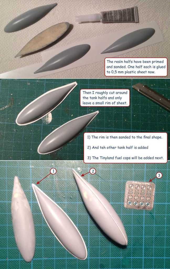

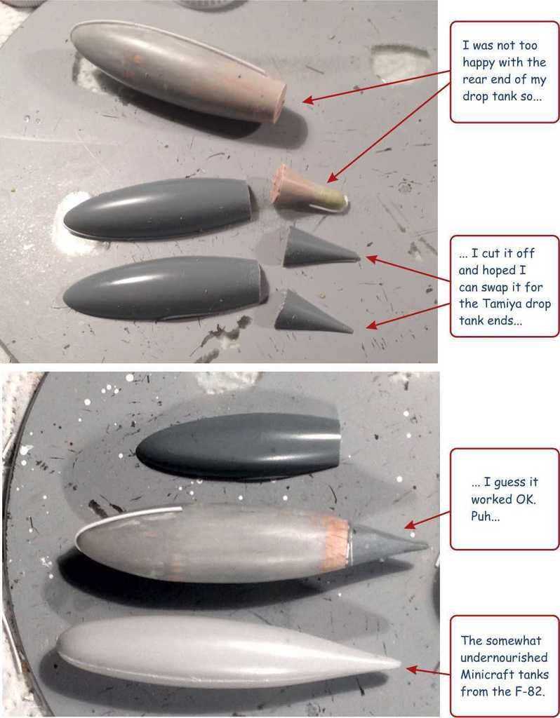

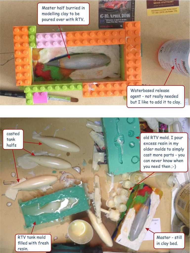

Caerbannog Posted March 31, 2016 Author Posted March 31, 2016 Thanks Stix. I once bought 4 bottles of Tamiya white because I read somewhere that it is one of the best covering whites in the market. Mind you this may be 6 or 7 years ago. It works OK with the airbrush but even then I guess there must be something better available. Next time I will use a white primer first. The drop tanks take shape. I primed and sanded the cast parts, glued one half each to sheet and sanded the sheet to shape. Then I glued the other resin half to the sheet as well. I found this easier for aligning than to add both resin halfs before shapeing the sheet: One tank is now assembled, but I found one resin piece to be still soft in places and I casted another one this morning as a replacement. Once this is in place I will add the etch filler cap parts and paint the tanks aluminium. Regarding the colour I am a bit uncertain. The tanks seem to be NMF, which makes sense as these would be dropped during the race. So why invest? On some pictures they also look to be dull aluminium but on others they could also be white. To add to my confusion the rim around the tanks where the two shells are rivited together seem to be painted a dark colour (red or blue?) - I first though this would be just a shadow but I am not sure now. However I decided to go with NMF dull aluminium for now. In the mean time I also finished the prop. I was brush painted with Revell Aqua Aluminium. Next time I will do such jobs with the airbrush again. It is OK but you can see some brush strokes and the paint build up where the masking tape was is a bit heavy (although I saned it down). To mimic the various metals I just mixed white or dark grey to the aluminum colour: And finally a pic of the flat white Bombshell. After another sanding with polishing cloth I will give it a gloss coat before I add dark blue to the front and red to the tail and tips: Because of some birthday parties the next days my next update will be after the weekend I suppose. Thanks for looking, René 2
