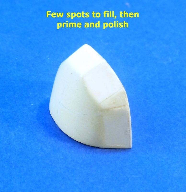

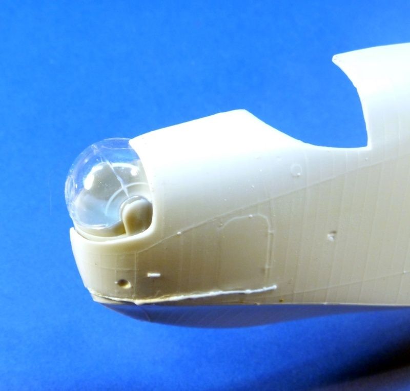

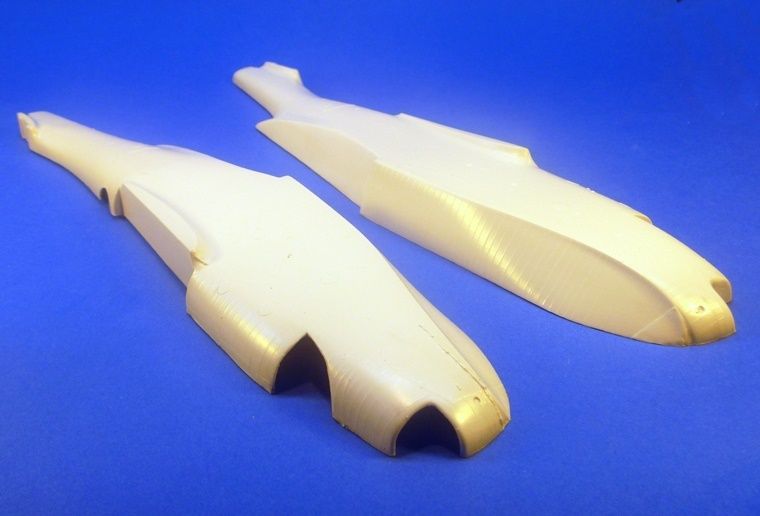

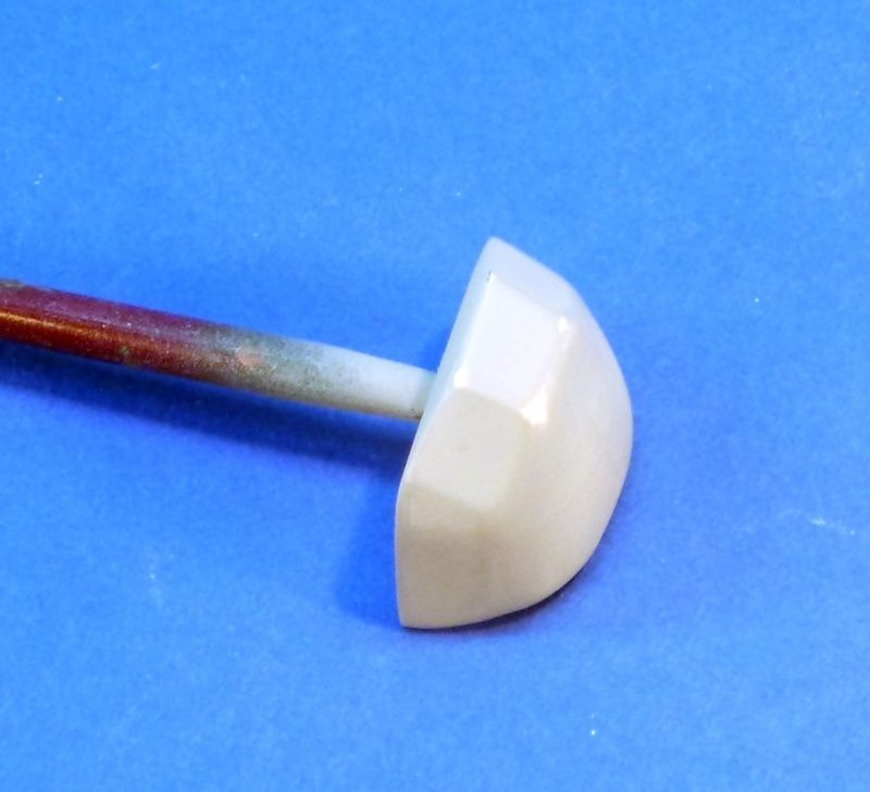

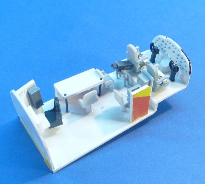

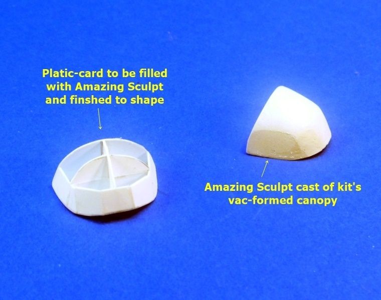

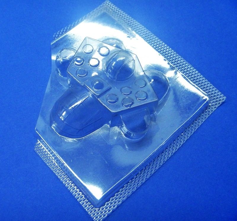

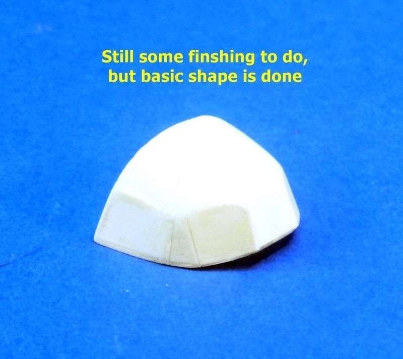

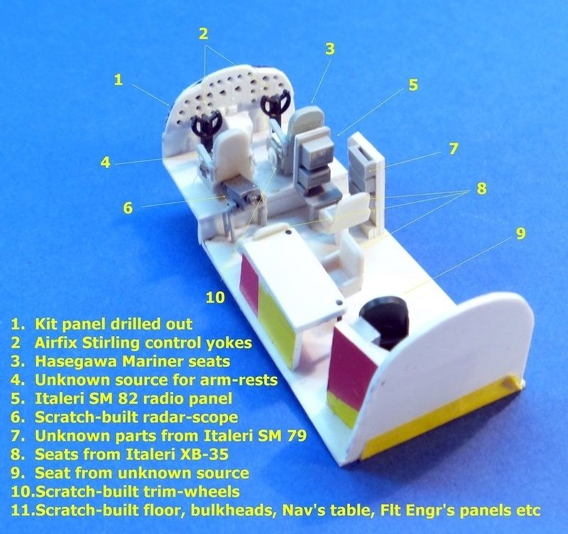

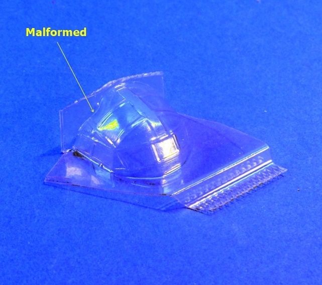

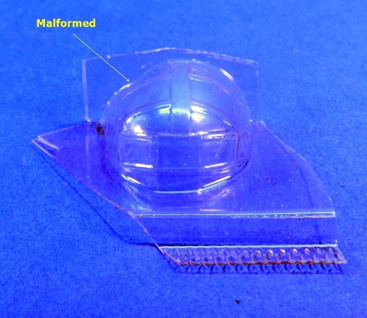

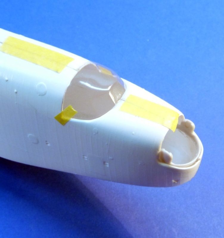

Kiwikitbasher Posted February 18, 2016 Share Posted February 18, 2016 (edited) I've joined in a Gordon Stevens Memorial Group Build over on HyeprScale with what will be my first attempt at a vac-build. Just to complicate matters I plan to use a Red Roo Mariner GR.1 conversion set intended for the Minicraft kit, plus the gun turrets from the Minicraft kit (Ed Russell of Red Roo gave me the turrets when I found out he was converting his Minicraft kit to an RAAF PBM-3 transport without turrets). For details of the Red Roo Mariner GR.1 set see my in-box review:http://www.hyperscale.com/2014/reviews/accessories/redroorrr7251reviewmd_1.htm Being new to this vac-form lark I'm off to a slow start. I must admit Rareplanes' plastic seems nice enough to work with so far. There are some shape and dimensional differences compared with the Minicraft PBM, so I anticipate a some dramas when I come to use the Minicraft turrets (especially with the nose one). I only noticed that the cockpit canopy was quite misshapen and malformed after cutting it from its backing sheet in preparation for trimming: I tried using the vac canopy as a mold for an Amazing Sculpt (like Milliput) master, but was none too happy. Besides, the kit canopy is not that good to begin with, if you're used to canopies by Falcon like me.So I decided to scratch-build a canopy master in order to better achieve the faceted effect of the lower clear panels, and would match Rareplanes' slightly inaccurate (IMO) overly curved shape using Amazing Sculpt for the top panels. I hope to plunge mold a new canopy over the weekend when I've sanded the Amazing Sculpt to shape and polished the master up. After basic filing and sanding down to plastic-card forms: I have a usable canopy after my third molding attempt. I would like to do one in thicker material, but I need to source something suitable as the scrap packaging I was using is a bit thin. But I have proof of concept, so work on the Mariner can resume now I know I have a workable canopy solution. Not a lot of progress. I made a representative flight-deck based on photos,cutaway drawings and the Minicraft kit. It's enough to convey the "flavour" of a PBM's flight-crew stations given the little that will be visible. I also cut out the portholes and windows which will be glazed with clear styrene sheet punched out and cut to fit respectively: Edited February 21, 2016 by Kiwikitbasher 16 Link to comment Share on other sites More sharing options...

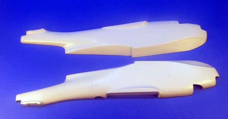

Brandy Posted February 20, 2016 Share Posted February 20, 2016 Nice start! Do you know which of the 2 (Rareplanes or Minicraft) is actually the more accurate re the shape and dimensions? Ian Link to comment Share on other sites More sharing options...
Kiwikitbasher Posted February 20, 2016 Author Share Posted February 20, 2016 I'll tag along with this too, as I have a Meteor F8 ongoing, although it will be pretty basic compared to this. Different type of modelling altogether. Amazing cockpit.... Thanks Sean, I kept the cockpit fairly basic as not much will be seen, but I do still need to make and overhead console with throttle controls etc. 1 Link to comment Share on other sites More sharing options...

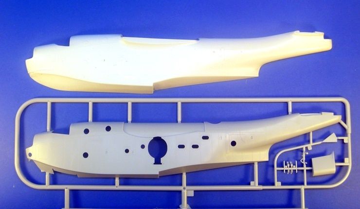

Kiwikitbasher Posted February 20, 2016 Author Share Posted February 20, 2016 Nice start! Do you know which of the 2 (Rareplanes or Minicraft) is actually the more accurate re the shape and dimensions? Ian Thanks Ian, I don't know which is more accurate, but I differences have noted so far are: 1. Minicraft is longer in the rear fuselage. 2. Mincraft has a longer vertical section from the end of the planing hull to the beginning of the rear fuselage. 3. Mincraft cockpit canopy is a lot less rounded in both plan and profile. 4. Mincraft is shallower in the fuselage where the nose and especially the tail turrets sit. 5 Minicraft has a shallower up-sweep to the chine. At glance, I think Mincraft is better possibly 3, also 5, but less accurate on 1,2 & 4. Link to comment Share on other sites More sharing options...

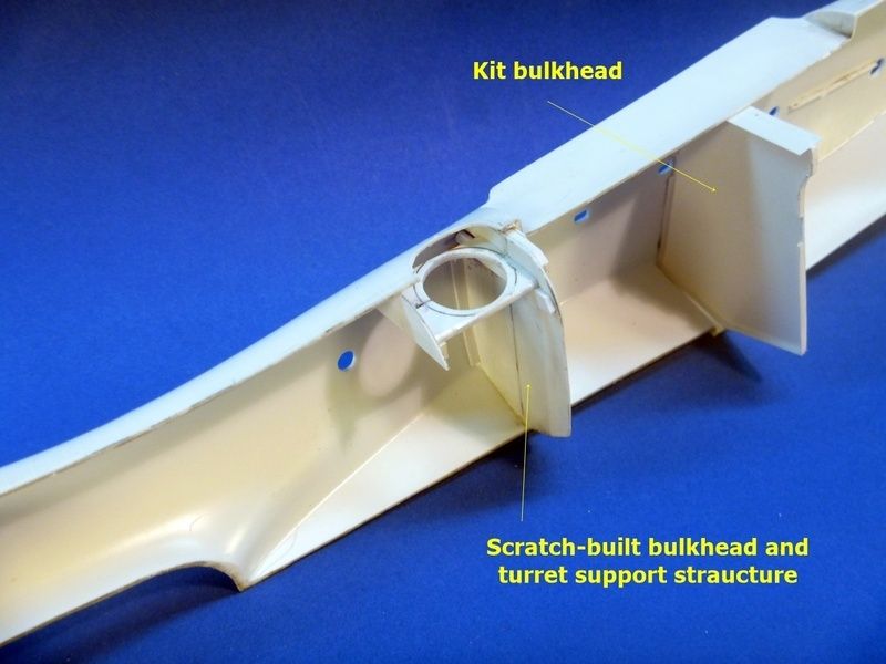

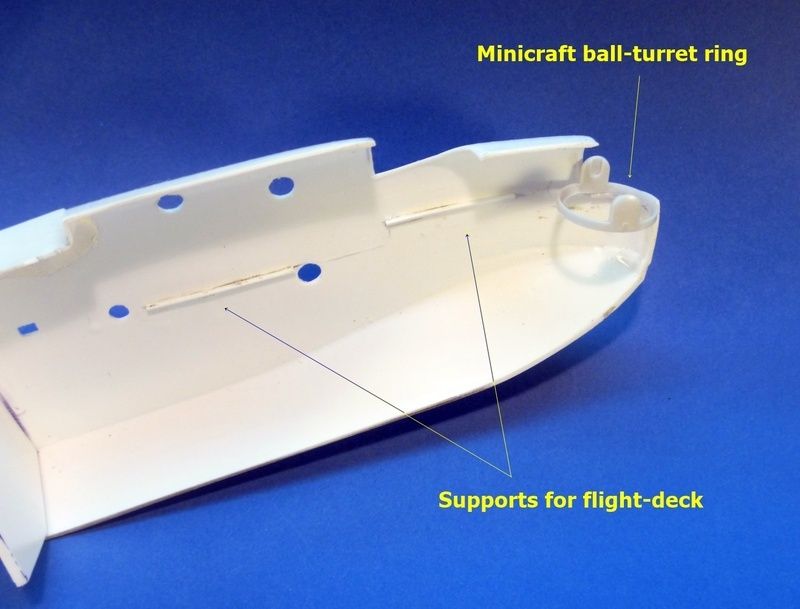

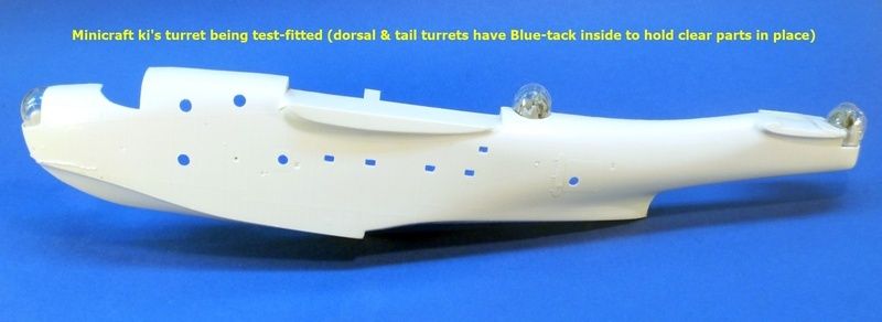

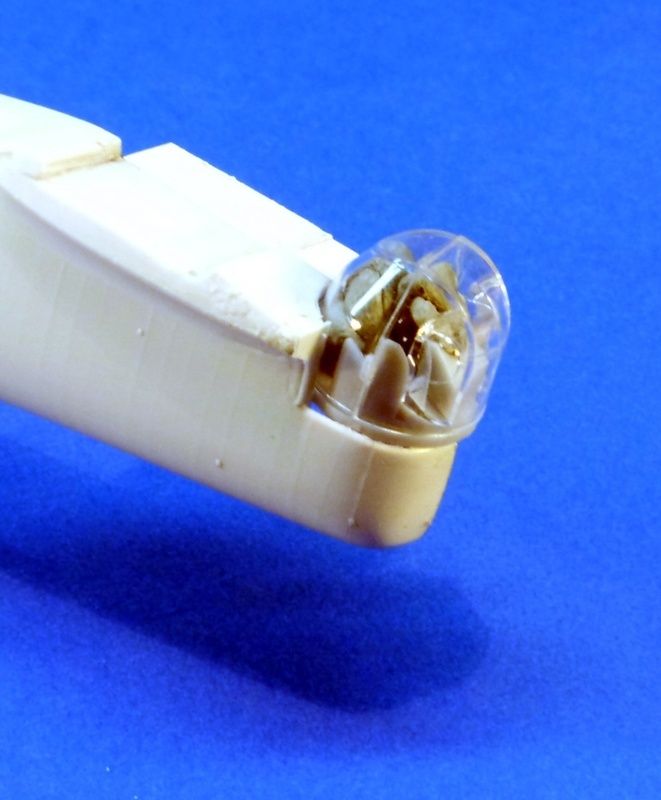

Kiwikitbasher Posted February 20, 2016 Author Share Posted February 20, 2016 (edited) Part 6, Turret test-fitting... The Minicraft turrets Ed Russell sent me were a good fit after some adjustment of the Rareplane fuselage. This was necessary in the main because the vac kit's turrets were not fully formed and rotatable; instead being simple butt-fit items. Edited February 21, 2016 by Kiwikitbasher 4 Link to comment Share on other sites More sharing options...

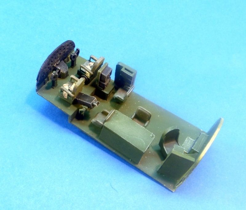

Kiwikitbasher Posted February 21, 2016 Author Share Posted February 21, 2016 PBM Mariner - Part 7, Cockpit painted and some parts cut out.... A little more progress (forgot to blow the plastic dust off the cockpit floor)... It's coming together rather quickly, those turrets look pretty good in there Thanks Woody. 4 Link to comment Share on other sites More sharing options...
