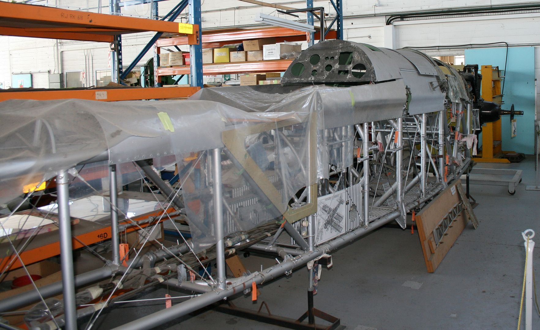

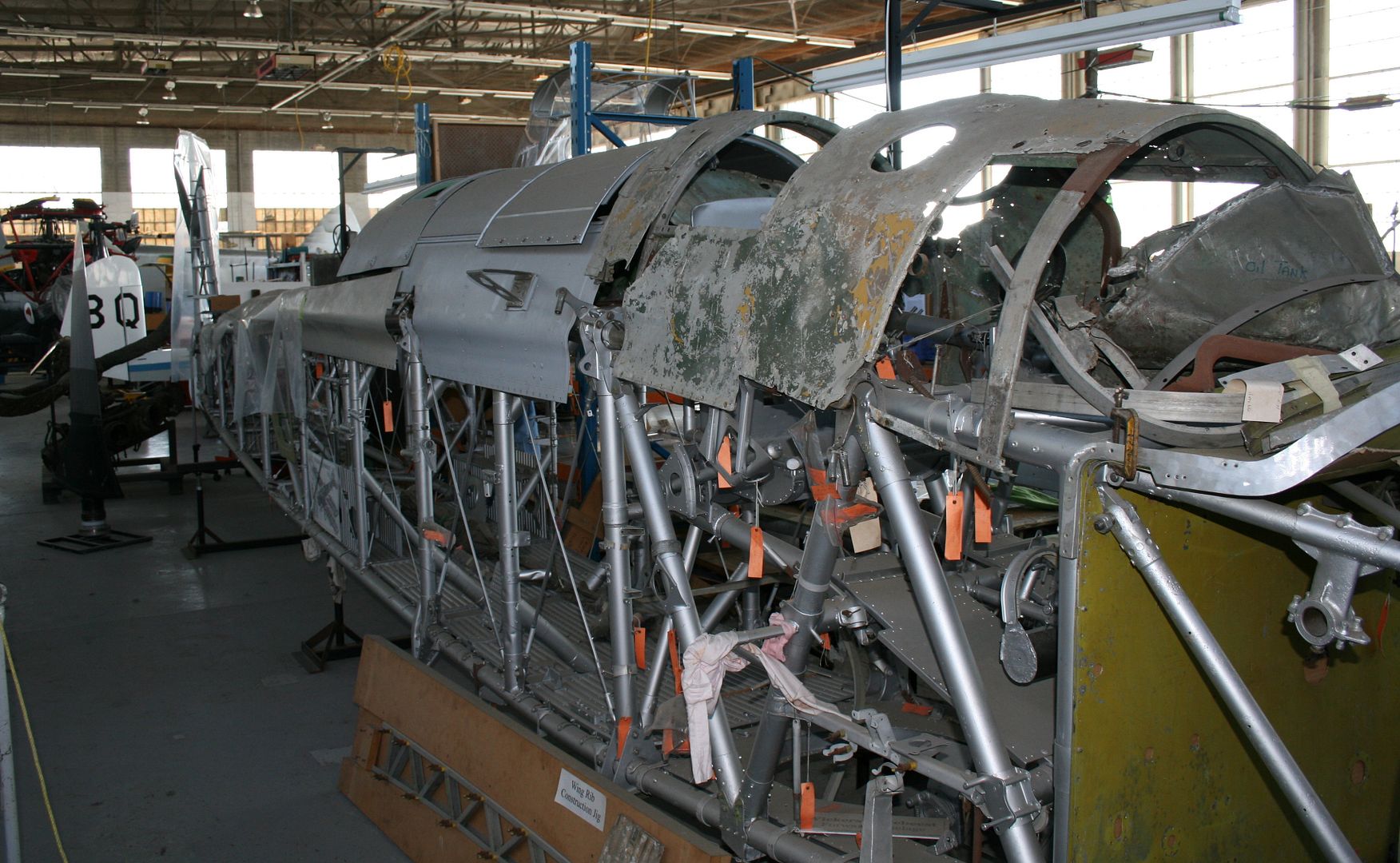

Wow, they are rebuilding a Vildebeest somewhere ?
Or is it a Vincent ?
Share this post
Link to post
I'll be visiting Dairy Flat on Saturday - do you have any Vincent picture requests?
I think John's photos are of the RNZAF Museum's example at Wigram, but I may be mistaken.
Share this post
Link to post
Hi Occa. The pictures John has posted are the Vildebeest that the Air Force Museum at Wigram in Christchurch, New Zealand are re-building.
The Vincent is the one at Dairy Flat here in Auckland that is being re-built by the Subritsky family. I thought I'd posted a series of photos of it here on Britmodeller, but can't find it in the walkarounds section.
