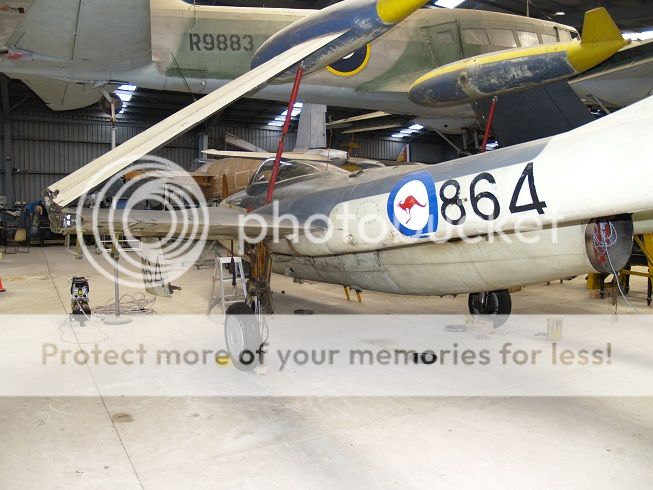

NAVY870 Posted May 29, 2016 Share Posted May 29, 2016 Wing fold jury strut correctly installed (like I'd do it any other way) is 1470mm in length. The wings folded are 1855mm between the widest point of the tip tank. I shan't say anymore as you lot are of your bonces. I knew Hale was but I'm quite surprised at the rest of you! 3 Link to comment Share on other sites More sharing options...

Navy Bird Posted May 30, 2016 Author Share Posted May 30, 2016 On 5/29/2016 at 03:02, NAVY870 said: Wing fold jury strut correctly installed (like I'd do it any other way) is 1470mm in length. The wings folded are 1855mm between the widest point of the tip tank.  Thanks for taking the time to measure this. I went back to the kit struts, and if I measure the length of the area that remains visible (not including the pegs that go into the receptacles on the fuselage and wing) the length is 19mm, or 1368mm in real life. Based on your measurements, they should be approximately 20.5mm. So the struts supplied in the kit are short by about 1.5mm which doesn't seem like a whole lot. However, it's not possible to use the kit struts AND achieve your tank spacing of 1855mm (25.8mm at scale). They'll end up much closer than that. So I have some more questions!  Looking from the front or rear end, do the struts appear to be vertical, or slightly leaning in at the top? Have a look at these two photos:    I know that the struts lean backwards at the top when viewed from the side:   This next photo shows the struts leaning backwards at the top, and the right and left hand struts appearing parallel - which would mean that they are pretty close to vertical when viewed from the front (you need to think in 3-D space to visualize this one!):   In that last photo, the attachment point for the bottom of the strut appears to be just inboard of the boom fairing. On the kit, it is centered on the boom fairing. Which is right for my subject?  My plan of attack is to have jury struts that are approximately vertical (or slightly leaning in at the top) when viewed from the front, and see how close I can get to a spacing of 25.8mm between the widest part of the tanks. It will be interesting to see how long the struts turn out. Stay tuned!  Cheers, Bill  PS. Steve, you are absolutely correct about the canopy. I wish you hadn't mentioned that, it will now haunt me for the rest of my days! 1 Link to comment Share on other sites More sharing options...

NAVY870 Posted June 2, 2016 Share Posted June 2, 2016 Thanks for taking the time to measure this. I went back to the kit struts, and if I measure the length of the area that remains visible (not including the pegs that go into the receptacles on the fuselage and wing) the length is 19mm, or 1368mm in real life. Based on your measurements, they should be approximately 20.5mm. So the struts supplied in the kit are short by about 1.5mm which doesn't seem like a whole lot. However, it's not possible to use the kit struts AND achieve your tank spacing of 1855mm (25.8mm at scale). They'll end up much closer than that. So I have some more questions! Looking from the front or rear end, do the struts appear to be vertical, or slightly leaning in at the top? Have a look at these two photos: I know that the struts lean backwards at the top when viewed from the side: This next photo shows the struts leaning backwards at the top, and the right and left hand struts appearing parallel - which would mean that they are pretty close to vertical when viewed from the front (you need to think in 3-D space to visualize this one!): In that last photo, the attachment point for the bottom of the strut appears to be just inboard of the boom fairing. On the kit, it is centered on the boom fairing. Which is right for my subject? My plan of attack is to have jury struts that are approximately vertical (or slightly leaning in at the top) when viewed from the front, and see how close I can get to a spacing of 25.8mm between the widest part of the tanks. It will be interesting to see how long the struts turn out. Stay tuned! Cheers, Bill PS. Steve, you are absolutely correct about the canopy. I wish you hadn't mentioned that, it will now haunt me for the rest of my days! Just for giggles WZ.907 - My photo WZ.901 -Moorabbin air museum WZ.901 - again WZ-939. Classic Jets at Parafield, up for sale at the moment. 1 Link to comment Share on other sites More sharing options...
