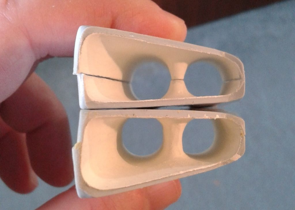

Mark4700 Posted February 24, 2016 Author Share Posted February 24, 2016 (edited) I've got bored with scribing and sanding and scribing and sanding. Needed a new direction for a while so I've decided to tackle the intakes. So far I've took the flashing off and that's about it. I'm going to sand them and get as good a fit as I can before gluing them and filling and sanding them some more. I know I could have gone out and bought an after market set, but I love a challenge. Ā Edited August 14, 2017 by Mark4700 Link to comment Share on other sites More sharing options...

CurrantBunbury Posted February 24, 2016 Share Posted February 24, 2016 You've reminded me of a problem I had with the tail section when I built mine, so I thought I'd share the thread in case there's anything you find useful: http://www.britmodeller.com/forums/index.php?/topic/234988253-vulcan-tail-problems/?hl=%2Bvulcan+%2Btail+%2Bproblems I'm a less experienced and less skilled modeller than you, but I think all information is worth having. Those intakes are a challenge, but a satisfying one: The centre bits should be a good deal thinner than that - that was as far as I could bring myself to go - but it does show up the difference a bit of filling and sanding will make. 3 Link to comment Share on other sites More sharing options...
Mark4700 Posted February 24, 2016 Author Share Posted February 24, 2016 I'm a less experienced and less skilled modeller than you, but I think all information is worth having. You flatter me too much. I look at the posts on this site and just hope I can get close to some of the finishes, and on lots of occasions I am amazed by the talents on show. Your intakes are superbly done, something for me to aim for. Thanks for your comments and sharing the thread. Very useful. Link to comment Share on other sites More sharing options...
