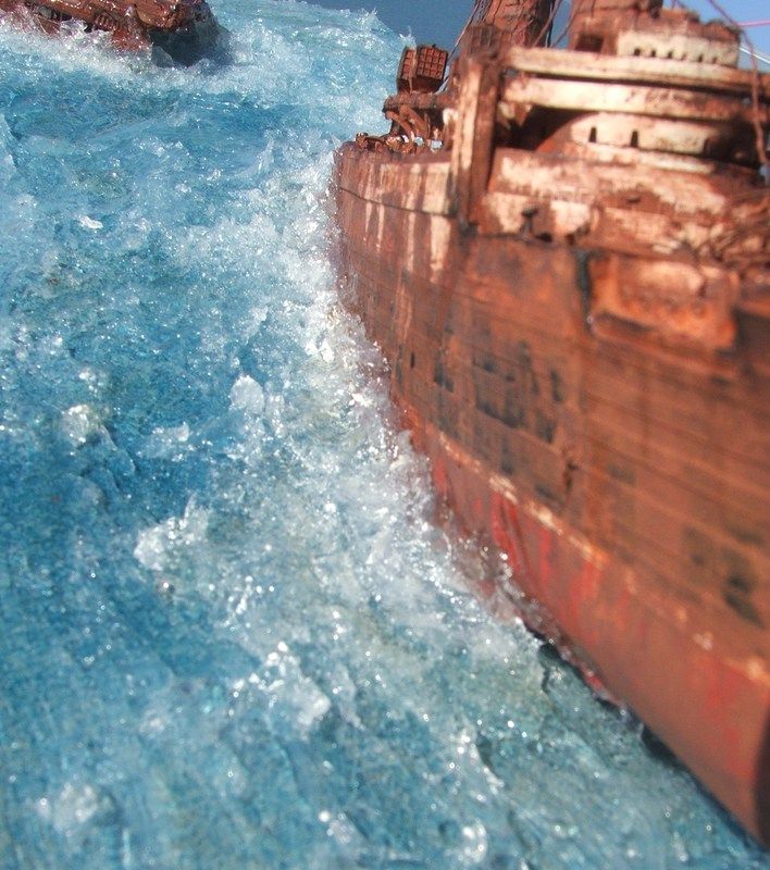

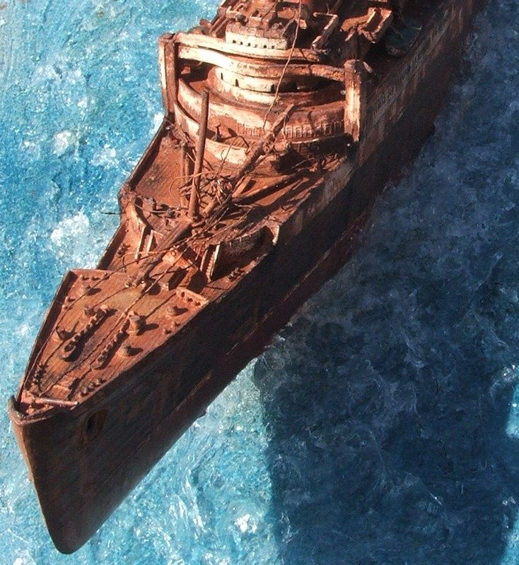

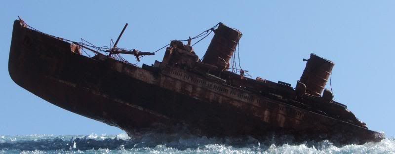

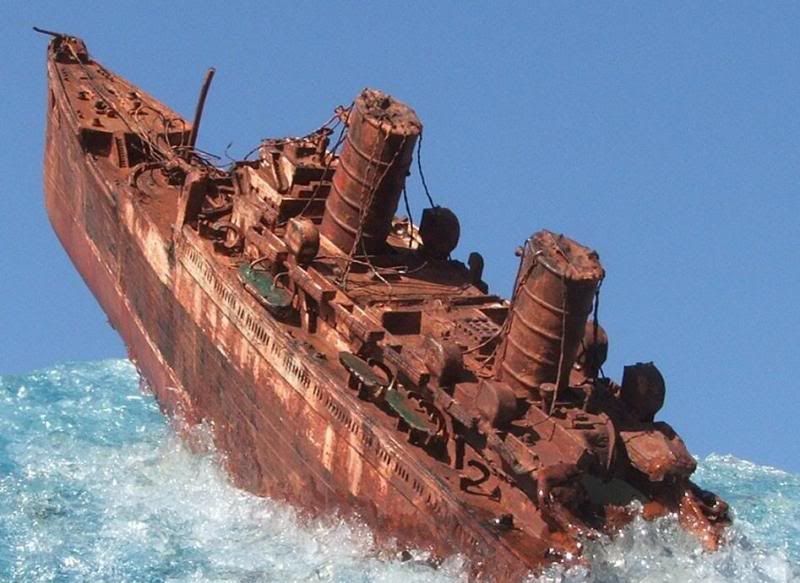

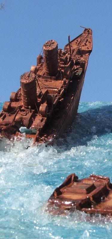

eddiesolo Posted December 18, 2015 Share Posted December 18, 2015 (edited) I got this part built model of a liner to redo but it was too far gone to get it back to its former glory. I ended up using it as a rusting techniques test piece. Si:) Edited December 18, 2015 by eddiesolo 28 Link to comment Share on other sites More sharing options...

sinnerboy Posted December 18, 2015 Share Posted December 18, 2015 wow! please share, how did you create the rust and the water effects? 1 Link to comment Share on other sites More sharing options...
eddiesolo Posted December 18, 2015 Author Share Posted December 18, 2015 wow! please share, how did you create the rust and the water effects? Firstly, many thanks glad you like it. Right the effects. The model was painted in the normal colours. Then it was distressed by hacking apart, lines were added and glued. Once the paint had dried it was sealed using a matt varnish. I then made a mix using three rust pigments: Rail rust, old rust and new rust. Once I got the look I applied using pigment fixer and a fine soft brush. To create the streaks I used a Q-tip with some more pigment fixer to remove and drag-this shows the paintwork underneath but more rusty. The base and water is just a piece of ply with a spray coating of metallic blue, once dry the model was positioned and stuck down using silicon sealant. The rest is just clear sealant applied using a tea spoon to create the swirls and peaks, around the model to create the more rough looking water you use a brush dipped in cold water and then agitate the sealant, it produces the more 'frothy' look. The other water effects are just some water effect gel, warmed up and brushed on to give a more wet uniform look against the model sides etc. Hope this helps. Si:) 5 Link to comment Share on other sites More sharing options...
