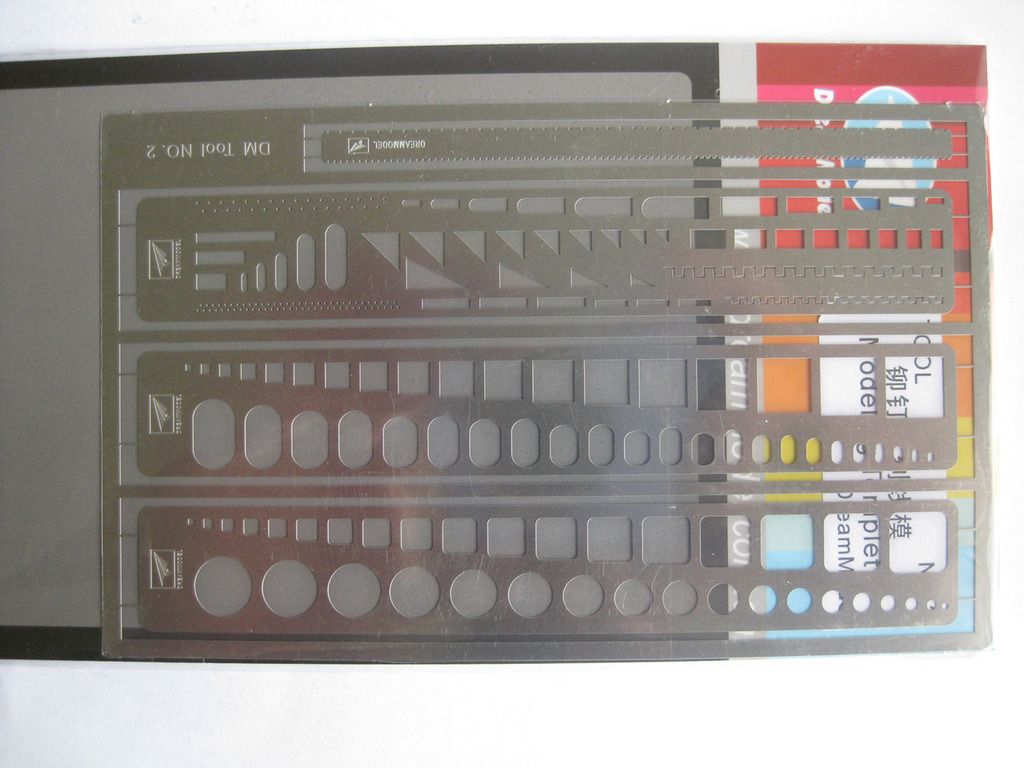

Mike Posted December 13, 2015 Share Posted December 13, 2015 aboard Allan. Good luck with the Tornado With PE, you need to get yourself a few tools, such as a hard surface for cutting the parts from the fret, needle files or sanding sticks to remove the sharp "sprue gates", and a folding jig (bending brake), of which there are a few types available. Radu Brinzan does one in PE, Trumpeter and The Small Shop and others do the flat jigs with "fingers" that hold down the PE while you bend them with razor blades, and Tamiya do a flat-bladed pair of pliers that are marketed as a PE bending tool. Any flat bladed pliers would do the job, but these ones have extra length to the blades, so you can bend 2" at a time. There are also rolling devices that are very handy for, well... rolling PE up Hope that helps a bit Link to comment Share on other sites More sharing options...

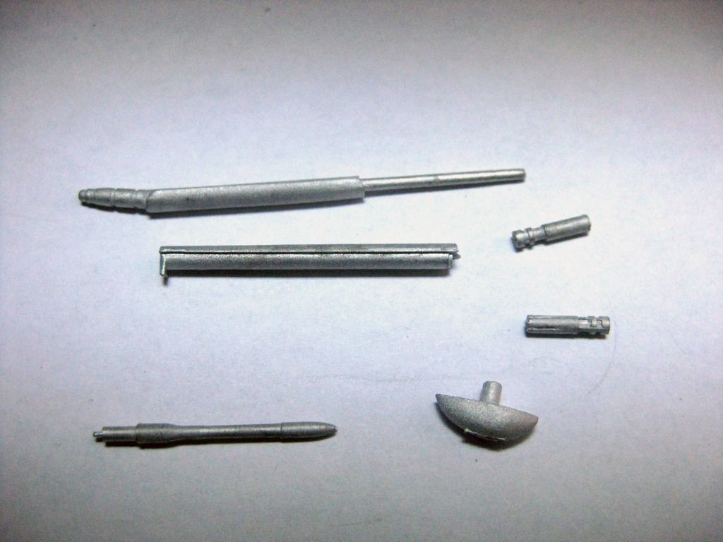

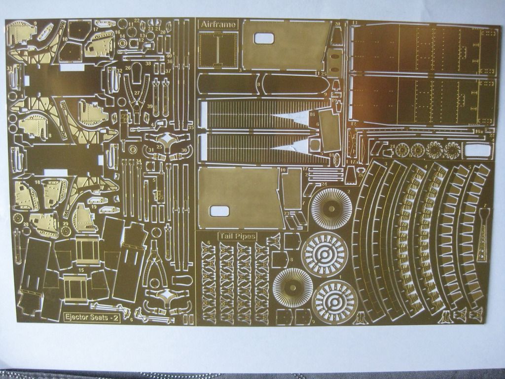

taffallan Posted December 26, 2015 Author Share Posted December 26, 2015 Flightpath detail set sheet 1 Ejector seats, tailpipes, various panels for airframe including wing sweep seal and top of intakes. Flightpath detail set sheet 2 Access ladder and cockpit detailing. Flightpath detail set sheet 3 Boz, air brake bay and front U/C bay Cockpit dials overlay. As well as the PE sheets above there are a number of other items in this set as follows. Wheels and pylons including option of two shoulder rails Front nose wheel metal Seat metal parts to add to kit seats Refuel probe detail Not too sure what this is I think it is a GR4 piece. Anyone advise please. Link to comment Share on other sites More sharing options...

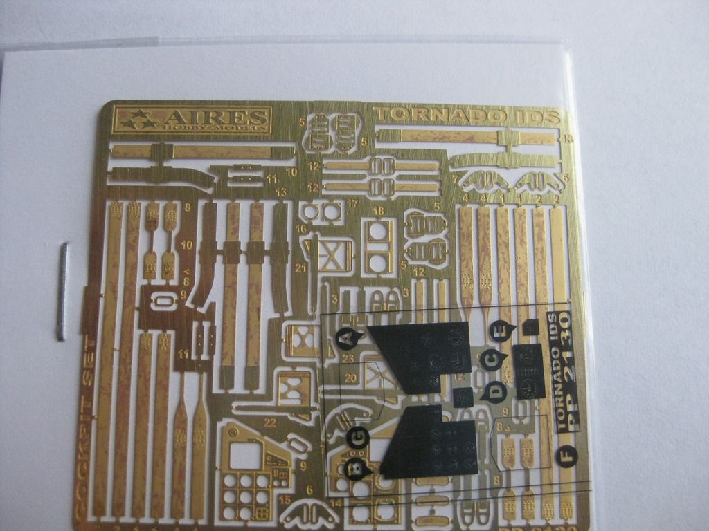

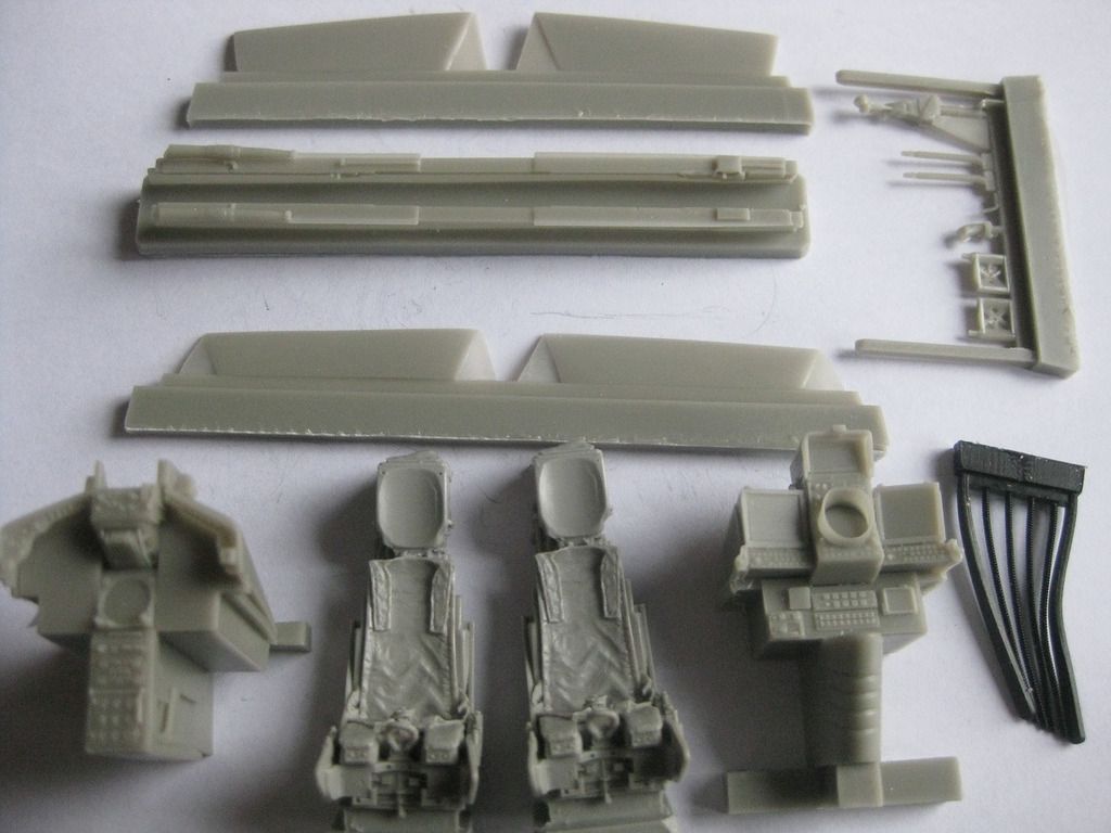

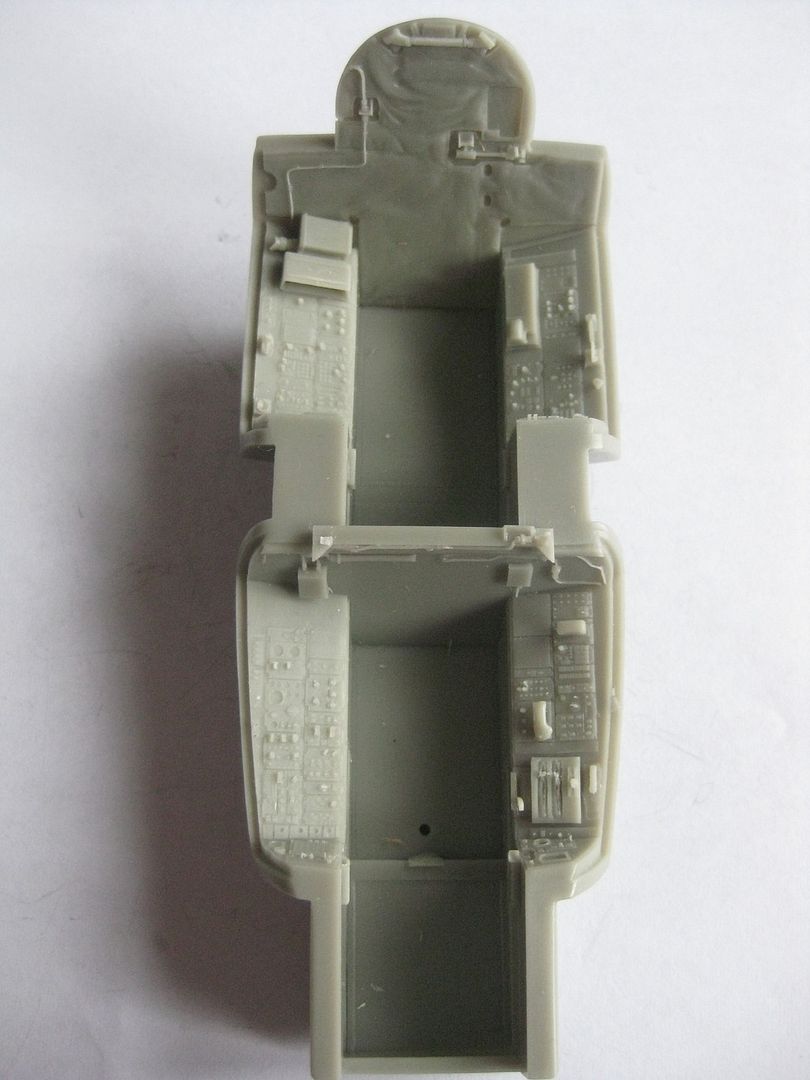

taffallan Posted December 26, 2015 Author Share Posted December 26, 2015 The next set of pics are of the Aires cockpit set. Cockpit tub Cockpit details and seats PE straps for seats and overlay for cockpit dials, this is different from the overlay in the detail set not sure if either is better or more accurate than the other, will let you know. Link to comment Share on other sites More sharing options...

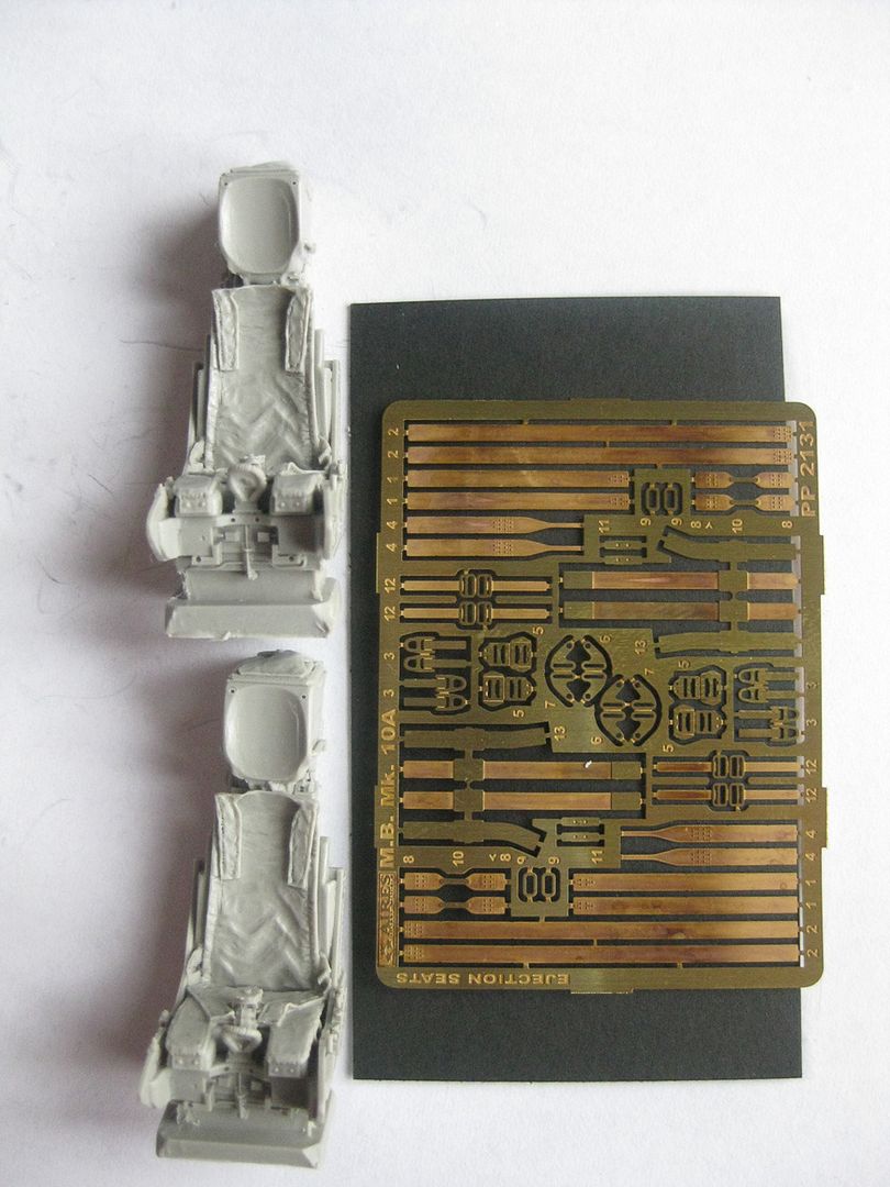

taffallan Posted December 26, 2015 Author Share Posted December 26, 2015 The next set is the Aires ejection seat set, the eagle eyed among you have noticed that the seats are included in the cockpit set and details for the seat are in the detail set so definitely overkill with this set it is not required. i am planning a 1/32 Hawk so will have these for that model. Nice detail in the seats but exactly the same as the cockpit set. Link to comment Share on other sites More sharing options...

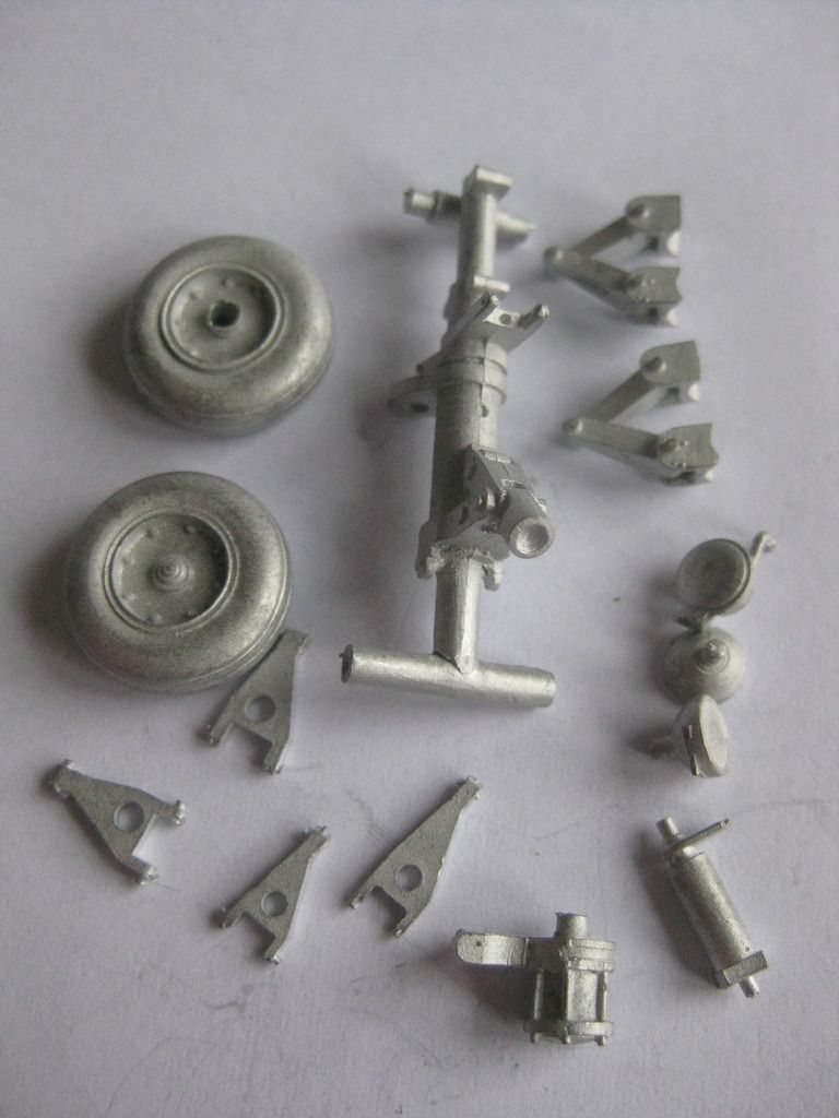

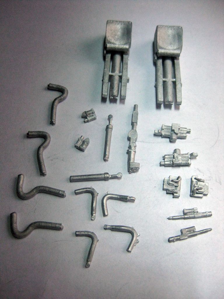

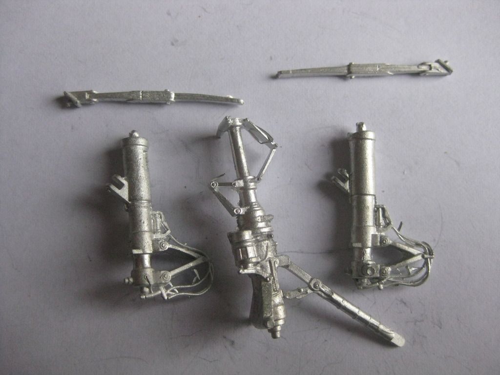

taffallan Posted December 26, 2015 Author Share Posted December 26, 2015 This is the U/C set from SAC. Useful because with all the add on's this model will be heavy! Link to comment Share on other sites More sharing options...

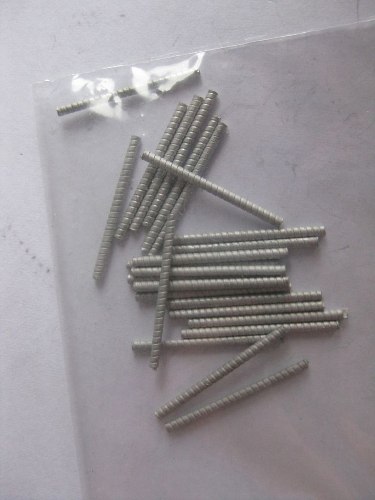

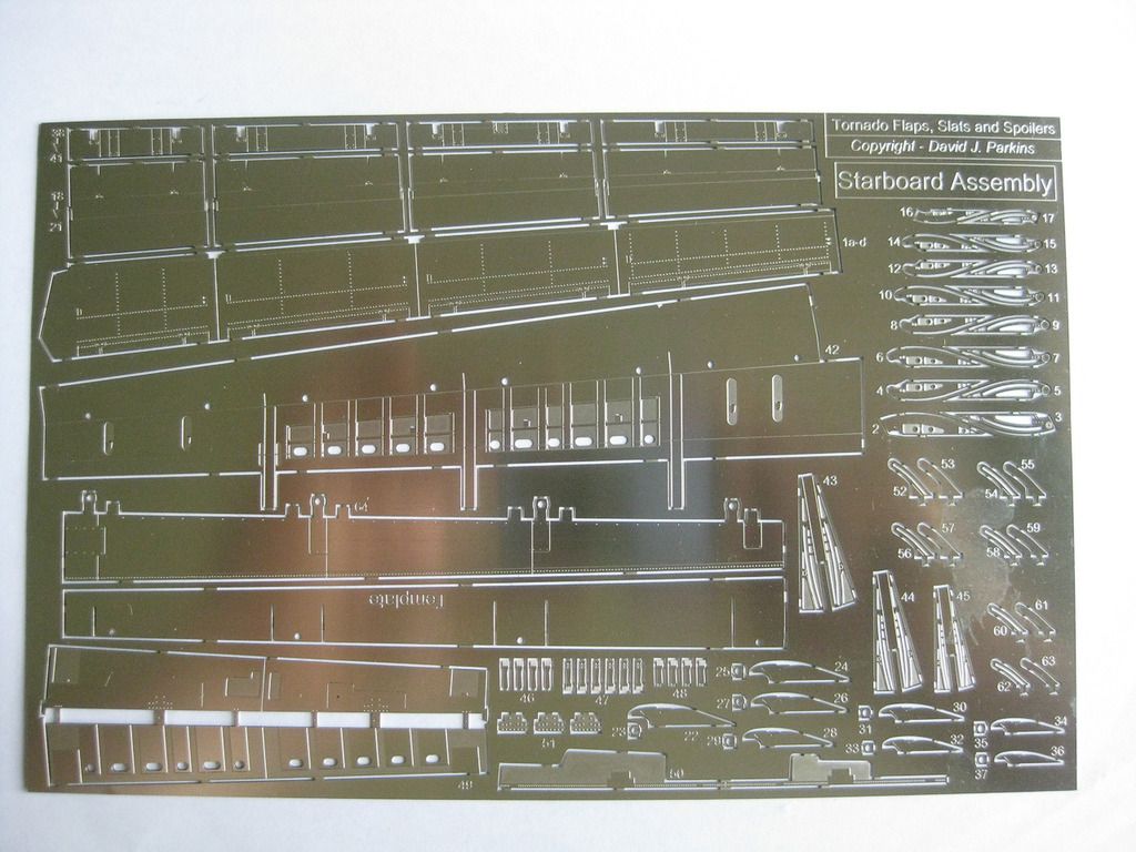

taffallan Posted December 26, 2015 Author Share Posted December 26, 2015 The last set is the Flightpath flap and slat set very scary lots of work I have not soldered for years so this will be fun! These are the worm drives to be used with above Link to comment Share on other sites More sharing options...

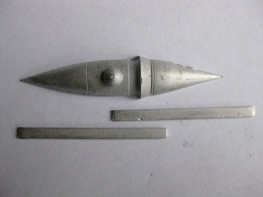

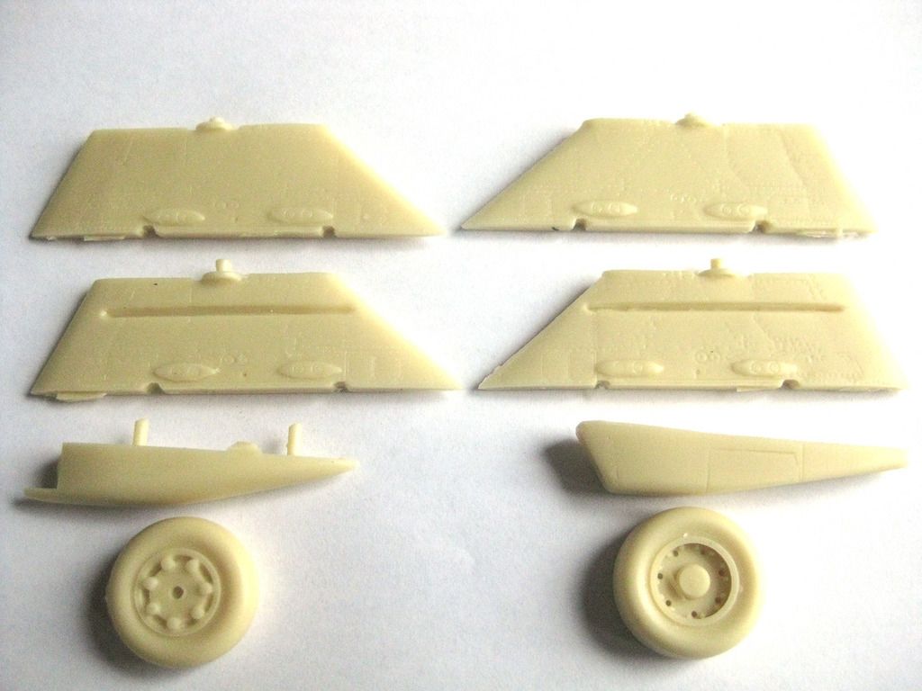

Richard E Posted December 26, 2015 Share Posted December 26, 2015 (edited) Not too sure what this is I think it is a GR4 piece. Anyone advise please.[/quote/]Not from a GR4 as such, it's the under fuselage IRLS (Infra Red Line Scan) camera fairing for the Tornado GR1A/GR4A reconnaissance variants which were mainly operated by 2 and 13 Squadrons. I haven't seen the Flightpath set but you'll probably find two photoetch windows which also need to be fitted the forward fuselage if you plan to build this version.The only aftermarket Tornado electronics bay I can think of if the one included in Verlinden's 1/72nd scale detail set together an open cannon bay. Edited December 26, 2015 by Richard E 1 Link to comment Share on other sites More sharing options...

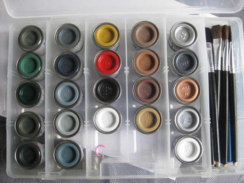

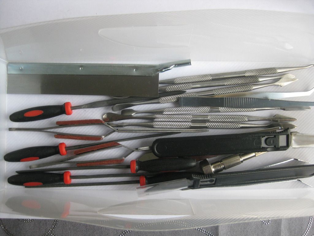

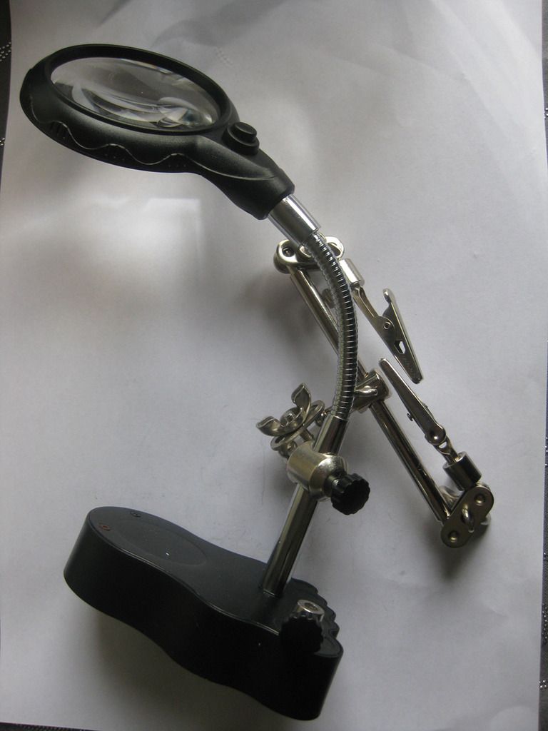

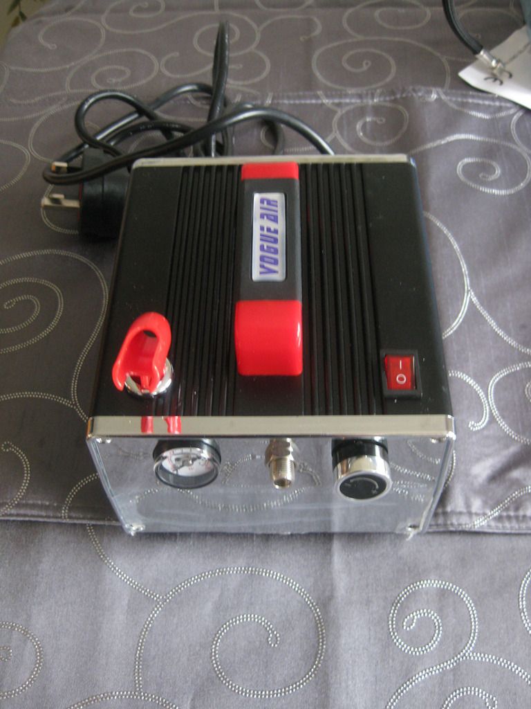

taffallan Posted December 26, 2015 Author Share Posted December 26, 2015 On top of the above this is the base kit which I had to get from Poland as there seems to be a shortage of these kits in the UK. I bought a compressor and air brush from Rutland's (link at bottom) for £49.00 on offer it seems to run OK and the brush is a two stage with a .3 needle. Not had chance to use them will update soon. Also bought a load of tools and paints, still waiting for some stuff such as acrylic paints and thinners but most of the stuff shown here. Got the stencil from china arrived in 8 days! Really impressed. I thought I would add all this up, (do not tell the wife) Base kit £54 All Detail kits about £145 Paints glue thinners etc. £105 Tools and stuff about £45 Compressor and airbrush £49 All together about £400 that was a shock for me!! Had not counted it all up before, keep in mind much of this is for ever and will be used on other kits. So after all this I really need to do this properly. I expect it to take some time and I am going to have to learn some techniques from scratch, such as airbrushing and soldering. I will keep you all up to date. If any other newbies want further info please ask and I will help all I can. http://www.rutlands.co.uk/ Link to comment Share on other sites More sharing options...
