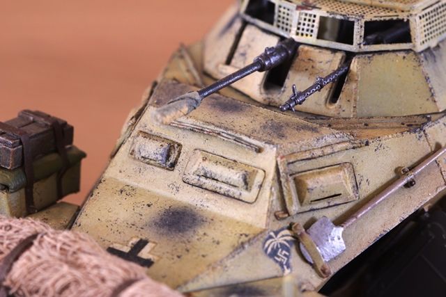

sponge & dry brush for me - not got away with MiG chipping fluid the 1 time i have used it (think it needs to be very light coats but not sure - will do some more tests when back painting). You could do salt chipping but that would need you to undercoat in the chipping colour, apply water & salt, then spray the top coat. I have seen it done mostly on aircraft (including 1 I did) but you can do it on AFV as well...
14603620196_3eecb3da5a.jpgP7110211 by Robert Worth, on Flickr
was donw with dry brush/sponge and also brushing scratches

as was (I also used oil pain, very small dot and then stippled to give the more work patches around the defined damage) :

erm let me try...
1) sponging - get small amount of sponge and a small amount of paint, take most of the paint off and then start dabbing it on the edges or areas you want wear - you need to put as little paint on at a time or it will look wrong (the sponge should give you the random effect)
2) dry brush - as above, paint on brush, remove most of it and then gently "flick" of the edges - again used more for wear & tear on the edges but can be used on flat surfaces too
3) oil - finally (for me on the above any way) - a small dot of oil paint (grey or payne grey or whatever colour you want) - make sure it really is a small dot - it goes a long way, and then use a stiff old brush rub the paint in to the surface - that "should" give the effect of the paint being worn through, so you should have the base paint being broken up by the grey to give wear & tear (the large grey areas on the walking surfaces for example)...
unfortunately I am out of action for painting until after Christmas or I would do some better photos... if you want, in the New Year I can do some more to try to explain it more....
Edited by robw_uk
