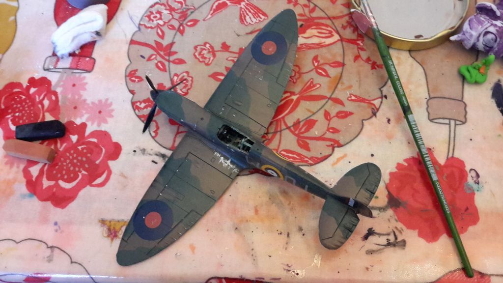

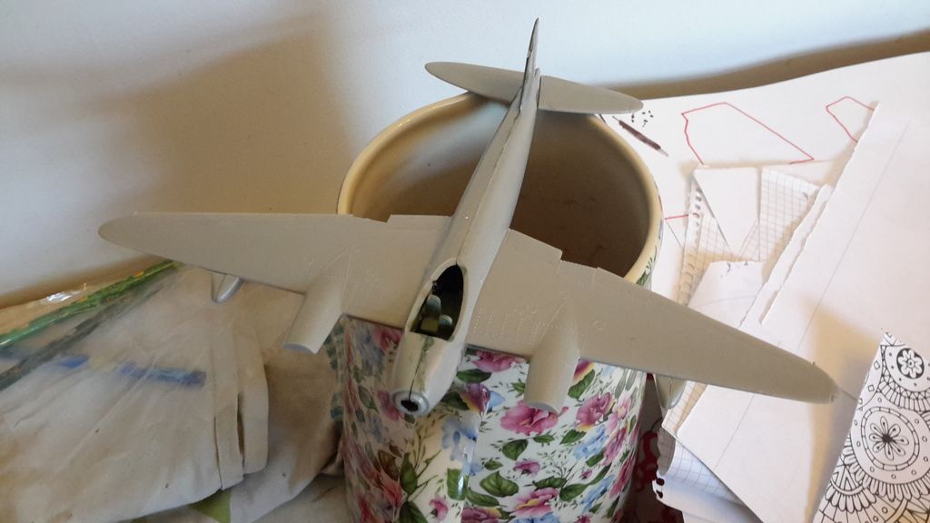

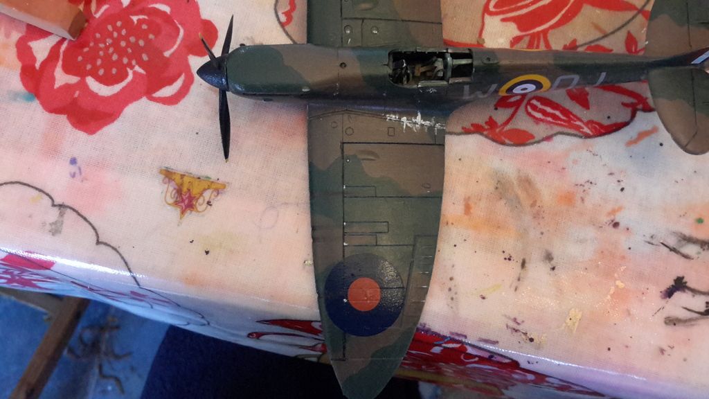

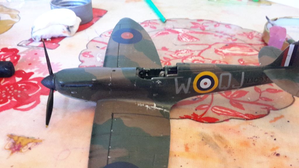

rob85 Posted January 10, 2016 Author Posted January 10, 2016 Right, I got some time in today to weather one of these little ladies. QJW, I used lots of shades of pastels for oil marks, gun and exhusts. I also cracked on with a bit of chipping using flat aluminium by tamiya. Pic's below. I am happy with it, probably over done, I need to work on my subtlety maybe..... yes I broke the wheels off but they are back on now What are your thoughts? I want to use some light pastels for bringing out some panels and breaking up the block colour of the roundels, good idea or no? I think I will use oils to do the oil stains on the other and see how we go. In other news my little 5 year old wanted a spitfire mkix kit to paint light pink.... I have not got one and so far have not bought one....this has angered the normally calm little thing and she had a strop, saying well "what planes DO you have!?", I picked a few from the stash and here are the results Photos by the little one all work, with a little help mixing paints and placing things from day, by herself as well.... I am informed it will be painted light pink with wheels down. One amazing thing I have to say is that I left her with the kit while I was getting everything ready, when I got back she had dry fitted the fuselage, wings and had the prop and cone in place while while trying to rip the necklaces from their spruce.... how does she kown how to do that! It very much impressed me Rob 8
Col. Posted January 10, 2016 Posted January 10, 2016 The Spit looks good as is Rob. Careful you don't overdo the weathering now. The Mossie looks as you both have had fun today and that's what matters both in this hobby in particular and life in general 1
Cookenbacher Posted January 10, 2016 Posted January 10, 2016 I really like the weathering Rob. Pastels work great at de-saturating decals, and I think it works best if they have matt coat over them. 1
Biggles87 Posted January 11, 2016 Posted January 11, 2016 I agree with the above, I think you've got just the right amount of weathering, especially for 1/72 scale. I'm also planning to use pastels on mine. I'm also impressed with your 5 year old's knowledge of things aeronautical. Cheers John 1
giemme Posted January 11, 2016 Posted January 11, 2016 Rob, I'm all for a weathered aircraft , provided that your reference pics shows it that way. That being said, I concur with the others saying that you got that right If you want to tone down a little bit the oil streaks, you can always go over them with a filter (base color, slightly lightened, very thinned) - I'm following too many builds and I don't remember if you're using an airbrush or painting these by brush, but the idea for the filter is the same. If you use oils to do them, I think you'll probably get a better control. I would also personally go for toning down the roundels, whichever method you choose. One amazing thing I have to say is that I left her with the kit while I was getting everything ready, when I got back she had dry fitted the fuselage, wings and had the prop and cone in place while while trying to rip the necklaces from their spruce.... how does she kown how to do that! It very much impressed me Rob, she's a girl, they learn fast (scaringly fast, sometimes)! I have three, I think I know what I'm talking about Ciao 1
rob85 Posted January 11, 2016 Author Posted January 11, 2016 Cheers chaps, I will give a bit of pastel to the roundles and run over the oil streaks with the enamel I used but thinned, I feel they need to be mor realistic, Girls do learnt fast! My boy probably knows how to do the same but would rather just smash it currently.... Still I like to think she will design aircraft for a living, it's my rite as a father to think this Rob 2

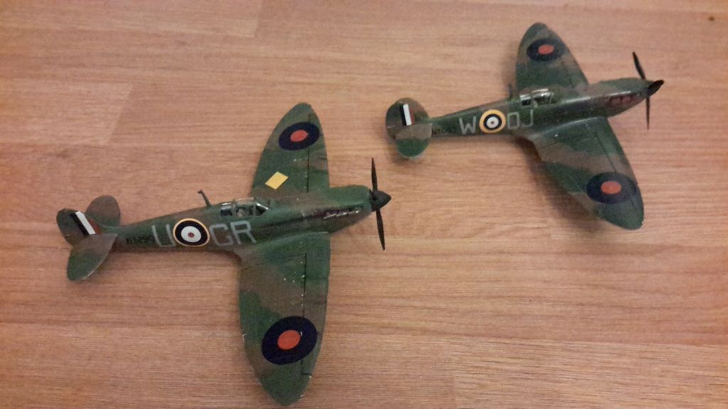

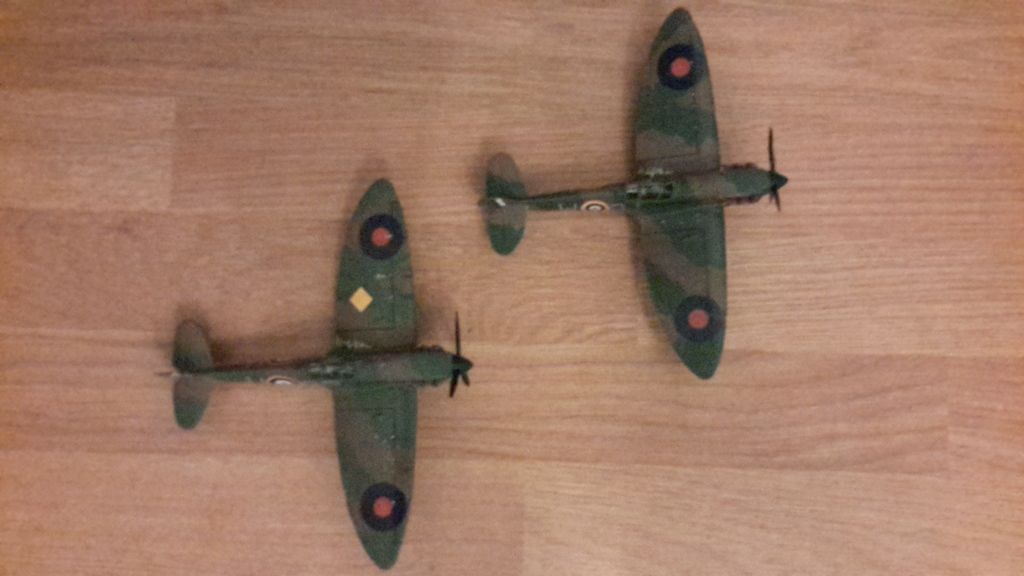

rob85 Posted January 20, 2016 Author Posted January 20, 2016 These are actually finished now! The canopy in the pictures looks a lighter shade but doesn't in real life!? However I cant show you that as photo bucket is having 'maintenance' so I can't post anything! Rob 2
Cookenbacher Posted January 21, 2016 Posted January 21, 2016 Can't wait to see them, and how's the Mosquito doing? 2
rob85 Posted January 21, 2016 Author Posted January 21, 2016 (edited) Cheers, mosquito is currently next to her bed half done and rapped in a lovely red ribbon.... more time on this this coming weekend, should have the main kit finished then just painting for the wee lady Also cookie, just getting the pictures uploaded Rob Edited January 21, 2016 by rob85 1
PlaStix Posted January 21, 2016 Posted January 21, 2016 Lovely progress Rob - the weathering looks fine to me..........and a Mossie too! Lovely stuff! 1

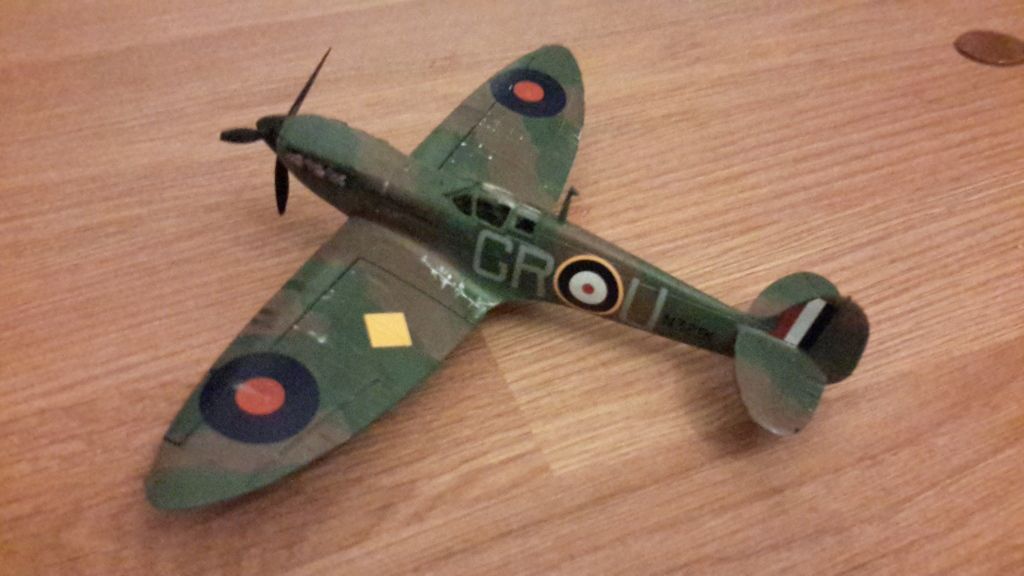

rob85 Posted January 21, 2016 Author Posted January 21, 2016 Here we are chaps....let me know if they can be improved! Waiting for the pic's of the undersides to up load! Rob 7
Beard Posted January 22, 2016 Posted January 22, 2016 They look splendid. I know I'd be pretty pleased with them. 1
rob85 Posted January 22, 2016 Author Posted January 22, 2016 Cheers chap's, RFI now up and all sorted! As jamie has pointed out, antenna wire! I will add this tonight Rob
