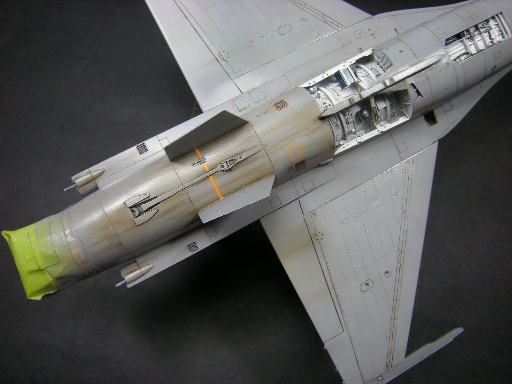

Pappy Posted November 13, 2015 Author Share Posted November 13, 2015 G'day Bri! Long time no hear. How is your F-117 coming along then? I am glad that you like my little effort, I am having a ball. It sure isn't the Tamiya kit, but you know what, it goes together great and cost me a fraction of the price, so plenty of modelling bang for buck as far as I am concerned, cheers, Pappy 1 Link to comment Share on other sites More sharing options...

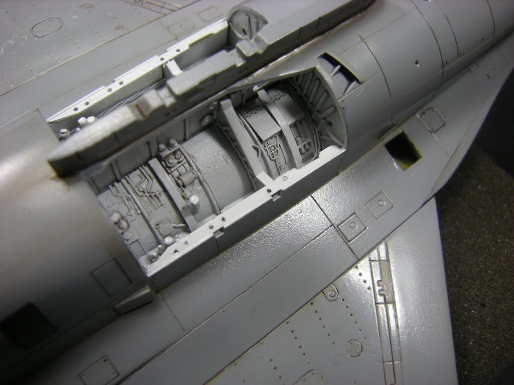

Janremco Posted November 13, 2015 Share Posted November 13, 2015 Great weathering on the bottom of the aircraft. Did yiu use powder or oils? Link to comment Share on other sites More sharing options...
uilleann Posted November 13, 2015 Share Posted November 13, 2015 G'day Bri! Long time no hear. How is your F-117 coming along then? I am glad that you like my little effort, I am having a ball. It sure isn't the Tamiya kit, but you know what, it goes together great and cost me a fraction of the price, so plenty of modelling bang for buck as far as I am concerned, cheers, Pappy Heh - it's stalled out as the house remodel has taken over, and I really need a new (larger and better lit) modeling space. That's one problem with a 1/32 scale kit. It ain't so tiny! Still hoping to have some custom PE made for it, and struggling madly trying to figure out Adobe Illustrator to create the needed vector files. It's just not my strong suit there. I'll keep following this one with great interest of course! And should you ever pick up the Nighthawk again, I'll be there too cheering wildly from the sidelines! All my very best! Brian~ Link to comment Share on other sites More sharing options...
Erik Leijdens Posted November 13, 2015 Share Posted November 13, 2015 Her bottom looks awsome Pappy! Erik Link to comment Share on other sites More sharing options...
Pappy Posted November 13, 2015 Author Share Posted November 13, 2015 Great weathering on the bottom of the aircraft. Did yiu use powder or oils? Oils, always oils! Heh - it's stalled out as the house remodel has taken over, and I really need a new (larger and better lit) modeling space. That's one problem with a 1/32 scale kit. It ain't so tiny! Still hoping to have some custom PE made for it, and struggling madly trying to figure out Adobe Illustrator to create the needed vector files. It's just not my strong suit there. I'll keep following this one with great interest of course! And should you ever pick up the Nighthawk again, I'll be there too cheering wildly from the sidelines! All my very best! Brian~ G'day Brian, What is it with us modellers and house moves/renovations? Let me know when you figure out how to do custom etching, I need a few bits done, Pappy Her bottom looks awsome Pappy! Erik Her top is coming along as well, pics soon, Pappy 1 Link to comment Share on other sites More sharing options...

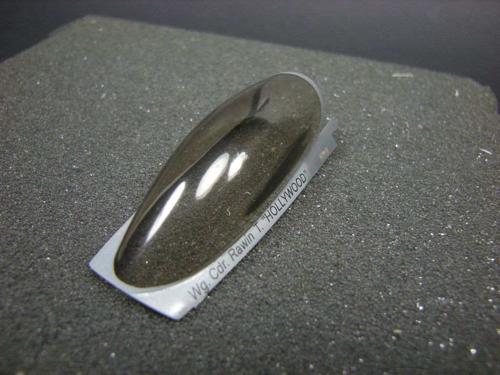

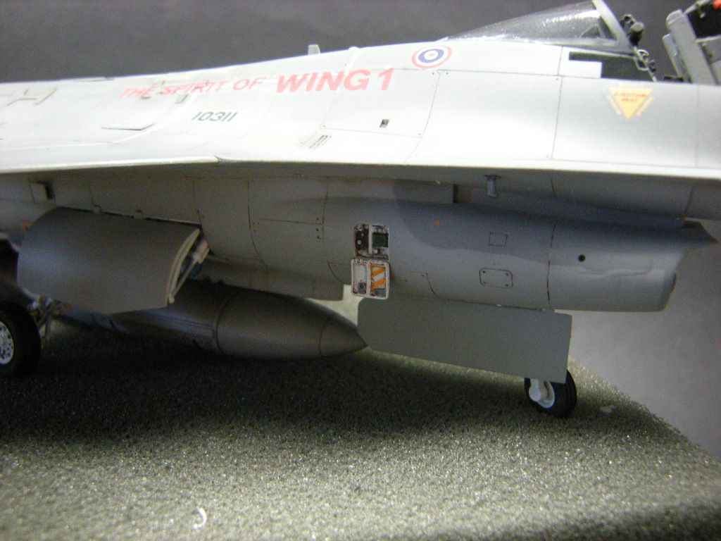

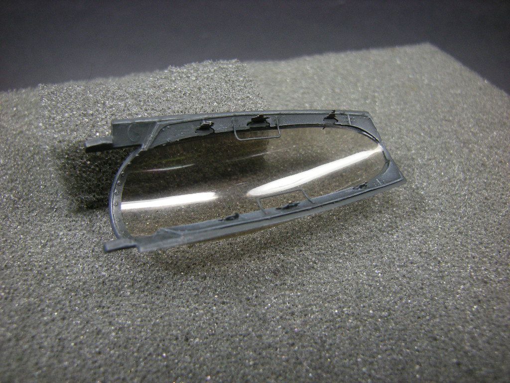

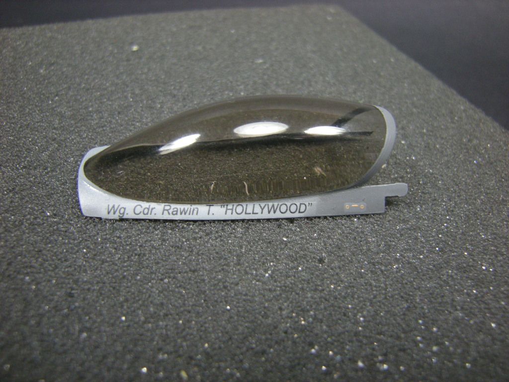

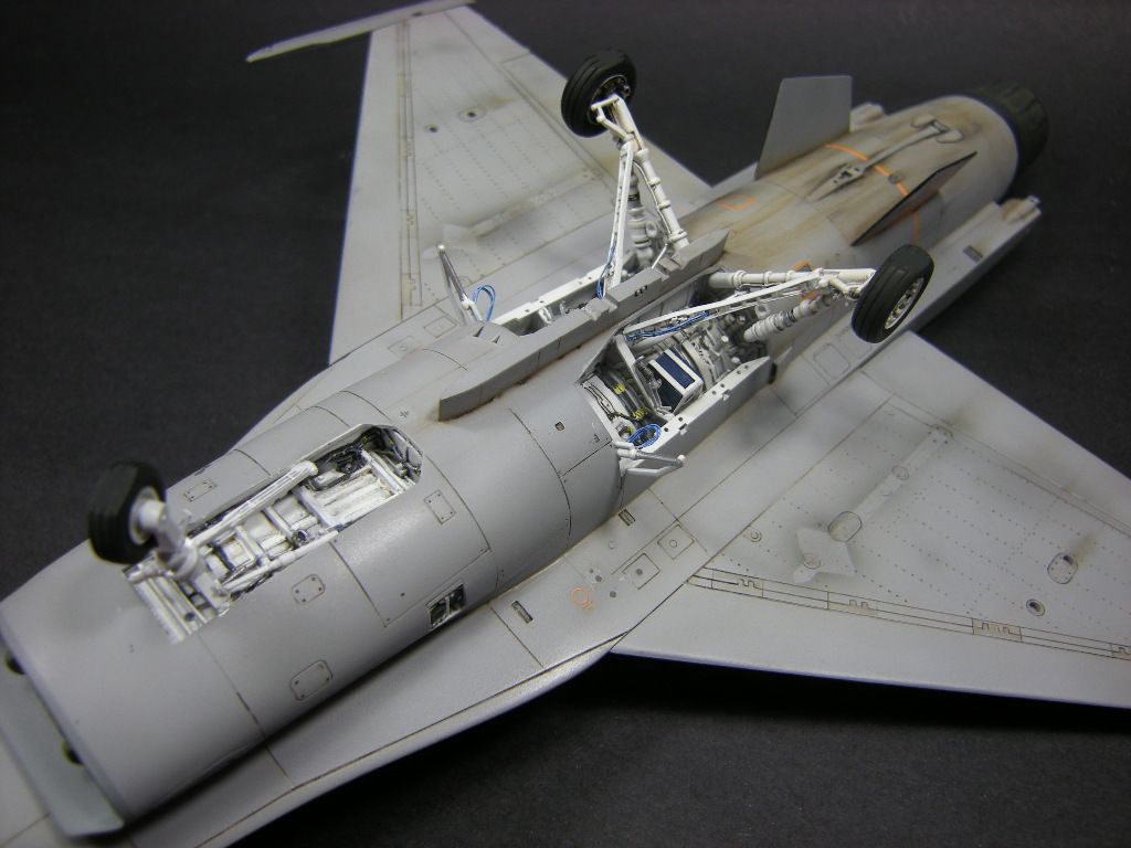

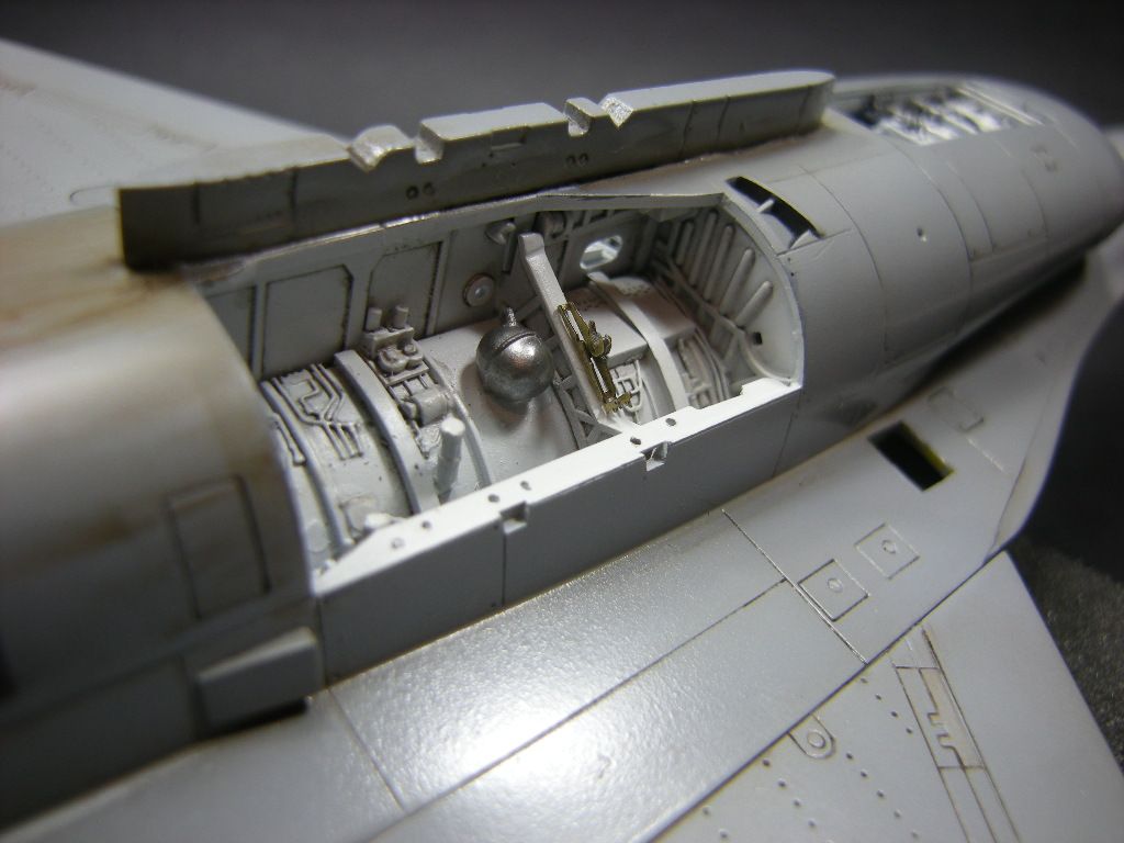

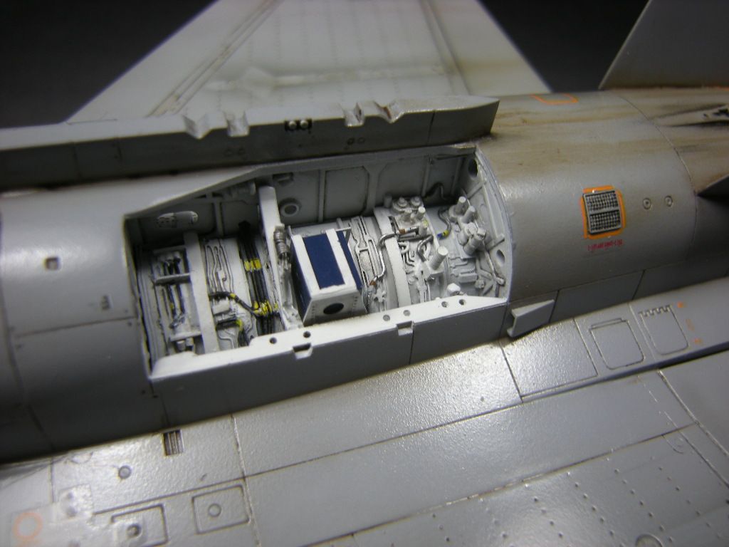

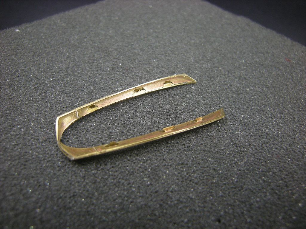

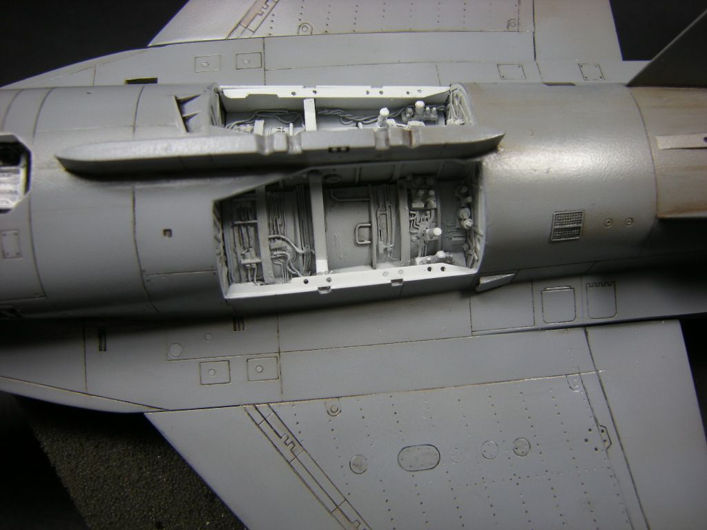

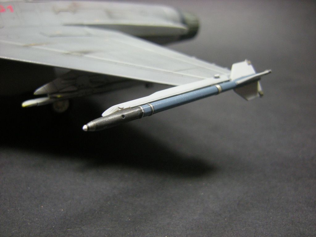

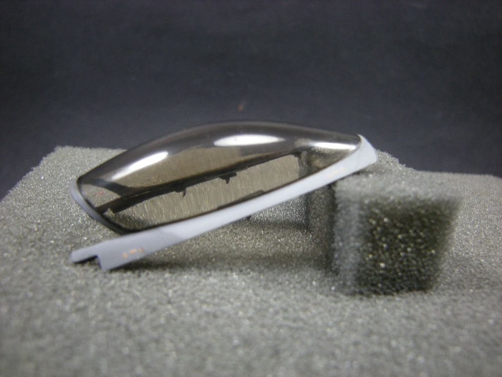

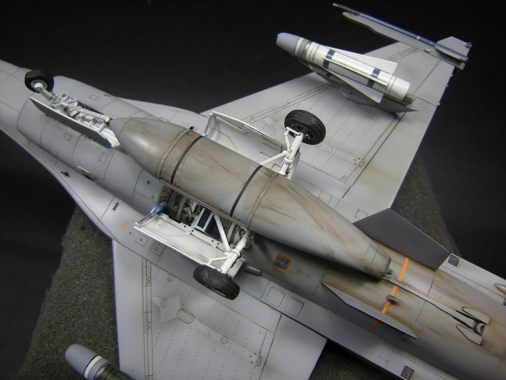

Pappy Posted November 14, 2015 Author Share Posted November 14, 2015 G'day people,I have painted up the undercarriage bays and installed the undercarriage,Some more PE for the bayStores pylons addedAs well as a heater for the port wingtipand finally the remaining stores,Now that the all the masking has been removed, I can start adding some etch details to the main canopy. The canopy detail is laminated up from several brass overlays that are added to a baseOnce set, I bent up the tabs , to which the canopy locking hook parts are added,I also added these two rails as per my refs,cheers,Pappy 7 Link to comment Share on other sites More sharing options...

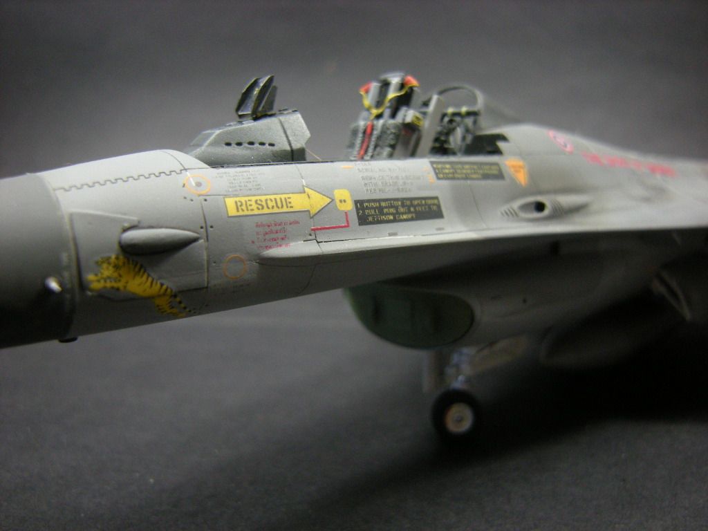

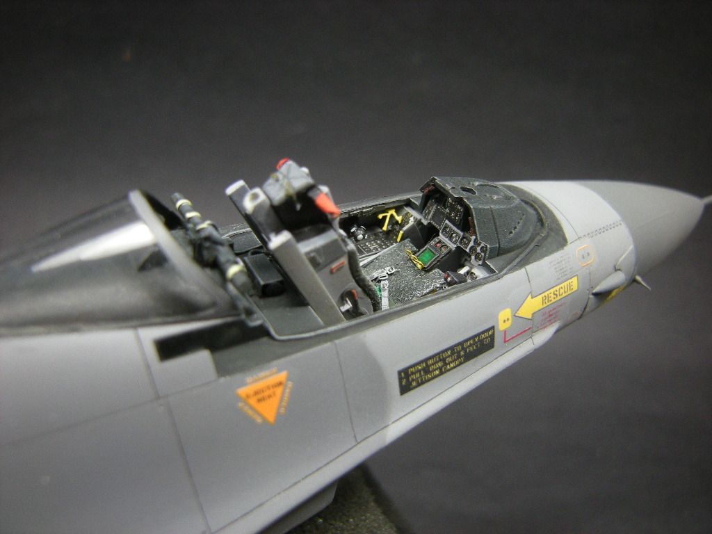

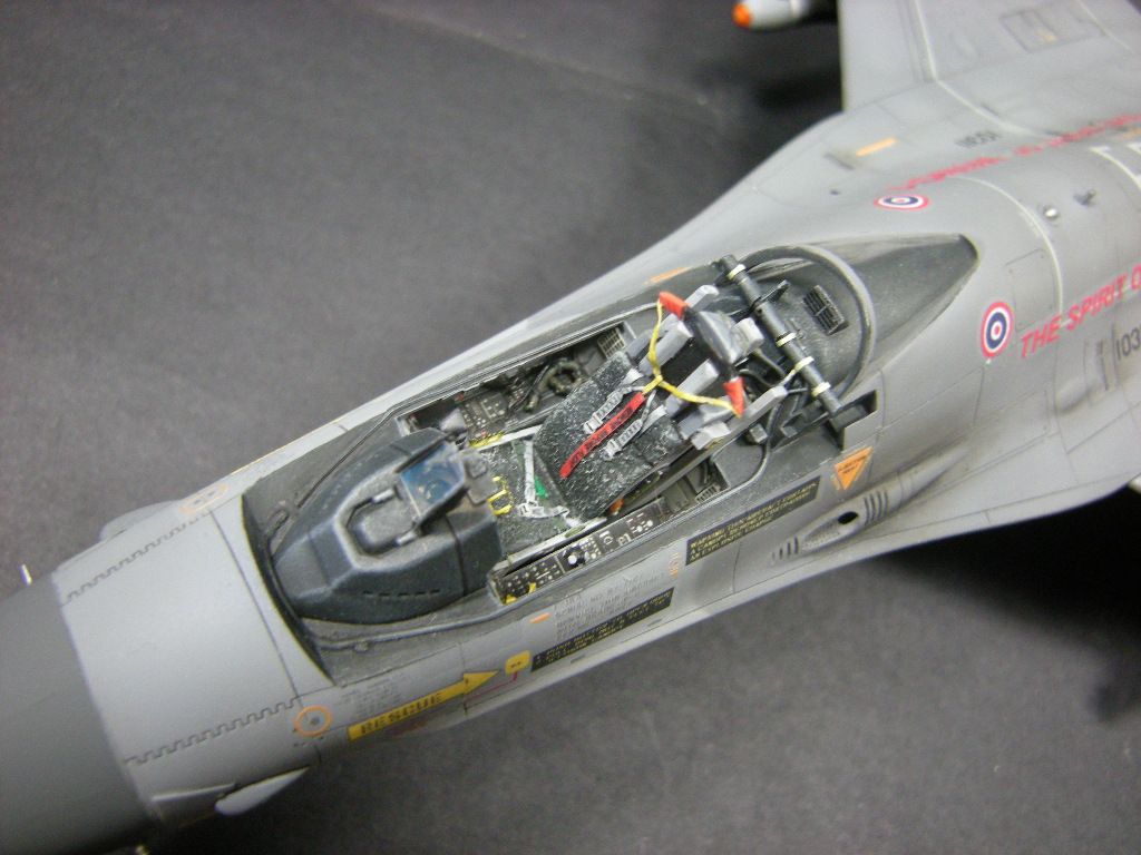

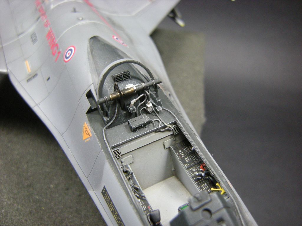

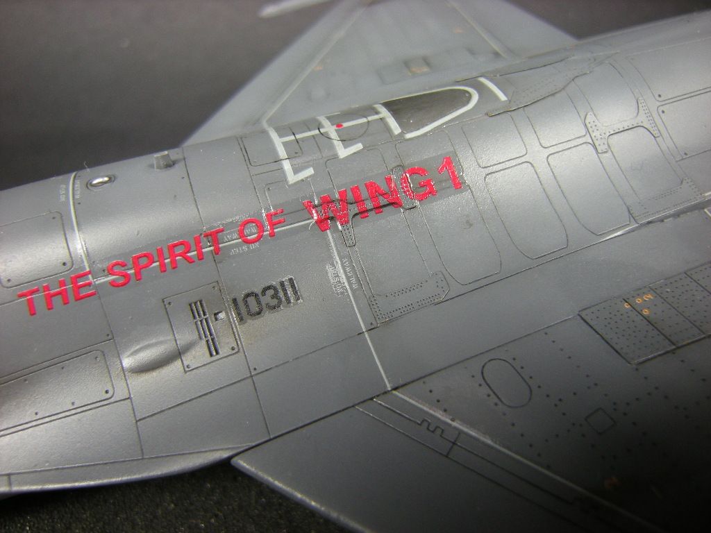

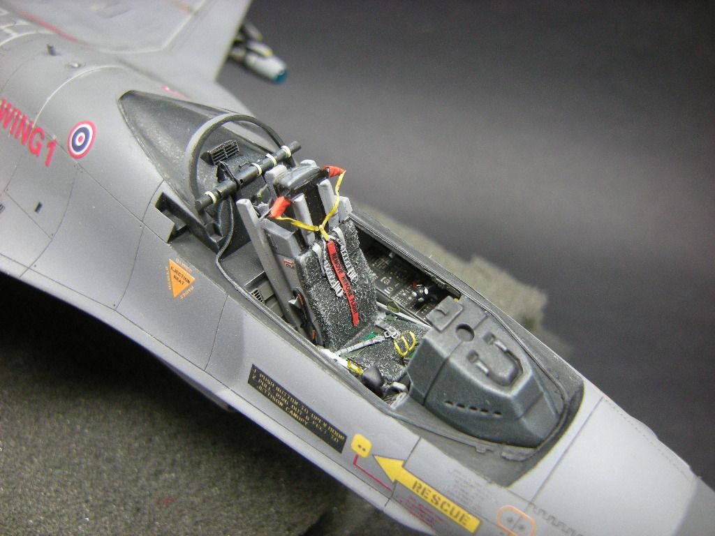

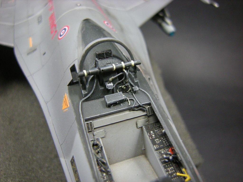

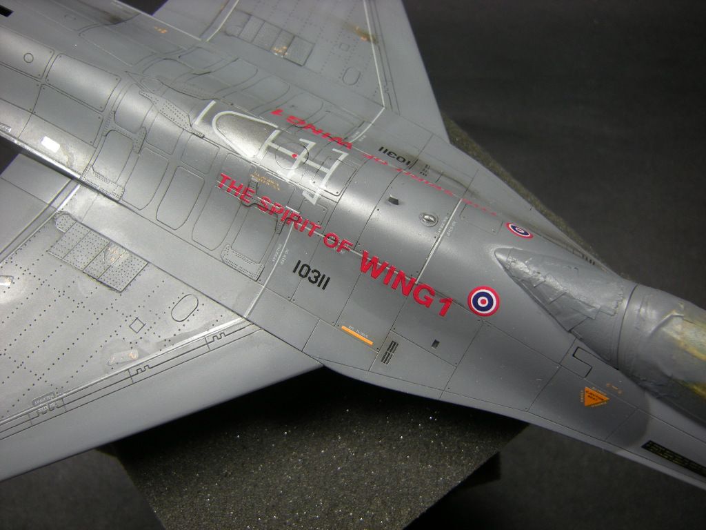

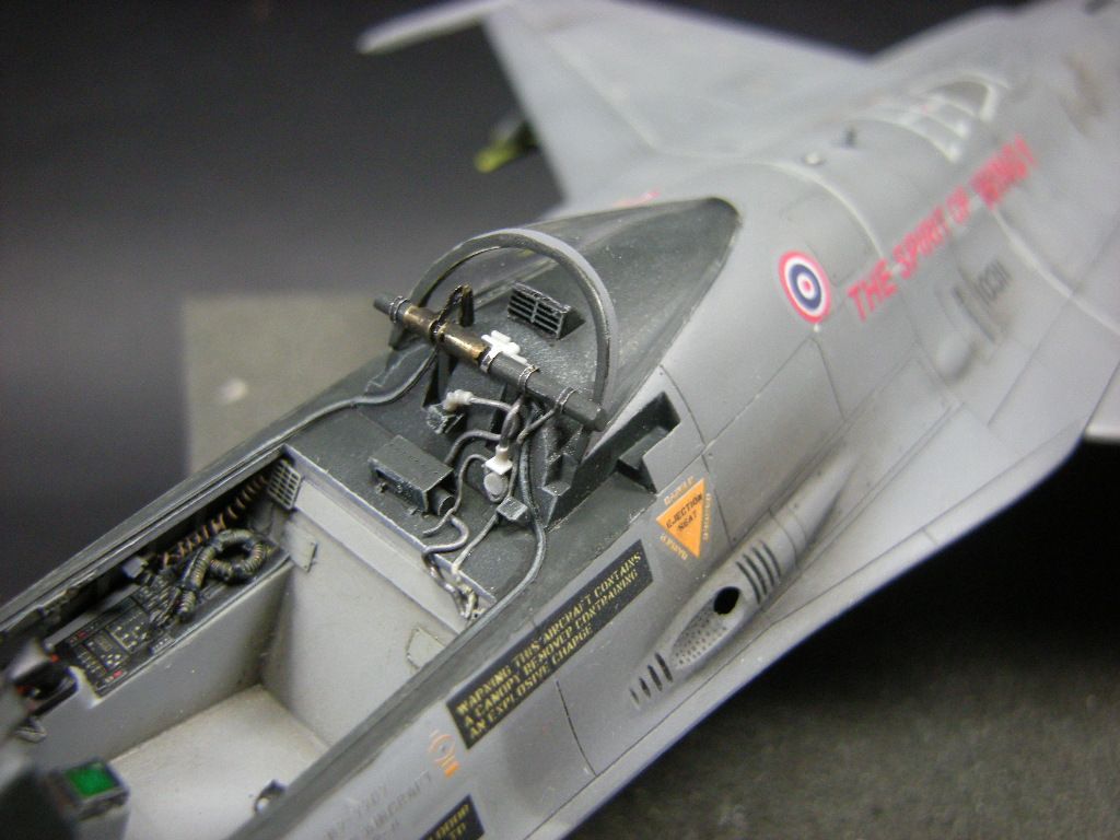

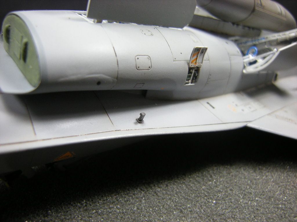

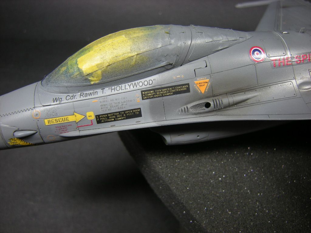

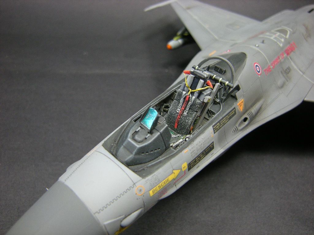

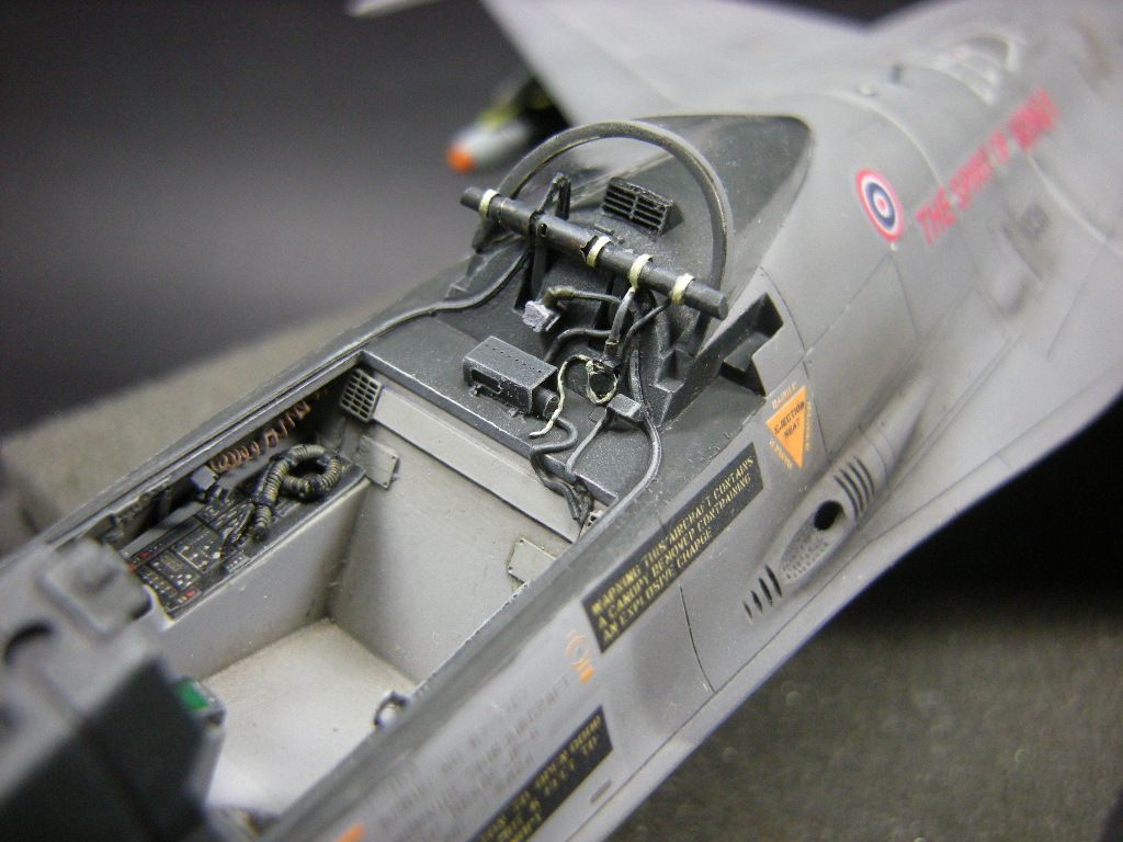

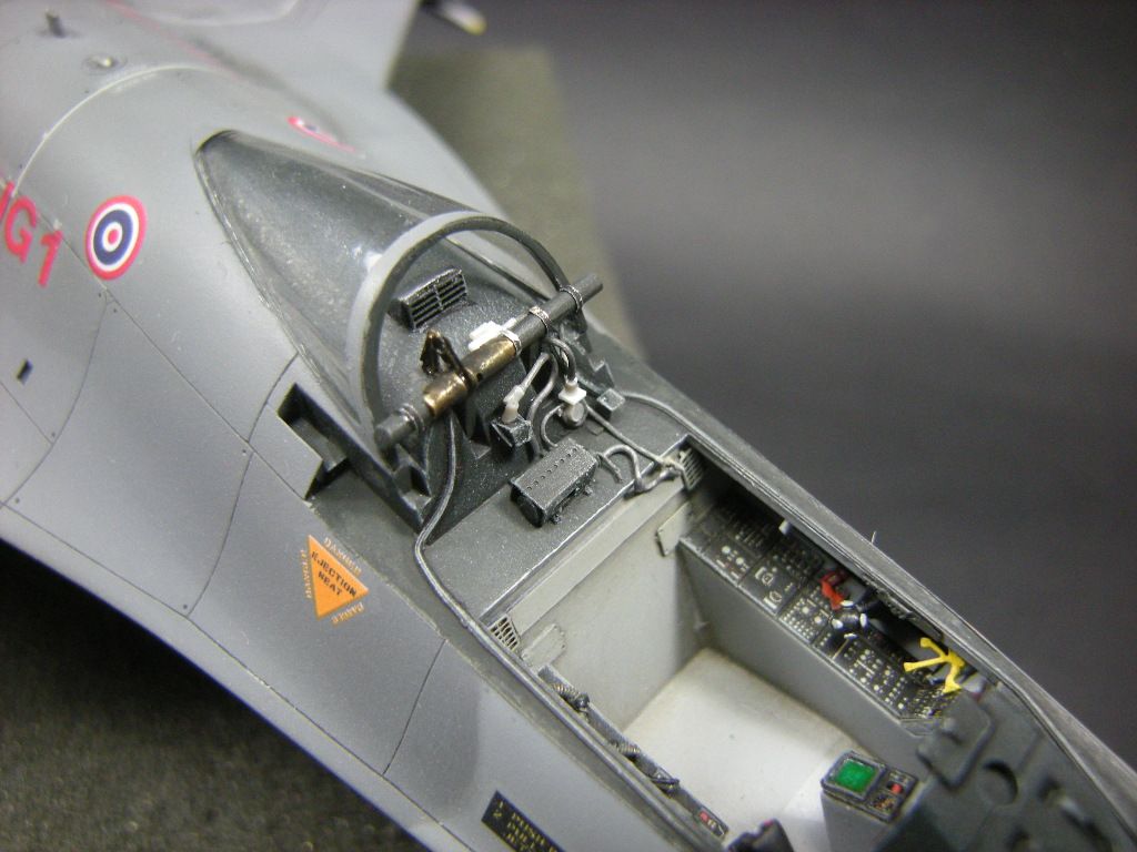

Pappy Posted November 15, 2015 Author Share Posted November 15, 2015 (edited) G'day people,Decals are now done and it is time to reveal this viper's owner, Wit the canopy masking removed, it was time for some of the final details to be added. As I mentioned earlier, I originally intended this build to be a pole sitter (canopy down), which would mask one of the shortcomings of the Hasegawa kit. The rear cockpit bulkhead should have a small recess in which the canopy motor and various other gubbins live. It is too late to fix this once the fuselage is sealed, but that does not mean some additional detail cannot be added.The kit canopy actuator was installed and various bits and pieces were fabricatedAfter a quick splash of paintSatisfied, the seat was installed. I did have to trim the front of the seat slightly so that it would clear the centre pedestalNow it was time for the small details such as the TAT probe and ground power access doorOnce the small frangible details were done, I decided it would be safe to add the PE HUD,cheers,Pappy Edited November 15, 2015 by Pappy 4 Link to comment Share on other sites More sharing options...

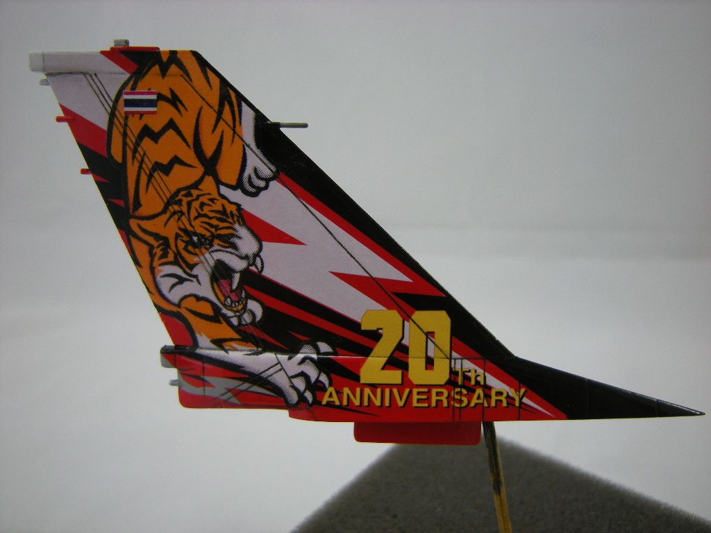

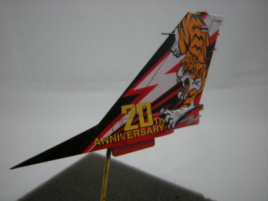

Pappy Posted November 15, 2015 Author Share Posted November 15, 2015 Thanks Brian, G'day people,The tail was finished a while ago, about a year ago.I completed this part first, because if I stuffed up the decals on the tail, there was no point continuing with the rest of the scheme, so the whole build kind of depended on getting that right. The tail has now been attached and she is ready for her beauty shots,cheers,Pappy 2 Link to comment Share on other sites More sharing options...
Erik Leijdens Posted November 15, 2015 Share Posted November 15, 2015 Never had guessed it would be a Thai Viper! Always good to see a more exotic Viper. Tail looks very good, hope the fit to the fuselage will be ok. But I think you already figured that out. Erik Link to comment Share on other sites More sharing options...
