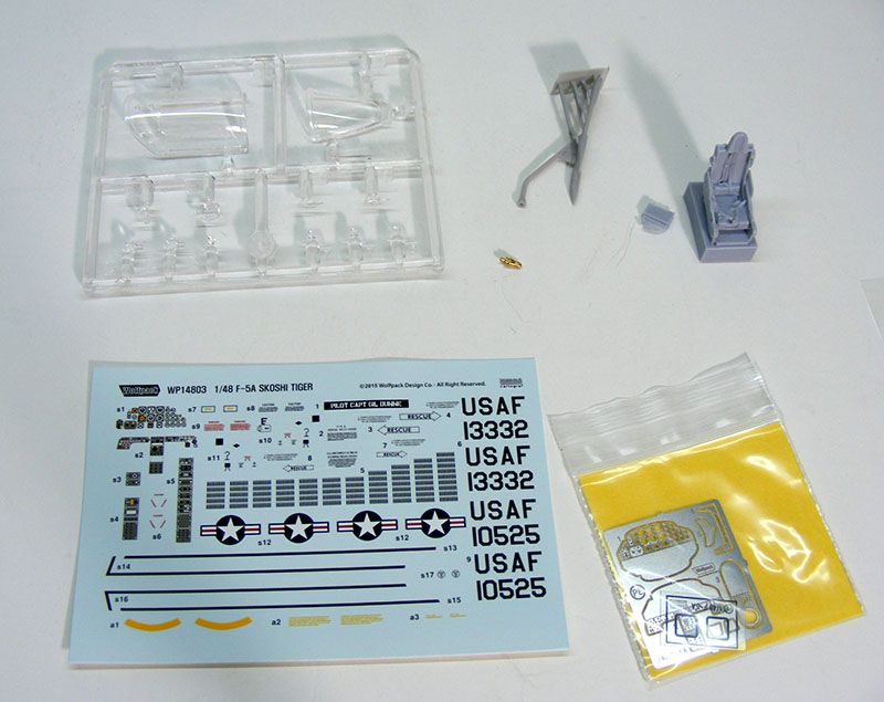

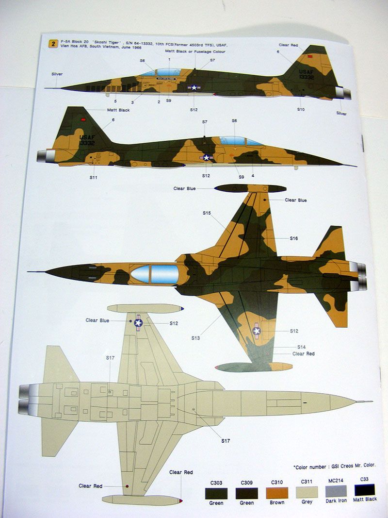

trickyrich Posted November 3, 2015 Posted November 3, 2015 Well after much thought I decided on something nice and simple and looked what showed up in the post today! Wolfpack’s F-5A Shoshi Tiger, well a tarted up Kinetic model, and that was/is a beautiful model! I was lucky enough to find one in South Korea that was going for a price just too good to not get one. Even after postage it was nearly ½ the price of similar Kinetic/Wolfpack ones on evilBay…bargan! So this will be close to a OOB build (we shall see on this point….) though I do have some Eduard PE interior bits on the way… and still thinking about the external PE set as well! The model looks amazing with some lovely extra bits, though I only have two choices in the markings. ooooo so lovely!!!!!! Actually it's the other colour scheme....took photo of the wrong one! Well I have to get the Meteor out of the way first but I will be pushing quite hard to get this build out of the way as I will be in Europe for 4 weeks over the Xmas/NY period so no modelling for me! I can’t wait to start this one! 8

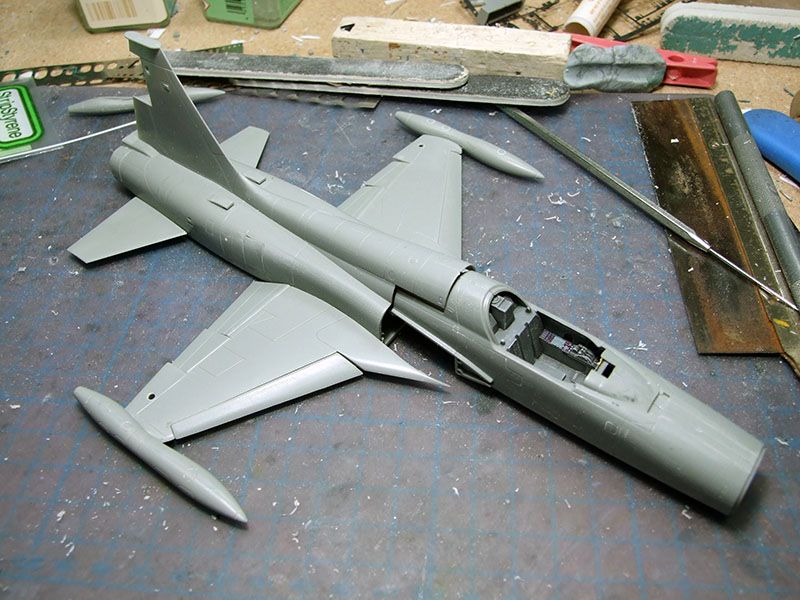

trickyrich Posted November 15, 2015 Author Posted November 15, 2015 That looks nice. I almost bought one in Telford for 20 pounds. Now I am sad I didn't. Can't wait to see what you will do with it. Cheers, You should have, it's a nice model, though there are a few issues and it would be best to get one now! As I have a feeling later releases may have some issues unless they refresh their moulds, Kinetic or Wolfpack! Well I have finally made a start to this build. The whole build itself is actually quite a simple one that can be built up in modules, so that’s what I’ve done. Anything and everything that can be pre-built I have started, I haven’t taken photo’s of everything, just the important areas. I have found some issues that will also relate to the Kinetic builds and will go over these as I find them. The wing section is together, but there are a few issues. The general fit is very nice and I like the way they go together and hide the joins. But there are a couple of issues! Where the wings meet at the wing tips, the lower section does sit quite proud and dose require sanding down, I probably should have test fitted this and corrected it before I glued the wings together!! Also the leading edge of the leading edge extension is really poor and way too thick, this needs some work! I’ll take photos as I fix this problem. Next issue is the wing tip tanks. On the original release from Kinetic they had two LHS tip tanks, this was corrected in later moulds. However this later moulding have a new issue in that the new RHS tip tank in the wrong shape. The photo doesn’t show it too will but the new RHS tip tank is quite a bit thinner that the original ones. Though it’s not too noticeable, once you see it, it just bugs you! The only way to fix this is to modify one on the LHS tank to fit the RHS. Again I’ll post photos and details as I sort it out. The intakes, tail section and nose cone went together without too many issues, though not as nicely as I have hoped/expected! The cockpit was the next bit to be done, the new Eduard interior bit were fitted. I haven’t quite decided whether to used the Wolfpack or kit/Eduard ejector seat yet. Will build/paint up both and decide towards the end. Once all the PE bits were on everything was given a undercoat of Model Master Aluminium then grey before a coat of flat clear. I have just the shading and Eduard panels to fit to finish, that should be a simple and quick task. One thing I have noticed, while this is a really lovely mode, it appears that the moulds are getting a bit worn, as there is a lot more moulding and flash issues that I would have expected!! Something that does quite surprise me! 6

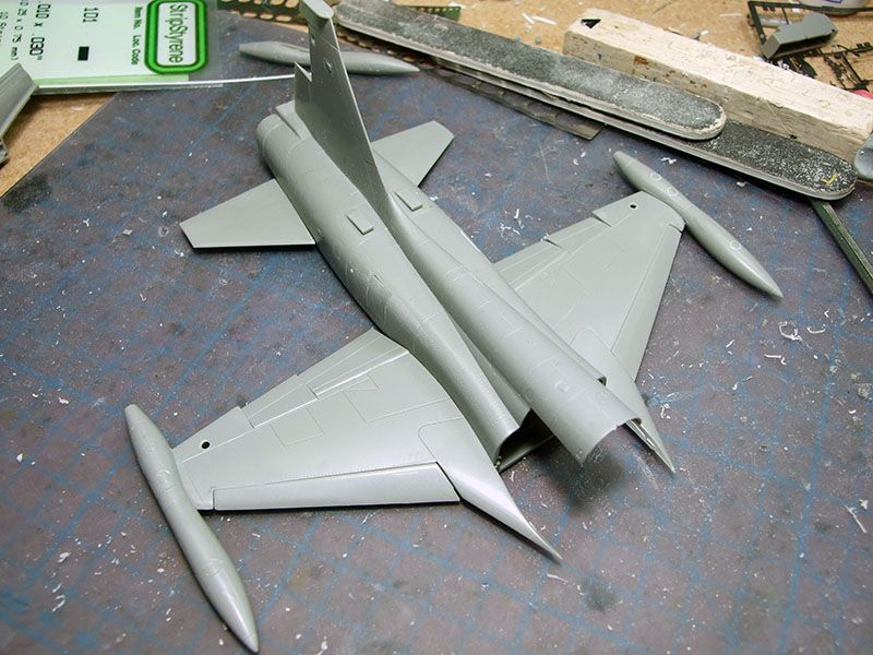

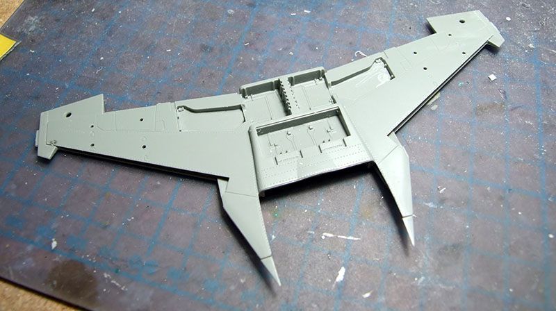

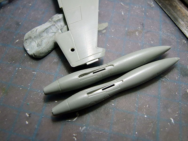

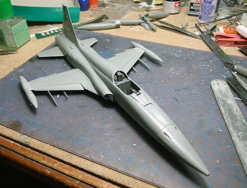

Skids Posted November 16, 2015 Posted November 16, 2015 The wing section is together, but there are a few issues. The general fit is very nice and I like the way they go together and hide the joins. But there are a couple of issues! Where the wings meet at the wing tips, the lower section does sit quite proud and dose require sanding down, I probably should have test fitted this and corrected it before I glued the wings together!! Also the leading edge of the leading edge extension is really poor and way too thick, this needs some work! I’ll take photos as I fix this problem. Next issue is the wing tip tanks. On the original release from Kinetic they had two LHS tip tanks, this was corrected in later moulds. However this later moulding have a new issue in that the new RHS tip tank in the wrong shape. The photo doesn’t show it too will but the new RHS tip tank is quite a bit thinner that the original ones. Though it’s not too noticeable, once you see it, it just bugs you! The only way to fix this is to modify one on the LHS tank to fit the RHS. Again I’ll post photos and details as I sort it out. The intakes, tail section and nose cone went together without too many issues, though not as nicely as I have hoped/expected! Good start Rich I have been testing mine constantly while I was waiting for some etch. I have sanded the wings down so as the fit is better. Havent put the tanks together yet so not seen the shape issues so will look forward to seeing how you fix it. (then I can just copy what you have done ) I have noticed that the fit on the kinetic kit is "not the best". I think it is slightly over complicated and that causes a few fit issues. I know that it was probably done to maximise the different variants you could produce from one mould. Also after 'test' fitting the canopy raising arms it may have been easier to leave the part that attaches to the canopy off as its very close to the fuselage when fitted and may cause issues when trying to mask.

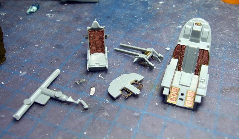

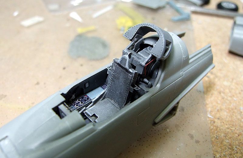

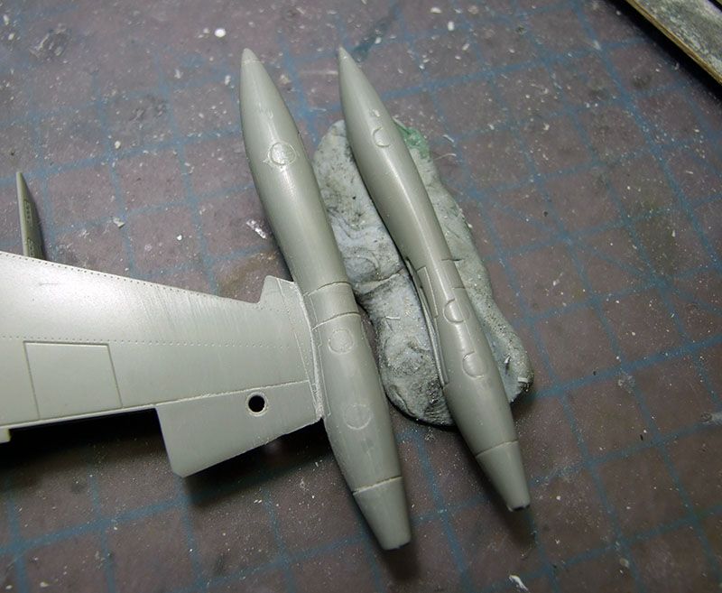

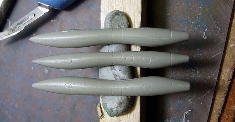

trickyrich Posted November 20, 2015 Author Posted November 20, 2015 Havent put the tanks together yet so not seen the shape issues so will look forward to seeing how you fix it. (then I can just copy what you have done ) well I'll probably cheat on that one and take one of the LHS tanks and re-scribe it as a RHS one, I know the wing tip shape is already moulded in but a wee but of work with the Dremel will sort that out. I may have to use a wee bit of filler to tidy up. Ok I’m a wee bit late with this update, everything to follow was done earlier in the week, plus I have been trying to finish off the Meteor. I know I keep harping on about this but the quality of the moulding throughout the model is actually quite poor and vague in some places with the fit….well lots of limited run models have much better fit! Ok a couple of poor areas are on the nose section and tail section. In both these areas you need to add panels to suit the version you’re build, normally no big issue. But in this case they don’t fit very well at all and leave very noticeable gaps and they are recessed too much, you need to fit spaces under them! They’re not huge issues at all, just a pain in the bottom to sort out! Ok that aside I pretty well finished the cockpit and glued the nose section together. I still haven’t decided about the ejector seat, the kit one with Eduard PE bits looks sort of ok, but the Wolfpack looks better in shape…but not with the moulded seat belts! I may end up removing them and fitting the Eduard ones! With the Meteor almost done I should be able to spend more time on this build, would like to get it done before I go away on holidays….we’ll see. 6

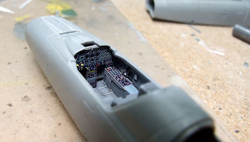

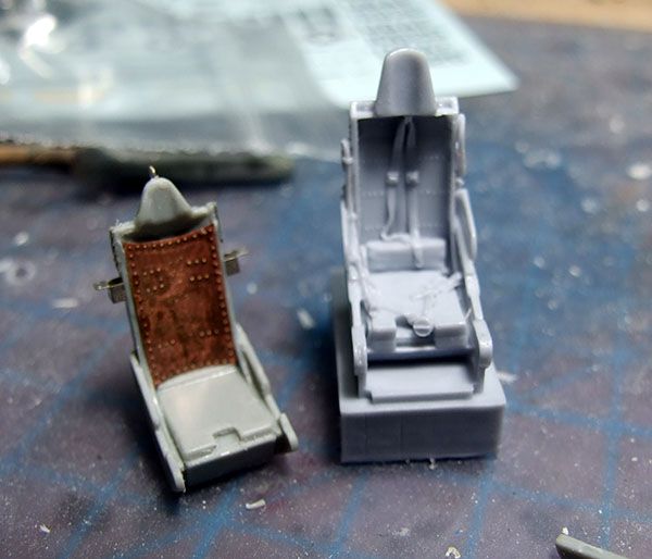

modelling minion Posted November 21, 2015 Posted November 21, 2015 That cockpit looks great Rich, very convincing. It seems all the modern 1/48 F-5's are giving us one or two issues with the fit of variant specific parts, I know my AFV F-5F is but so far they are not too bad. Craig.
mirageiv Posted November 22, 2015 Posted November 22, 2015 As convincing as decals can look, they will never match that, lovely job on the pit!

Mr B Posted November 23, 2015 Posted November 23, 2015 Lovely work on the internals..... Nice progress......is this a true Wolfpack mold do u know? Lines look a tad deep.....in my opinion......but that's just me....and your building skill shows great progress n nice work Rgds
mirageiv Posted November 23, 2015 Posted November 23, 2015 I loved them for the fact you didn't have to be a good painter to have a lovely cockpit, I use to hate painting cockpits. The old Airfix cockpit decals were pretty plan, just black & white, or for the really old stuff you had to cut the instrument panel out of the instruction sheet! Oh dear now I'm really showing my age! Then Esci came along with beautifully printed colour decals, modelling heaven I thought! I still think they suit certain models, and the F-5 especially so, they just look so nice and right on the old Esci 1/72nd F-5's. Am really glad members are using them....brings back great memories of builds of old! Usually I build my kits in flight and initially I went around purchasing aftermarket cockpits/etch sets but now after just using decent decals a few times, it is pretty much the same looking through thick 1/72 canopies. I agree they can look a lot better than most people would think!
gingerbob Posted November 25, 2015 Posted November 25, 2015 is this a true Wolfpack mold do u know? No, it is the Kinetic kit, apparently with some bits and bobs added.
trickyrich Posted November 25, 2015 Author Posted November 25, 2015 the extra bits are a resin seat and refueling probe with brass tip for it.....but no Bob's!
Giorgio N Posted November 25, 2015 Posted November 25, 2015 Not sure you'd have liked the CA kit: there was a very interesting build of a Norwegian aircraft in an issue of MAM and the author (Nils Mathisrud of Vingtor, who also posts here) found several accuracy issues, some quite serious (like the size of the wings)

Skids Posted November 26, 2015 Posted November 26, 2015 That cockpit looks brilliant, nice work. I have been looking at those leading edges and they do need working on. (might be quicker using a belt sander ).

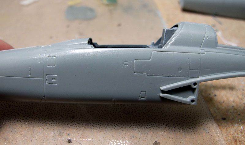

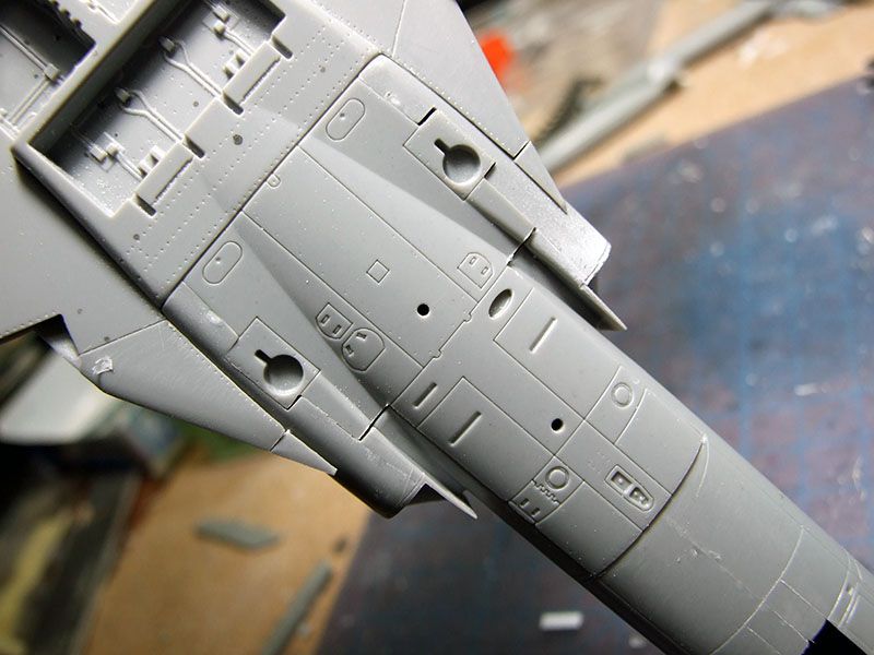

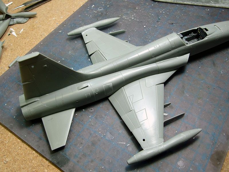

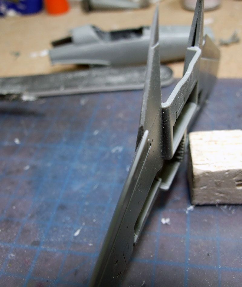

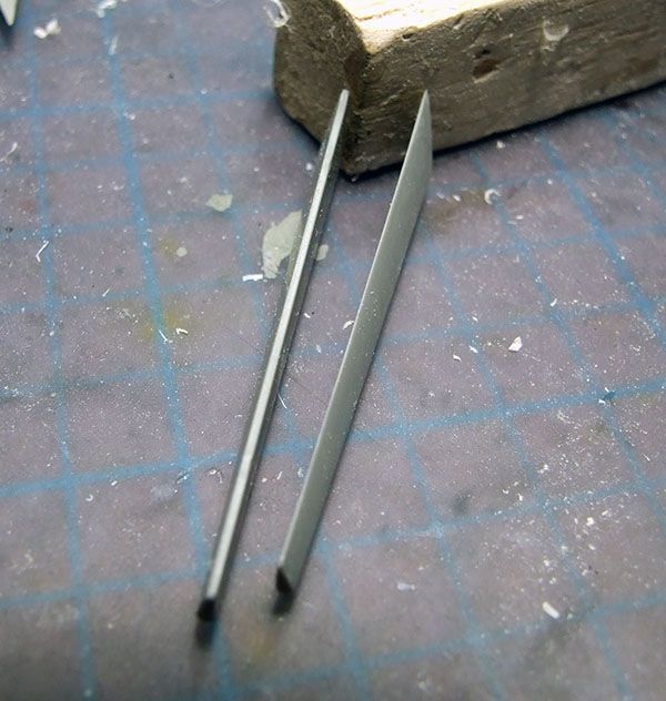

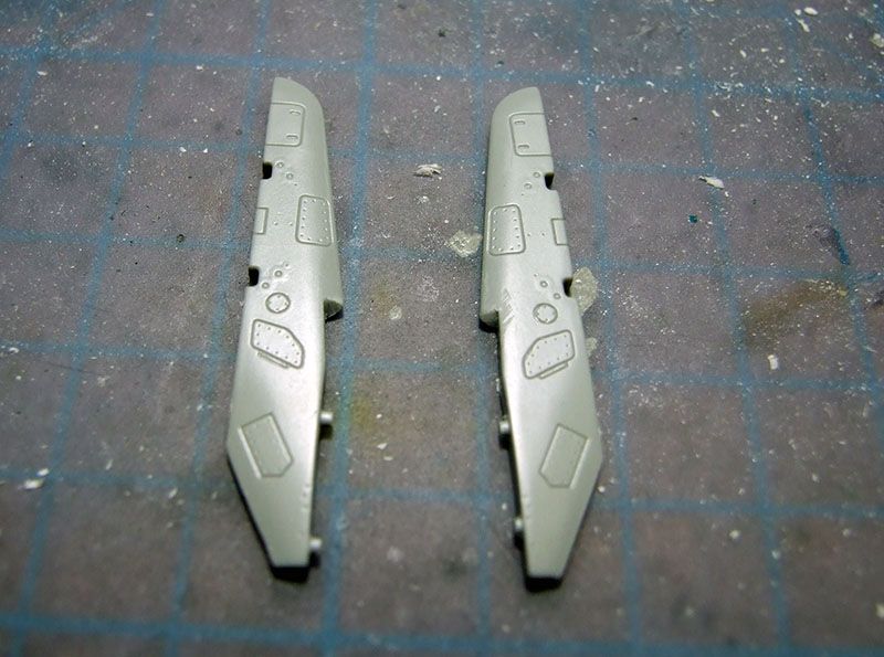

trickyrich Posted November 28, 2015 Author Posted November 28, 2015 Well this is sort of a two part update as I had done a wee bit more work before I went away but forgot to write it up……so a double today. So first up the wing and LEX edges. I have been banging on a bit about these because they are/were so terrible! Sorry this first photo is a bit blurred but you can sort of see the issue, both sections are completely blunt. Here is a before and after of the leading edge slats, the elevators leading edges were worse! Now this looks a lot better. So do the elevators now. Next on the to-do list was the wing tip tanks. As mentioned the original model provides two LHS tanks by mistake (two sprues are identical, it just so happened that the tip tanks were on these), in a later release they provided a new RHS tip tank. However this tank is not quite right either! As you can sort of see in the photo the new RHS tank (in the middle) is quite a bit thinner…..well it is too me and so bugs me now I know it. So the easiest thing to do was to turn one of the LHS tanks into a RHS one, a fairly simple task. First the tank was re-scribed for a RHS tank, then the cut out and wing tip were shaped so that the tank would sit/fit correctly. There are some gaps but a wee bit of sprue and filler will sort that out. Again this looks much better, just a little tidy up and she's done. At this stage she is starting to look like a real F-5, the slats and flaps on mine will be out. I do so love the lines of this aircraft. Right part two of this update! The intakes were cleaned up and painted inside, I didn’t actually worry about the engine face as it is so far back and dark inside you won’t see a thing. The rear of the front section of the fuselage had sprue spacers add so it would fit nicely with the rear section. Seems to be a must for this model as everyone else is doing the same thing! Next up the inner pylons were fitted, no real dramas other than one of them was poorly moulded and needed quite a bit of cleaning up! The outer pylons are another problem with this model, as they are you cannot have the slats lowered! The need to have the “dog tooth” you see in the photos for the slat to drop down. It is sort of moulded in the pylons but needs to be removed, even if the slats are up! A word of caution though the “dog tooth” is not square to the pylon, it must be cut on an angle to match the wing leading edge angle! Ok then fit it all together to see how she looks…even better. Ok last part of the update and one that consumed quite a lot of time, the underside panel between the intakes and the forward and rear sections of the fuselage…………..well it doesn’t fit! The fit is really poor here and required (for me anyway) an awful lot of test fitted and modifying to get everything to fit. The instructions want you to fit this panel before you fit the intakes….insane! The intakes require a bit of work to get them to fit nicely with the forward fuselage, having this lower section fitted won’t allow you to do this! After about an hours work this is as good as I can get it, some gaps, but everything including the rear fuselage sections actually fits quite nicely. It’s not glued in at the moment, it will sit better when glued in. So I would recommend doing the fuselage this way; 1, finish what you can of the front section..leave off the nose for now 2, finish off the rear fuselage section, again leave off the elevators. 3, glue the wings to the rear fuselage section. 4, clean up & paint the intakes and fit to the forward fuselage section 5, leave everything to dry solid for a day or so 6, now fit the underside panel to the forward section 7, finally once everything is dried, join the two sections together. In each of these stages test fit everything a million times to make sure it all fits nicely before you glue anything!! If in doubt, don’t glue it, recheck it!! It’s almost like building a resin model, you don’t get a second chance once you glue it! Hopefully by this time tomorrow I should be getting ready to paint her….very exciting! 2

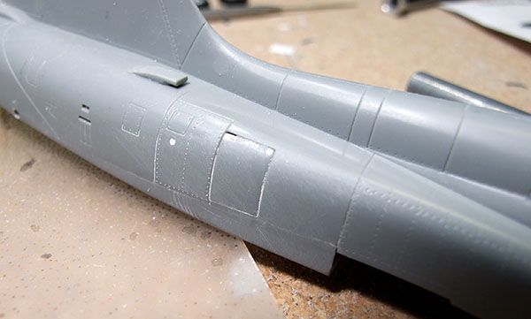

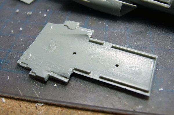

Arniec Posted November 28, 2015 Posted November 28, 2015 (edited) Nice progress Rich. I know what you mean about that plate. Mine wasn't a great fit either. I can't remember how I placed it but it wasn't to bad. The worst fit for me was that I got a big ridge near the airbrake. I mostly sanded that down. Edit: I did glue the front halfs and back halfs of the fuselage together first so that fit was good. But you should have doen that very early in the build. Here is the link to my build at the lesser build air force GB. Maybee it helps. http://www.britmodeller.com/forums/index.php?/topic/234972996-dutch-northrop-nf-5a-freedomfighter-finished-10-04-2015/ Cheers, Edited November 28, 2015 by Arniec
modelling minion Posted November 28, 2015 Posted November 28, 2015 Fantastic work Rich, and great progress. You have really started to knock this kit into shape. The step-by-step guide you have given us will prove useful to anyone tackling this model. Craig.
