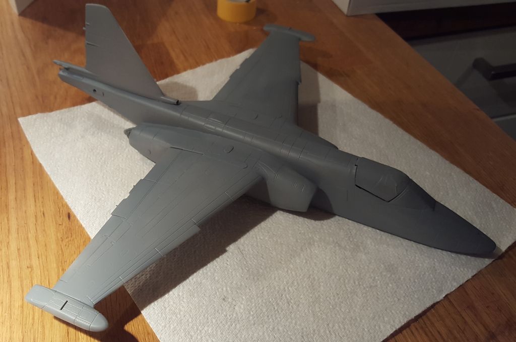

Muzz Posted December 6, 2015 Author Share Posted December 6, 2015 Primer on! 2 Link to comment Share on other sites More sharing options...

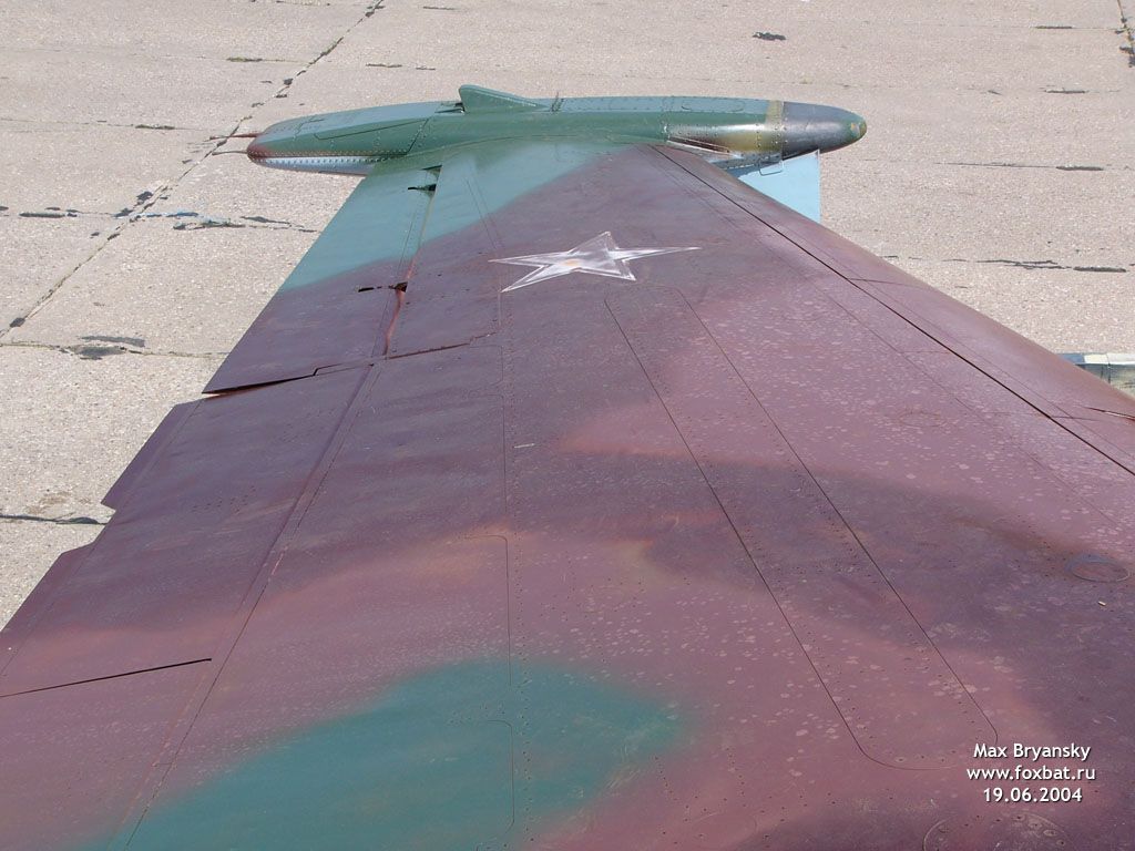

upnorth Posted December 8, 2015 Share Posted December 8, 2015 Nice page with good photos, but ... If you want the real Su-25 must not work according photos the Czech and Slovak Sukhois. Visible difference in the ailerons. Different series were different the rear fuselage, ailerons, lights on the undercarriage. Photos bays that are on that page are for Su-25. A double version UB a single seat BM, has a wholly different bays. Also there are details such as armor electronics cover on nose, different location el. blocks in the nose, and many more ... Interesting; I had no idea the Czechoslovak Su-25s were that different from anyone else's. Link to comment Share on other sites More sharing options...

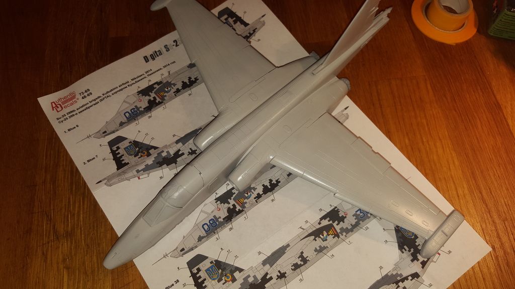

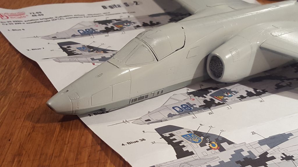

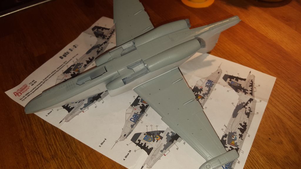

Muzz Posted December 8, 2015 Author Share Posted December 8, 2015 Paint on, Akan's Grey-Blue 73023 on the lower surface and Mr Hobby H338 Light Gray on top. 3 Link to comment Share on other sites More sharing options...
harvy5 Posted December 8, 2015 Share Posted December 8, 2015 Muzz you should still do hard cover of kinematics air brakes. 1 Link to comment Share on other sites More sharing options...
harvy5 Posted December 8, 2015 Share Posted December 8, 2015 Interesting; I had no idea the Czechoslovak Su-25s were that different from anyone else's. In Czechoslovakia were used by all production series and were never upgrade the standard 10th series. All were delivered in the years 1984 to 1987. Since 1988 in the Soviet Union during overhaul and medium repairs, upgrade to standard 10th series. Link to comment Share on other sites More sharing options...
Muzz Posted December 8, 2015 Author Share Posted December 8, 2015 Muzz you should still do hard cover of kinematics air brakes. Ah, I see what you mean, not a problem I'll sort that with a couple of bits of spare PE. I've left all the air inlets and other lumps and bumps off just now anyway due to the amount of decals going on. Thanks for that. Muzz 1 Link to comment Share on other sites More sharing options...

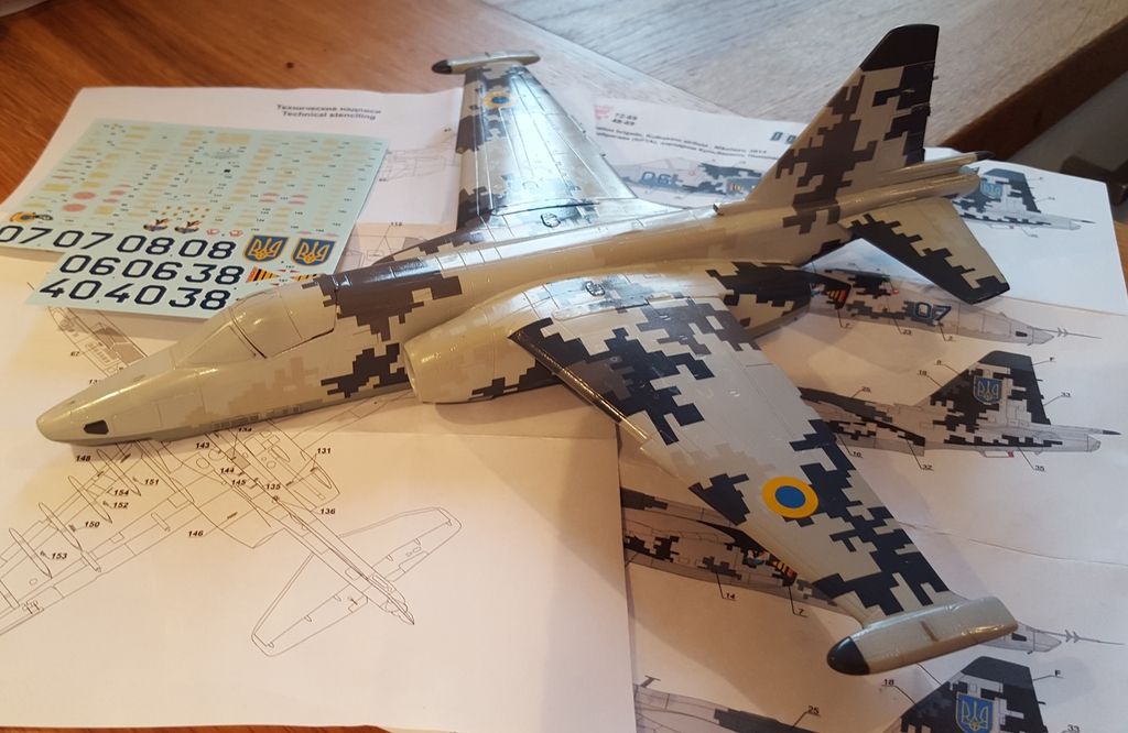

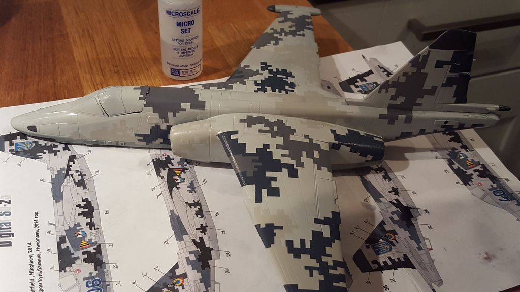

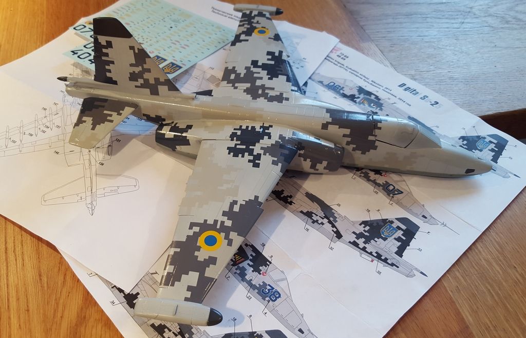

Muzz Posted December 11, 2015 Author Share Posted December 11, 2015 It's been a mammoth decal session so far and maybe half way there, maybe not. The decals have behaved well although the curves some of them are expected to reach round have not been designed into the shape of the decals. Lots of Micro Sol required and a sharp scalpel blade. Here's how it looks so far........ As you can see from this photo I had to cut he decal that went over the top and down he side of the starboard engine intake, I'll be able to fill the gap in with spare bits of decal. (Some small spare sections are provided). If i didn't do this the angles would be all wrong because of the curve. No disasters so far, so quite happy with how its going. 5 Link to comment Share on other sites More sharing options...
noeyedears Posted December 11, 2015 Share Posted December 11, 2015 shame they couldnt get the decal shape right, not really on for a set specifically designed for this plane, ill have to watch out for that when i get around to my one (STILL waiting for the engine mounted flare launchers from Eduard, starting to lose hope even though they assure me they are coming) Link to comment Share on other sites More sharing options...
RMP2 Posted December 11, 2015 Share Posted December 11, 2015 In fairness to the decals - unless loads will be sold then its more financially viable to get pretty close and leave some spare bits on the sheet for touch ups, I doubt theres much profit overall from that set. Nice that they gave you the patch up bits as some sort of concession. Im holding out for the finished job before deciding if Ill go this way with mine, looking good, but also looking about as much work as 4/5 colour camo! Link to comment Share on other sites More sharing options...

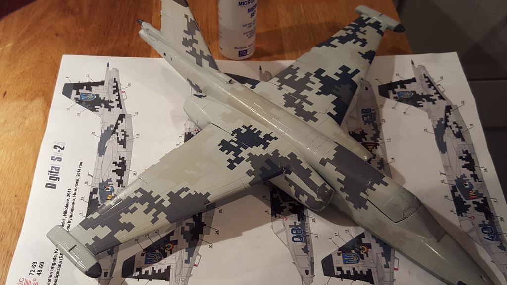

Muzz Posted December 13, 2015 Author Share Posted December 13, 2015 That's all the digital camo decals on and making a start on the rest, there's quite a few stencils to go on and after checking references, there not all entirely accurate but close enough (as I don't have any other option). I've applied another gloss coat over the everything that's down ready for the stencils that will be going over the top. 5 Link to comment Share on other sites More sharing options...

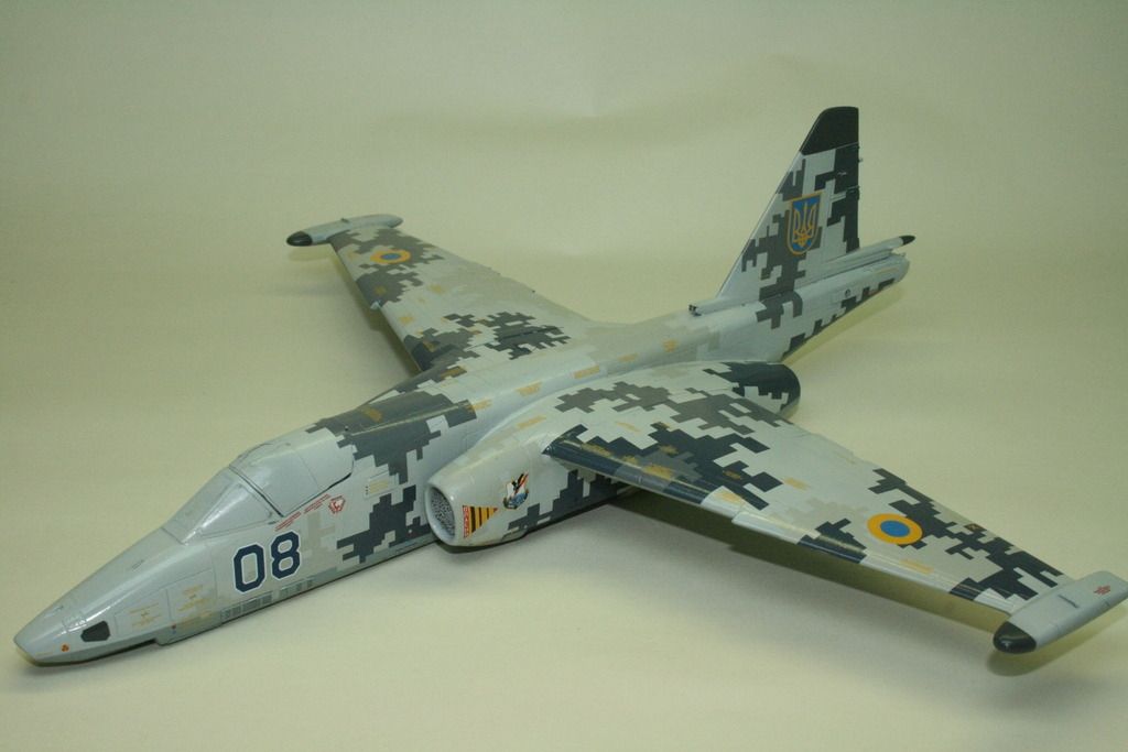

Muzz Posted September 12, 2016 Author Share Posted September 12, 2016 Long overdue an update on this build.......................................... The decals are complete, the stencil decals provided with the Authentic Decal set are not 100% accurate but after some head scratching I decided they're was no other option and they'd have to do. After this I'll be adding the various air inlets and the countermeasures dispensers on the engine nacelles. I'll be working on this again so should see some progress. 5 Link to comment Share on other sites More sharing options...
