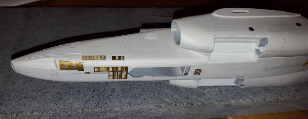

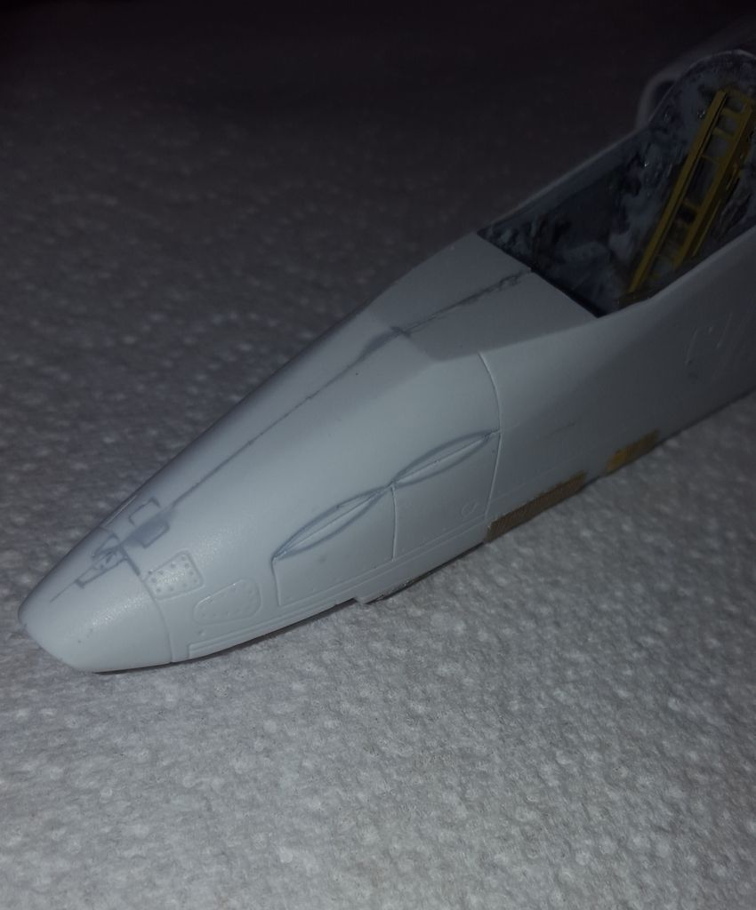

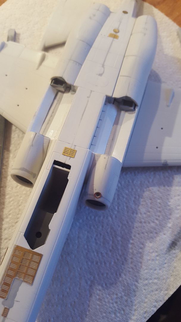

Some more updates, got a lot of the PE added, using both the Eduard set and the Part set as they both have some nice bits of detail....
Filling in some panel lines on the nose that aren't on the real aircraft, this area is actually flat spots on the fuselage panels but have been represented as panel lines on the kit.

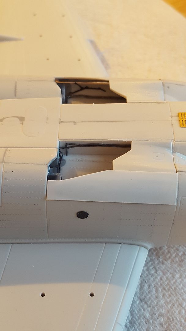

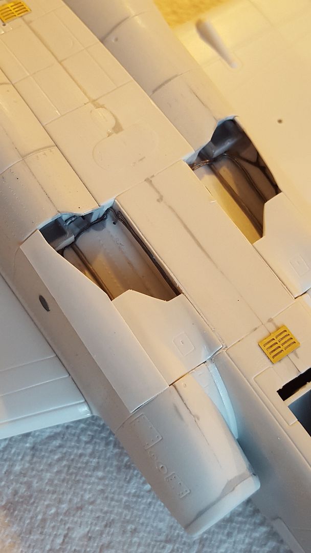

Main wings on as are the intake lips which are seperate parts and have to be blended into the fuselage with some Mr Surfacer.
The under fuselage PE, you can see a gap at the rear of the nose undercarriage bay, this is because I've moved the whole be further forward so that the nose gear leg sits in the correct position. The gap at the rear of the wheel bay wont be visible as the main nose wheel door is going to be in the closed position as it usually is when on the ground. I've drilled out some holes in the lower fuselage including the one just below the intake lip surrounded by PE.

Very well, but forgot the camera on the nose! :winkgrin:
I've still to get round to that! The wheel bays aren't finished yet either, some tidying up needing done and pipes added.

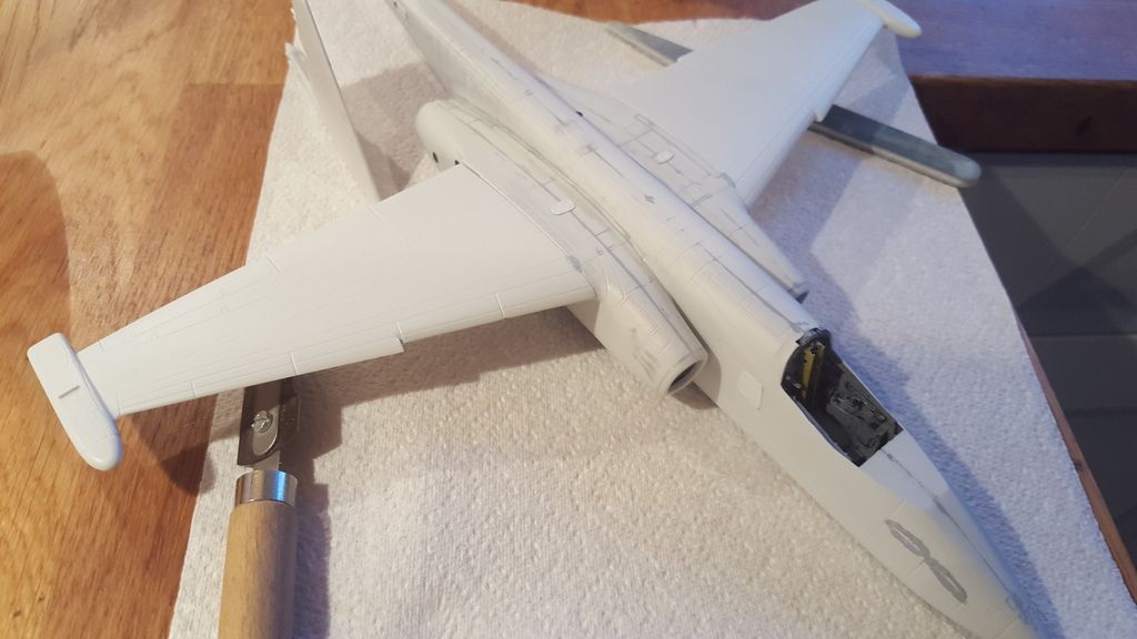

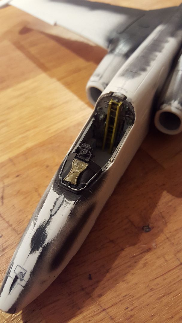

Some more work done between proper work and risking my life climbing on the roof to put Christmas lights up!
Cockpit dash, HUD unit installed.
I cut the one piece main undercarriage doors into the required 3 pieces for the open doors. The fit is pretty bad on the doors hat are in the closed position and quite a bit of cutting and test fitting is required to get something close to a decent fit, ended having to make a new starboard side door out of plastic sheet. This is just the doors placed roughly and not glued into position. Once the gear legs in there and the other open doors added not much will be seen (I hope).
Forward canopy masked and in place and the fin/rudder has been added, always tricky this as there's no locating tabs.
