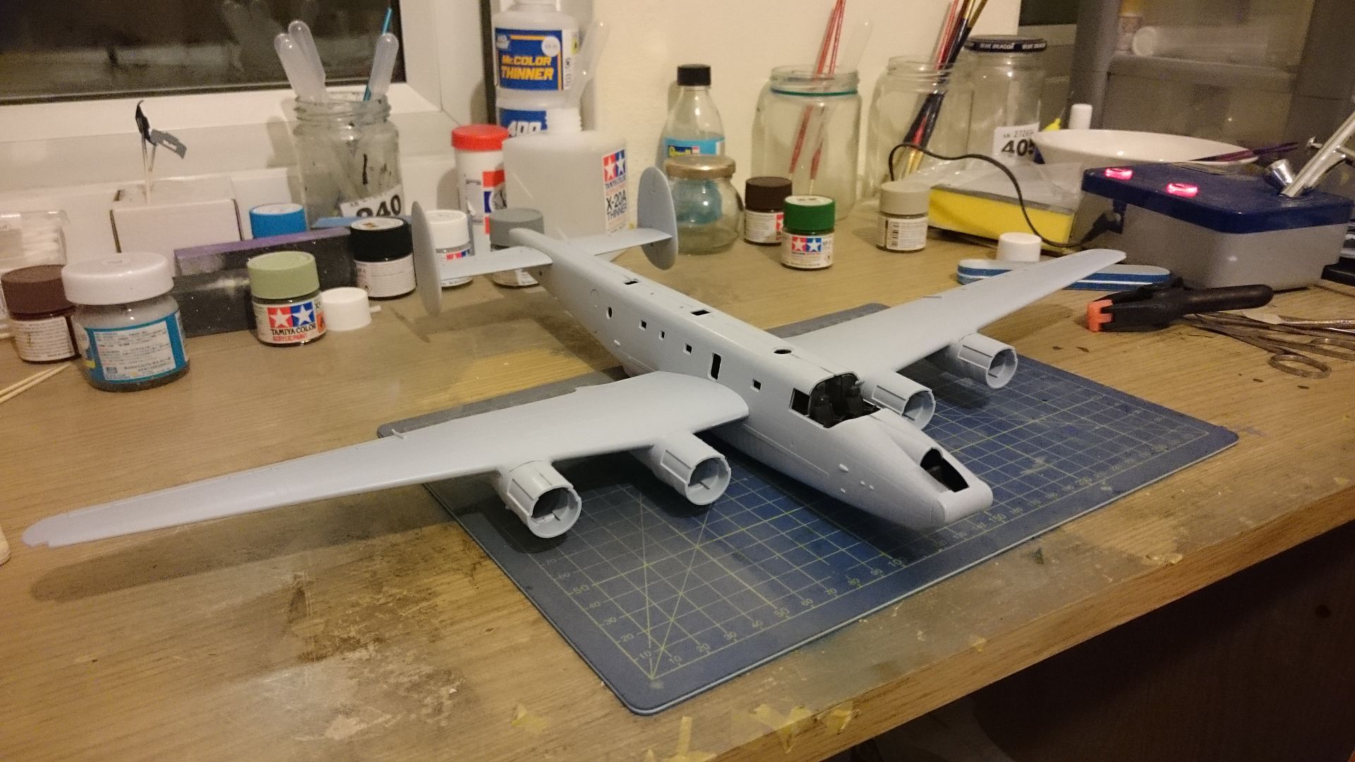

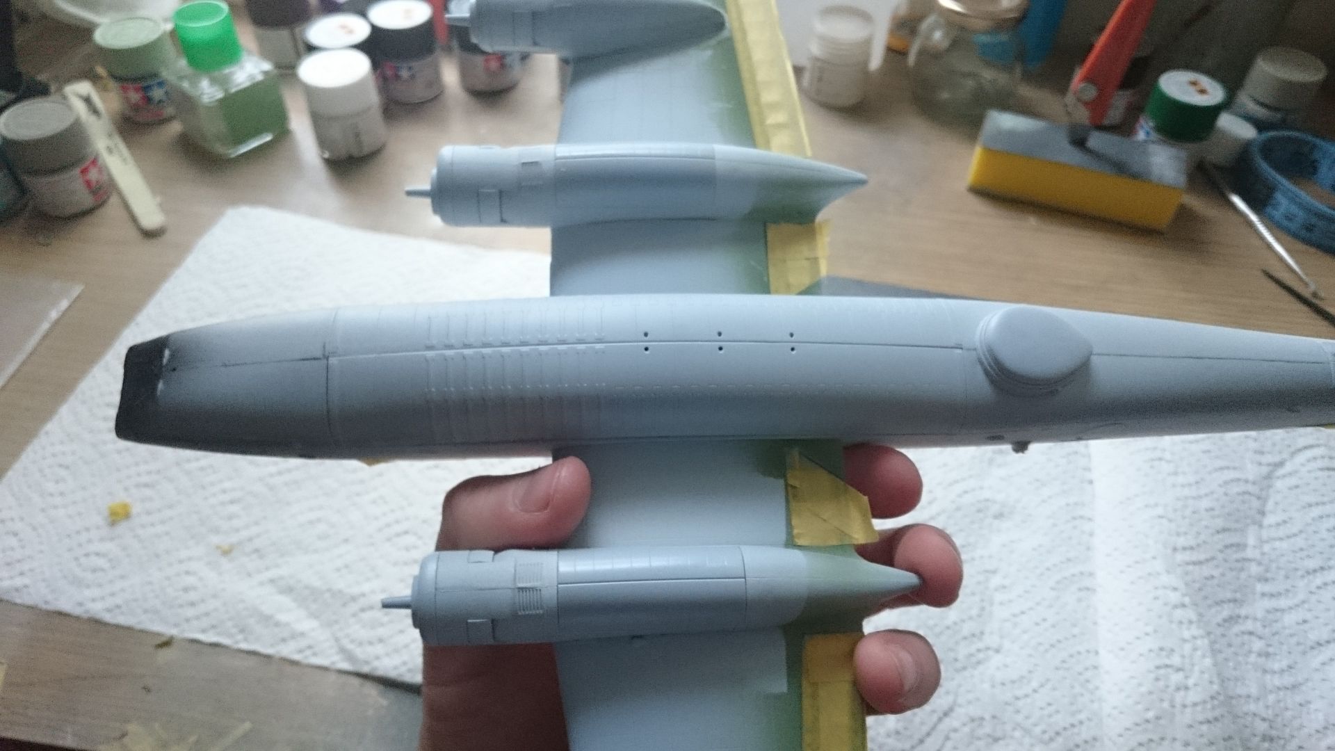

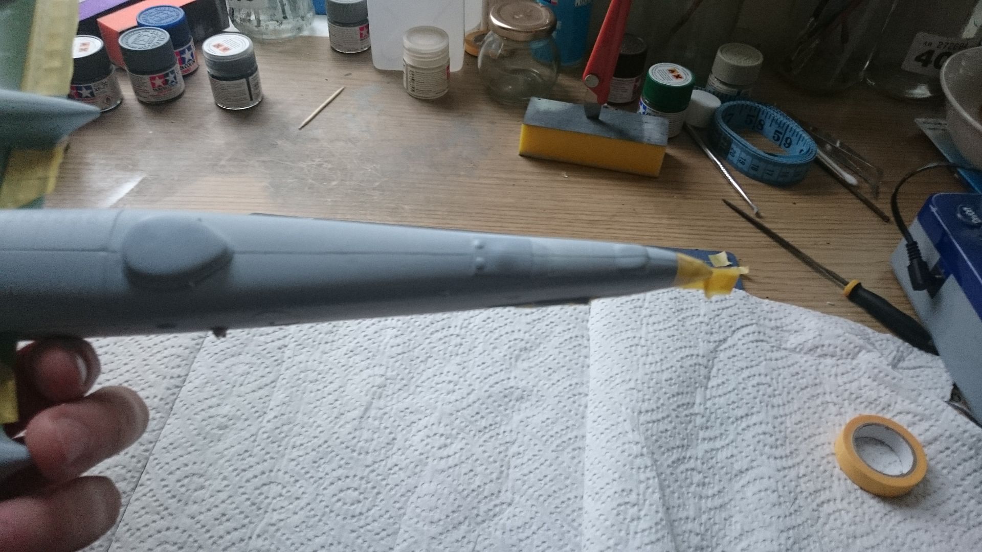

perdu Posted October 26, 2015 Share Posted October 26, 2015 She sure is, I remember thinking that when I did my Froggy one years ago Are the joint lines likely to be hard to eradicate on the fuselage, they look a bit prominent there and I have seen a build with a huge joint line underneath it Somebody at my IPMS branch thought there might be a little concavity round the fuselage joints when he held the parts together I'd love him to be 'not quite right' Link to comment Share on other sites More sharing options...
thepureness Posted October 26, 2015 Author Share Posted October 26, 2015 I'm going to give the areas a coat of primer too see if I they are still prominent and still need some attention, although most of what you might be able to see it my choice of filler, which is green and stands out like a sore thumb on an unpainted kit 1 Link to comment Share on other sites More sharing options...

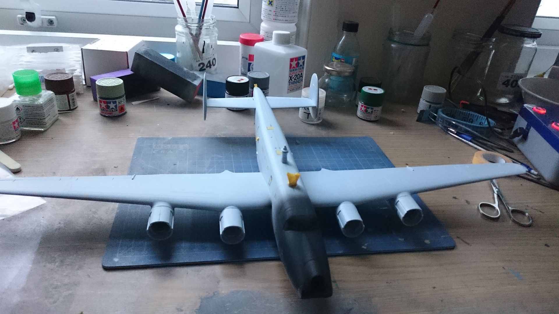

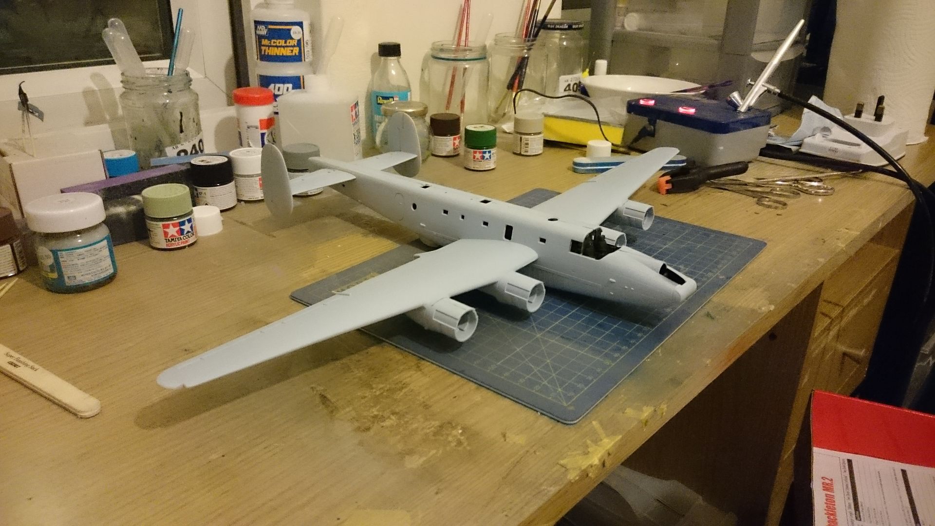

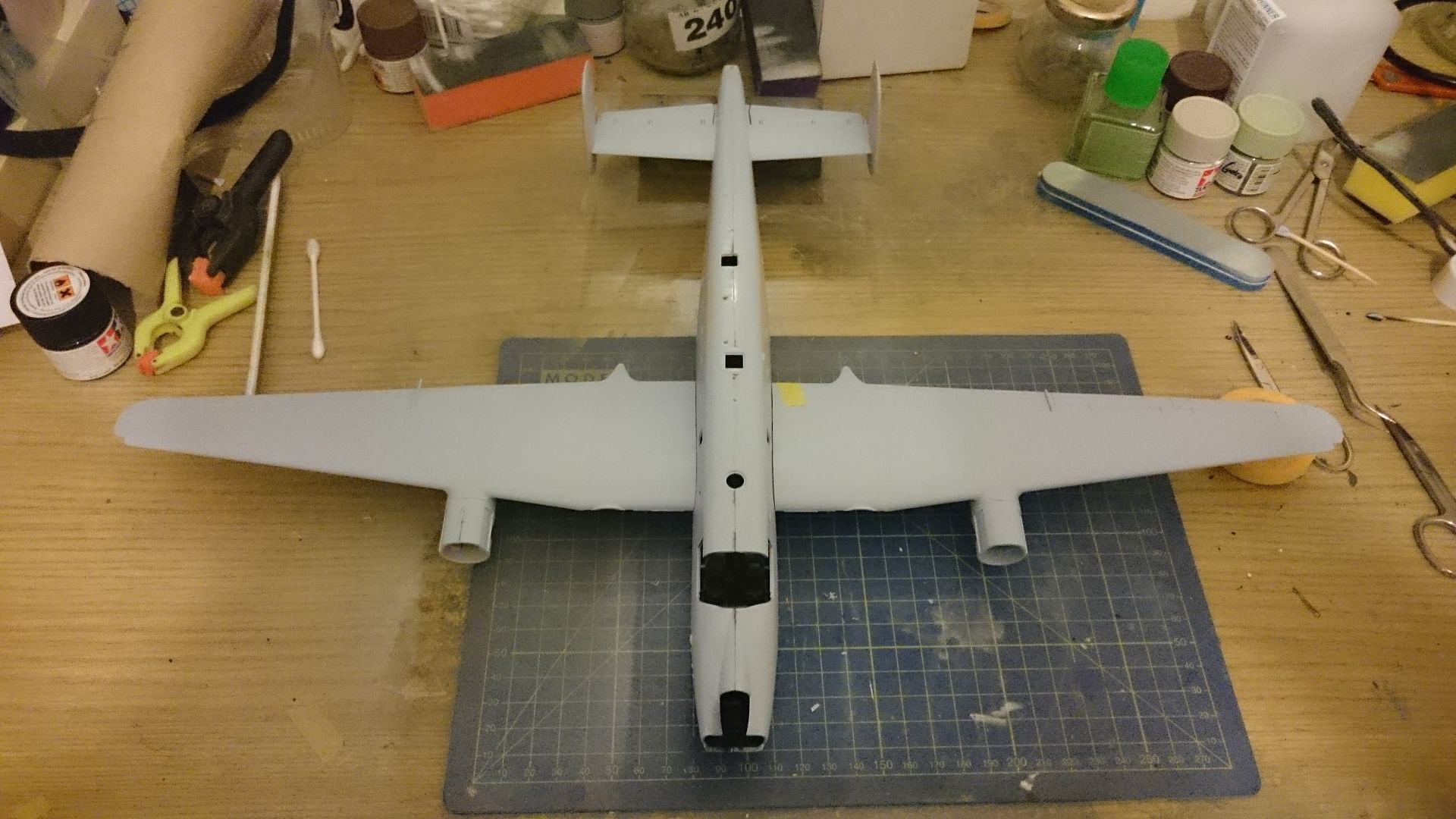

thepureness Posted November 2, 2015 Author Share Posted November 2, 2015 So, little more work done over the weekend, I'm only working one day this week due to cashing in some holiday before the end of the year. I've got to the stage of fitting the engines to the wings and the wings are now fixed in place. I'm going to spend tomorrow getting all the windows/canopy in and masked, there is still a few areas where some mr surfacer will be added to fill some smaller gaps, i'm going to give it a little primer in the areas of the aircraft that are white, I don't usually prime my kits, but the undercarriage bays didn't take very well to the white being sprayed onto the bare plastic, while that can be hidden in some cases, I'll struggle with the upper wings and fuselage areas. anyway, a few pictures 9 Link to comment Share on other sites More sharing options...

richw_82 Posted November 2, 2015 Share Posted November 2, 2015 In regards to the shack, I got home tonight and started some work on the wings and engines, I must admit i'm a little disapointed with the fit of the outer engines to the wings, but hey, we are modelers, what is an extra bit of filling and sanding going to do. Don't worry too much the fit is awful on the real thing too. The nacelle behind the engine is one piece and attaches to the lower surface of the wing using dzus fasteners. It stands proud of the wing as a result. The fillet panel from the wing to engine cowl also sits over the panels on the engine. If anybody gets perfectly smooth cowlings on a model Shack (Revell, FROG, Airfix, Sanger) it always makes me smile, as you can never get them perfect on the 1/1 example. Luckily you don't need to as she's far from supersonic. Great work so far! 1 Link to comment Share on other sites More sharing options...
thepureness Posted November 2, 2015 Author Share Posted November 2, 2015 thanks for the tip rich I've got a few days off work, so managed to get some more done today, all the canopy is now masked. I've also sprayed the black on the front of the aircraft along with the interior color of the cockpit framing, it is going to be interesting getting white to go over that black, but i'm sure it will be ok. I've got to the stage when i'm throwing away empty sprues, which to be shows we are going along at a good speed. 7 Link to comment Share on other sites More sharing options...

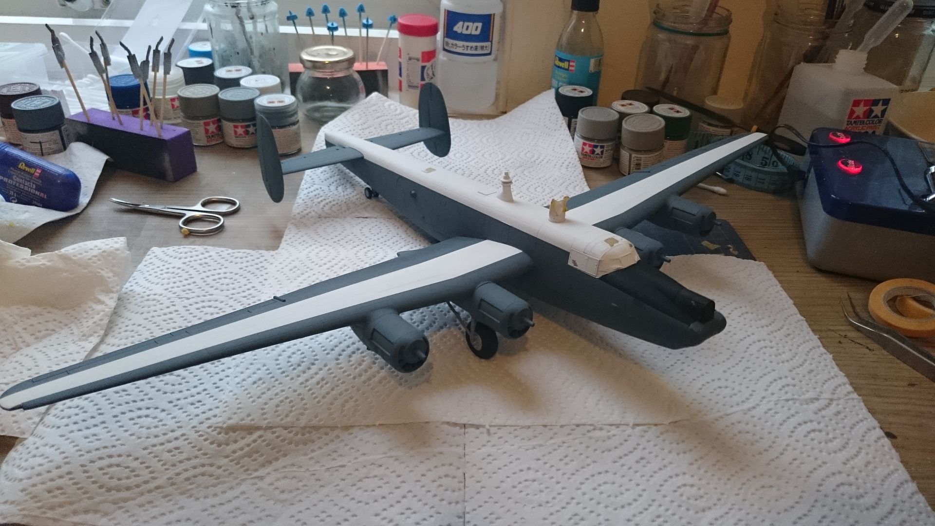

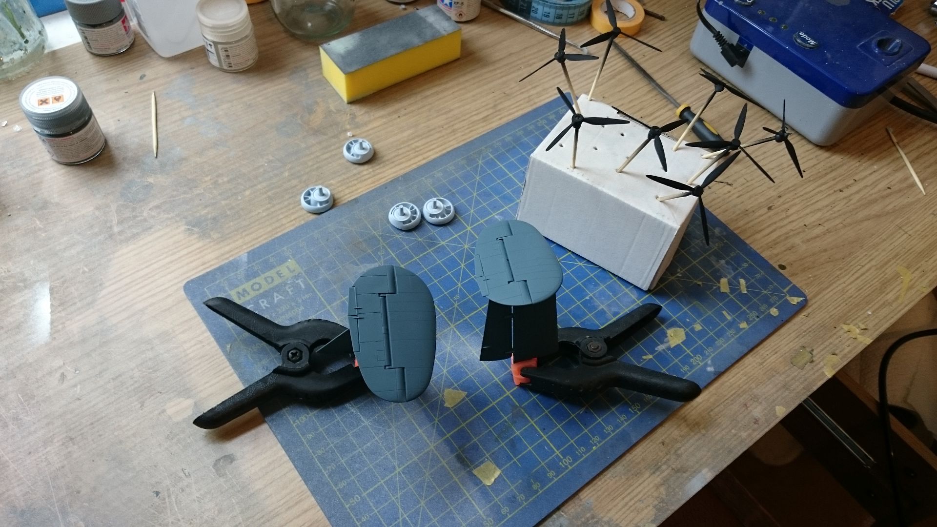

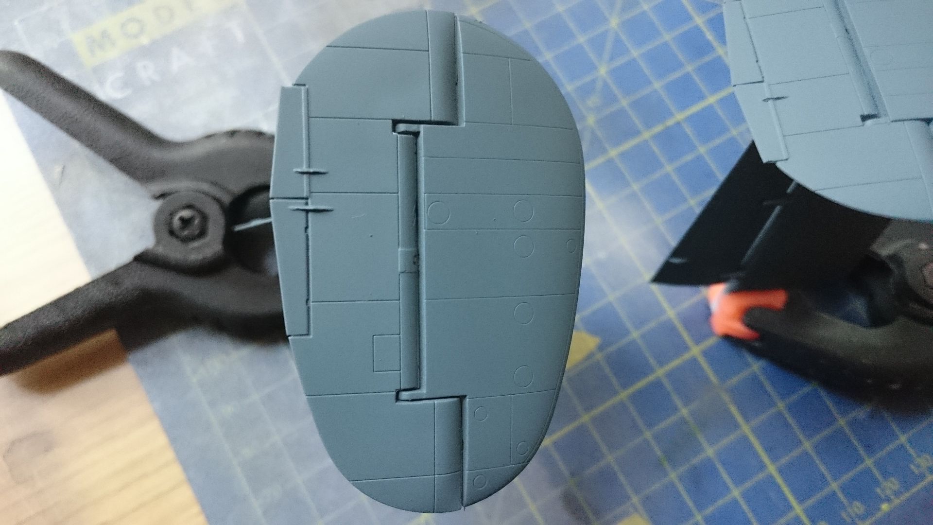

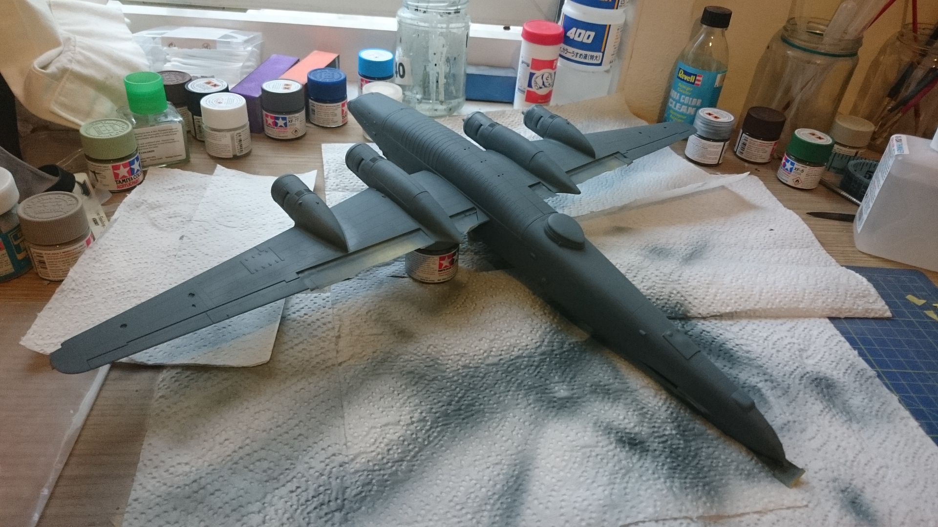

thepureness Posted November 3, 2015 Author Share Posted November 3, 2015 so, again on with some more today, great having a week off work So props painted, i've decided to go with the decals instead of painting the tips, yes, I am a fool. I've always had an issue with getting dark sea gray correct, So I decided to use the same mix that Jen Wright used in the recent issue of Airfix model magazine. roughtly 50/50 mix with XF-82 and XF-77 and a couple of drops of X-4. It looks good enough for more so I painted the tailplanes and the result looks ok, feel free to give your views 2 Link to comment Share on other sites More sharing options...
heloman1 Posted November 3, 2015 Share Posted November 3, 2015 Looking good, I'm glad you left the fins and tail surfaces off untill after painting the fus. The scribed detail looks good under a caot of paint. The SAAF builders down here in SA are all champing at the bit for the AEW Mk3 kit... Colin Link to comment Share on other sites More sharing options...

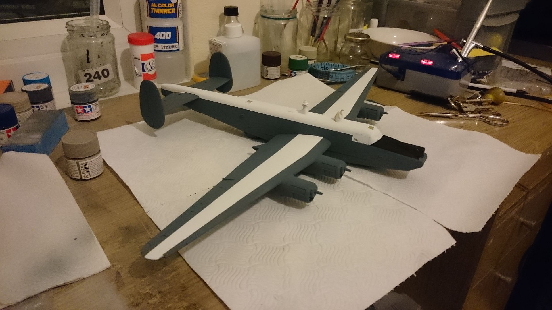

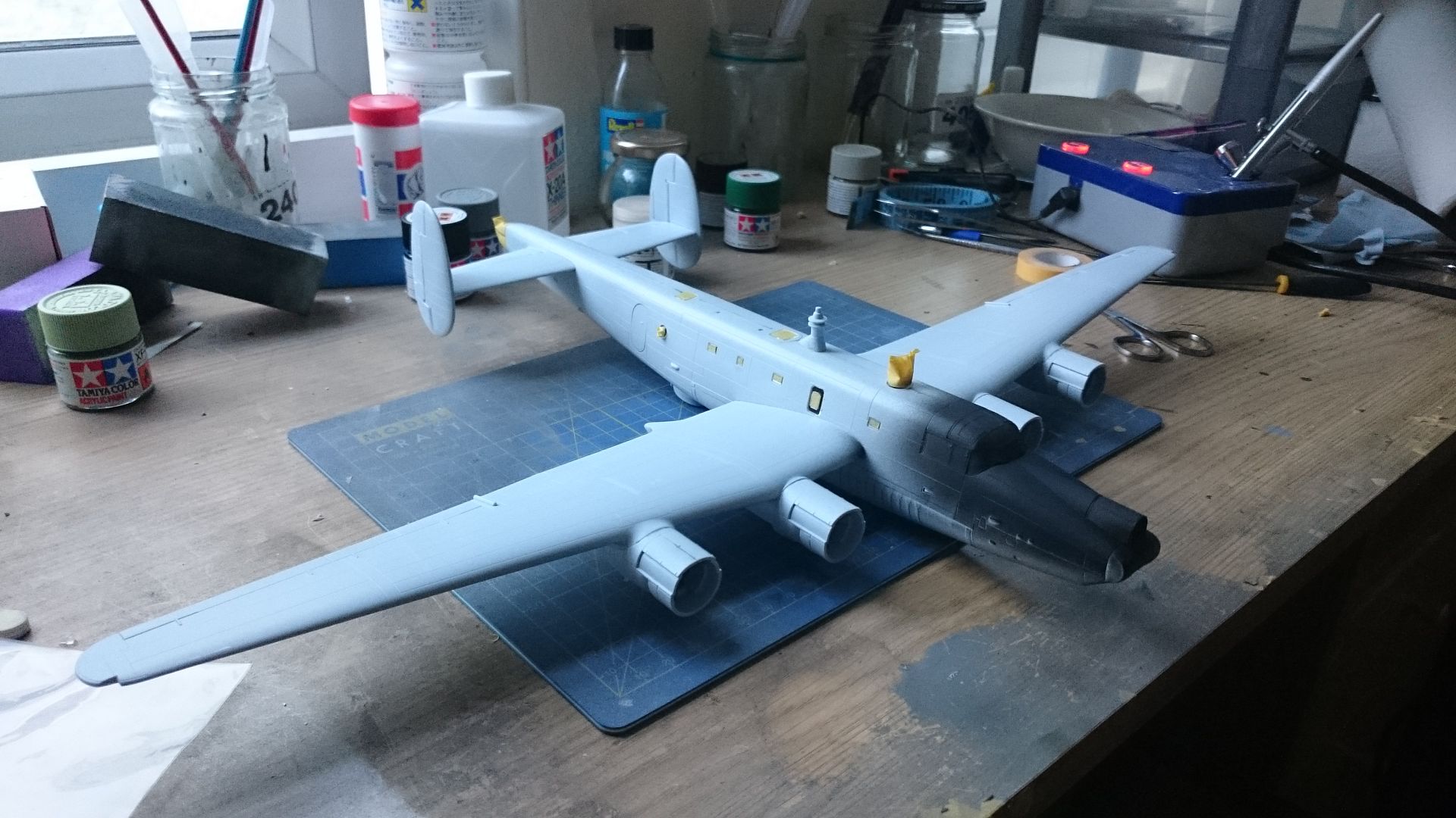

thepureness Posted November 3, 2015 Author Share Posted November 3, 2015 Another update on the shack today, this is moving fast. First, the masking of the white surfaces, with plenty masking tap. I painted the undercarriage bays before the main colour as I found the kit comes with some awesome masks for the undercarriage bay, the close undercarriage doors, these are not glued in, just clipped in place and work out as really good masks for them, as I'll be displaying my kit with gear down these part would have found themselves in the bin, but I found a use for them and now some DSG I'm going far too quickly here 6 Link to comment Share on other sites More sharing options...

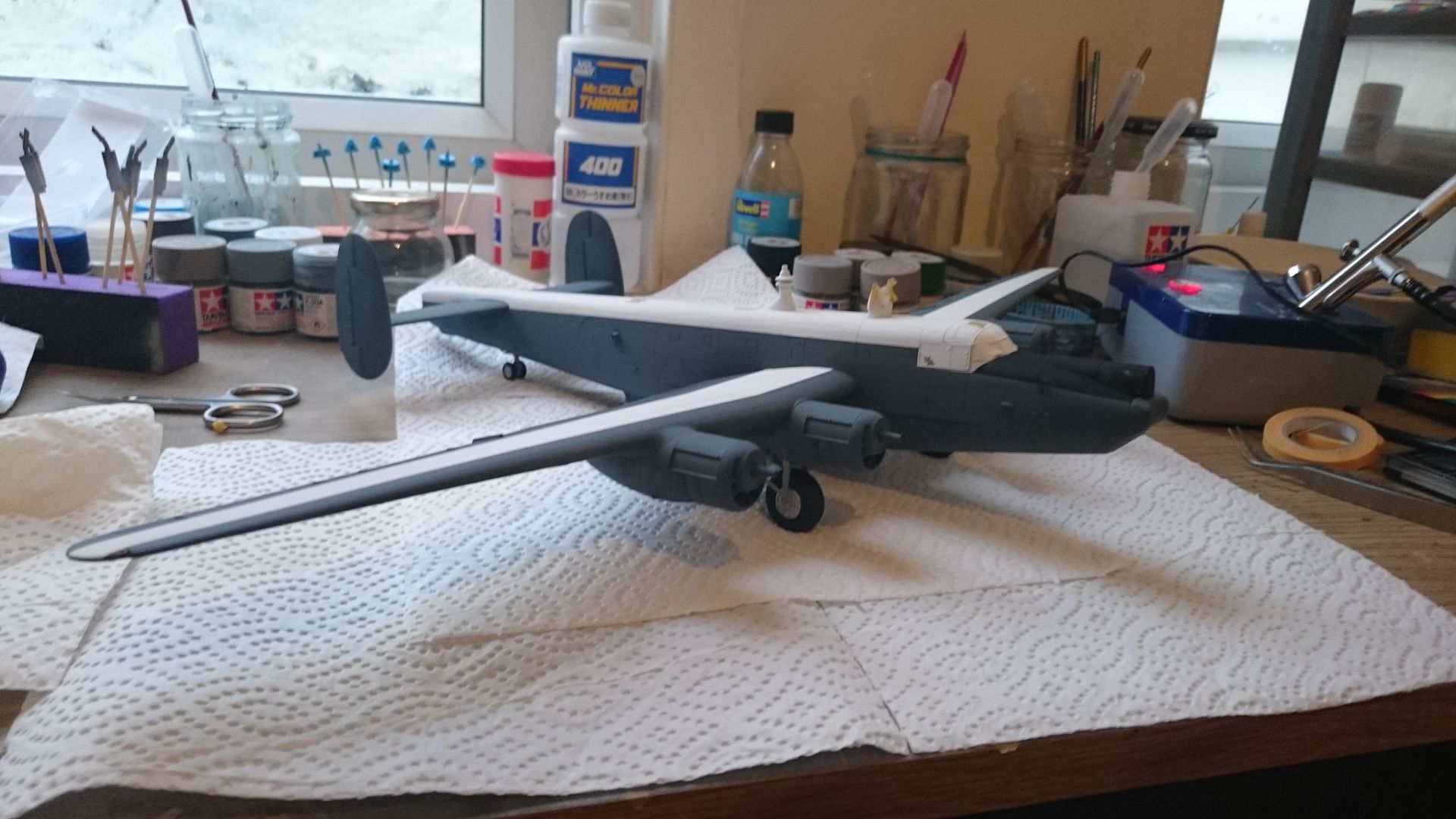

thepureness Posted November 3, 2015 Author Share Posted November 3, 2015 Final update for a few days, masking off, few touch ups required then will start working on the undercarriage. 11 Link to comment Share on other sites More sharing options...
