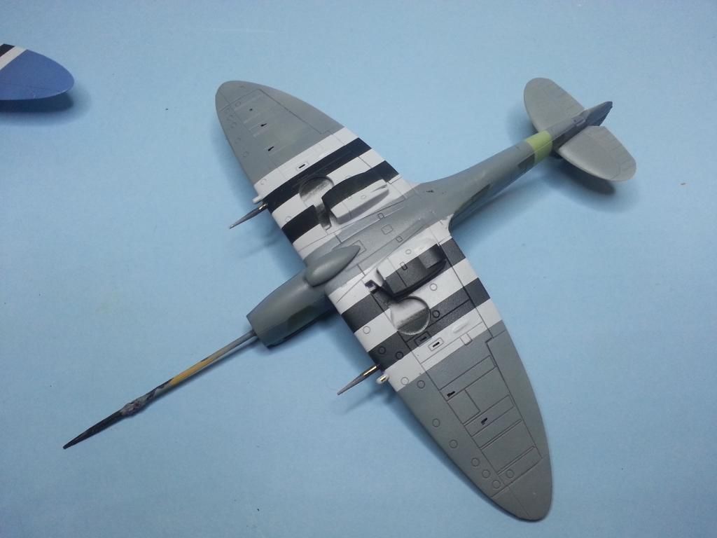

Plasto Posted October 8, 2015 Author Posted October 8, 2015 Are the radiators the same size on the IX and the XIX kits? I've always heard that the Griffon engine aircraft needed bigger radiators than those with Merlins but I'm not sure if this is a myth. Or did you just use the XIX radiators on the IX wings? Hi, The Griffon Rads from the XIX kit are deeper than the Merlin Rads from the IXc. IIRC the Griffon rads fitted to the IXc wing with no issues. Converting the XIX 'wet' wing to take the smaller Merlin rads requires that you chop off the moulded on alignment plugs its then a straightforward fit for the Merlin rads to fit the 'wet' wing. Here an underside shot of the XI conversion and the XIVc for illustrative purposes.. HTH Plasto 1
Meatbox8 Posted October 8, 2015 Posted October 8, 2015 That's a great Spit XIV. I was thinking of doing this cross-kitting myself so seeing someone pull it off has definitely inspired me to try it. Hi, The Griffon Rads from the XIX kit are deeper than the Merlin Rads from the IXc. IIRC the Griffon rads fitted to the IXc wing with no issues. Converting the XIX 'wet' wing to take the smaller Merlin rads requires that you chop off the moulded on alignment plugs its then a straightforward fit for the Merlin rads to fit the 'wet' wing. Here an underside shot of the XI conversion and the XIVc for illustrative purposes.. HTH Plasto Spit XI is looking good. How did you do the deeper 'chin'?

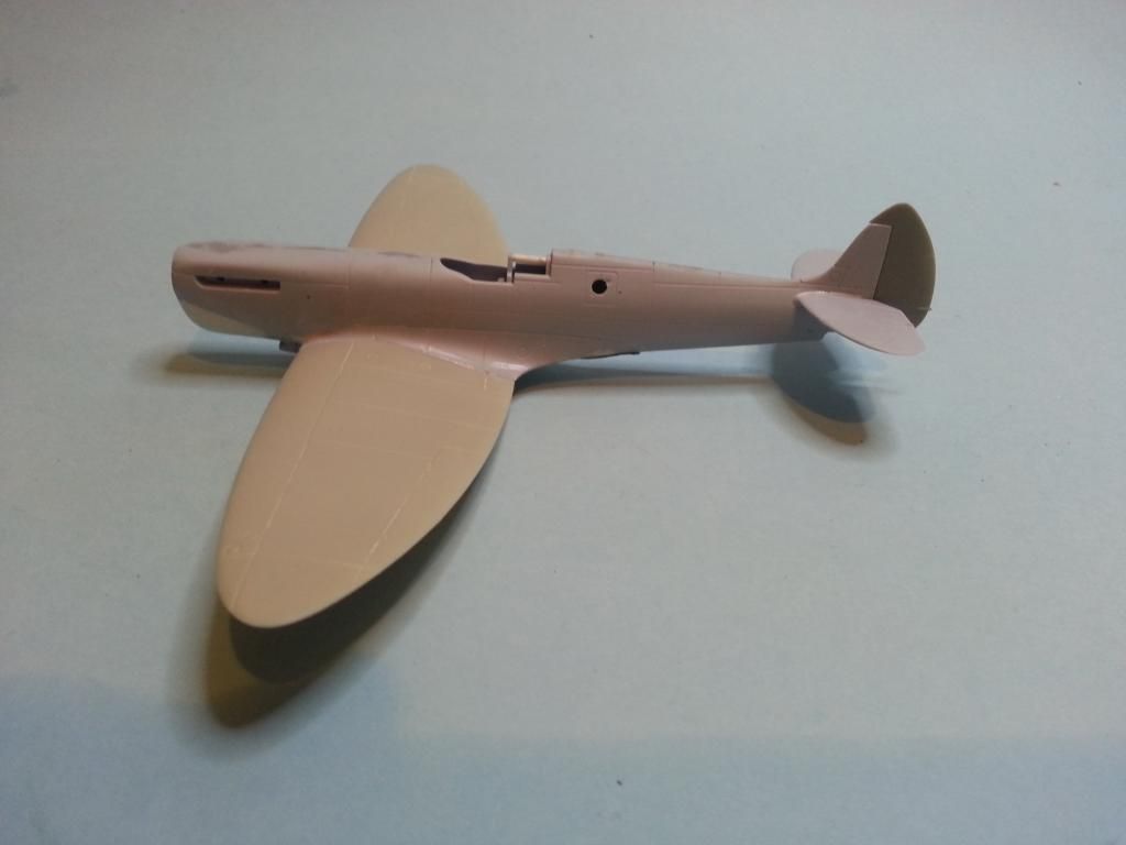

Plasto Posted October 9, 2015 Author Posted October 9, 2015 (edited) Hi, Glad you like the XI. The chin was relatively easy. I got a side profile of both a mk IX and a mk XI and scaled them to 1/72 that gave me a correct nose profile. I made a plastic card former of the correct profile and glued this to the centre line of the nose and then added milliput which I shaped to the correct profile. Here it is in construction the broader chord rudder and belly tank are from a Hasegawa mk VIII. Cheers Plasto Edited October 9, 2015 by Plasto
