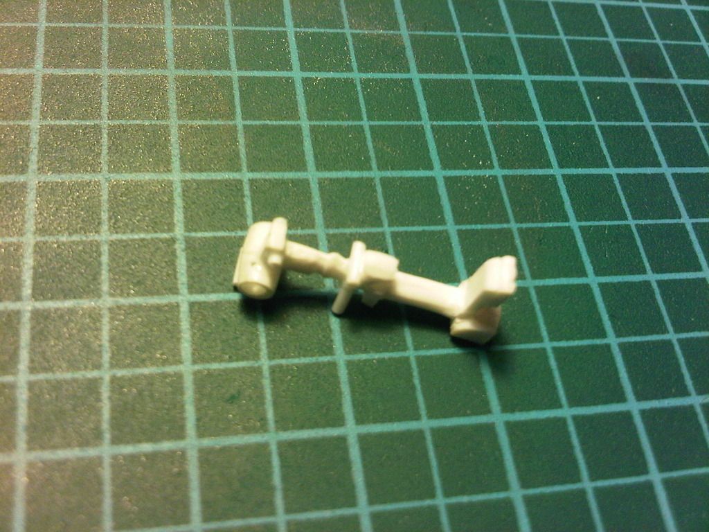

I have cut some plastic, hurrah!
Starting with the front landing gear. Here's what Revell supply:
I have been spoiled by the excellent modern Airfix kits! Some of the molding and fit on this kit is going to be problematic.
Here is the fit of the landing gear.
Really loose, so am going to have to do something about this.
Here is the difference in the size of the etched landing gear door vs. the aperture on the kit. Am going to have to change the size of the aperture.
You can also see that I've drilled out the huge lump of plastic in the undercarriage bay and filled the hole with plasticard.
Here's the landing gear with the oversized bits and pieces removed. I've turned the front section into a foot which can be fixed securely when it's time to attach the undercarriage.
Here's the foot with the etched part in place. Covers it nicely:
Here's the component parts. You can see small holes on either side of the landing bay. I will insert the brass rod into these to create the struts:
Slight modifications to the landing gear. I've attached 0.8mm plastic rod to create brackets and hinges to attach the etched parts onto:
I've also attached two pieces of rod to represent the hydraulic rams which turn the landing gear:
Am having a lot of fun with this :)

Hi Danyel,
I agree with Ray about the etch. Kit landing gear on these older moulds are often lacking detail but the Extratech sheet is very comprehensive isn't it!?
Just had a quick look over your posts so far and I noticed that your coroguard decals are for the Airfix 747. Might be worth checking they'll fit the Revell wings.
Looking forward to seeing your build progress!

I think judging by the photos that the etch doors may be a trifle too long. Before committing to some possibly unnecessary chopping, it may be a good idea to confirm how big the real doors are. Maybe someone at the Museum of Flight in Seattle can take a tape measure to their 747 for you?
Link to post

You're not wrong, Ray. It certainly has spruced it up :) There will also be three brass rods representing the three other struts. I am super pleased so far. Time to move onto the next set of undercarriages.
Hi Danyel,
Cheers,
Ian
It is a super etched set. Well spotted on the Airfix type decals, Ian. My plan is to trace the decals onto baking paper and offer them up to the aircraft. If they fit, great, if they don't I'll either cut/resize them or, if that doesn't work, paint the corogard panels.
I think you're probably right, Jessica. I've got a situation where I have to choose the lesser of two evils. The etched component isn't going to like being shortened. You see in this photo, that the door is made from two etched components. if I try to cut the etched parts the end fold will be removed and the internal panel (part 9 on the etched sheet) won't look right anymore. This is the first time I've worked with etch, so am not confident to chop the etch about. I'd rather have a door that looks right than an aperture that is right. I am going to disguise the larger aperture with hypothetical pipework, etc., particularly as the aperture is way too shallow.
Thoughtful ideas though. Please do keep them coming :) This is my first airliner for 34 years. I need all of the advice, haha.
