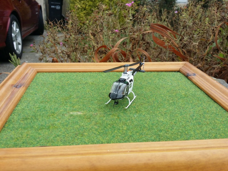

Rodders154 Posted July 27, 2015 Share Posted July 27, 2015 After waiting for to me the highlight of the releases this year only equalled by the upcoming Airfix seaking I am more than deflated I was so looking forward to this kit and even though I am not the most accurate of modellers I feel let down The kit is the old OH58A with a few added parts. First of all the skids are now the high skids which is what I wanted but the bend at the top is far too thick and to be honest they are best replaced with thin wire. The rear cabin has no seats I got around it by using some from the spares box but it really should have been in the kit especially the price they are charging circa £13 The tail pylon has the shaft cover now but not the gearbox housing it may only be a little thing but it should be there as the LAPD aircraft pictures when googled show it in place, The decal instructions are very hit and miss the LAPD drawing shows the placement of the spanish police's tail rotor warning decal as well as the italian aircrafts serial. the drawings and the box art show the right ariel under the tail but the kit suppliers the wrong one The rear doors have the place for the minigun still moulded on but apart from the italian one in the helicopter museum i cannot recal any civvy ones having them I am just disappointed as this was my release of the year and hoped for better. Anyway normal 5ft away looking distance applies Rodders 5 Link to comment Share on other sites More sharing options...
heloman1 Posted July 27, 2015 Share Posted July 27, 2015 Looks good Rodders. sounds like another half ar... Italeri research job. Bet they wouldn't do it in one of their armour kits? Thankfully I have a couple of the 48th ESCI kits Colin 1 Link to comment Share on other sites More sharing options...
Rodders154 Posted July 27, 2015 Author Share Posted July 27, 2015 Looks good Rodders. sounds like another half ar... Italeri research job. Bet they wouldn't do it in one of their armour kits? Thankfully I have a couple of the 48th ESCI kits Colin Don't rub it in.... Rodders Link to comment Share on other sites More sharing options...
k5054nz Posted July 31, 2015 Share Posted July 31, 2015 It's a bit unfair to say Italeri did a poor research job considering the many differences between the OH-58A and the 206!!! It takes a lot of work to do a JetRanger from this kit. Great job Rodders! I'm partway through a similar conversion and it's tough with such a small model. Link to comment Share on other sites More sharing options...
Shrek51 Posted July 31, 2015 Share Posted July 31, 2015 Hi Rodders, as a builder of all thing Police and EMS I was really looking forward to this one, although you have made a cracking job of yours I may give it a miss. Link to comment Share on other sites More sharing options...
