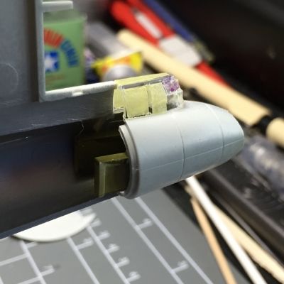

andymoore Posted May 21, 2015 Share Posted May 21, 2015 sticking the cowlings on & masking them before fitting the engines is indeed a good idea - I wish I'd done that, I painted the underside of the cowlings with a hairy stick. 1 Link to comment Share on other sites More sharing options...

Spookytooth Posted May 21, 2015 Share Posted May 21, 2015 Looking good Ced, I would go with the advice given, temporary fix the cowlings in place. That way, hopefully your demarcation lines should match up. Simon. 1 Link to comment Share on other sites More sharing options...

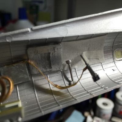

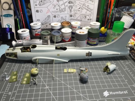

CedB Posted May 22, 2015 Author Share Posted May 22, 2015 Morning all! Thanks Sean and Logical. I won't feel I'm nearly there until the mask sheet is on the clear parts... a big task in itself! Thanks Charlie. You're obviously a man of impeccable taste! Thanks Andy and Simon - I'll proceed with the cowlings idea and let you know how it goes. Thanks Mike and Rob - the Bombay is close to unbuildable and I just got lucky Thanks Stew - credit where credit's due! There will be more to come I'm sure - especially if you continue to increase your scratch building skills... hee haw hee haw! Today I can look forward to more masking. Groan. Until that's done I can't close up the fuselage and start spraying the thing (can't wait). It's the last step before close up - I've just checked again and everything else is done. I did consider / am considering: chucking out the nose masks and trying to find a decal or something for the tiny, tiny bit of frame. Aha! Perhaps I can 'pen it in'? I have a photo of the 'current Belle' as my desktop background (apparently a 'G' masquerading) and it's almost an invisible frame. I can do almost invisible! I think another warning about step 47 is warranted - the 'orders' (faster to type than instructions) clearly say 'paint the nose 'U' - so wrong. making up the engines. Andy's over my shoulder warning about the small differences and getting things mixed up... perhaps I could label them up? Might be a nice 'non-masking' diversion how the heck do you build this thing wheels up? I had the same problem with Airfix's old Dakota. Must research. Paint the props. Nice easy side job. Right. Masking. Right. More later and thanks for looking. Link to comment Share on other sites More sharing options...

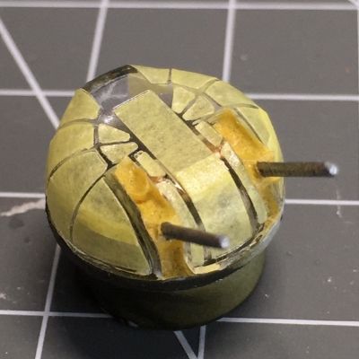

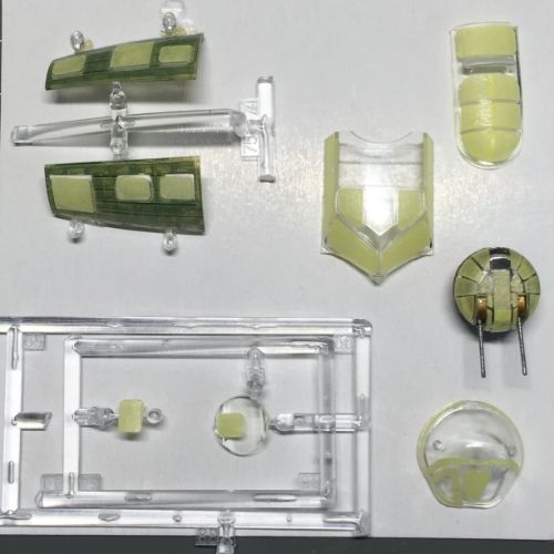

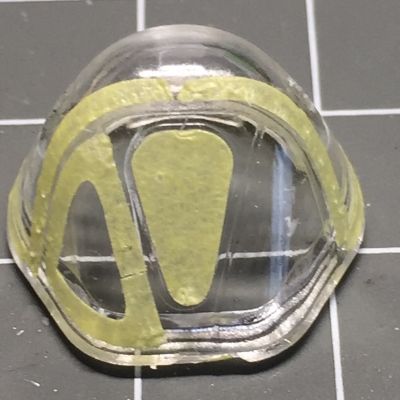

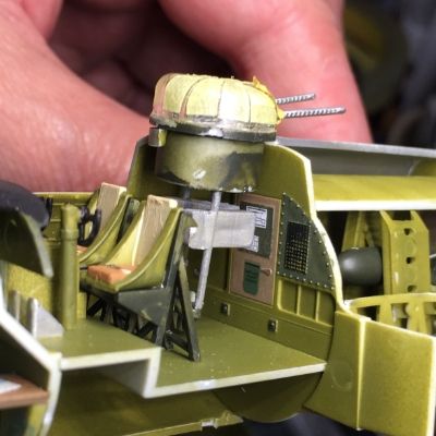

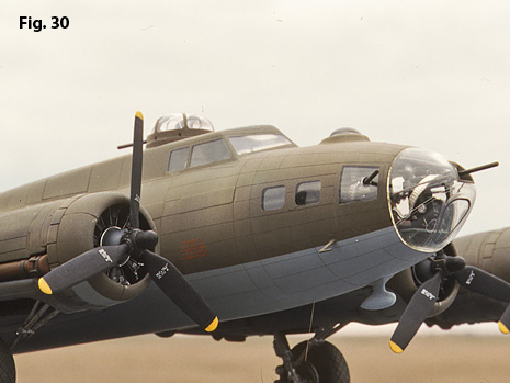

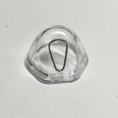

CedB Posted May 22, 2015 Author Share Posted May 22, 2015 OK, if you're going to build one of these buy a mask set. I really enjoy masking canopies (no, really) using Paul B's technique but there's no way I could have done that top turret. 35 minutes. Anyway, done now: Here's a close up of the nose: The one on the left is my pathetic masking job so far. The one on the right is the finished article... just kidding! My name's not Paul Budzik. And yes, that is one of his models. I continue to watch Paul's videos on YouTube and looking at his website with frank admiration. Thanks Paul for sharing and helping me improve my skills, a bit. Decided - that's a job for the Sharpie or something. Edit: Noticed the wobbly masking by the guns on the top turret and now poked with a pin. Any ideas on masking the slots that the guns poke out of? 5 Link to comment Share on other sites More sharing options...

Josip Posted May 22, 2015 Share Posted May 22, 2015 I wouldn't paint the gun railings on the top turret in copper or gold. They were more likely aluminium. I still can't understand why did Revell with all modern technology make that impossibly thick nose blister. It really needlessly degrades this kit. 1 Link to comment Share on other sites More sharing options...

CedB Posted May 22, 2015 Author Share Posted May 22, 2015 Hi ArmouredSprue - welcome to the madness! Thanks Josip - the rest of the mounts are aluminium but this one's brass (humbrol enamel). As always, just following orders! Hi Andy - props used to be a pain for me before I discovered Liquitex pens (yes, it is an advert). First used on my Brigand build (shudder) here and a close up of the results. Now I spray the blades and blob on the pen - easy! More details here. I use these a lot now for interior detailing. Made a bit of progress on the nose. The masked effort Mk II was left for an hour and the mask removed and excess paint scraped off with a cocktail stick. Not too bad but there were some gaps, so I used my new 3/0 brush to dab a bit more paint on. I'll leave that to dry a lot now and then carefully cut off the excess. Also masked the top turret (WWND - What Would Nigel Do?) by making a hole in some 2mm masking tape, pushing it over the guns and then carefully prodding it into the slots: Looks like I need to do a bit more prodding! I can re-coat the guns any time. Close up later? Nervous! 3 Link to comment Share on other sites More sharing options...

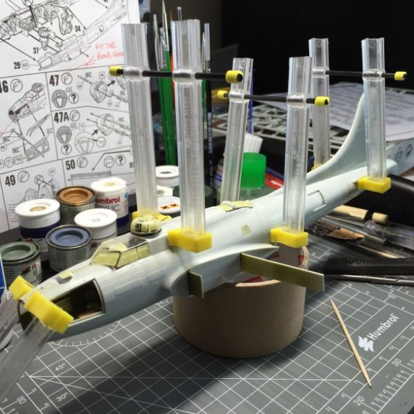

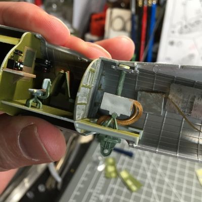

CedB Posted May 22, 2015 Author Share Posted May 22, 2015 Wow, thanks Jon! I am honoured to be in such great company! Right, "Hold on to your hats Boys!" - close up time! Ready... Steady... top turret in... oh, hold on a minute, the ball turret assembly won't fit through the hole with the ball on. OK, ball off... through the hole, ball back on*... Er, steady again... rear turret on... mask the waist windows from the inside and attach guns to the tape so they don't get lost... GO! Clamped, aligned, clamps tightened, TET down the join just on the top (I'll do the bottom later **). Fit canopies (already masked). Canopies fit really well so applied with Glass n Glaze. And rest... phew. Plans: - turn over, align and glue bottom and then do the lower fuselage join ** - fit the cheek windows with Copydex (latex glue) so I can spray and then remove, fit guns and glue back on properly - mask front OR fit the nose with Copydex so I can spray and then remove, fit guns and glue back on properly - do not forget the bomb sight! Nose is ready: I think that's as good as it's going to get. Step back and imagine it on the ceiling. I'm a bit worried about the join and the paint finish across the nose joint so either: I'll fit the nose with Copydex, mask it up and spray or I'll fit the nose later, brush paint the join and 'weather it' We're out tonight, the girls are back for the long weekend and my birthday celebrations ('proper' day next Thursday) so I shall be in and out . I'll post what I can, when I can and see you later! Thanks for looking. * Do not try this at home, fnaar fnaar. ** Score 1, fnaar fnaar. 8 Link to comment Share on other sites More sharing options...

Josip Posted May 22, 2015 Share Posted May 22, 2015 Be sure to store the fuselage like in the picture, because ball turret mounts can easiliy be damaged if you leave it lying around without undercarriage (ask me how do I know that?) Josip P.S. I love those clamps! 1 Link to comment Share on other sites More sharing options...
Cookenbacher Posted May 22, 2015 Share Posted May 22, 2015 Beautiful build Ced. It is a bit of a shame to button up all that interior detail, but we'll all know that it looks like a B-17 on the inside as just as much as on the outside. 2 Link to comment Share on other sites More sharing options...

Nigel Heath Posted May 23, 2015 Share Posted May 23, 2015 Nice masking. Congratulations on getting the fuselage closed up - this is always a significant milestone on any build. 1 Link to comment Share on other sites More sharing options...
