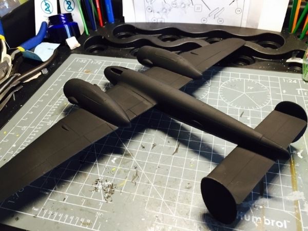

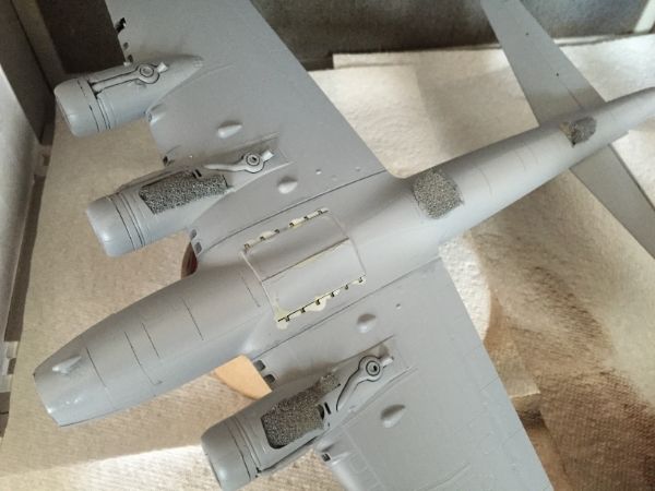

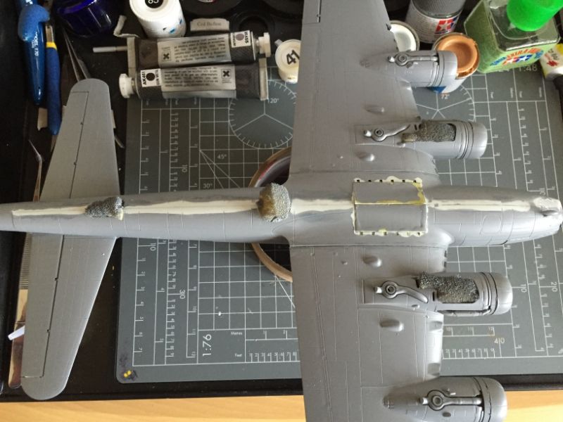

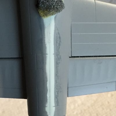

CedB Posted May 27, 2015 Author Share Posted May 27, 2015 Another request for help please. From some angles and in some lights the seam looks OK: The lumps around the bomb bay are intentional - Maskol - the doors will be opened later (qv). The problems are this seam and the filled 'hatch' on the nose: Easy question first - the hatch. Can I blob some Mr Surfacer 1000 on there, brush paint and do some 'weathering' later? The seam. I suspect that the Vallejo putty is discolouring the paint on the seam - I had similar problems with 'not cleaned up properly excess' on the Brigand wing roots: Some people never learn and I'm obviously one of them! In future I shall only use the Vallejo in small gaps and make sure I clean up afterwards. Or perhaps just throw it out. It may be the cause of 'obvious' seams on my and others' models? I have some PPP that I've been saving, for some strange reason, so that'll come out in the future. For this one it looks as though I need to sand it all down, ignore the fuselage flattening and re-scribe / re-paint. Unless anyone has a quicker method? I'll be masking up and spraying the top today (if I get time) so I'll let you ponder! Any ideas appreciated! Thanks guys and thanks for looking. 1 Link to comment Share on other sites More sharing options...
rob85 Posted May 27, 2015 Share Posted May 27, 2015 (edited) I can't think of another way Ced but then I don't know much... Other than that your bottom looks great! (Snigger) The rattle can did give a very good finish Rob Edited May 27, 2015 by rob85 1 Link to comment Share on other sites More sharing options...
GREG DESTEC Posted May 27, 2015 Share Posted May 27, 2015 Looking good Ced. Seam work is a bit hit an miss for me, when in doubt i get a bit OTT with the sanding sticks. As you say it looks better from different angles or lighting. I would go with lighter grade sanding/polishing till it looks right to you. These are the tasks that involve persistance/patience, and in my case can make or (hopefully not) break a model. Good luck mate! 1 Link to comment Share on other sites More sharing options...
Nigel Heath Posted May 27, 2015 Share Posted May 27, 2015 Easy question first - the hatch. Can I blob some Mr Surfacer 1000 on there, brush paint and do some 'weathering' later? It looks like it needs a bit more sanding and filling. Mr Surfacer 1000 is very thin and I doubt it would be able to hide the lumpiness there. The seam. I suspect that the Vallejo putty is discolouring the paint on the seam I'm not sure about it discolouring paint but it is very prone to shrinkage, its really best suited to very fine gaps. Don't throw it out, it certainly has its uses. 1 Link to comment Share on other sites More sharing options...
CedB Posted May 27, 2015 Author Share Posted May 27, 2015 Thanks Rob and Greg - looks like a big sanding job is on the cards then! Thanks Nigel - I'll keep the Vallejo for fine gaps, do some more sanding on the nose and then out with the PPP! All daunting jobs next on Belle - the sanding and masking. I may roll some a lot of Blutak ready for the fuzzy demarcation masking whilst watching some rubbish relaxing TV tonight. Thanks guys! Link to comment Share on other sites More sharing options...
sean Posted May 27, 2015 Share Posted May 27, 2015 I use the Vallejo myself, and have never got that discolouring, but then I brush paint with Humbrol. It might be better to brush a coat of paint down the seam perhaps? Sean 1 Link to comment Share on other sites More sharing options...
CedB Posted May 27, 2015 Author Share Posted May 27, 2015 Thanks Sean, interesting! Perhaps it's the Tamiya / Vallejo mix? I rushed upstairs and ran some of the Tamiya brush acrylic down the seam. It looks darker at the moment but may calm down (hopefully) otherwise it's out with the sanders tomorrow! 1 Link to comment Share on other sites More sharing options...

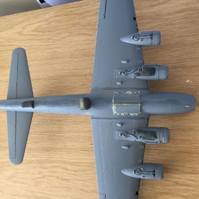

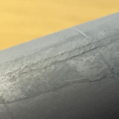

CedB Posted May 28, 2015 Author Share Posted May 28, 2015 Well, not only did the seam fairies not turn up again but I've found that the Tamiya pot is not the same colour as the spray. Rats - I bought that for touching up. It's also quite grainy when brushed un-thinned. Another lesson learnt. I also thought 'Crikey, I hope I haven't left that Maskol on for too long': Either I left the Maskol on for too long or I didn't wait long enough for the primer to go off. So, looks like sanding, sanding, sanding. And then some re-scribe. I may be gone some time... Thanks for looking. Link to comment Share on other sites More sharing options...
06/24 Posted May 28, 2015 Share Posted May 28, 2015 A gentle polish should see you right. Chin up chap, your production speed for this is still mightily impressive. 1 Link to comment Share on other sites More sharing options...

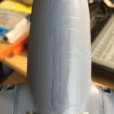

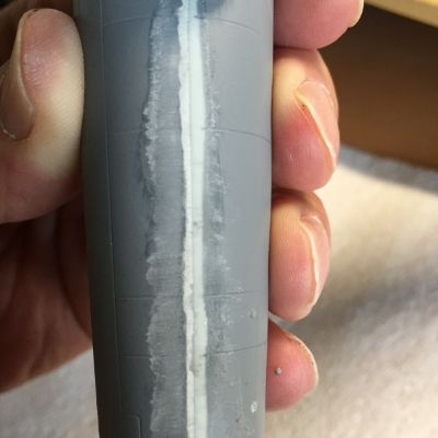

CedB Posted May 28, 2015 Author Share Posted May 28, 2015 Thanks Rob, I needed that motivation! Thanks again John for the link to Suddensky's thread for tips on painting the exhausts. He points to a thread here. I'll try to do that 1/72 with the exhausts fitted! I don't know whether you ever get this feeling, but sanding is one of those jobs where I think "I can't be bothered to do that" for a while and then all of a sudden the urge comes over me and off I go! And then I do the sanding*. So this afternoon I sanded the seam. To recap (with photos) despite my multi-stage close up I ended up with a small step in the seam. To correct this and to avoid a flattened profile I filled the lower part of the seam with Vallejo plastic putty and sanded it. This gave me a discolouration problem which I tried to correct with brushed paint ending up with this: Initial sanding exposed the white putty, of course, so I angled the (wet) sanding stick to the higher edge of the seam and sanded until the feathered white putty vanished: I then went over the brushed paint with a fine belt sander to polish it off (thanks Jon!). Here she is now, drying and waiting to be re-scribed: I don't know whether you ever get this feeling but re-scribing is one of those jobs... you know the rest - I now need to wait for the urge to take me. After that I'll airbrush the bottom* with some of the decanted spray paint. Does anyone have any idea why the jar of Tamiya 'Neutral Grey' XF-53 is darker when brushed than the spray AS-7? It's going to be a pain. * Dbl-E, score 1, fnaar fnaar 7 Link to comment Share on other sites More sharing options...
philp Posted May 28, 2015 Share Posted May 28, 2015 I have noticed that with a couple of Tamiya paints. Hence the reason I spray the can into a container for touch ups. Unfortunately I have no good explanation for them. 1 Link to comment Share on other sites More sharing options...
Cookenbacher Posted May 28, 2015 Share Posted May 28, 2015 Excellent work on the seam Ced! That's so strange about the Tamiya paint being different in the rattle can. 1 Link to comment Share on other sites More sharing options...
CedB Posted May 28, 2015 Author Share Posted May 28, 2015 Thanks Phil and Cookie! Urges fulfilled: Ta da. So, back to where I was on Monday with a tidy seam. Finally. Masking for the OD next. I don't know whether you ever get this feeling but masking is one of those jobs... just kidding! Better leave that to dry overnight. Question - soft or hard? And the demarcation lines (fnaar fnaar). I can't see in the reference shots. Hard is easier, otherwise a packet of Blutak is going to get rolled (lucky Blutak, fnaar fnaar) 5 Link to comment Share on other sites More sharing options...
sean Posted May 28, 2015 Share Posted May 28, 2015 Nice save Ced, although I feel slightly embarrassed that you've had to do this, who knew one colour could be two? I shall keep my ideas to myself from now on Sean 1 Link to comment Share on other sites More sharing options...
