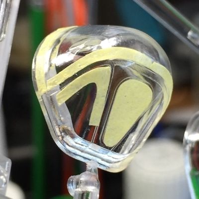

Cookenbacher Posted May 18, 2015 Share Posted May 18, 2015 Once again, you're one step ahead of me in adopting a new modelling tool Ced (which reminds me, I still need to pick up some Liquitex paint markers). I've been using the tape and scalpel masking technique, but am very tempted by pre-cut masks. Hmm, looks like there's advantages and disadvantages alright. Your work on the interior detail is splendid, and leave it to you to choose the most complicated mass market kit available after your excellent Valom builds. 1 Link to comment Share on other sites More sharing options...

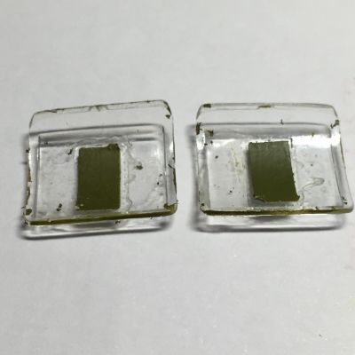

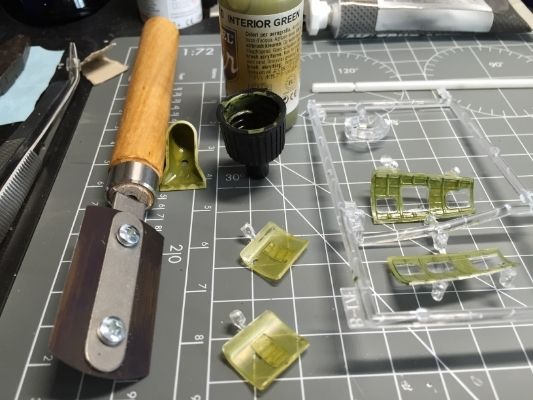

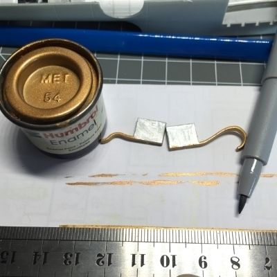

CedB Posted May 18, 2015 Author Share Posted May 18, 2015 Thanks Cookie. "...leave it to you to choose the most complicated mass market kit available..." - I did WHAT!! But it is easy after the Valoms I'm still not convinced about the masks except for complicated jobs like this one. Bit more progress tonight. Carefully masked and sprayed the waist windows (above) and while they were drying I painted the ammunition boxes/ belts. I then fitted the windows 'open': The boxes are True Metal aluminium and the belts are H54 metallic brass. They look... what? Where? What's green? OH MY LORD!!! I need some wine. More tomorrow. 2 Link to comment Share on other sites More sharing options...

Nigel Heath Posted May 19, 2015 Share Posted May 19, 2015 Good luck with that enterprise: Picked the masks out of the bin I hope it works out. but am very tempted by pre-cut masks. Hmm, looks like there's advantages and disadvantages alright. Indeed, sometimes the fit isn't that good but when they do - on a complex canopy framing - I like them a lot. 1 Link to comment Share on other sites More sharing options...

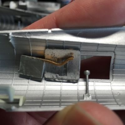

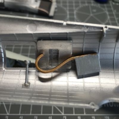

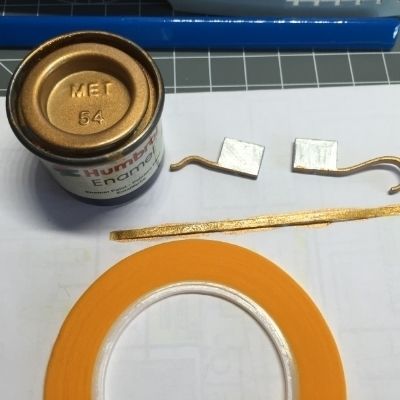

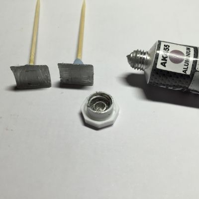

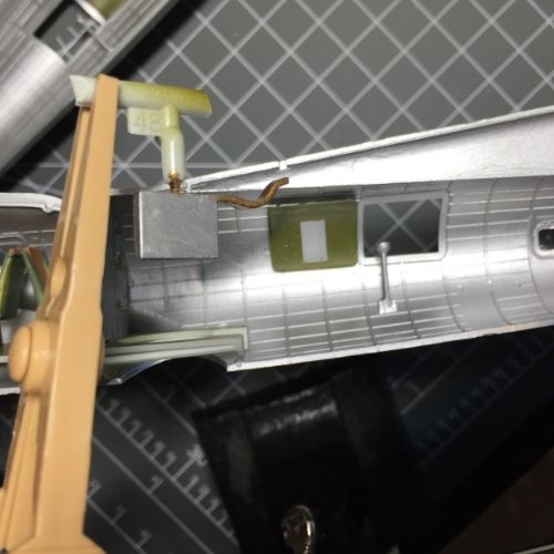

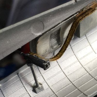

CedB Posted May 19, 2015 Author Share Posted May 19, 2015 Thanks Nigel, Cookie, Rob and Greg. It does look as though I'm getting close but things keep slowing me down. And how many turrets does this thing have?? I'm sure I've done about ten today and I've still not finished. Anyway, the last post was those green aluminium windows and they're fitted. Again. Next step is to fit the ammo boxes (sorry, I can't type ammunition over and over again!). Would it surprise you if I said that the ammo boxes don't fit? Surprise! Those brass bits are supposed to be the ammo belts and no way will they reach the guns. It's at times like this that I think "What would Nigel do?" (Mr Heath, of course) and I come up with a solution that's way beyond my skills. THIS time I also thought "Well, Fozzy made some belts out of tape. I could do that". Madness. So I cut a length 2mm masking tape, folded it back on itself, painted it brass and drew some lines with a pen: Then I stuck the tape to what looked like the feed slot on the guns with some CA, let that dry, put the guns on their racks and stuck the belt to the box with PVA: Quite pleased with those, smug wotsit. The plan is to leave the guns floating on the belts so that I can mask the windows for the top coat and then pull them out and glue them in when the things almost finished. Hmmm. Photobucket's playing up again so I'm going to post this and try again later. 8 Link to comment Share on other sites More sharing options...
Cookenbacher Posted May 19, 2015 Share Posted May 19, 2015 That looks way better than the kit part Ced. Nigel and Fozzy should be proud. 3 Link to comment Share on other sites More sharing options...
Stew Dapple Posted May 19, 2015 Share Posted May 19, 2015 Ooh I do like those ammo belts Ced, nice bit of lateral thinking there Cheers, Stew 2 Link to comment Share on other sites More sharing options...

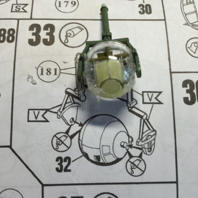

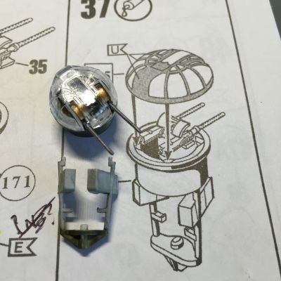

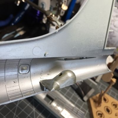

CedB Posted May 19, 2015 Author Share Posted May 19, 2015 Thanks Cookie and Stew, I'm pretty chuffed too! Now, let's see if Photobucket is behaving... Something to watch for in step 29a is fitting the tailwheel housing. There's a tempting wedge shaped slot on the fuselage and a wedge shaped end on the housing. Ignore it or you'll go barmy - the housing fits nicely on top of the hole. I've stuck it with PVA so I can pull it off if there's any problem closing up*. Then it was turrets, turrets, turrets... Watch out for the flash on those parts - I didn't notice until I'd stuck them together and the parts didn't fit in Step 33. I also don't think this is going to hold the turret in as the forks are a bit splayed - I may glue it in place (can't play with it on the ceiling anyway. Also watch out in step 36 - there are two sprues with 4 x part 46 on each but they're not the same length so match two guns before you put them in. And don't glue the gun mount if you want it to go up and down (ask me how I know): Over the page for step 38. More turrets! Thanks for looking. * Dbl-E, score 1, fnaar fnaar. Haven't done one of those for a while! 4 Link to comment Share on other sites More sharing options...
