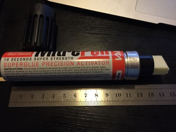

CedB Posted May 12, 2015 Share Posted May 12, 2015 I've bought an activator pen that has a thick 'nib' from here. Here's a photo: Haven't tried it yet but it seems more efficient than a spray? Directions say glue on one surface, activator on the other, hold for 10 seconds. My plan is CA on the location, rub your part on the nib (fnaar fnaar) and Robert is your Father's Brother? (Sorry, "Bob's Your Uncle" for our 'overseas' readers) 2 Link to comment Share on other sites More sharing options...

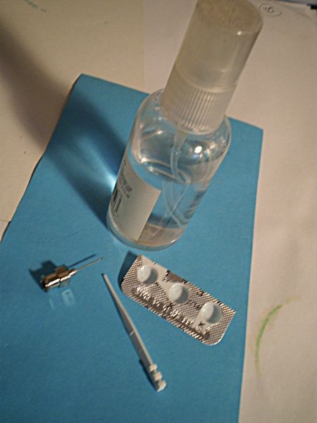

AngstROM Posted May 13, 2015 Share Posted May 13, 2015 The only time I 'accelerate' cyano adhesive is if I'm using it as filler -and that is only where re-scribing is required ('cause I can't seem to make Mr Dissolved Putty scriber-proof). The Loctite variety responds well to a drop of water, and can be sanded almost immediately. Otherwise, gel or liquid types can be decanted in small amounts into the tiny 'bubbles' on empty tablet or capsule strips, and applied finely with a hypodermic needle (just the needle, not the syringe bit) or vinyl toothpick. 1 Link to comment Share on other sites More sharing options...
