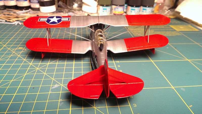

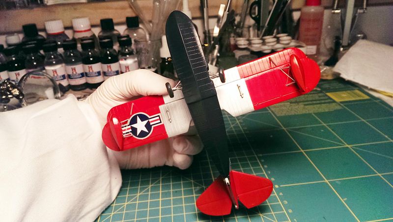

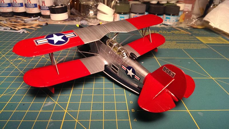

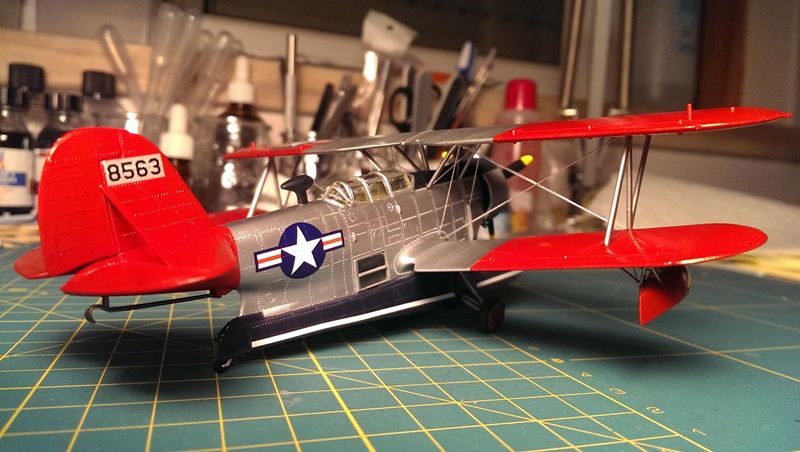

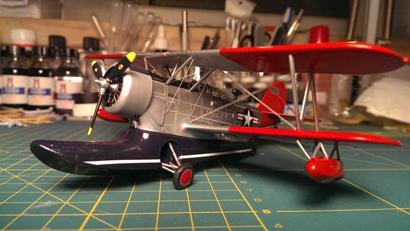

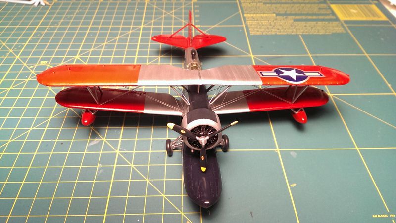

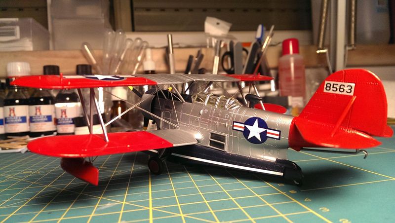

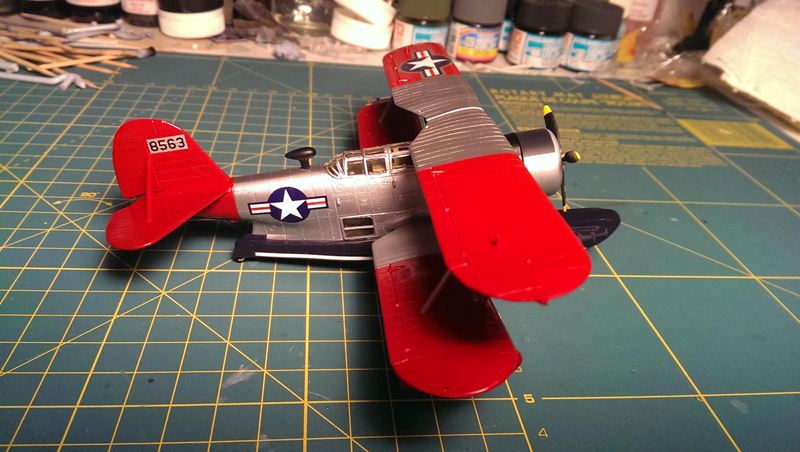

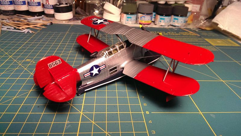

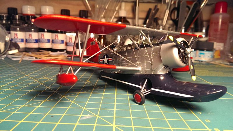

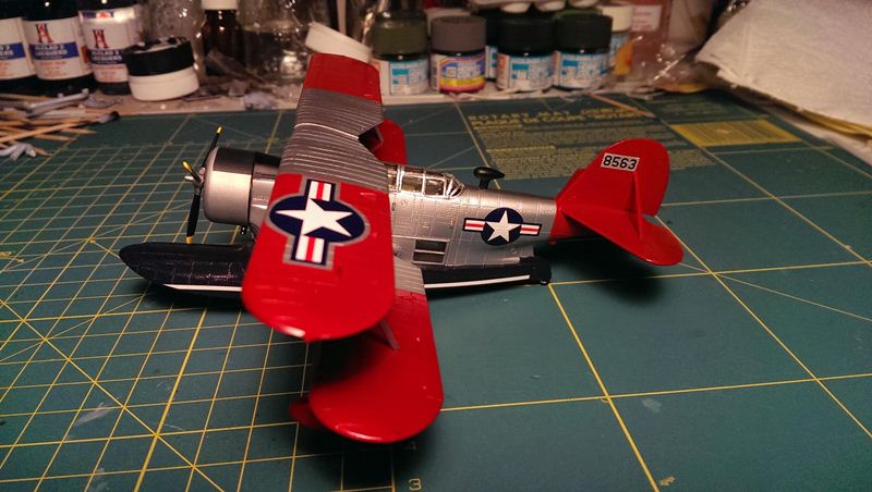

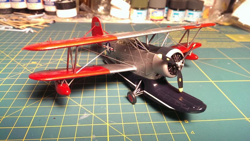

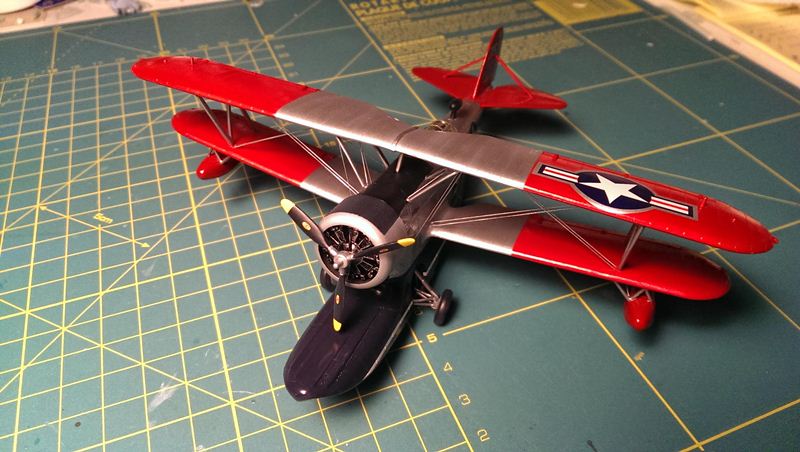

jrlx Posted May 10, 2015 Posted May 10, 2015 Dear Fellow Modellers, Feeling really encouraged by the reception to my first two RFI posts, here is my third This time I'm presenting the Airfix Grumman OA-12 Duck 1/72, in the colours of the 10th Rescue Squadron, USAF, Elmendorf, Alaska, 1948. I started this model in parallel with the Hurricane (posted here) and Spitfire (posted here), in early August 2014. However, just after finishing the cockpit and closing the fuselage, I left it untouched for 2 and a half months, while finishing the other two. I only managed to finish it by the end of January 2015. This kit is a very old mold (1968, according to Scalemates). As such, it was a nightmare to build, since nothing seemed to fit or align properly... Seams were very hard to treat and the general fit of parts was poor. On the other hand, the cockpit detail is bare and the surfaces have raised panel lines and gigantic bolts. I didn't try to solve these detail/surface problems because my objectives for this buid were: gain experience with Alcald paints build my first biplane with full rigging So, here are the pictures: IMAG1394 IMAG1395 IMAG1396 IMAG1397 IMAG1398 IMAG1399 IMAG1400 IMAG1401 IMAG1404 Details of the rigging are shown in the following photos: IMAG1402 IMAG1403 IMAG1407 IMAG1408 To conclude, a few words about the techniques: Primed with Alclad II Gray Primer and Microfiller Metallic paints are all Alclad II (regular shine): Fuselage: Alluminium Wings: White alluminium Struts and landing gear: Duralluminium Engine and exhausts: Gunmetal Engine couling: Semi-Matte Alluminium Hook: Steel Red, Blue, Yellow and Interior Green are Gunze Acrylics, Flat Black is Tamyia Acrylic Weathering: dry-brushing with silver on the engine, nothing else Top wing with struts was glued to the bottom wing after finishing painting Decals applied according to the usual method (Micro set/Micro Sol). Went on beautifully. Rigging holes drilled on the wings and fuselage, according to pictures of real planes and the box art, before priming used elastic fishing wires, glued with super-glue (CA glue), after main painting was finished (this aircraft had no stretchers for the rigging. The rigging passed through holes on the wings and fuselage) rigging brush painted with silver after installation (some complicated masking was needed to protect the aircraft painting) General finish is Alclad Aqua Gloss, except for the anti-glare black panel and the propeller, which are flat (Micro flat) As a first experience with Alclad I can say I was pleased with the results and found these metallic paints easy to use, contrary to much of what is said on the net. They provide a realistic metallic finish and the only difference to acrylic paints is the different primer and the different thinner used to clean the airbrush (cellulose thinner). Apart from that, they are pre-thinned, can be used directly from the bottle and dry fast. As long as the surface is properly primed and without defects, all works fine. Hope you like it. Please let me know what you think. Cheers Jaime 51

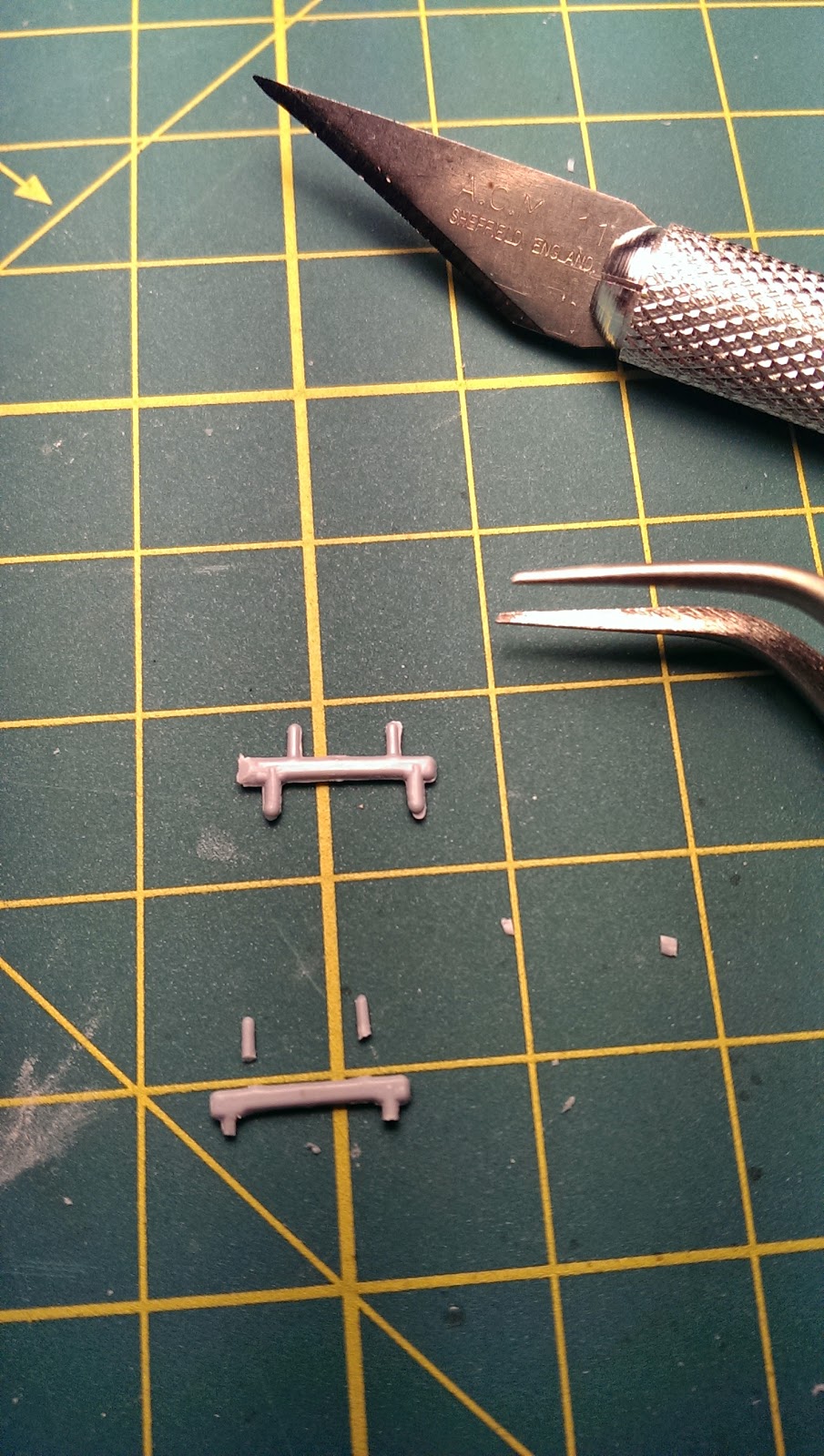

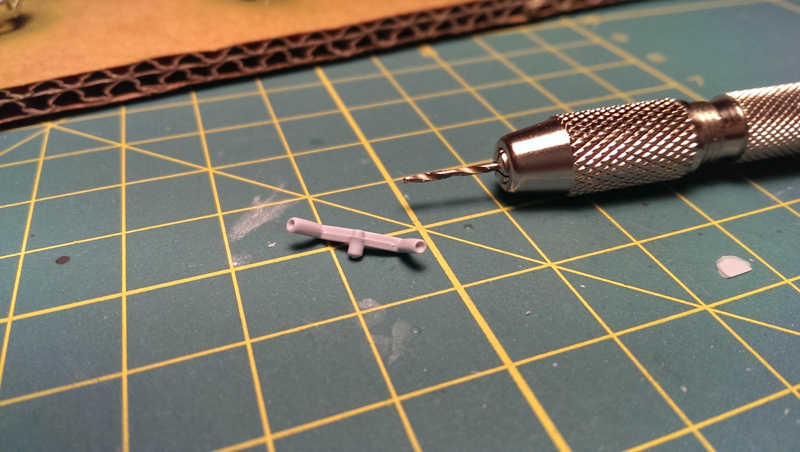

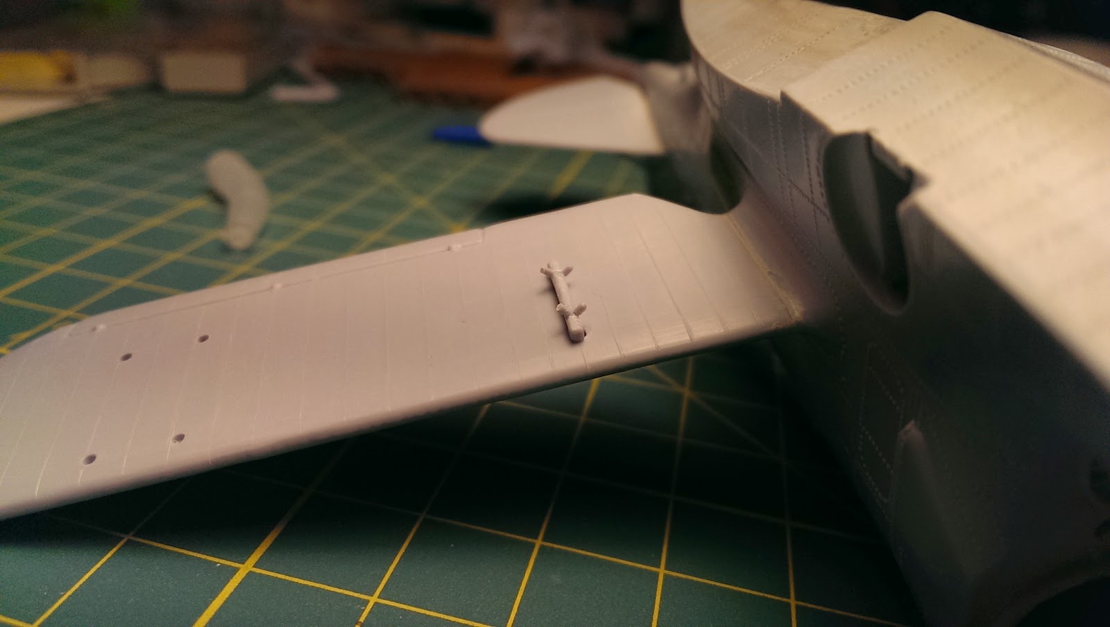

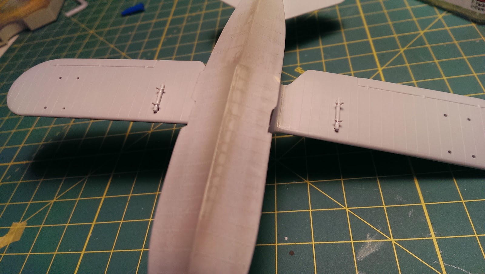

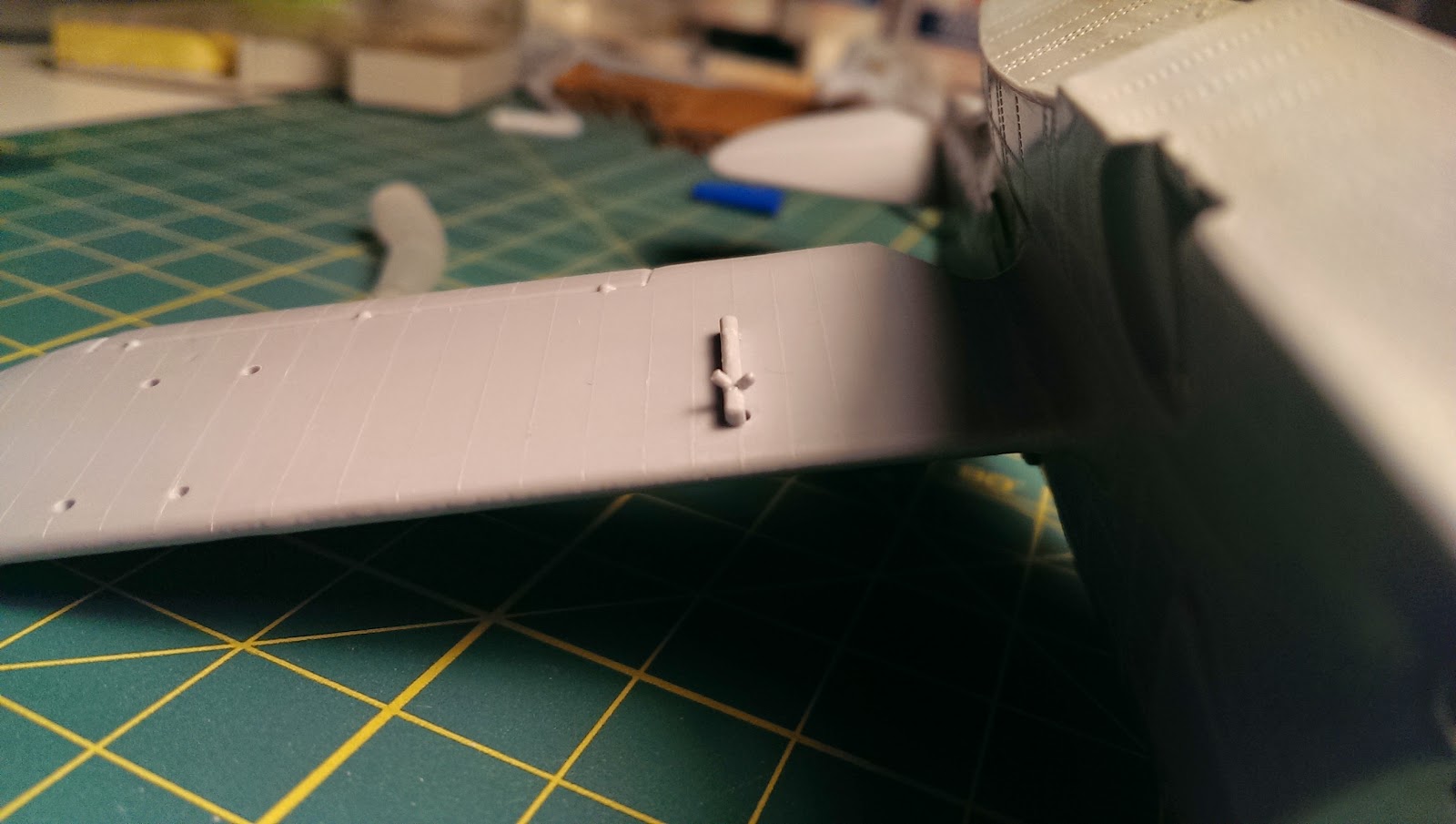

jrlx Posted May 11, 2015 Author Posted May 11, 2015 Thanks to all for the kind words. The kit was really difficult for me to build due to the fit and seam problems I mentioned. On the other hand, I must say I still haven't mastered the art of seam treatment... that's one of the areas I dread the most (that and rescribing...). I guess this model would be a piece of cake in more experienced hands. Anyway, in the end I was quite pleased with the colourful result as well. As said, this was an almost purely OOB build. I only drilled the ends of the exhausts with a 0.3 mm mini-drill: IMAG1069 and kind of "scratch built" the bomb holders under the wings. Though these would not be used by 1948 and by a rescue squadron, it seems these holders were kept: I just used the kit parts and transformed each pin in a kind of claw, as per the following pictures. Here are the two bomb holders. I've already cut the pins of the bottom one: IMAG1091 The holder was glued in place and the pins were cut in half and glued in a claw-like fashion. Here's the front "claw": IMAG1093 This holder is ready: IMAG1094 The end result was this: IMAG1096 Well, nothing too sophisticated and not perfect but I believe it improved the looks of the aircraft compared to the original straight pins. Thanks for looking. 5
