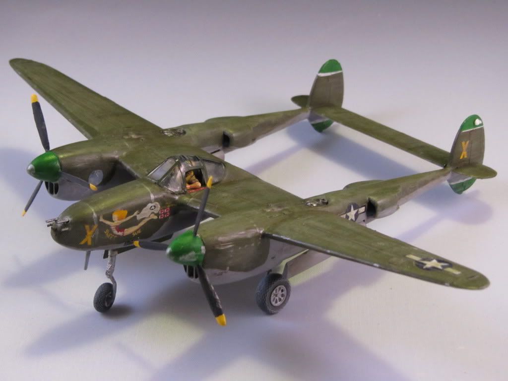

sunray Posted May 1, 2015 Share Posted May 1, 2015 I have never built a P-38 before so I would give this kit a go. These are the kit decals but I managed to get a better set from ebay. As with a lot of Airfix kits of this era they loved their rivets and this kit is no difference, in fact there are that many rivets you could use the wing as heavy grit sand paper! Also I think there will be a fair bit of re-scribing. I started sanding the many revits off and also started the re-scribing. And I opened up the rear of the radiator cowling's. I did this by drilling small holes around where the opening was going to be then I just joined the holes up with a sharp knife. That done I just tided up the hole with a small diamond file. I did this on all of the radiator cowling's and I finished the re-scribing on the four fuselage engine halves. The bolt holes on the engine cowling's were made by using a pin scribe.Now for the wings. Them done I then attached the wing halves together. The centre fuselage was re-scribed and I glued the forward undercarriage cover in place.This is where I am going to drill a hole for the machine bolt for the stand.I filed the head of the bolt down just to make sure it didn't catch the cockpit tub.Then it was just a case of using super glue to join them together.As the bolt's job is to hold the P-38 to the stand I added a small amount of glue and then sprinkled a small amount of bicarbonate of soda over the glue. The bicarb acts as an activator to the super glue and sets rock hard to give a more substantive joint. The thing you should to be aware of is that the chemical reaction between the glue and bicarb produces a small amount of heat. It won't burn you but you can feel the plastic warm up a touch. If this happens just wait for the plastic to cool down or even use cold water if you aren't sure. To be continued............................ 10 Link to comment Share on other sites More sharing options...

sunray Posted May 1, 2015 Author Share Posted May 1, 2015 Thanks lads. The cockpit didn't have a lot of detail in it and what it did I sanded off to start from scratch. I drilled out the dials for the instrument panel and scribed a few lines. The control column was made from scrap strips if plastic and bent copper wire. Also I added a bit of detail to the rear of the cockpit as well.On the seat I bent a piece of copper wire to make part of the seat frame.I test fitted a fair few times just to makesure everything worked just to be on the safe side. This one is to give you an idea of scale. 9 Link to comment Share on other sites More sharing options...

sunray Posted May 5, 2015 Author Share Posted May 5, 2015 Thanks for the comments guys. Just finished painting the pilot and cockpit before fitting it to the fuselage. I used Mr Hobby Cockpit Green for the base colour of the cockpit. For the weathering I used a dark Vallejo wash. The pilot was painted with Vallejo paints and Citadel washes. 6 Link to comment Share on other sites More sharing options...

sunray Posted May 5, 2015 Author Share Posted May 5, 2015 Thanks guys. I have managed to do a fair bit today. I have attached the cockpit to the central fuselage, attached both the engine booms and wings, built the nose, added the tail and installed the landing light. Here are a few photo's.I could have dropped the landing light from the kit straight into the wing but I decided to line the hole with white plasticard. Next I cut the clear part from the sprue and filed the sides down so it would just fit into the gap in the wing. I ensured that the light would be just proud of the wing as I was going to sand it flush with the wing when the glue has gone off but just before I fitted the light I drilled a small hole into the back of the light about half to look like a bulb. That done I added a few touch of PVA glue in the gap and pushed the light into the gap. As I have said I waited for the glue to go off, then I sanded the light flush with the wing and buffed it clear. I didn't paint the back of the light silver as you don't need it because the white plasticard at the back of the clear part gives a mirror effect like a real light reflector. 4 Link to comment Share on other sites More sharing options...
