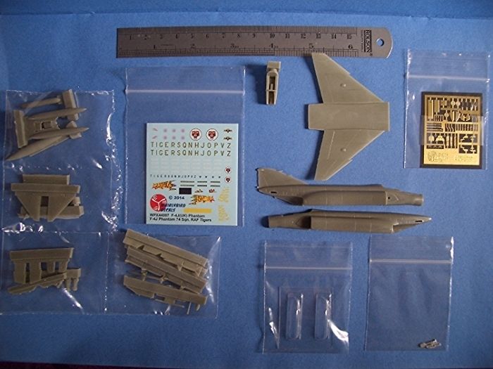

nimrod54 Posted April 25, 2015 Share Posted April 25, 2015 This is my entry for the group build, it's Whirlybirds 1/144 kit. I may be a little late starting as I still have to complete a couple of WW2 ground attack attack targets first, but I shouldn't be too late to the party. So here is a shot of the box and the contents and a close up of the decal sheet. 6 Link to comment Share on other sites More sharing options...
Tim Moff Posted April 25, 2015 Share Posted April 25, 2015 So thats purely resin? What sort of glues do you use when building these? Looks a challenge! Link to comment Share on other sites More sharing options...
nimrod54 Posted April 25, 2015 Author Share Posted April 25, 2015 So thats purely resin? What sort of glues do you use when building these? Looks a challenge! Yep Tim, apart from the etch, white metal undercarriage and the decals the rest is resin. As for glueing together, you can use 5 min Epoxy but I am going to use a Gap Filling Superglue to help with any filling that may be required. These also take a little longer to bond than thin superglue so will hopefully give me some time to check that the parts are aligned correctly. We'll see how I get on, it could well go for an early flight in the garden and then it will be a quick search for something in a more traditional medium. 2 Link to comment Share on other sites More sharing options...

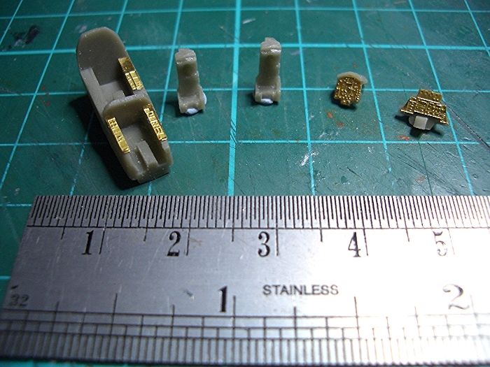

nimrod54 Posted May 2, 2015 Author Share Posted May 2, 2015 Made a start on this last night. First job was cleaning up the resin cockpit components and then I added the etch brass instrument panels and side consoles. I need to tidy the seats some more and then I can add the seat handles, some tape seatbelts and the remaining cockpit details such as rudder pedals and control column. After a clean up of the fuselage halves and the wings I gave them a trial fit and I am impressed by the fit of these, they go together really well. I need to give the parts a final tidy up but there are only a couple of areas that will need some filling and two little pin holes at the rear of the fuselage. 7 Link to comment Share on other sites More sharing options...

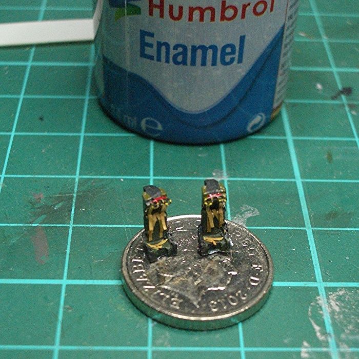

nimrod54 Posted May 7, 2015 Author Share Posted May 7, 2015 Over the last couple of days I have been working on the bang seats for this between other builds that I have going at the moment. Painted up and with some thin pieces of Tamiya tape for belts they don't look too bad, just one or two bits of touch up to do and a coat of matt varnish to seal the belts in place and they will be finished. 5 Link to comment Share on other sites More sharing options...

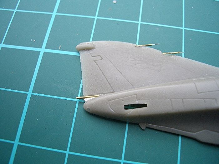

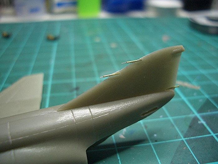

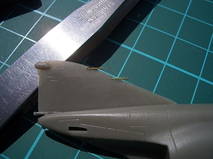

nimrod54 Posted May 13, 2015 Author Share Posted May 13, 2015 Did you ever have one of those days? You know the ones, those where you set out thinking just a bit of simple modelling, and really you should have left things in the box. Today I decided that I would give the fuselage halves a bit more of a tidy, ready for adding the cockpit when I get the painting finished. I thought, a quick whiz over the seams with a sanding stick and 'jobs a good'un'. Then with my usual applomb for ham-fistedness I knocked one of the pitots off the tail, *@#! GREAT . So I decided to remove the other and fabricate a couple of new ones from some 0.3mm micro-tubing and 0.1mm NS wire, I was quite happy with the way they turned out, so then it was on with the seam tidy. I was just putting the part back in the box and the little beggar jumped out of my hand and landed on the floor (I may have dropped it but I'm sticking with the story that it jumped your honour). Oh no, I thought, there goes a good hours worth of faffing about and after retrieving the part I was surprised to see my handiwork still intact, but wait a minute where has the fuel dump pipe gone, yep sure enough that had done a bunk too. So it was out with more micro-tube and some plastic strip to repair that. Needless to say everything is packed away now and I will be away from the modelling area for the rest of today. Anyway here is todays progress, well, sort of. The repaired/replaced pitot before the fuel dump debacle. The repaired fuel dump. I still need to fair in the fin leading edge and give it a general tidy up, but I thought it safer to put things away. 4 Link to comment Share on other sites More sharing options...
Cookenbacher Posted May 13, 2015 Share Posted May 13, 2015 On the bright side, your unintended scratch work is a great improvement over the original kit parts! 2 Link to comment Share on other sites More sharing options...
Hockeyboy76 Posted May 13, 2015 Share Posted May 13, 2015 Now they look cheeky. 1 Link to comment Share on other sites More sharing options...
nimrod54 Posted May 13, 2015 Author Share Posted May 13, 2015 Thanks a lot gents, I think that the PRV has re-seated cos the steam has stopped coming out of my ears. 1 Link to comment Share on other sites More sharing options...

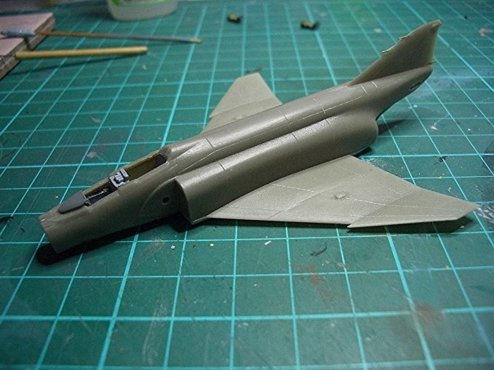

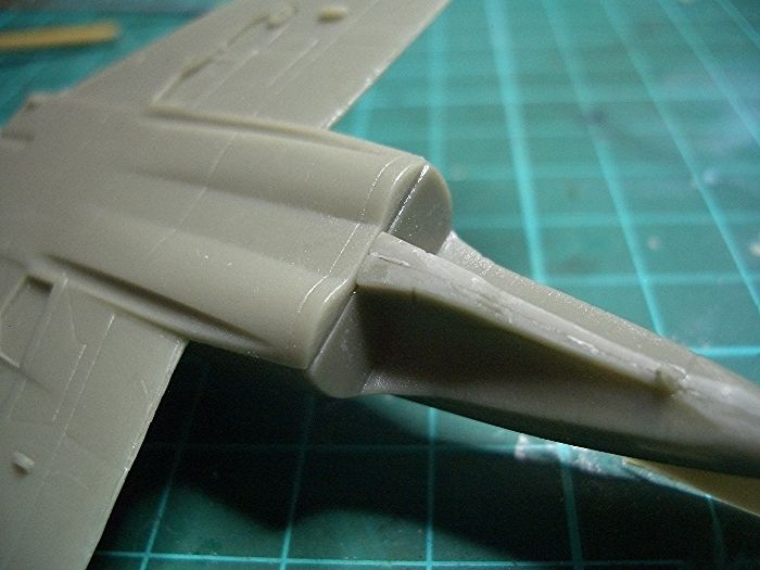

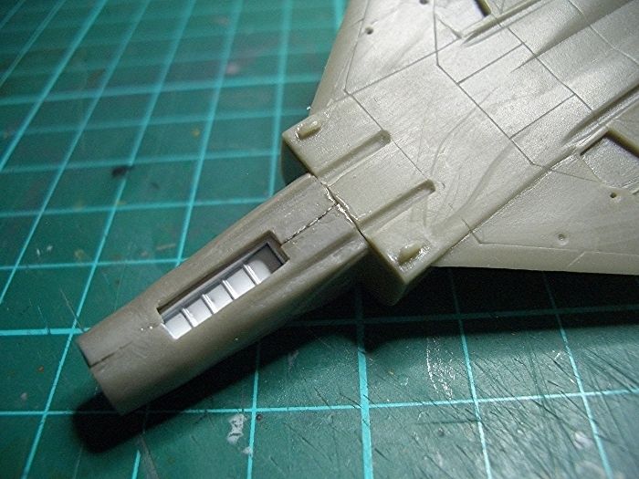

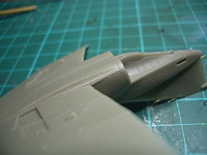

nimrod54 Posted May 17, 2015 Author Share Posted May 17, 2015 Well, I've been able to get quite bit done on this since my last update. The cockpit tub has been completed and added to the fuselage, this was then glued together. I've added a small peice of resin to the fin and blended this in it just needs a final clean up to smooth everything out. I also glued in a small piece of aquarium plant weight just behind the cockpit tub before adding the wing, hopefully this will be enough to keep the model on its nosewheel. Cockpit tub completed and added to fuselage. Fin after the addition of a small piece of resin and an initial clean up. One piece wing assembly added after inserting aquarium plant weight behind the cockpit. Finally a few shots of the front and rear wing joints Next up is the addition of the splitter plates and intakes before checking the nose fit and cleaning the wing joins up. 6 Link to comment Share on other sites More sharing options...
