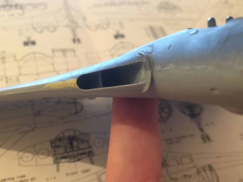

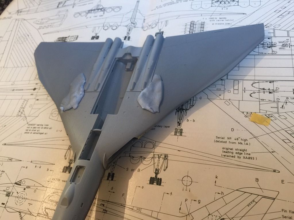

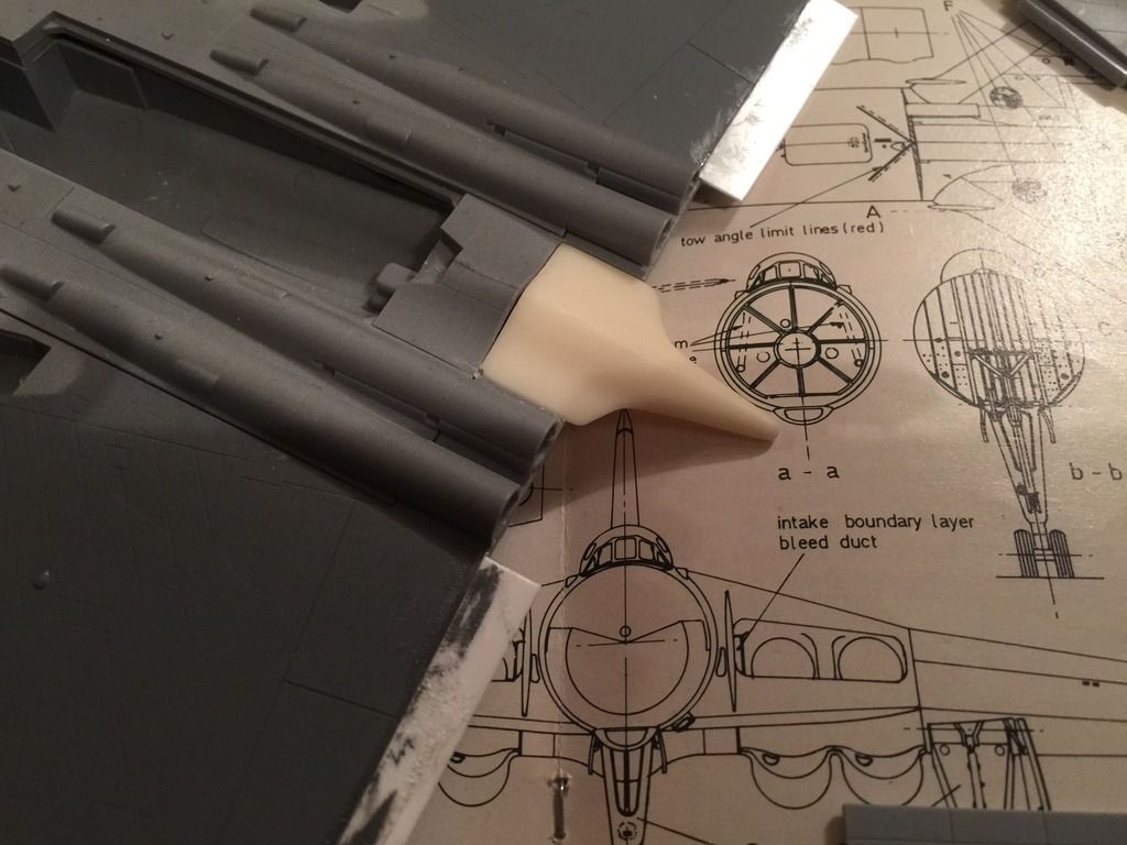

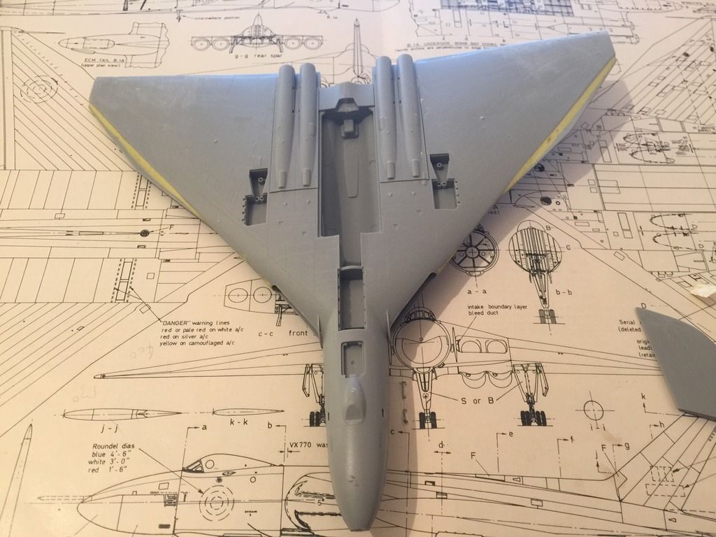

Right then back on with this pedantic build and I am tweaking the tail further. Also got the miliput on the wings and intake lips so I can start sculpting them :)

I also removed the B2s control surface housings not present on the B1

Getting there this one has been built much faster than the other 2 I guess that’s down to less fear this time. I cant wait to get this one finished. and I think I have decided that the 2nd B2 that featured a few pages ago with the Early B2 will be just build as demo models on stands for our Bomber Command Table.

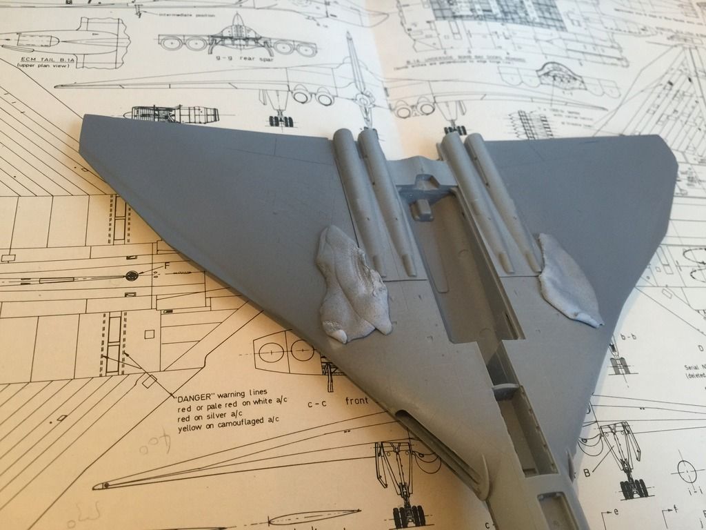

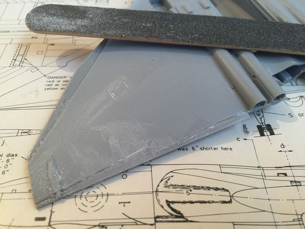

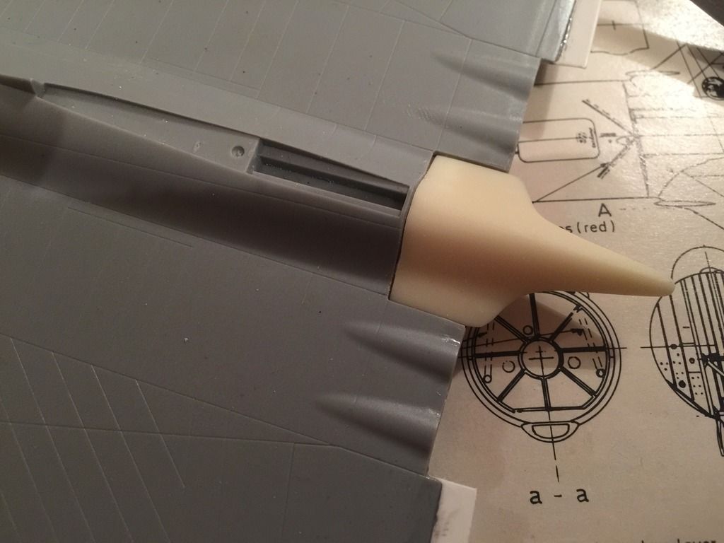

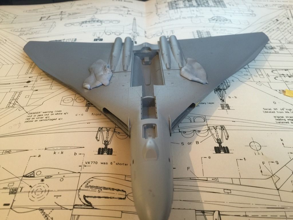

Well its getting there, The lower wing edge is gradually being blended in till it looks right using milliput, Mr Surfacer 500 and lots of wet and dry, Micromesh, Curved files and patience.
I have also found that Halfords Primer is great at filling in smaller details and scratch marks. In this case making my life easier.
A few angles so you can see how it catches the light.

Its starting look a bit more B1 now. I need to build up the back of the inner wing a little on the bottom and then when its time contour the edges and round the forward wing tip.
I am getting very tempted to do some work on the bomb bay albeit simple and allow easier work later. Might make up a Violet Club too while stuffs drying

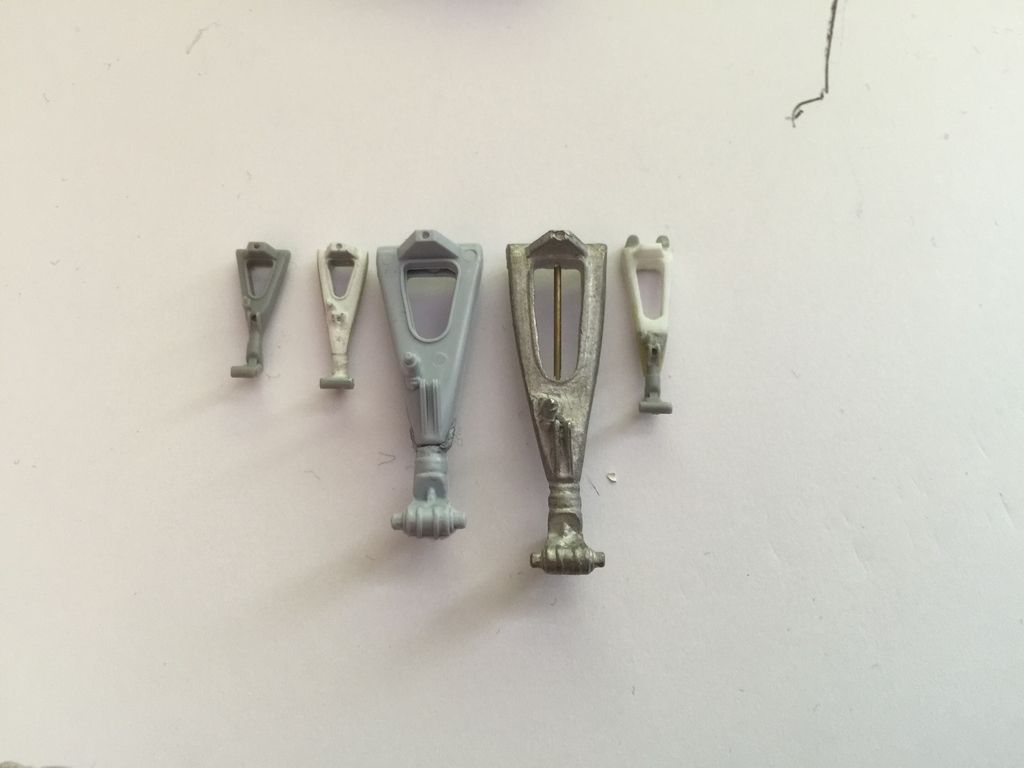

Ok lets talk about legs !
Ages ago last year I started work on the legs. The Pit road ones look nice but the front leg is too short and fits a little low in the Fuselage. The rear ones are looking good but again fit to low into the body.
I started by modding the B2 leg to improve the length. As for the overall height I need to sort this and feel the easiest way is to simply put the legs on a riser of about 1 or 2 mm.
I also made the B1 leg which is much longer and gives it a nose up look but this with the low back wheels makes it look like a dog dragging its backside !.
This is why I like the Corgi wheels they are more accurate and look better but are a bit cartoony and simple. I may modify the corgi ones and refine the detail and hybrid them with Pit Road wheels to make more accurate wheels that give the Vulcan a nice sit too.
Left to right we have the Pit Road kit leg, My Corrected B2 leg, Airfix B2, Flightpath B1, My mostly scratched B1 leg with the Pit Road wheel mounts.
100a8f34-cc9b-4470-8e34-ecefec3d7209_zps
Here I have enlarged my B2 leg to compare to the Airfix one. Tiny things to work on I think I will mold this B2 leg up.

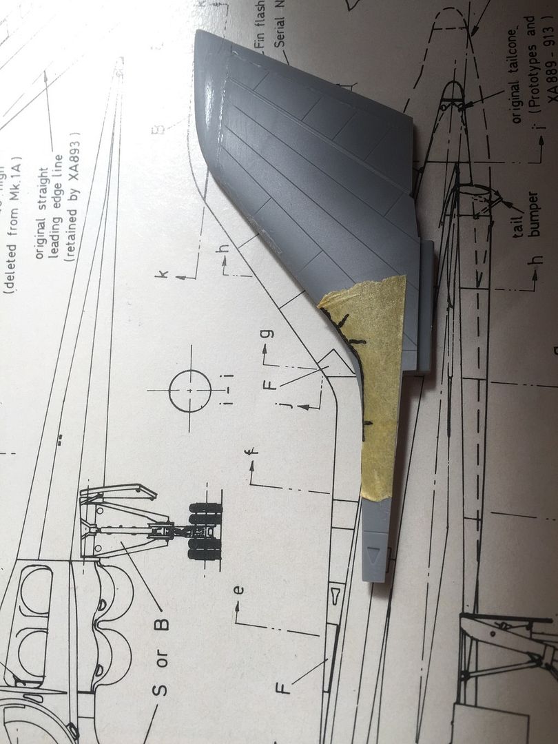

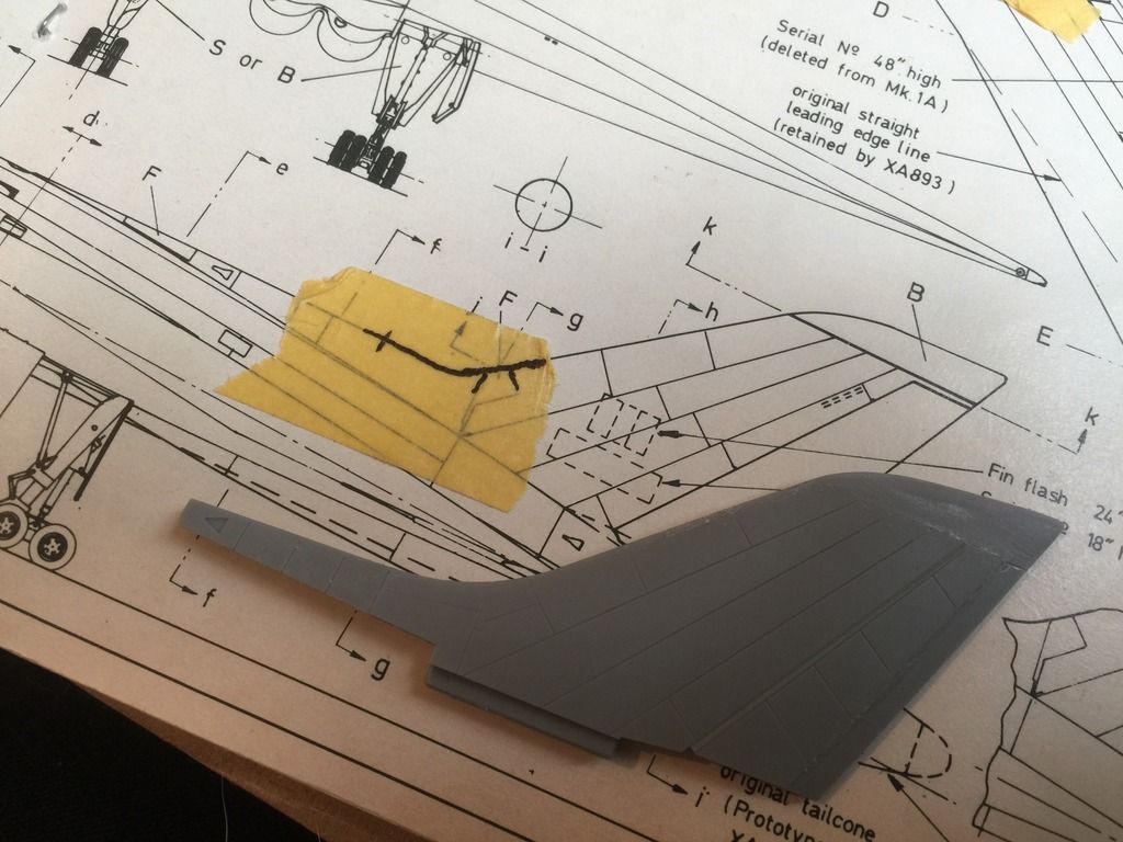

Update time.

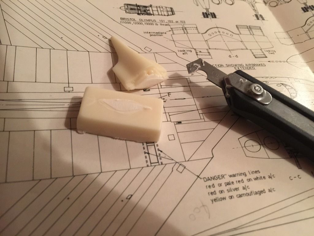

I started to take the resin tail one off the casting block. A few scrapes with the scriber either side on the line and then a little pressure and it will snap off at the line.
You need to sand down to the panel line and carve down the top section of the internal mount too account for the tail fin connector but once your there it simply push fits in. Whilst it does need a little super glue , filler and a minor carve to blend it does fit right. Ive done this to quite a few of my Vulcans now and for my first resin part im pretty chuffed with it.

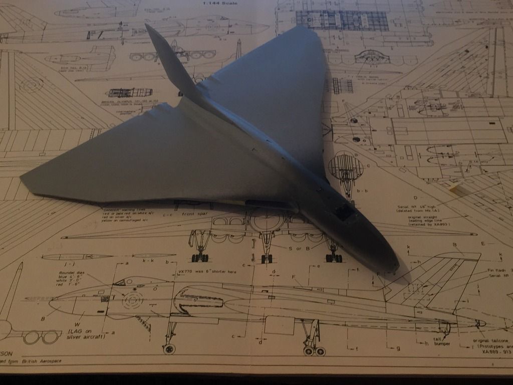

I also added some plasticard to the inner rudder to build them
Up a little to match the wing at the back.
