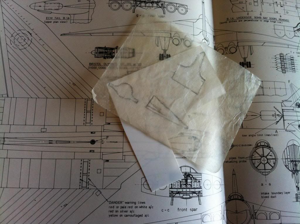

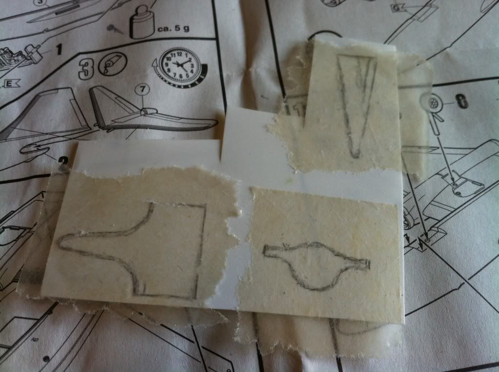

So what can you do with some Drawings I wonder. I met Andy (General Melchett) a while back and he showed me some excellent Drawings he had for A Vulcan B1 in 1/144th scale.
He kindly sent them to me as a scan but unable to print them off they where a curiosity I had studied and still do for ages at a time.
Then a few weeks later I found a copy of the drawings in print form to scale. I come from a long line of engineers but have no clue about how its done and always wondered how I anyone sets about converting 2D drawings into 3D objects.
After many cups of Coffee and a week at home skint I had not much to do and thought I would have ago at trying to figure it out. I thought, Tracing paper !..
So I got some Tracing paper and plasticard and decided to do this :
D8A3C42F-D476-4BC9-86F9-A0A7D35951E6-272
I thought I would have ago at making just the tail cone for A Vulcan B1 or Early B2 i used some 3m spray glue to affix the tracing paper for the bulkhead plan and side views of the cone.
20CEB2C2-51BA-4B8B-B09B-5A9CC761EAE9-272

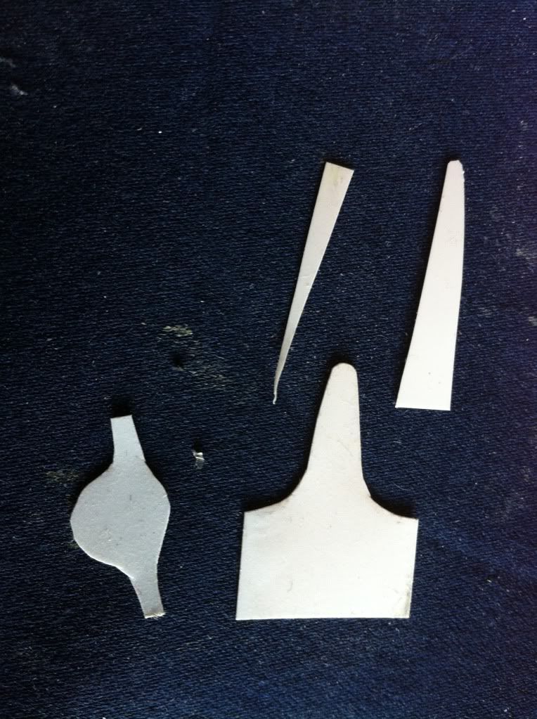

And then I cut them out. and glued them together.
3FDAB3CB-9D3F-4251-88F3-03879FB822FE-272
6B0A5226-BFF7-41AB-8BD3-0ED2DC6BD5B5-272
80DE4EF3-CBE0-4362-9FCB-6EEC2E3F1A31-272

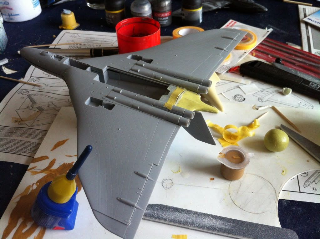

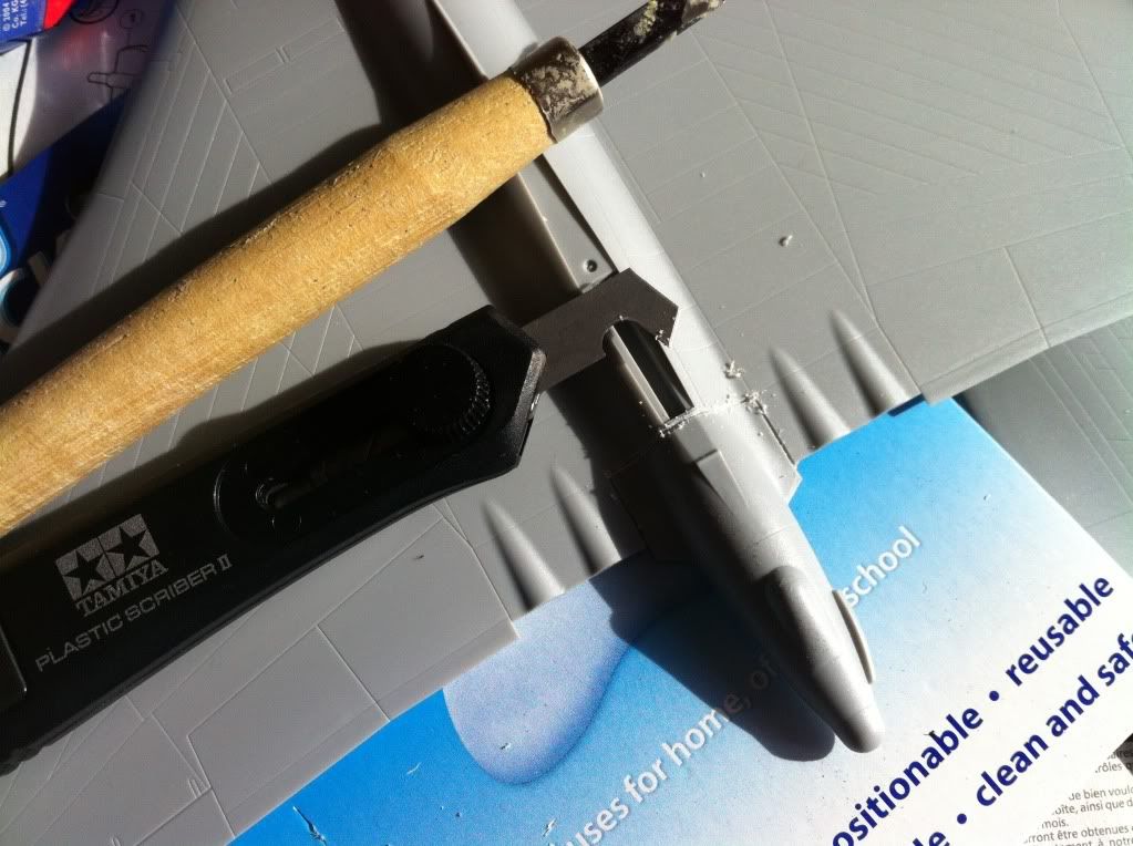

I have decided to be brave and go for it, So here is a Virgin Pit Road kit getting the Manx cat treatment ! :shutup:
1CE17EDB-C955-4108-A58D-BCD9A4F0A217-272
C76C1A5E-F38D-49AB-9189-970B1D22B31A-272

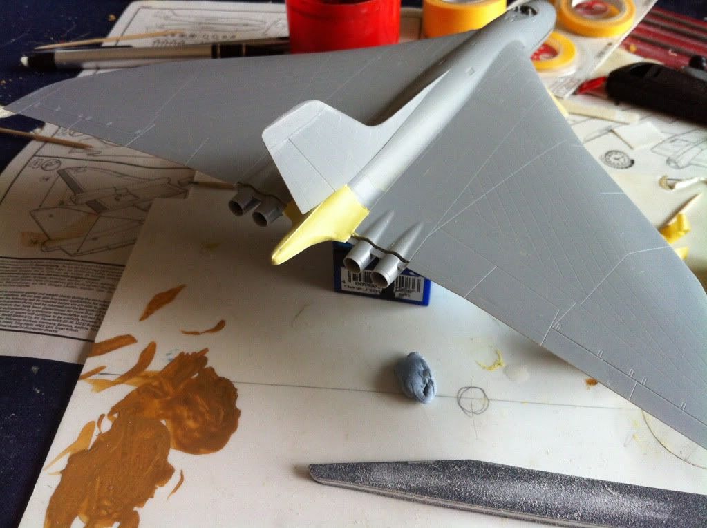

Well it fits great. Even though the Pit Road kit is a B2 the common parts of the B1 (which are very few) Match very well indeed. So I am getting optimistic with this and a little excited too.
FAA4CDB2-6B7E-401E-A6D7-954BB2A49740-272
265A6963-85C6-4373-9AD0-8595D697E820-272
  • Like 2

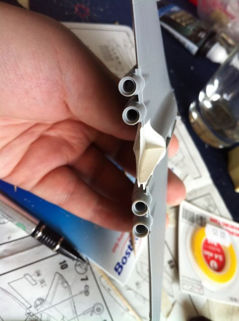

The way the panel lines are on the Kit and the the Drawings mean I am going to had to create a step on the lower edge of the Bulkhead.
7F4BAA2E-B1B5-462D-B4F4-5F24E95CF093-272
5489DB49-C643-48B3-8393-9653914FD7A5-272
I made a copy of the shape then stuck it to thicker plasticard to cut out later.
F43993F3-7656-4E36-AE7F-FF287FB4537C-272

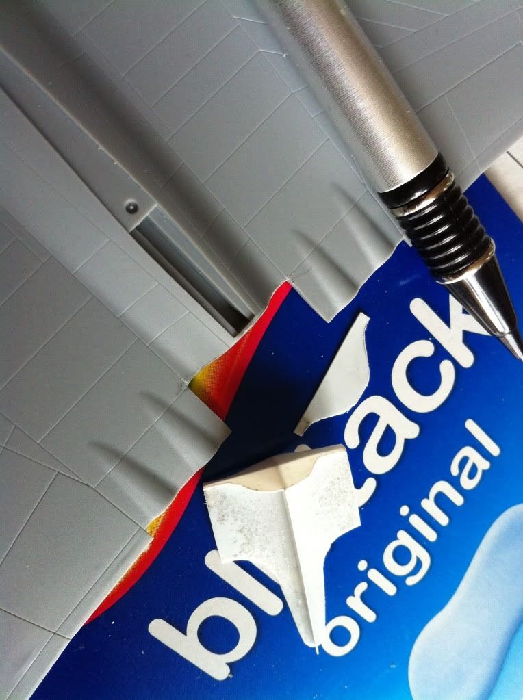

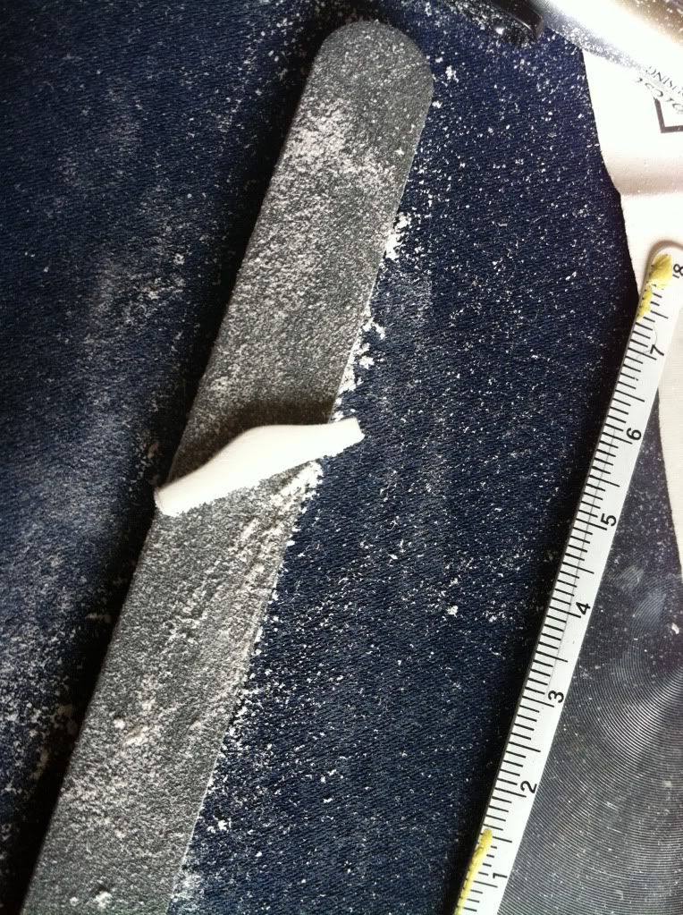

No I have cut the bulkhead piece out and sanding it to fit with Mylar Pads.
3F018E72-9584-4556-A09E-9ED2944B7C8A-272
AC9629CA-66ED-475E-8427-19DF835F89C8-272
A2BDADB4-0894-409E-B6B7-53476F508B7B-272
BD77DD8E-0EA2-4DB6-95F2-0BD82F74410C-272
53481976-6B8B-4A99-A593-6B4BB47E75A2-272
D3F181A1-690B-454B-8932-CEA8C661EFF2-272
Cheers Rob :)

Look Rob, if scratchbuilding was difficult or even impossible d'you think I'd be able to do it?
I would advise adding interim cross section shapes along the ribbed bit to allow the gently subtle bits to follow form
But as you are doing it nicely already I'll just sit here quietly with the occasional shandy and a 'six of chips'® for relaxation

Sounds good Bill I will bear that in mind and now I feel thirsty, Scratch building sure is fun I know that much. Cheaper too and more fun. :)

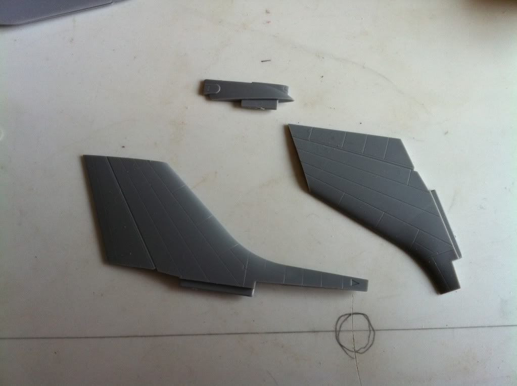

I might as well start making up sub assemblies. This is the Tail as comes in the kit but I will need to reshape the fin cap to the earlier sleek style and make a fillet for the Rudder.
as the tail fin will now need to be longer in this area where the new bee sting style tail will be :)
BAD2F131-E404-4C99-B45E-933E6873FA1A-272
  • Like 3

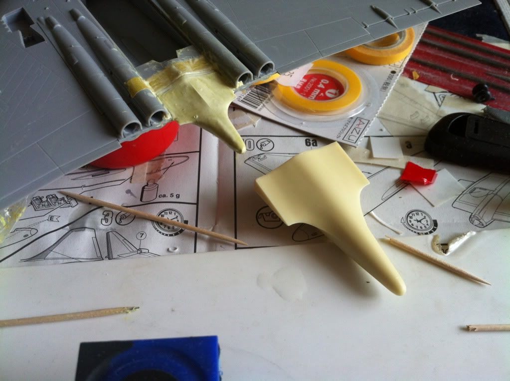

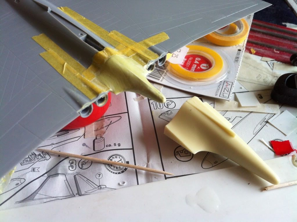

Ok so now the Milliput is on and I have simply wet smoothed it with my finger to look as close as possible to the the shape of the 1/72 Flight Path offering.
Later this can be sanded down to a better more accurate shape. I have done this with the former in place to help gauge how it should look. Its Tom Probert who give me this idea saying you shape and sand till you see the plasticard then stop as you have your shape.
FB4902D6-E942-48B3-ADAB-796139AA86D7-272
EA389703-377F-4516-B311-8DAC46A27401-272
I am pretty happy with how things are going so far. The Flight path cone represents the later B1 cone with a mod to the radar, Think it was orange putter, Not sure Ill have to read up on it.
There's a famous quote that I can't find about a sculptor who had made a fabulous elephant. When asked what his method was he said "I just get a lump of stone and chip away the bits that don't look like an Elephant". (I wish there was an 'I'm not shopping' button on search engines. Put me out of my misery someone.)
And so you should be - looking great!

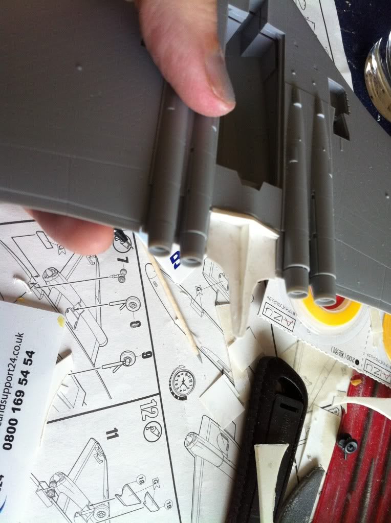

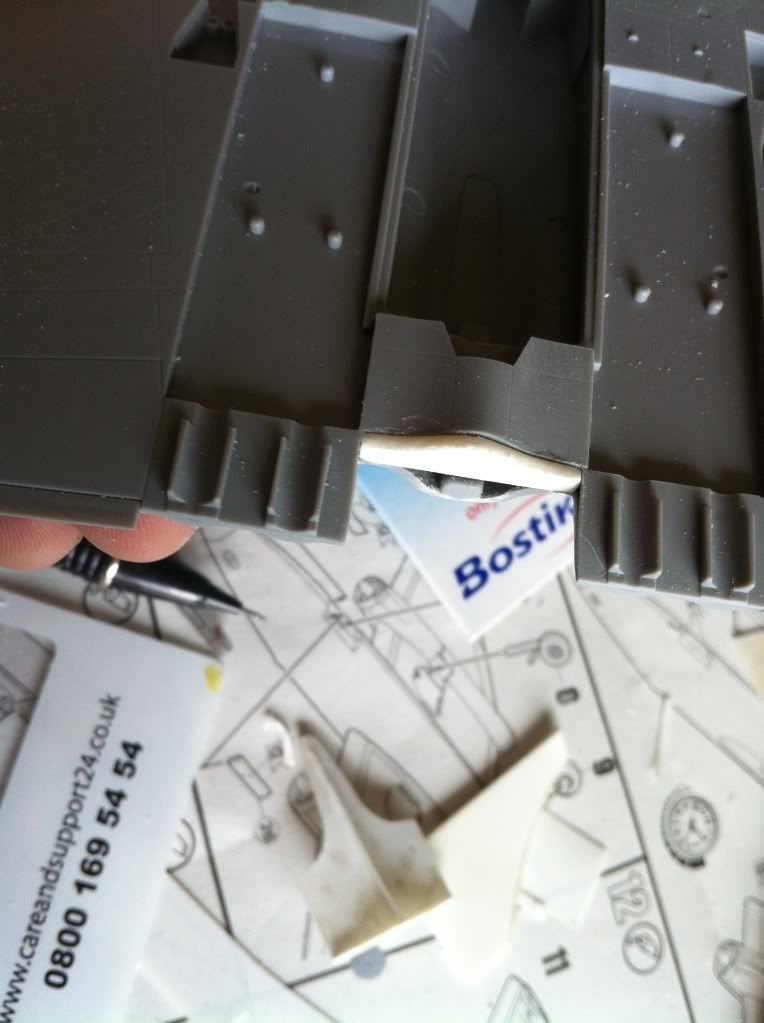

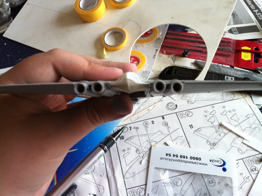

The Milliput Has Dried off a little now and I have made up and filed the Tail Fin to shape. Starting to resemble an early B2 now :)
3BF95373-799C-4083-9784-E2D820CB01C2-272
A3B4A242-FA70-4F62-ABA3-CF59314BE973-272
cheers Rob :)
  • Like 2
Looking good Rob, the bottom bit looks like it needs a little touch of filler but other than that it's a good shape! :)
You need to empty your PM's too.... mine is jammed sending :P
Yep its a bit scooped out there, Will add some later when its dry I did not want to push my luck too far today. :)
Thanks for reminding me I was just about to PM you. :)
