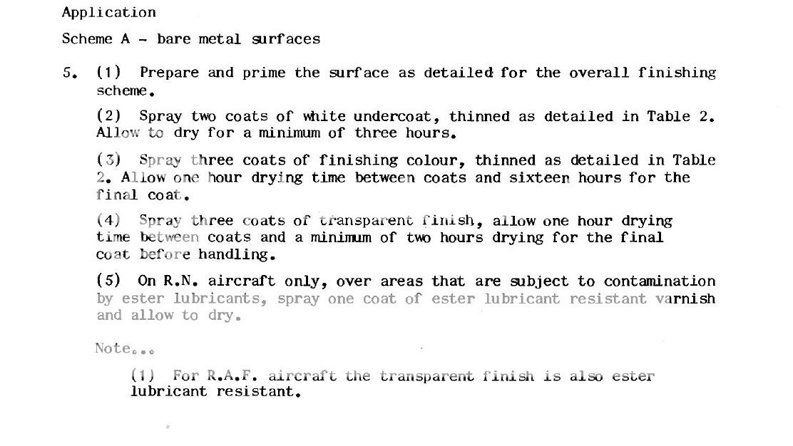

huvut76g7gbbui7 Posted April 3, 2015 Share Posted April 3, 2015 I remember the Vampires,Hunters,Sea Princes and Whirlwind 7s at Lossie with more shades of dayglo than you would believe! Some were pretty shabby before they went off for a repaint. The later Whirlwind 9s didn't seem to fade as fast as far as I remember. Does anyone remember the white undercoat which Humbrol made for their dayglo paint? 1 Link to comment Share on other sites More sharing options...

Nick Millman Posted April 5, 2015 Share Posted April 5, 2015 I see 'signal green' listed above. Was this a dayglo colour? Standard DayGlo colours and names were:- Neon Red Arc Yellow Signal Green Saturn Yellow Fire Orange Rocket Red Blaze Orange Aurora Pink Two more recent additions are Horizon Blue and Corona Magenta The four paints listed in the document at comment # 6 are all proprietary DayGlo colours. http://www.dayglo.com/ Nick Link to comment Share on other sites More sharing options...
Grizzly Posted April 5, 2015 Share Posted April 5, 2015 Standard DayGlo colours and names were:- Neon Red Arc Yellow Signal Green Saturn Yellow Fire Orange Rocket Red Blaze Orange Aurora Pink Two more recent additions are Horizon Blue and Corona Magenta The four paints listed in the document at comment # 6 are all proprietary DayGlo colours. http://www.dayglo.com/ Nick US supplied aircraft FS 595 28913 ie Hillier HT1/2 Red Orange. UK supplied aircraft Dockerblaze Orange Red 33B 2202312 over white primer to Mod 1741. regards Len 1 Link to comment Share on other sites More sharing options...
Grizzly Posted April 5, 2015 Share Posted April 5, 2015 I see 'signal green' listed above. Was this a dayglo colour? I remember some FAA Meteor TT20s being more a lime green with black stripes than yellow underneath but have it in my head there was a green fuselage band. Is this a false memory? The TT20 Meteors operating from Hal Far had the underside golden yellow replaced with Saturn yellow hign vis Day Glo because the missile operators were having trouble seeing the Mother aircraft when firing at the targets !!! The aircraft bands remained golden yellow but I believe that lease one trialed Day Glo green bands. Regards Len. 2 Link to comment Share on other sites More sharing options...
Nick Millman Posted April 5, 2015 Share Posted April 5, 2015 US supplied aircraft FS 595 28913 ie Hillier HT1/2 Red Orange. UK supplied aircraft Dockerblaze Orange Red 33B 2202312 over white primer to Mod 1741. regards Len Thanks. Yes, sorry, I should have said three colours in the document not four - Signal Green, Saturn Yellow and Rocket Red - Orange Red not a DayGlo colour! Nick 1 Link to comment Share on other sites More sharing options...

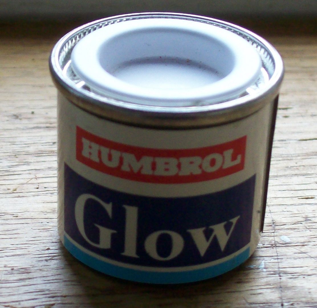

John Posted April 16, 2015 Share Posted April 16, 2015 I remember the Vampires,Hunters,Sea Princes and Whirlwind 7s at Lossie with more shades of dayglo than you would believe! Some were pretty shabby before they went off for a repaint. The later Whirlwind 9s didn't seem to fade as fast as far as I remember. Does anyone remember the white undercoat which Humbrol made for their dayglo paint? John 1 Link to comment Share on other sites More sharing options...
huvut76g7gbbui7 Posted April 16, 2015 Share Posted April 16, 2015 "Were those aircraft seen at Hurn by Chris Thomas, ex Hal Far aircraft or was DayGlo green being used on domestically (FRU) based TT20's also." I cannot remember what colours they were earlier in the sixties when they were with NASU at Lossie but long after they had left there they were regular visitors so I suggest they were operational with FRU. Link to comment Share on other sites More sharing options...
Grizzly Posted April 16, 2015 Share Posted April 16, 2015 John I still have a tin in the box . Link to comment Share on other sites More sharing options...
