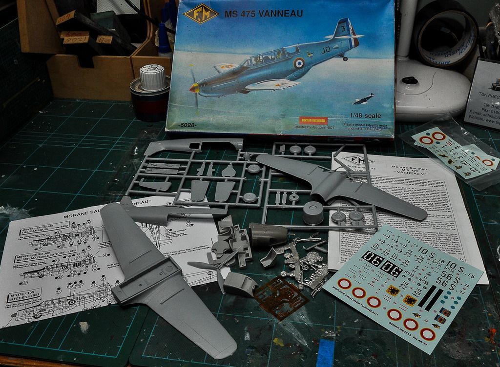

PaulT 876 Posted March 20, 2015 Posted March 20, 2015 Bonjour My build for this GB will be the MS 475 Vanneau in 48th by FM. I got the kit back in 2010 at the Salisbury show for £10.00 I have taken it out a few times to start got as far as cleaning up a few bits but just put it back as could not seam to get into it. This GB has made me want to do it and finish it. This is my main build I shall do 3 others also this is the one that is my main one to get finished. I shall use the Berna Decals set 48-32 and the a/c is from CERO 305 at ALGER MAISON-BLANCHE in 1953 This GB is like a Bus mans Hol for me as over 85% of my kits can be made as French subjects still new stuff on the French Sig Stand at shows can not be a bad thing. Till for the off see ya Paul 5

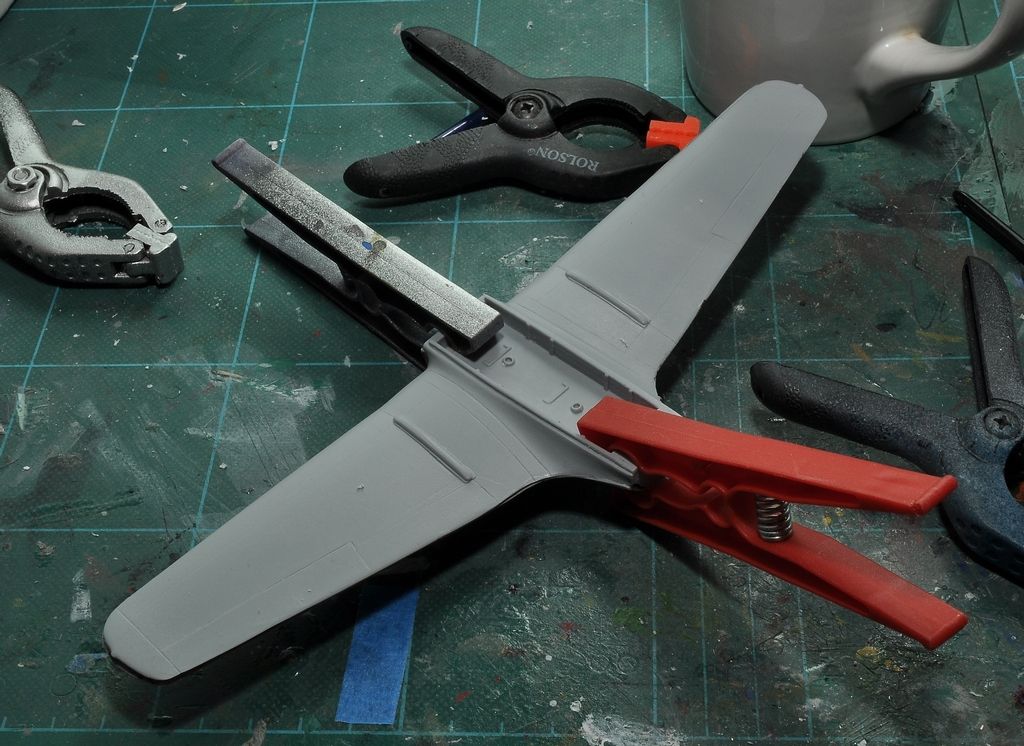

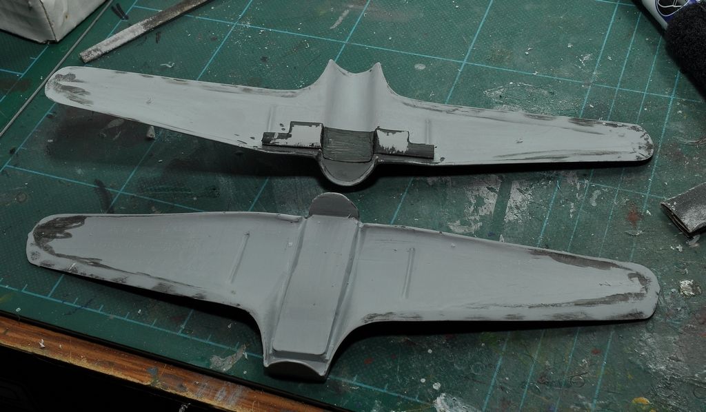

PaulT 876 Posted March 25, 2015 Author Posted March 25, 2015 Hi Just a quick update. I have got the wings glued together now just got to clean up the leading and tailing edges.This took me about 1 3/4 hours last night and just over an hour this morning just to get to this stage a lot of resin and plastic needs to be taken out to get it to fit, the carpet is full of resin an plastic shavings I will post photos tonight when I get back form photo club Jean Forgot to say there is a 72nd resin kit, its French also of the Vanneau, I cannot think of who it is made by. I have a made up one in my loft which a sig member made many years ago will have to dig it out some time I think it is in the same markings that I shall do this one. Till later Paul

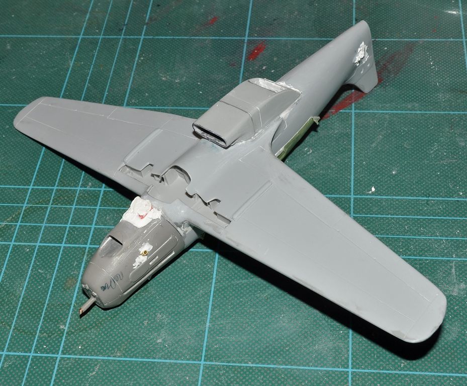

PaulT 876 Posted March 26, 2015 Author Posted March 26, 2015 (edited) Hi my updateI have got the wing cleaned up as far I will go with it just now. The last clean up will be once the under coat shows up what I have missed.I have cleaned up and glued the rad just got to find some photos to see if the flap is open or close when at rest on the ground.I also have cleaned up the fuselage parts and test fitted to the wing, some filling at the rear of the wing and the front also should be no trouble at all to do this.Next up is the inside detail to do.The photos just a few to show that it is being made would take ages to do a step by step build.Cliff = That is probably the Dujin kit as Dujin was at a lot of the French shows I used to go to with the chap that built the kit, and I know he used to have quite a few chats with him as he spoke French having lived in Lyon for some time.That's all for now till next time.Paul Edited March 26, 2015 by PaulT 876 1

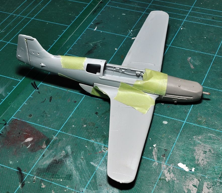

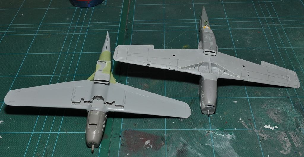

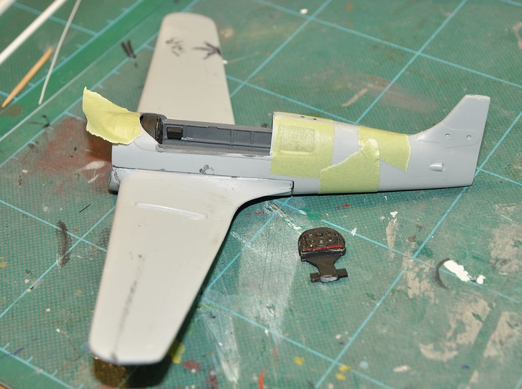

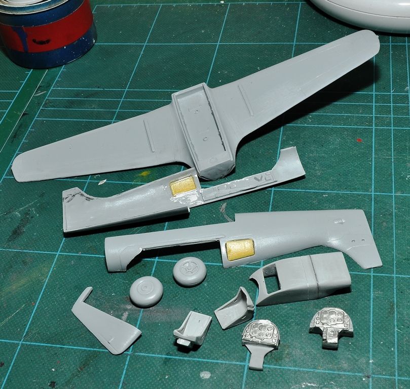

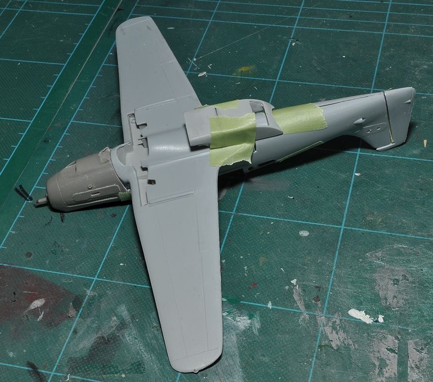

PaulT 876 Posted March 30, 2015 Author Posted March 30, 2015 (edited) HiNot much done over the w/e, glued some of the cockpit bits to the fuselage bits.I have taped it together to see the size and fit of a few bits.The rad is going to need a lot of trimming to the mating surface to make it fit.I have found some photos that show the rear vent open when on the ground.Some photos.I had the Mustang near by and noticed they look a bit the same. The MS looks like it could be a 2 seat Mustang.That all for nowDo more to it tonight I hope.Paul Edited April 8, 2015 by PaulT 876 2

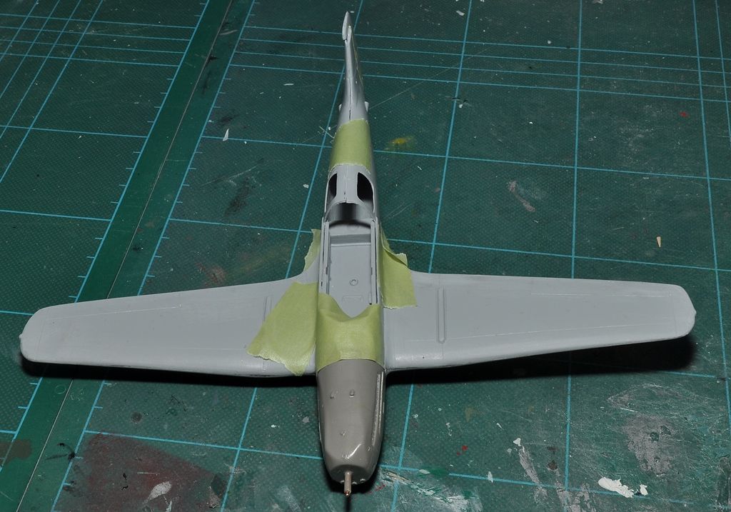

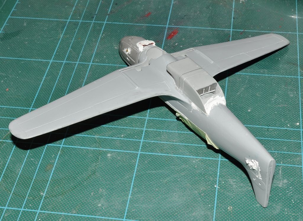

PaulT 876 Posted April 11, 2015 Author Posted April 11, 2015 HiNot done much this week as been doing the other kits I will get back to this one next week.A photo of how far.As you can see not much, I have been looking at loads of photos to see if I need to add things.The main thing seams to be a rear bulk head I need to fit its not in the kit and a few other detail bits I have noted that will improve the look of the kit.Till next weekPaul

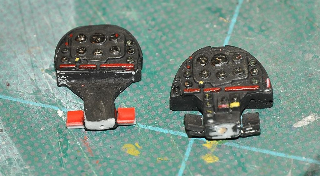

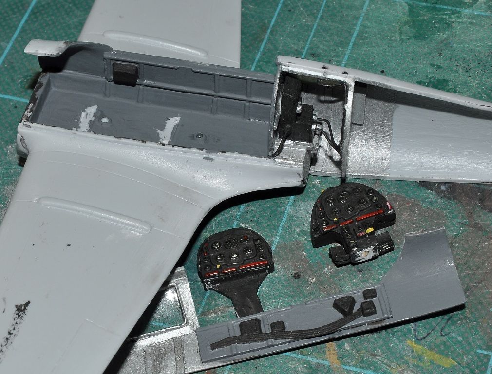

PaulT 876 Posted June 17, 2015 Author Posted June 17, 2015 HiLong time since last up date, I have been doing the kit most mornings for about 1 hour before I get ready to go to work. It has been a long slog to get to this point I have found that if i try to rush things with this kit you just end up going backwards so it has been two steps forwards and one back most of the time or back to the start of that section if it went wrong.I have found quite a few photos that have helped a lot and correcting and adding detail that is missing or wrong for the 475 has taken its toll on the time.Here are the photos and updates I shall do this over a few posts, as it is quite long and many photos.I found that there was a bulkhead missing in the rear. I have made this and added some more detail not all is corrected as not a photo of the lower bit only the top so I just made it up for the lower bit it looks ok. It looks ok I have added a radio and the Arial wires and power cables. The inside painted and ready to close up, had to do the rear detail before close up as will not be able to get to it when closed this took a lot of time and a few back to the start when things just did not look or fit took much to long to do. The panels had to make the pedals for the rear as not in the kit but shown in the instructions and by the looks of it from other internet reviews they seam to be missing from there kits also. The rear bit just before closing up. The close up at last, but no matter how many dry fits the rear panel still did not fit so it came out and I will fit it when I close up the canopy. The gap at the front end, sorted this later. That's all for part one. Paul 1

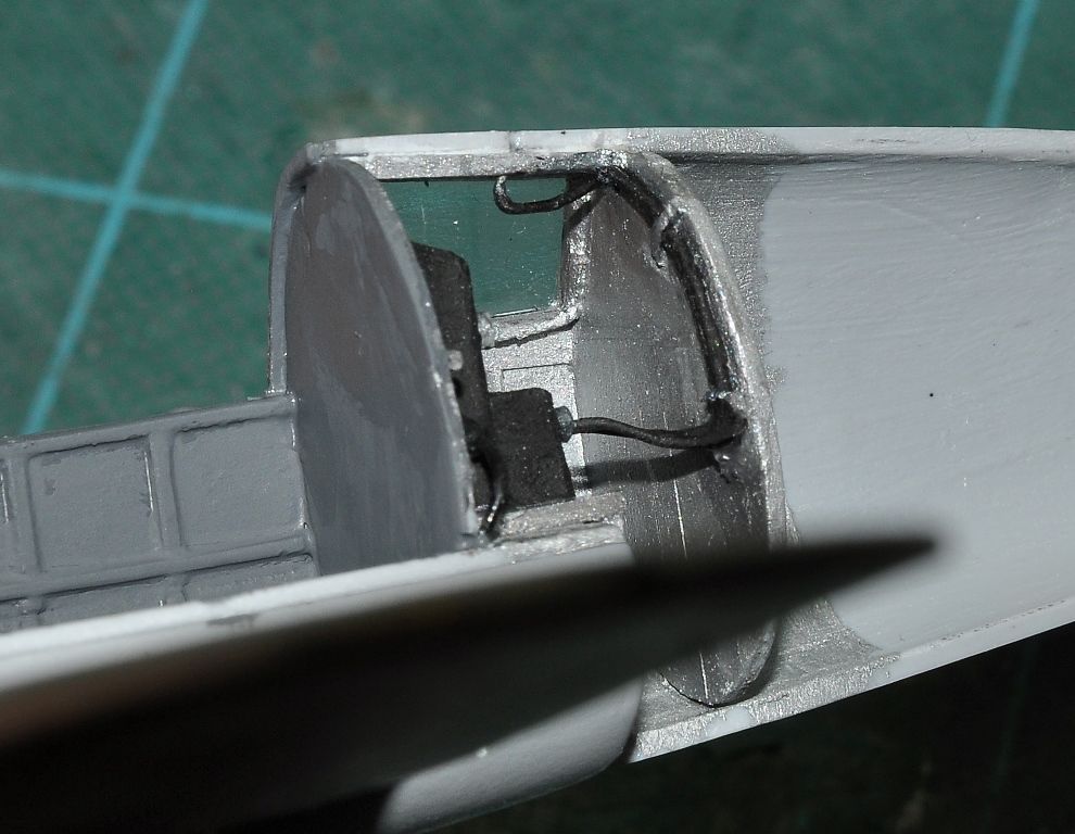

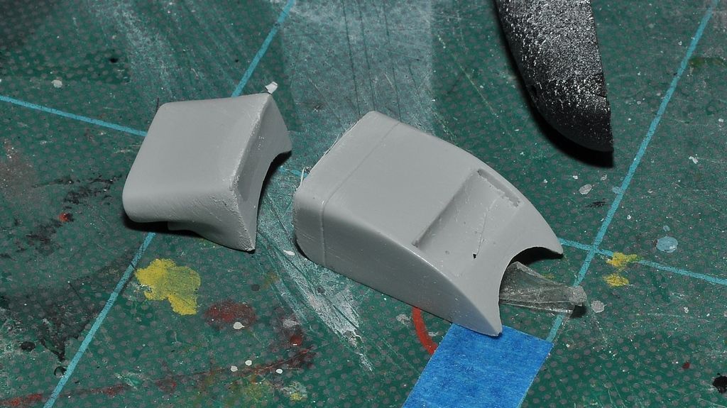

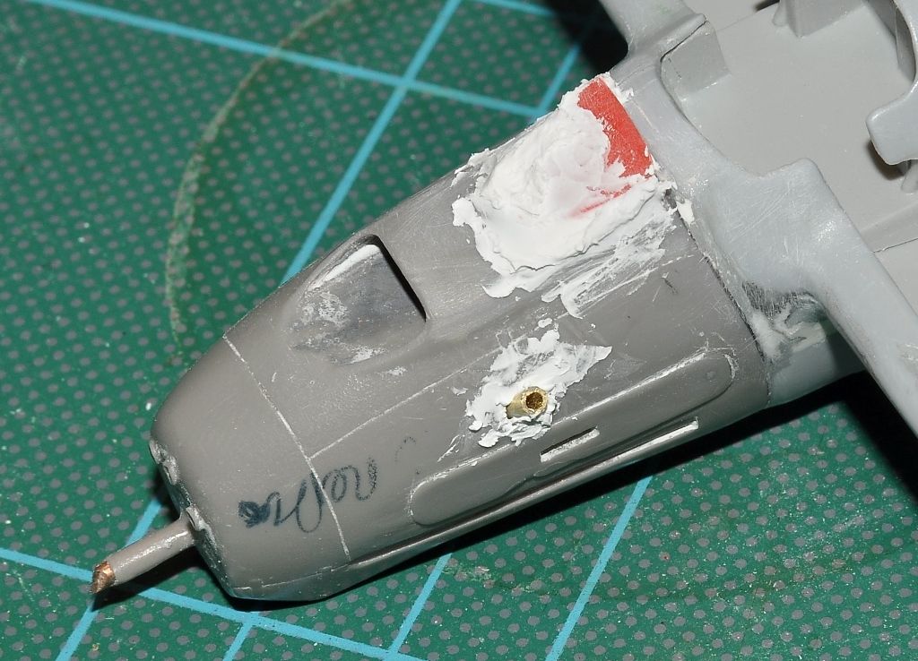

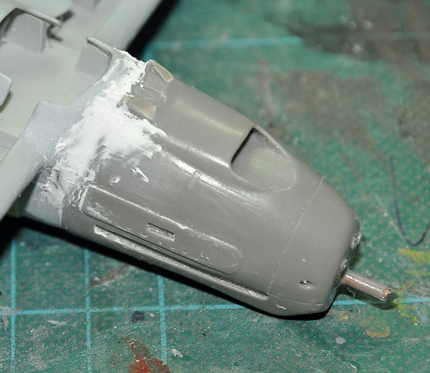

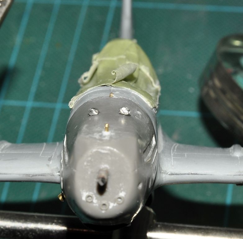

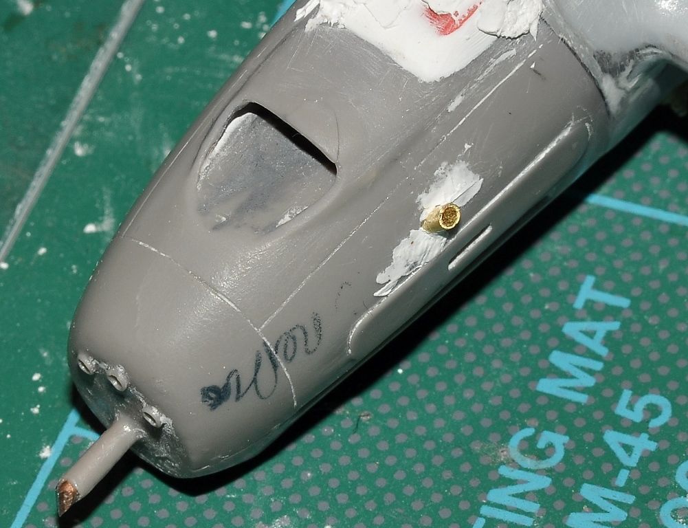

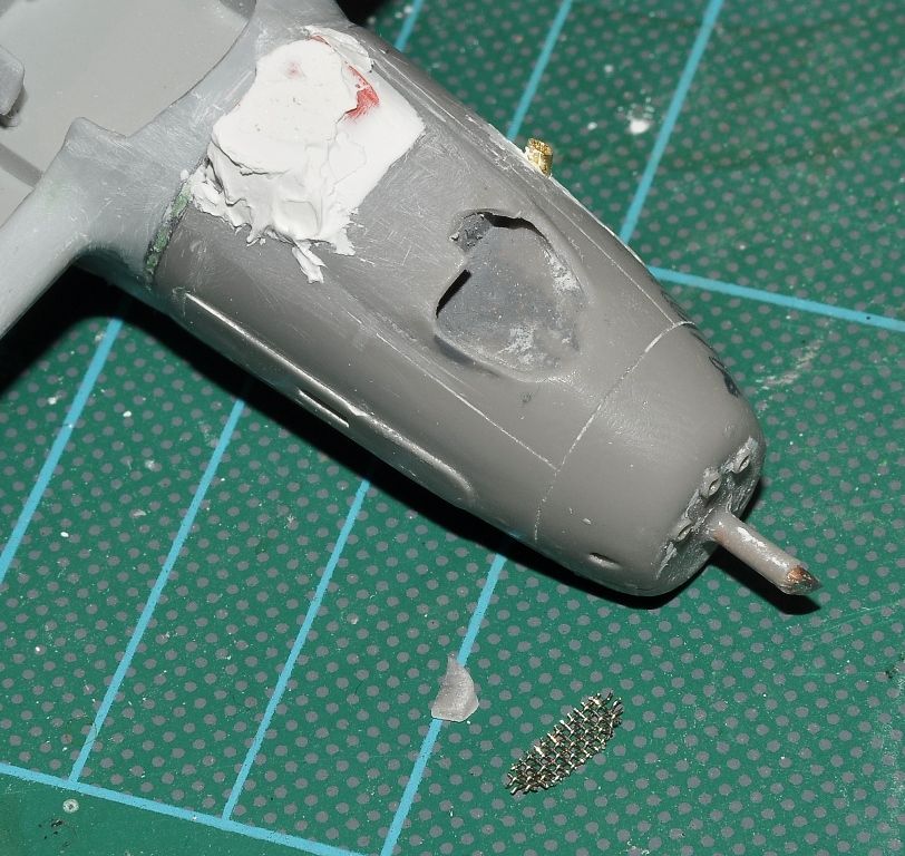

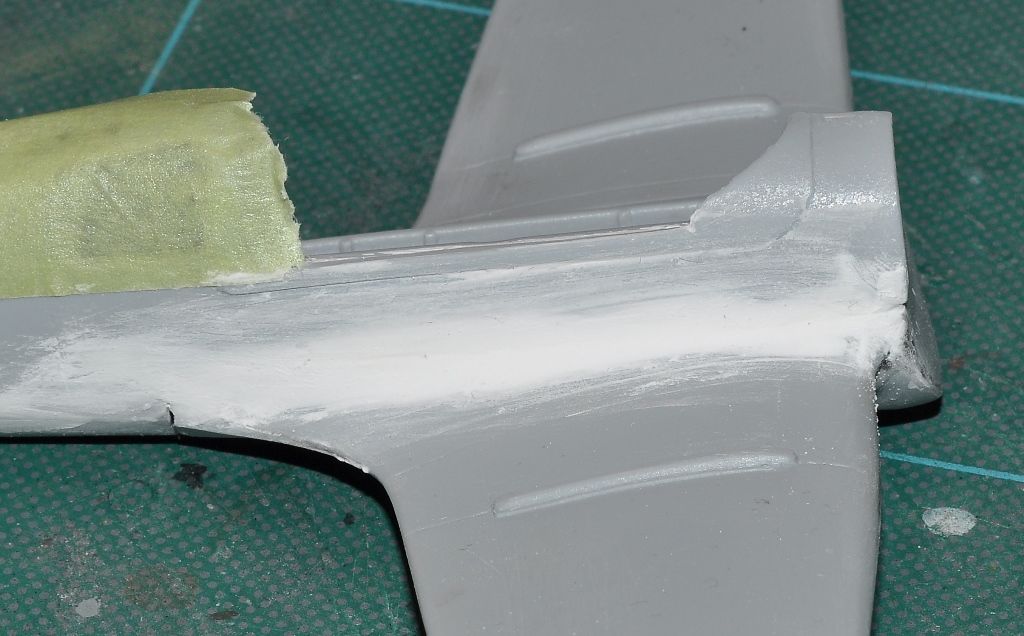

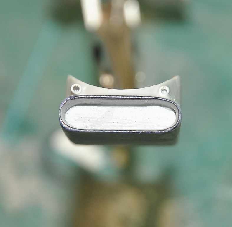

PaulT 876 Posted June 17, 2015 Author Posted June 17, 2015 Part twoA bit later than planned but the laptop locked up and its taken this long to get it going again.The 1st go at filling the gap, the other side was just as bad. It took a few goes to get ok.The rear nose vent, this broke as I tried to take out the mould rubber that was trapped in side it.The start of the new one its about 80% there just now. A few shaping bits to get right. The brass bit is a replacement for the moulded kit bit which looked naff.More steps back this broke as I was putting in the grill.The repair not to bad.The last bit looks better than just a blank hole.That's the end of part two.Paul 1

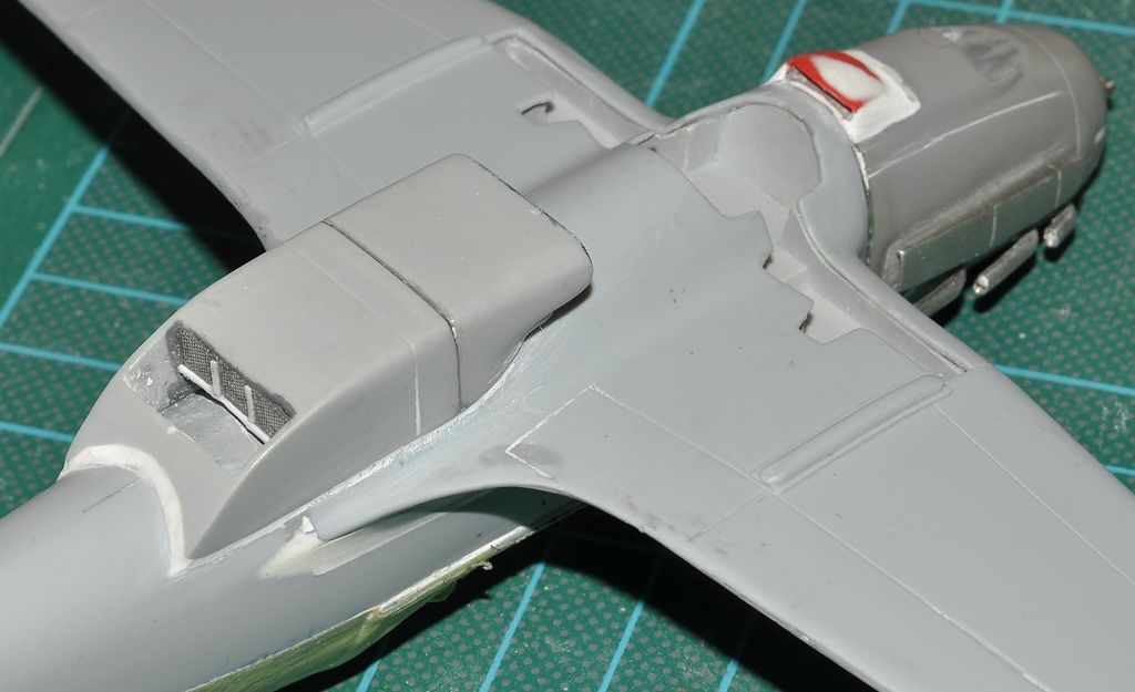

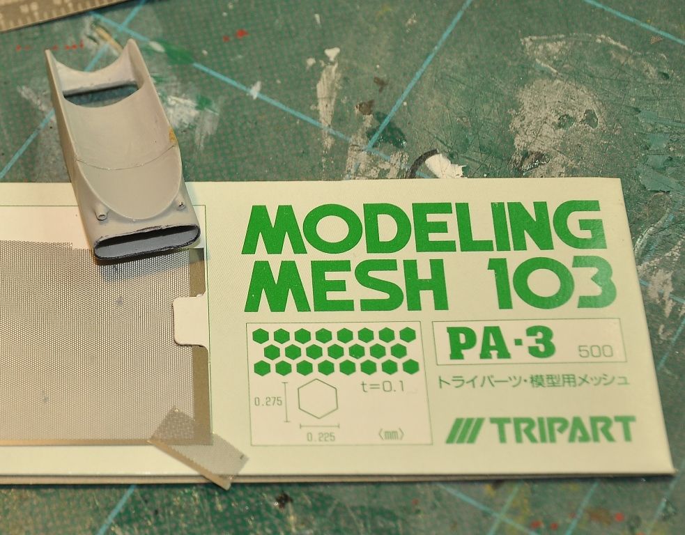

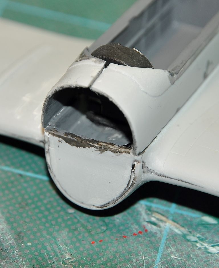

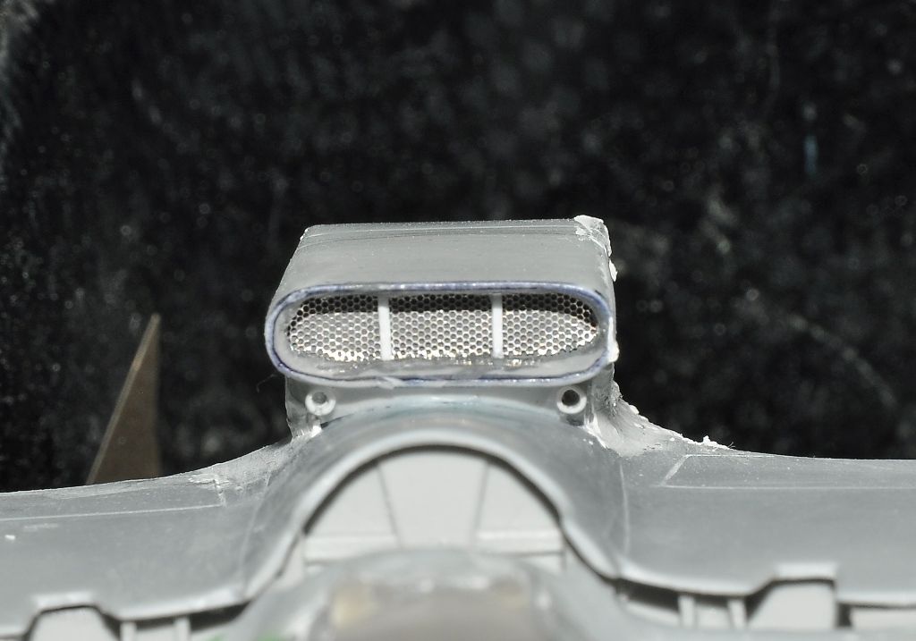

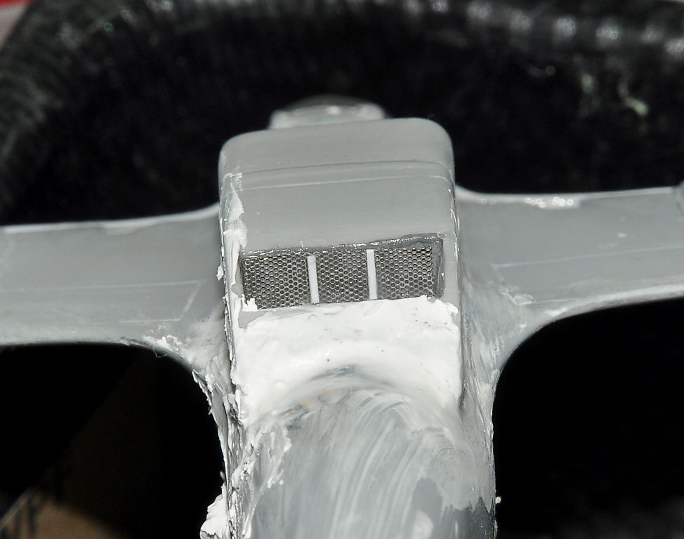

PaulT 876 Posted June 17, 2015 Author Posted June 17, 2015 Part threeThe Rad it looks a bit plane.I have used this P-E got it in the 80,s and this is the 1st time I have used this one I have used the square and round hole one before but can-not find them just now, must have a sort out to find them.A bit of plastic strip and the grill looks a lot better. The front.The rear and the filling needed to plug the gap left.Drilling these out and need to cut a grove behind each one.These are some of the kit bits for the nose. Flash more than Gordan I think. FittedYes naff so they are now in the bin and I now have to make new ones from plastic, this is how it has been with this kit all along try kit bits then scrape or mod to improve them.This is where I have got to so far, aim on hols this week so spending more time on it. I have done quite a bit to the nose section still some kit bits to fit, will see how this goes, then a few bits to the fuselage and we shall see how it looks.I shall stay with this kit and put the others on hold just now as I wish to finish this kit.I have to say in a strange way aim quite enjoying making it, aim having to think how to over come the kits faults and improve at the same time back to old time modelling and not shake and build.That's all for now hope to get a lot more done and will update then.Paul 1

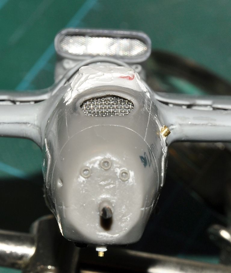

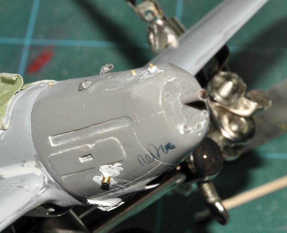

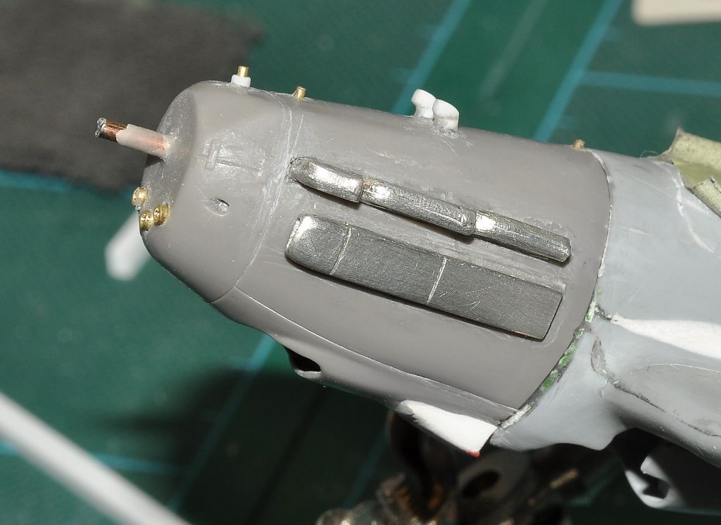

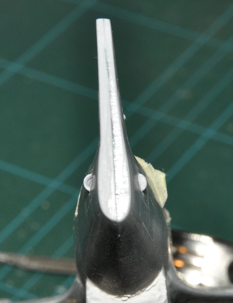

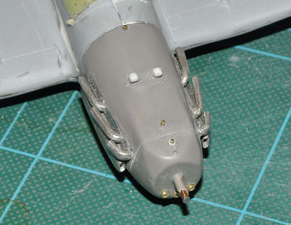

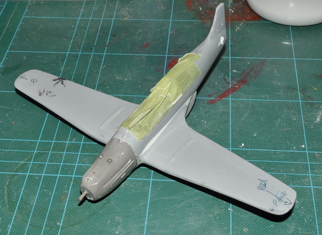

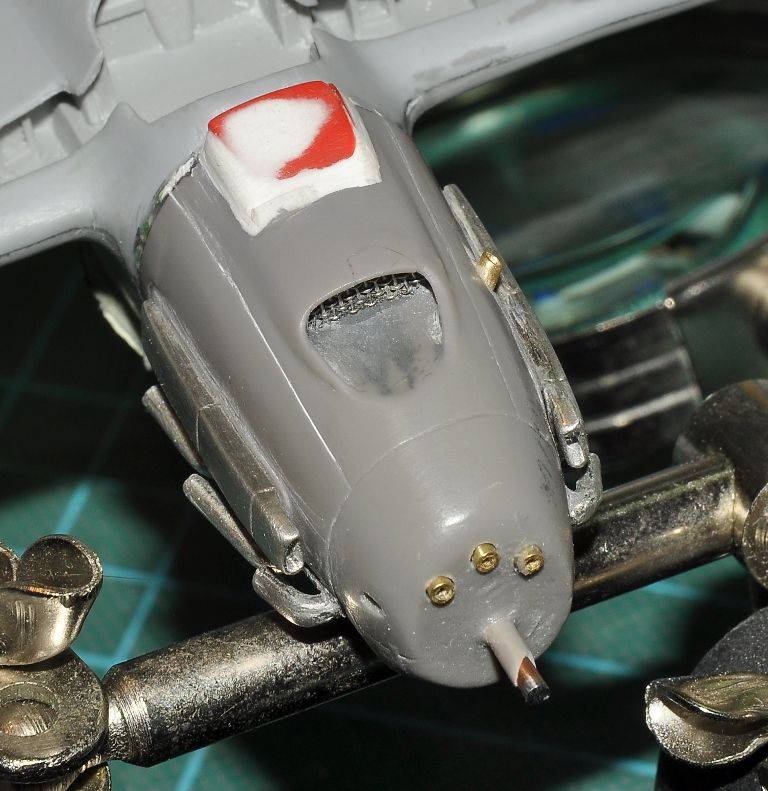

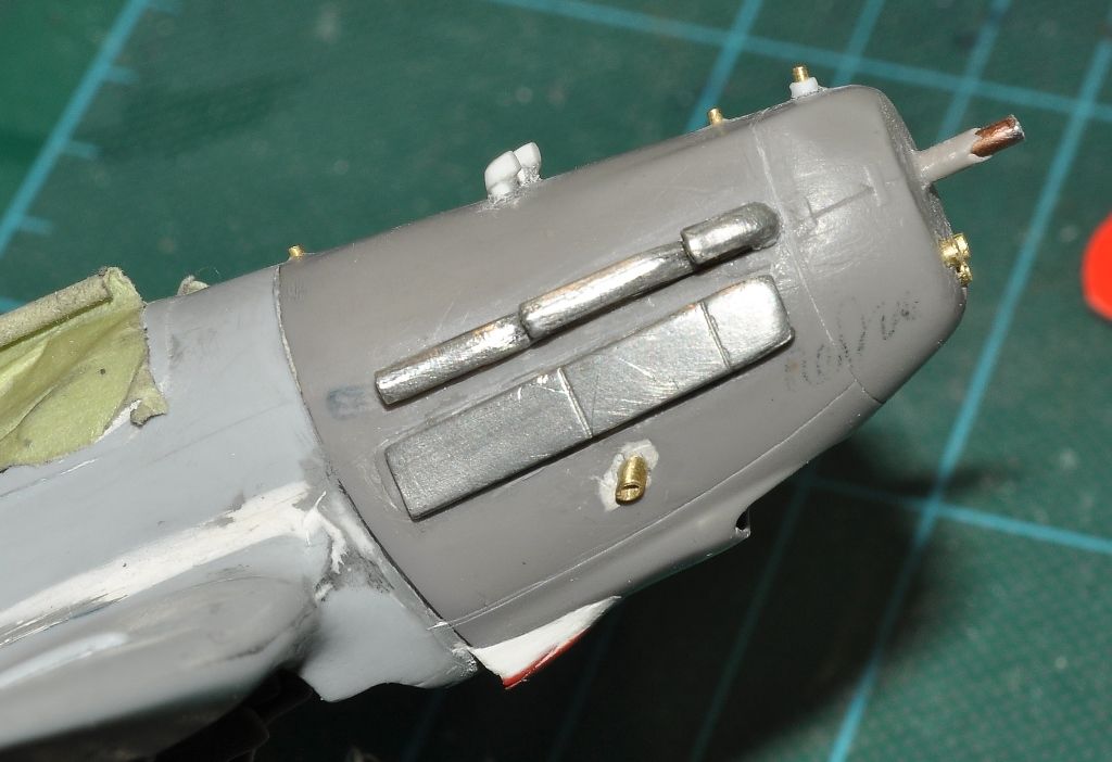

PaulT 876 Posted June 19, 2015 Author Posted June 19, 2015 (edited) HiI have got the nose done as much as I shall do to it apart from painting, if I say it went ok you will know aim telling porkies it took a long time.Here are the photos not to bad I think.The rad cleaned up just need to do the flap.Next I shall do some small details that I have seen in photo's, these are on the fuselage an not in the kit.Till next timePaul Edited June 19, 2015 by PaulT 876 1

BS_w Posted June 20, 2015 Posted June 20, 2015 (edited) Hi FM is wrong for the exhaust. There was 1 exhaust collector for 3 cylinders : 2 exhaust collector lined up on each side. each collector was in two pièces fitted together, but the front of rear collector was under the outlet of previous collector. Thus we can think that there was 3 exhaust collectors on each side. Good work on this FM model. Edited June 20, 2015 by BS_w
PaulT 876 Posted June 22, 2015 Author Posted June 22, 2015 Hi Many thanks BS_w ( What's your real name cant keep calling you BS_w its not polite) I have just found some better photos and I now can see that FM has got them wrong, I have side views but no top view. I have also noted from said photos that I need to change and add a few more bits to the nose section. I have also spotted that the rad at the rear has a second flap aim not quite clear how this should be, and there are 2 support bars at the front of the rad mined this is the easy fix the front one that is. Many thanks for the heads up and if you spot any thing more just say I would like as much info as I can to get it correct. It's a few steps back again but all good fun and to think I have 12 more FM / High Tech kits to do how much more trouble can that lot be. See Ya Paul
BS_w Posted June 24, 2015 Posted June 24, 2015 Hi Many thanks BS_w ( What's your real name cant keep calling you BS_w its not polite) I have just found some better photos and I now can see that FM has got them wrong, I have side views but no top view. I have also noted from said photos that I need to change and add a few more bits to the nose section. I have also spotted that the rad at the rear has a second flap aim not quite clear how this should be, and there are 2 support bars at the front of the rad mined this is the easy fix the front one that is. Many thanks for the heads up and if you spot any thing more just say I would like as much info as I can to get it correct. It's a few steps back again but all good fun and to think I have 12 more FM / High Tech kits to do how much more trouble can that lot be. See Ya Paul I have found the détail of exhaust in a Hispano Suiza manual for MS 475, I don't have another info about the MS 475, BS_Waroff

PaulT 876 Posted July 10, 2015 Author Posted July 10, 2015 Hi Thanks that is the same photo I have but you have a better copy, the drawing is also a great help. I shall not finish the kit in time, aim about 1/2 way in making new exhausts and the drawings will help a lot. Tried fitting the prop and found it’s too big and of centre that's being sorted also. I will post photos over the next few days when I get time. Thanks a lot Paul
