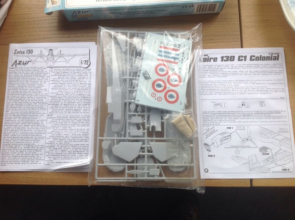

JOCKNEY Posted March 20, 2015 Posted March 20, 2015 As described in the title, it's politely described as unusual, or more accurately as just plain ugly. I haven't built an Azur kit before, so all advice very welcome, and as for the surrender stripes, your guess is as good as mine. Cheers Pat 8

Enzo the Magnificent Posted March 20, 2015 Posted March 20, 2015 Azur kits are really quite nice to build. BUT not Tamigawafix shake and bake !! I have quite a few Azur kits in The Stash and will be building four of them for this GB. They all seem to be nice kits and Jockney's Loire seems to be of a similar standard. One thing I really like about Azur is that the kits are very carefully packaged. The transparencies, resin and decals are always packaged separately in small plastic bags. 1

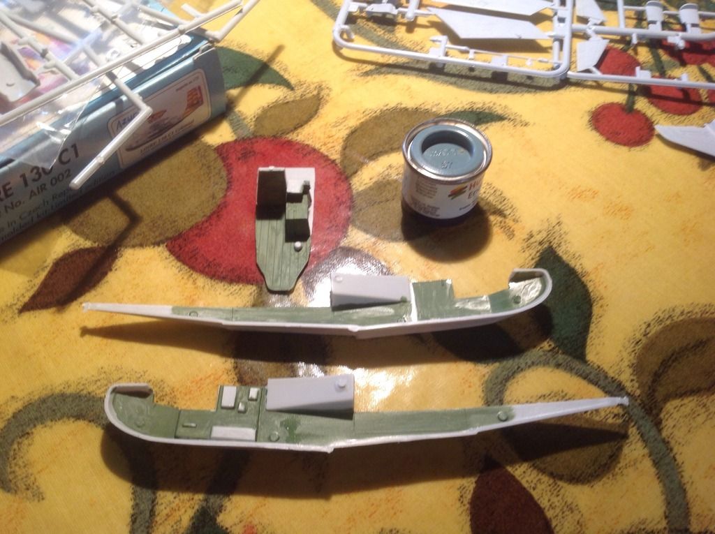

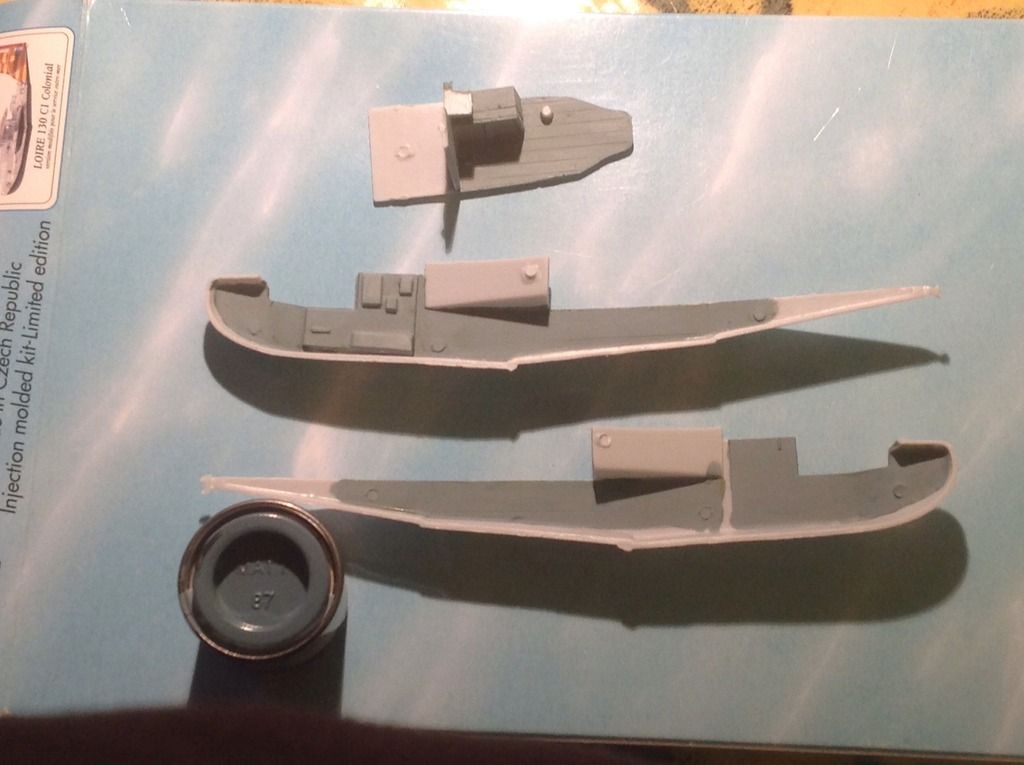

JOCKNEY Posted April 25, 2015 Author Posted April 25, 2015 Have a look back through this thread. It seems that the interior colour of most French aircraft was chamois, a sort of beige colour. I have been using German Dunkelgelb. Cockpit interiors of fighters were dark blue, while those of other aircraft were a blue grey, similar to the uppersurface colour.For my Potez 63-11 I will be using:Uppersurfaces:Lifecolor UA145 Gris Blue FonceLifecolor UA142 French KakiLifecolor UA143 French BrownUndersurfaces:Lifecolor UA141 Gris Blue Clair to the GB!B*gger ! Guess who has just painted the inside of his bus-shelter, err I mean aircraft, cockpit green. Is there a humbrol equivalent of UA141 Gris Blue Clair ? Well just to prove it photos before and after below, not sure if the paint is correct, but it's closer than it was ! Repaint in humbrol equivalent Now before I paint anything else, what colour are the seats ? Cheers Pat 2

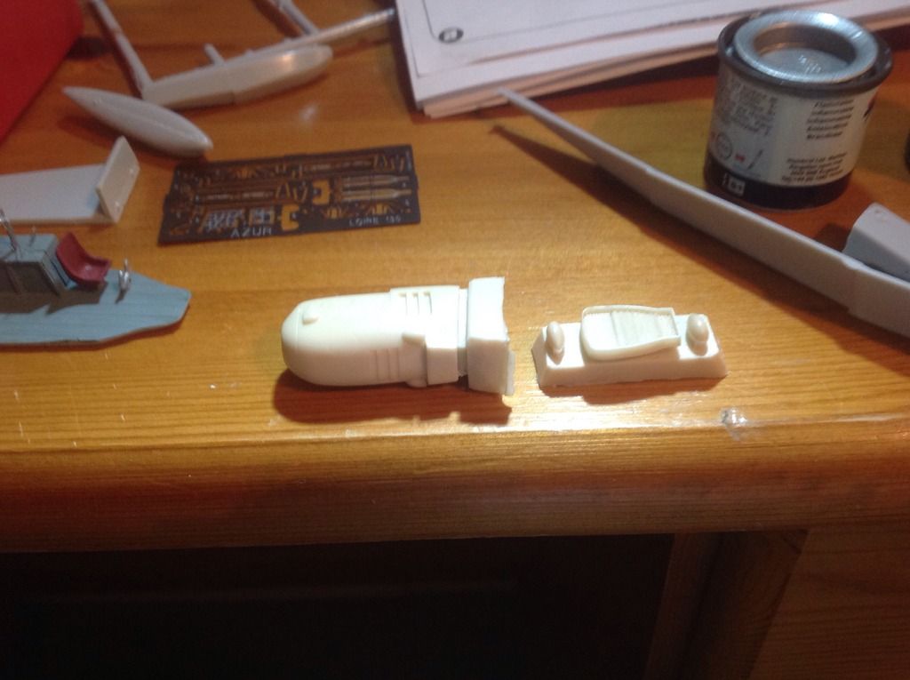

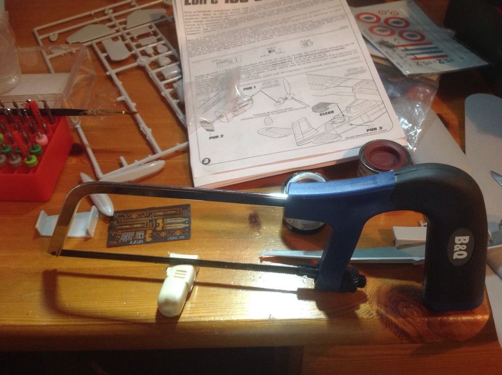

JOCKNEY Posted May 16, 2015 Author Posted May 16, 2015 Apologies for the lack of posts, normal reasons work and domestic bliss ! The above shows my first encounter with Resin, that are the tropical parts, not to the uninitiated, how do you get the resin bit you want off the resin bit that's surplus ? If there is an easier way than this, I'm all ears. If all goes according to plan tonight I hope to get the fuselage halves together, more tomorrow Cheers Pat 2
Rob G Posted May 17, 2015 Posted May 17, 2015 Razor saw and/or scribing and/or cutting disc in a motor tool, as appropriate to size and shape of bits. Just be aware that resin dust is pretty nasty, once it's in your lungs it stays there - always wet sand it, and use a dust mask if using power tools or if you feel the need for extra protection. 1

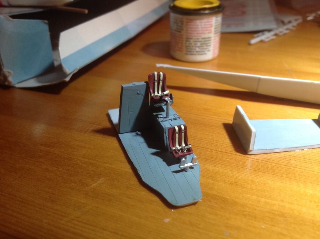

JOCKNEY Posted May 18, 2015 Author Posted May 18, 2015 Well after an epic battle with the carpet monster I failed to get the fuselage together. Progress above on seats but an instrument panel continues to be held hostage by the carpet, and as I am staying away in a hotel, unless it appears this morning it will have to remain lost. The fallback position will be to paint the area black with some white dots, after all I don't know how much you can see once it's all closed up. 2
