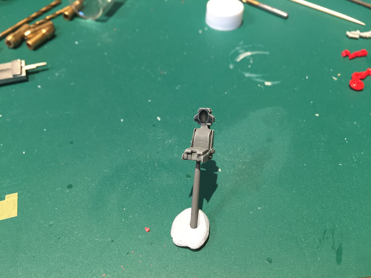

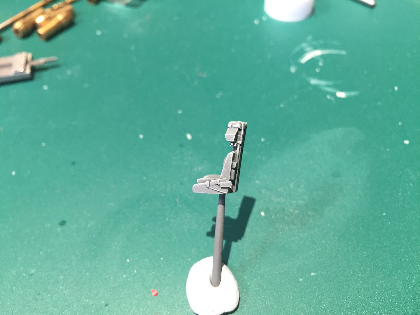

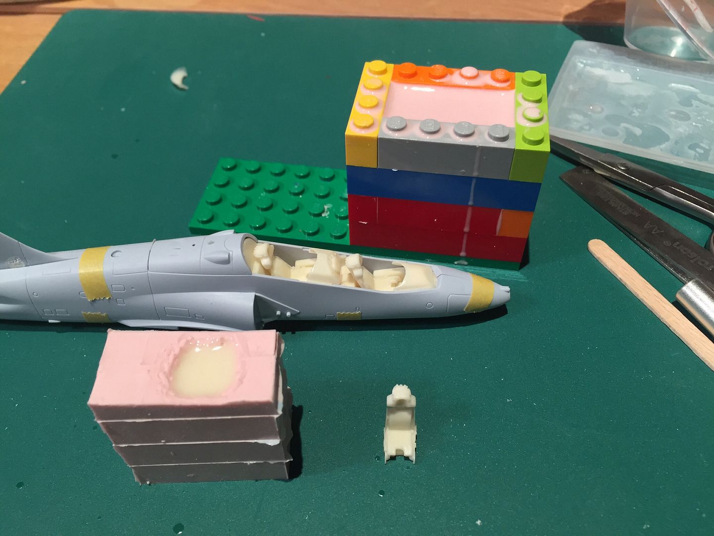

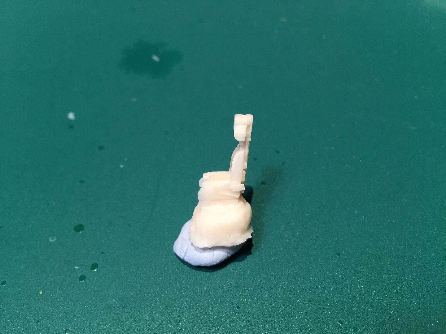

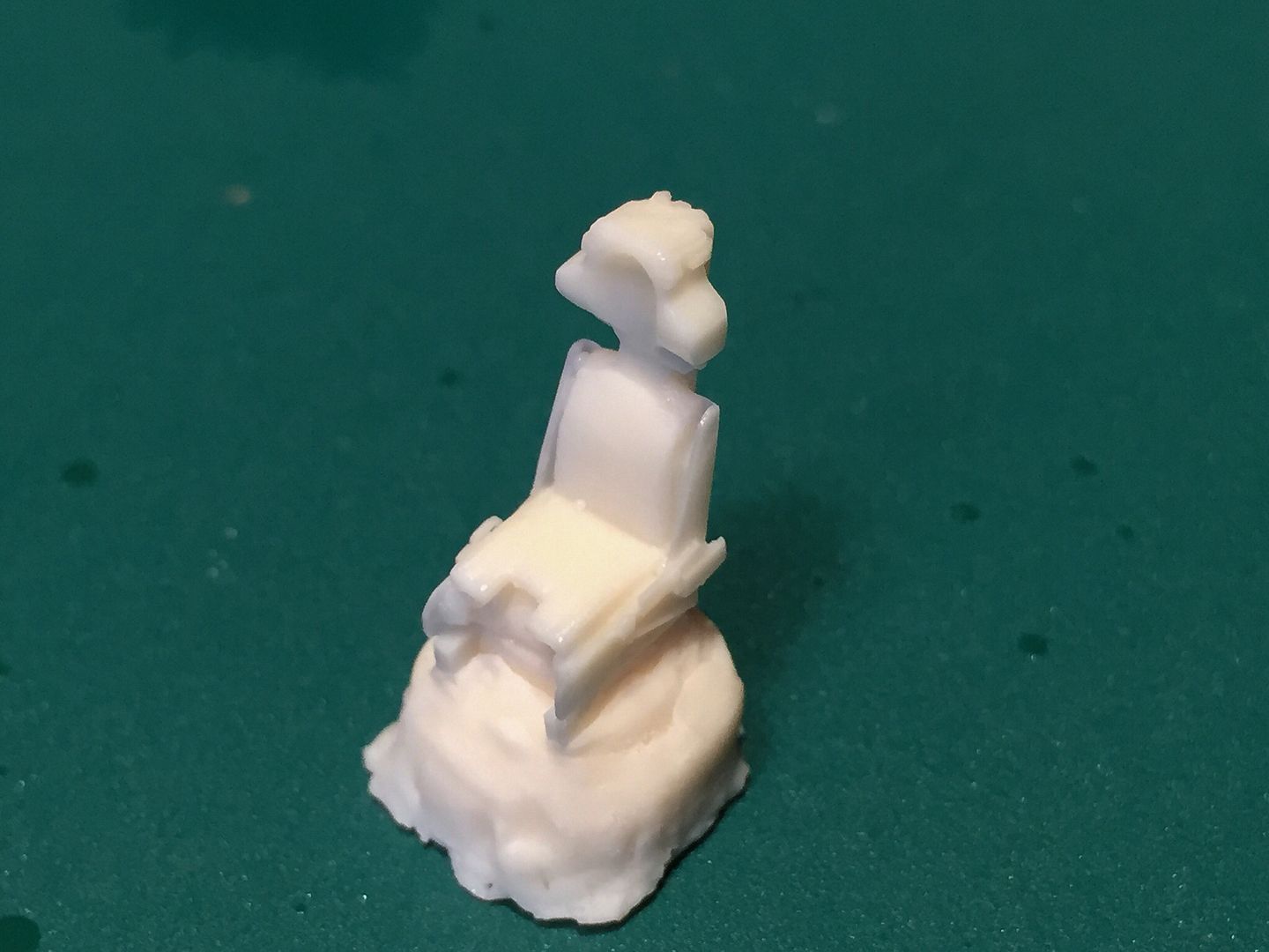

Fritag Posted April 18, 2015 Author Share Posted April 18, 2015 (edited) I will attempt to surgically remove the aforementioned etchie bits from the hulk that was to be the black tiger 74 squadron hawk, that I found in the cavity walling behind the shelf of doom! Mark; Etchie and other bits all arrived safely. Definitely be making use of some of the etch. TVM. In other news I've now made a mould of the bang seat - using the RTV recommended by CT - which sets in about half the time of my old stuff and so is about twice as useful...... Am pretty pleased with the result. I decided to try it without the webbing between the head box and seat - relying on the elasticity of the RTV to allow the seat out of the mould. Relieved to say that I got away with it. Here's a resin cast. the detail reproduced pretty faithfully - but I've had trouble getting a decent piccie cos the resin is so light in colour - even these are a bit overexposed: And a couple of all the resin bits for the cockpit dry fitted together: I've made a second RTV mould - just to see if I can avoid the one or two tiny air bubbles that occurred on the first: Well it's been fun being a mini-me CT - but it's now time to do some old style modelling on the pair of em :) Edited April 18, 2015 by Fritag 16 Link to comment Share on other sites More sharing options...
Cheshiretaurus Posted April 18, 2015 Share Posted April 18, 2015 Those have come out very nicely, pleasantly surprised too that the webbing wasn't needed, Your becoming a master a this. 1 Link to comment Share on other sites More sharing options...
hendie Posted April 18, 2015 Share Posted April 18, 2015 I'd say the operation was a success. Those seats look very good but I am sure will look even better once you have them painted and added all the bondage gear Link to comment Share on other sites More sharing options...
andy wood Posted April 18, 2015 Share Posted April 18, 2015 Fritag, glad those seats came out ok, but the head recesses look a bit too deep to me. Is that the just the photo? Link to comment Share on other sites More sharing options...
perdu Posted April 18, 2015 Share Posted April 18, 2015 Those have come out very nicely, pleasantly surprised too that the webbing wasn't needed, Your becoming a master a this. The boy's doing this very well isn't he I like the seats Steve, quality stuff as ever And the look of the pieces all 'at home', is excellent Link to comment Share on other sites More sharing options...
Fritag Posted April 18, 2015 Author Share Posted April 18, 2015 Fritag, glad those seats came out ok, but the head recesses look a bit too deep to me. Is that the just the photo? The photo makes em look a bit pinched and slightly strange - I think it's the iPhone having difficulty with the cream coloured resin. Nonetheless I think the recesses are indeed a bit deep Andy. However I don't think it'll notice once the straps are put in place. 2 Link to comment Share on other sites More sharing options...
perdu Posted April 18, 2015 Share Posted April 18, 2015 Steve you can 'shallow' them out using paint brushed in and left solid inside but brushed out on the edges That will reduce the inner depth of the hollow without much affecting anything else That said I think you are right, the headbox straps will cover the hollow pretty well Link to comment Share on other sites More sharing options...

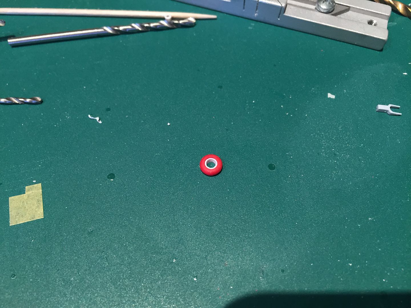

perdu Posted April 23, 2015 Share Posted April 23, 2015 I'm glad those lessons in making wheels from oddments stuck in your noddle Steve That IS the way to do it Er, the actual wheel. Do you not have a ready supply of Starbuckses plastic stirring sticks around? Shocked I am, I thought I'd taught you the art of plastic foraging well enough Joking and peetaking apart, there's enough quality in your first wheel to leave me encouraged for the future I do feel for you though, I have fond (he lied!) memories of making all of the undercarriage legs and wheels for an improved 'Red Flag' desert cam Buccaneer many years ago when I deemed the Matchbox ones unsuitable (they weren't really either, I was just flexing early 'detailing' muscles) nice start dude (anyone out there who can tell me why oh why I decided to upgrade Win XP to Win 7?) b 2 Link to comment Share on other sites More sharing options...
Cheshiretaurus Posted April 23, 2015 Share Posted April 23, 2015 That bang seat look even more fantastic now with a lick of paint, what kit did that nosewheel fork come from? is it the CMK one. Looking forward to the master at work on this one. (anyone out there who can tell me why oh why I decided to upgrade Win XP to Win 7?) Wait till you see win 8, if it aint broke dont fix it mr microsoft. 2 Link to comment Share on other sites More sharing options...

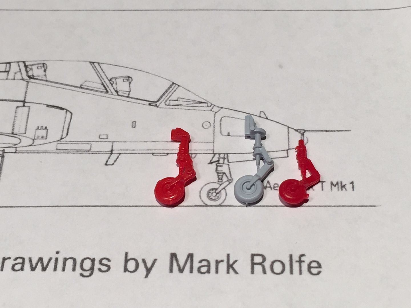

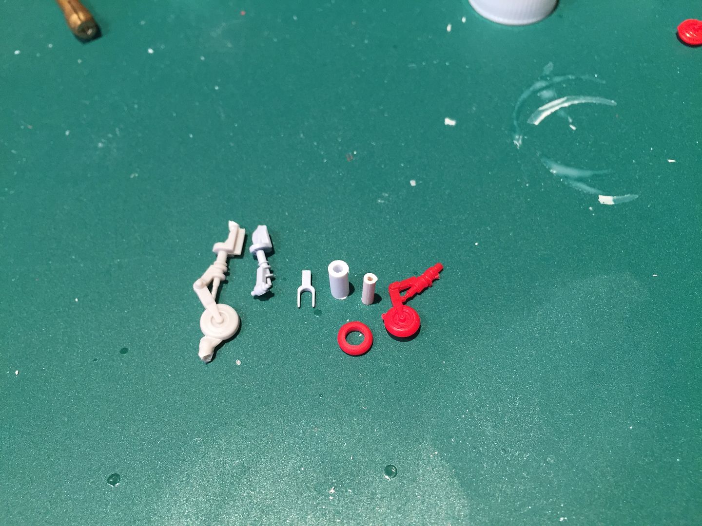

Fritag Posted April 23, 2015 Author Share Posted April 23, 2015 (edited) I'm glad those lessons in making wheels from oddments stuck in your noddle Steve That IS the way to do it You comfort me Bill what kit did that nosewheel fork come from? is it the CMK one. No - it's carved from the airfix nose leg you see in the piccie: The one on the left is an Airfix kit offering. The one to its right has had the fork section with moulded in wheel cut off - and next to that in the middle is the fork after the wheel and excess has been carved away. Edited April 23, 2015 by Fritag 8 Link to comment Share on other sites More sharing options...
hendie Posted April 23, 2015 Share Posted April 23, 2015 Be better still if I didn't have to make a nose wheel would never have had that problem if you'd been building a helicopter! Nice work though. I'll bet you're starting to get that warm mushy feeling already. - A few bits of brass tube, some more plastic butchery and you'll have a fine leg to stand on. 3 Link to comment Share on other sites More sharing options...
Ex-FAAWAFU Posted April 23, 2015 Share Posted April 23, 2015 As so often, Steve, your work is helping mine, even though at the moment I am in Burgundy and 500 miles from the nearest "playing with plastic" (has your wife been talking to mine, by any chance?). I have been pondering how to improve the Vixen nose wheel - the main wheels are fine because they will just have hit the deck, but the nose strut needs extending; I think you've just shown me how to do it. Thanks, mate! Coming on nicely. But as Hendie says. it's still not a helicopter! (I am toying with doing a Sea King next, but the rotor head is one thing that' saving me pause...) Link to comment Share on other sites More sharing options...
