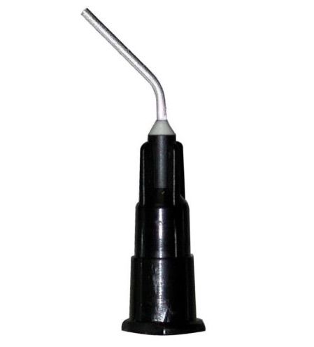

perdu Posted April 7, 2015 Posted April 7, 2015 Steve has obviously mastered it, but some might find the following applicator tip useful for attaching to syringes to get fluid resin into "difficult" corners of moulds prior to set: They can be purchased from EBay as "Disposable Pre-Bent Dispenser Needle Tips 20pcs 20G BLACK Luer Lock Slip Dental" They look ideal MD, does the gauge make much difference when using them with resin? I might put in an order for a 100 25 gauge if they will do the job, £6.99 INCLUDES FREE POSTAGE (but has to travel a long way from Shanghai) Does that sound OK to you? Steve does your mould for the tubs have a cut at the back so you can pull the piece out easily or does the mould deform enough to release without cutting it? The coamings especially look very good It is a real shame about Graham Wardell, the name and incident rings faint bells too Shows no matter how good we are there's always a few don't beat the clock. Terrible for that to happen when he'd been so lauded by the Service though, makes you think

dr_gn Posted April 7, 2015 Posted April 7, 2015 They look ideal MD, does the gauge make much difference when using them with resin? I might put in an order for a 100 25 gauge if they will do the job, £6.99 INCLUDES FREE POSTAGE (but has to travel a long way from Shanghai) Does that sound OK to you? I'll bring a few of those to Cosford for you as well if you like 1

MolarDoc Posted April 8, 2015 Posted April 8, 2015 (edited) They look ideal MD, does the gauge make much difference when using them with resin? I might put in an order for a 100 25 gauge if they will do the job, £6.99 INCLUDES FREE POSTAGE (but has to travel a long way from Shanghai) Does that sound OK to you? Hi Bill, PM sent - Sorry to hijack the thread Steve. Edited April 8, 2015 by MolarDoc 1

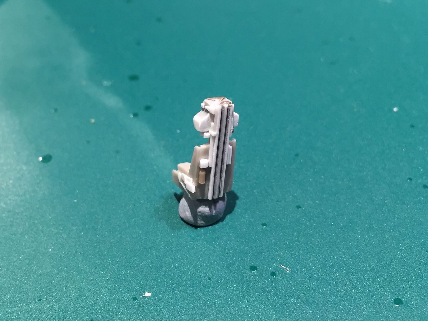

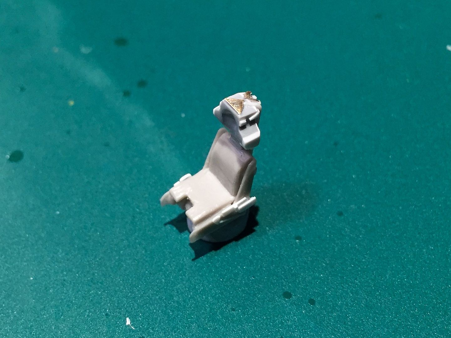

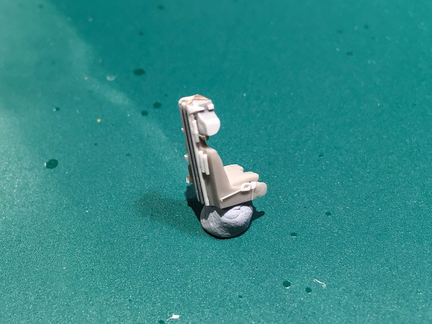

Fritag Posted April 14, 2015 Author Posted April 14, 2015 And to square the circle, just ordered twice as much as the first orderI've just taken delivery of some too. Ta for the reccomendation CT. I've been largely awol from the modelling bench for the last week or so cos of work - and as it happens I'm away from home for a couple of days as I type this.......but now that I've got some more RTV I'm about ready to have a bash at creating a mould to cast the bang seats. This is what I've cobbled together as the master: The head box cheeks stick out quite far and there must be a risk that I'll rip the head box off trying to get it out of the RTV mould. For this reason I had thought about casting the headbox seperately - but recent experience with the coamings and tub has persuaded me that the RTV is soft and malleable enought that I should be able to tease the seat master out without damage. We'll see - I'm sanguine about it...... I'm also not sure how well the mould/casting will pick up the bits and bobs - I'm sanguine about that too I've left the back pads and the harness off for simplicity - I'll add them individually and so hopefully add a bit of character. Also I'll probably model the rear seats with the solo flight aprons in place. So not a lot of progress - but if all goes to plan I should have 2 pairs of seats to combine with the tubs and coamings by the weekend. Steve 13

keefr22 Posted April 14, 2015 Posted April 14, 2015 Nice work again Steve. Good luck with getting the seats out complete- while I've found the RTV has no trouble picking up the small details, I have about a 75% failure rate in getting 72nd scale seats out of the mould in one piece. But I'm sure you'll have more success - & it must be possible as Pavla, Quickboost etc all manage it. I'm sure I'm just clumsy...!!
Cheshiretaurus Posted April 14, 2015 Posted April 14, 2015 I've just taken delivery of some too. Ta for the reccomendation CT. Tis good stuff, just not my shade of pink! That seat looks excellent, I'd be happy to take any excess ones you might cast inadvertently off your hands. also if you cast too many tubs.......... You might want to fit a thin webbing between the head and the seat on each side to make a slit wide enough to pull it through or it might get stuck by its head (gut feeling). My first thought might be to use krystal clear for this in the way its suggested to make small windows from this stuff. The webbing can be removed in the clean-up of the casts. CT 3

Fritag Posted April 14, 2015 Author Posted April 14, 2015 ............You might want to fit a thin webbing between the head and the seat on each side to make a slit wide enough to pull it through or it might get stuck by its head (gut feeling). My first thought might be to use krystal clear for this in the way its suggested to make small windows from this stuff. The webbing can be removed in the clean-up of the casts.Ok CT. Sounds like wisdom to me. I'll try something of the sort.Funny - I wos gonna bring a tub and a pair of coamings to Cosford to show you...... But then I figured that maybe that wos a bit like taking homework in to teacher for marking 1
