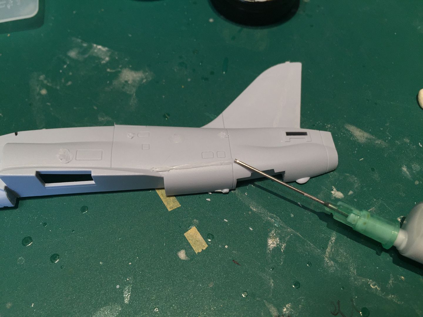

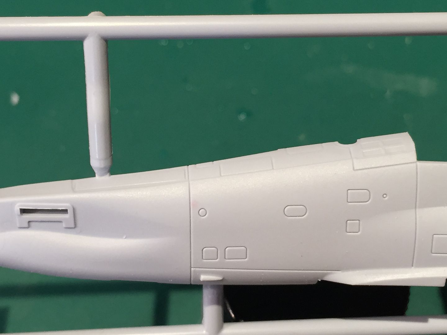

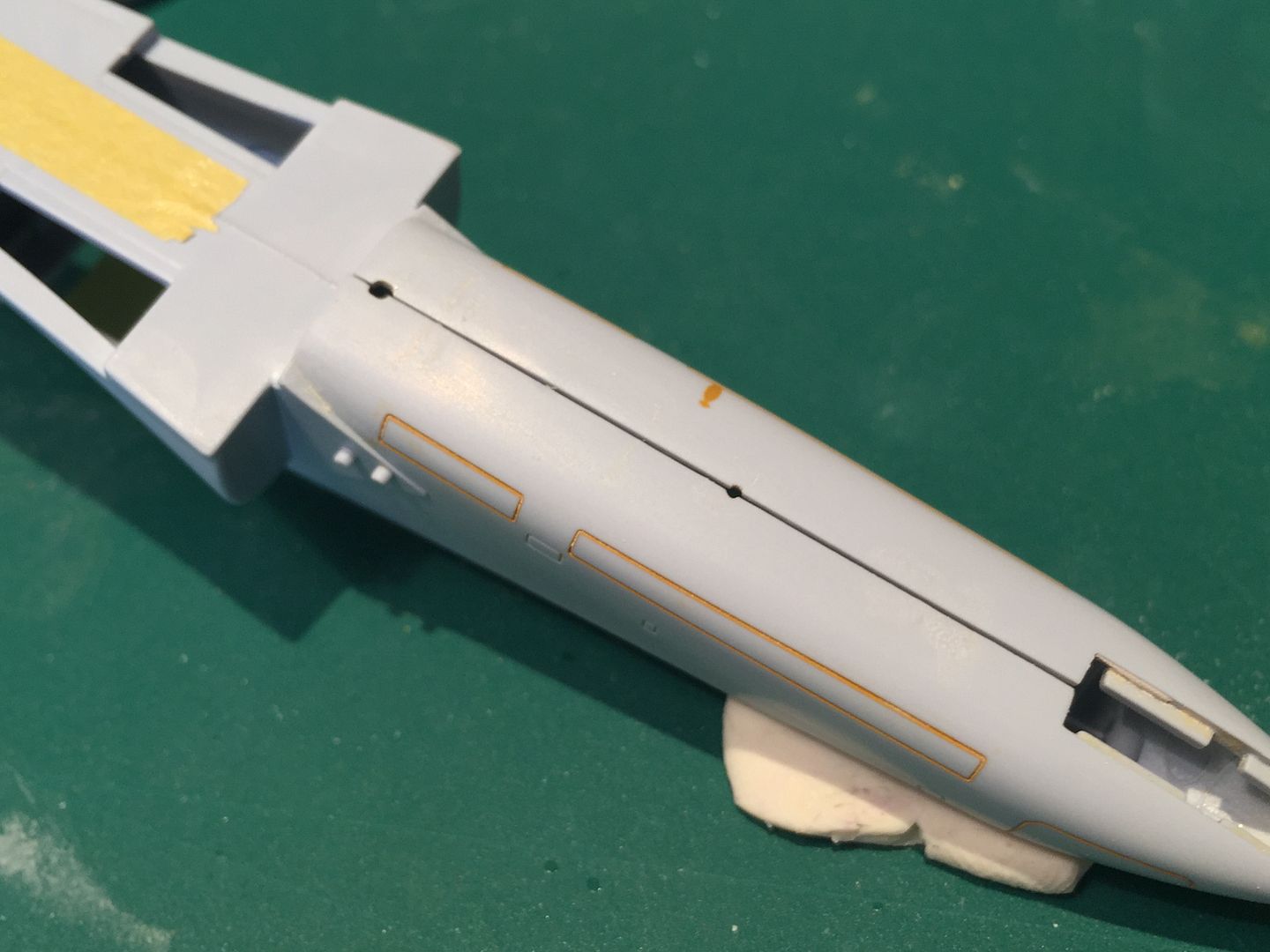

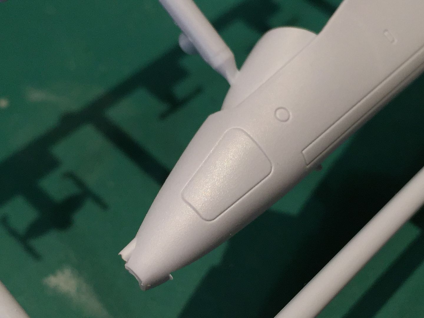

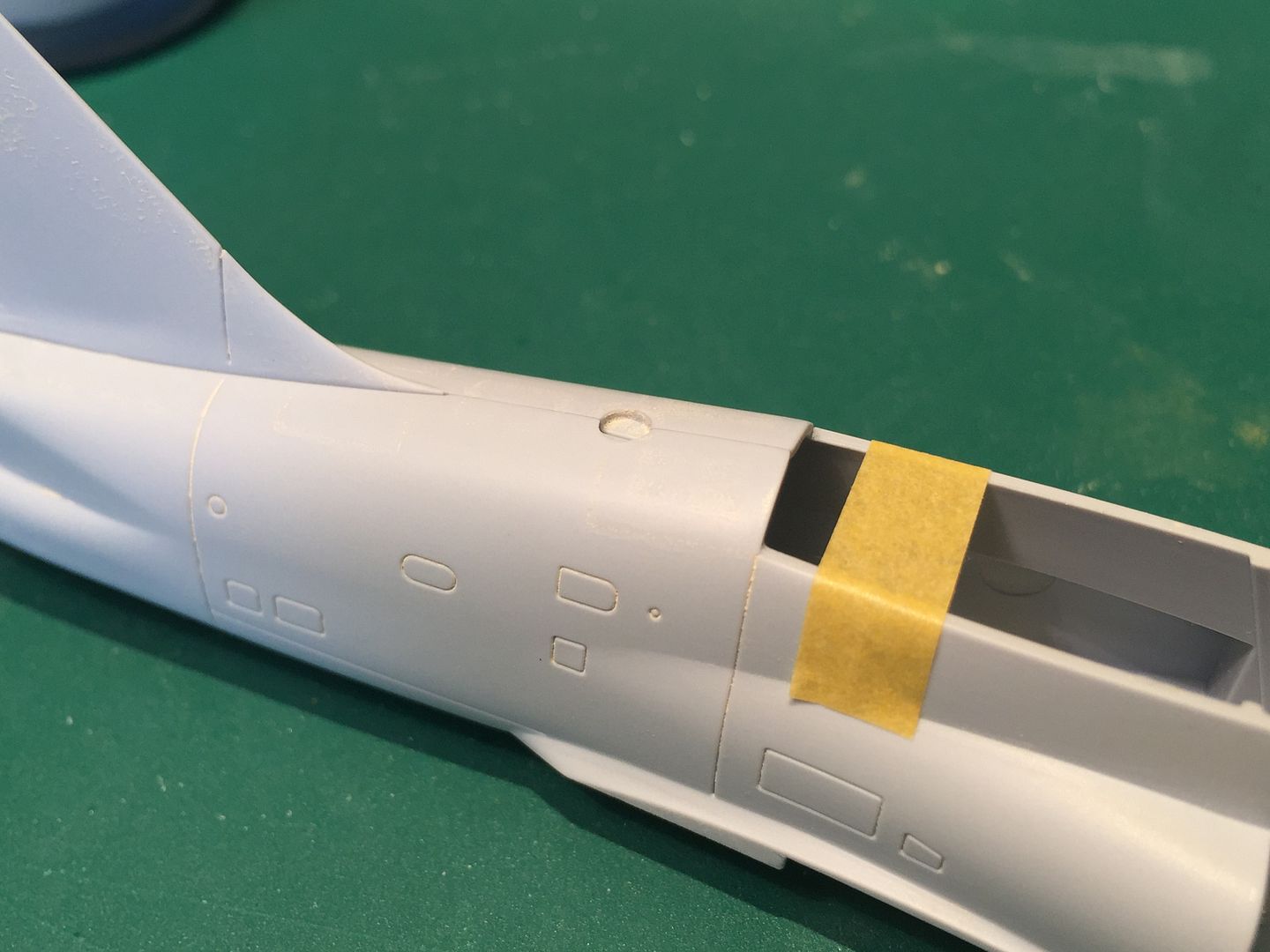

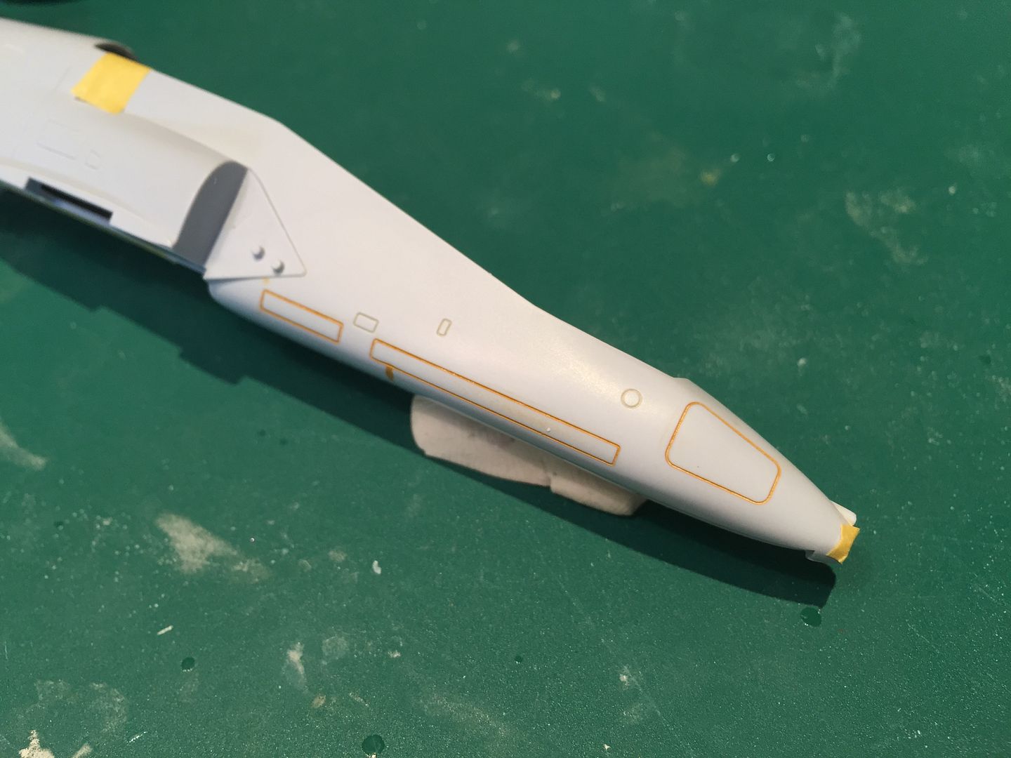

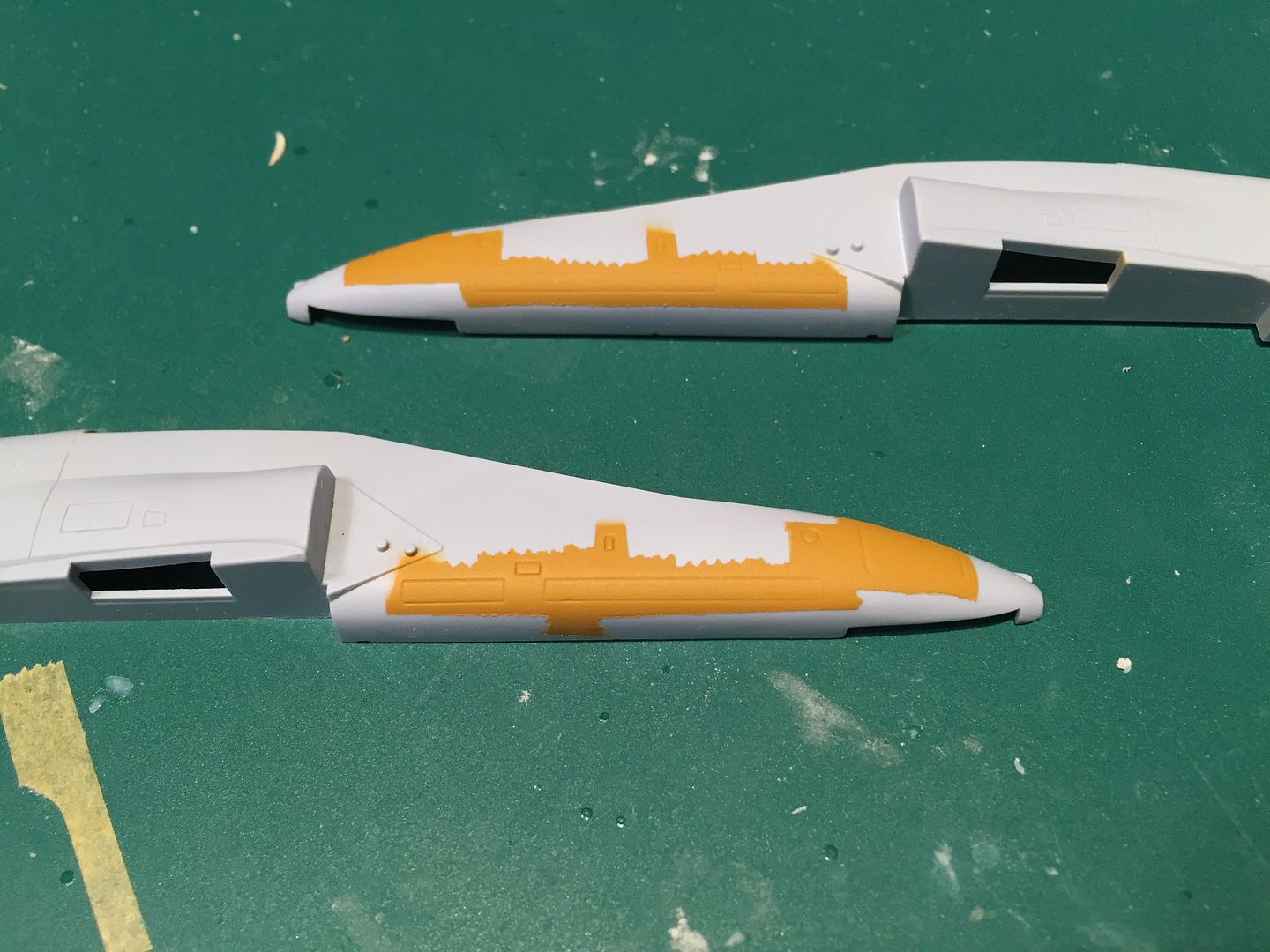

Fritag Posted June 1, 2015 Author Posted June 1, 2015 Ayup Steve, real life still getting in the way or have you managed to get back to these at all? Cheers. Not really got back to them Guy They've been mostly losing the competition for leisure time with other things at the mo'. We've been trying to get out into the Dales or the Moors on the bikes as much as possible when the weather's been fine - what's the point of living in 'God's own Country' unless you make the most of it? Also I've been trying to brush up the rusty skiing skills at snozone in Castelford (30 years rusty!) - hoping to go skiing in the New Year with some old RAF chums and its V V important not to be too embarrassingly awful....... So - one way or t'other the poor old boy's been a bit kn*ckered in the evenings...... I have been fingering the plastic a little tho'. Enough to find the surface detail on the Hawks rather disappointing. After the old chippie and JP5 mouldings I was hoping that the much more recent Hawk tooling wouldn't need much work on stuff like panel lines and moulded detail. Wrong..... There are some pretty awful trenches moulded in, and some curious recessed sections on the spin and underneath of the fuselage (possibly due to wear on the moulds?): So I've put some thought in to what to do. Keen to avoid 2 x rescribes if at all possible I'm using one of the 2 Hawks as a test bed. I've filled the curious and inaccurate recessed details on top and bottom with sprue dissolved in liquid poly (as recently discussed on Tom's Hunter thread IIRC) - the aim being to leave a consistent surface for any scribing that I need to do later: Sanded down and polished up OK And I'm trying to reduce the trench like panel lines - without filling and rescribing them - by masking and spraying with Halfords Filler Primer and cutting it back. Hear after one coat: And here a second coat before cutting back: If I don't get nice neat panel lines I may have to revert to the dissolved sprue - which I've just discovered with testing on a scrap fuselage can quite neatly be applied along panel lines with a hypodermic needle Sorry for the lack of progress chaps..... 13
perdu Posted June 1, 2015 Posted June 1, 2015 looks progressy to me Steve I'm seeking more excuses to use some of doc's hypo needles too, using them on dissolved plastic, that's a fabulous idea I think the filler primer might 'mark up' a bit snatchy when you try rescribing, but that is simply a guess I have only ever used it on my Midget when I was painting her, many years ago
dr_gn Posted June 1, 2015 Posted June 1, 2015 I tried Halfords filler primer on a new tool Airfix Spitfire Mk.1 - no luck; as Perdu said it was too brittle to rescribe nicely. It's the only model in recent times I've chucked in the bin and not bothered to try again (just bought the Tamiya version instead).
Fritag Posted June 2, 2015 Author Posted June 2, 2015 I think the filler primer might 'mark up' a bit snatchy when you try rescribing, but that is simply a guess I tried Halfords filler primer on a new tool Airfix Spitfire Mk.1 - no luck; as Perdu said it was too brittle to rescribe nicely. I'm not surprised by that - and I'm using it it see if a few layers of it will reduce the depth and width of the panel lines and save me the chore of rescribing. It's a big ask and I'm not confident the results will be crisp enough for me - but nothing ventured nothing gained 1
