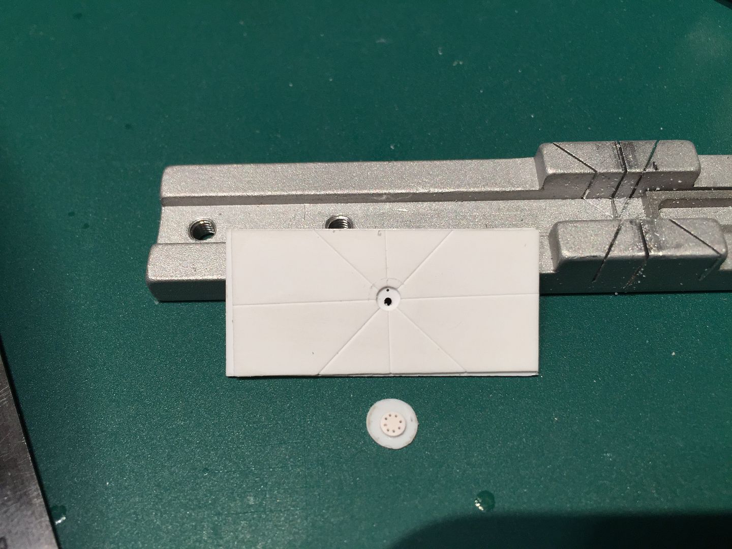

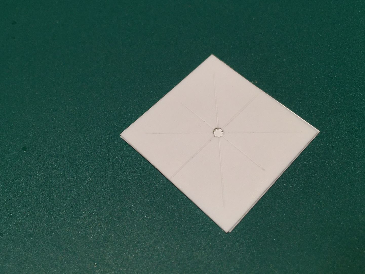

perdu Posted April 29, 2015 Share Posted April 29, 2015 (edited) Girl Friday buggeritanddammit I never thought of that honest guv'ner Have you decided whether to overeg the pudd'n or just rest and be thankful with eight tidy and very acceptable holes Steve? But if you do want uplifted bolts you might try using your hole jig to make bigger rather than smaller How about placing the jig thingy into the hole in the hub and dropping something like liquified Perfect Plastic Putty into each hole with a bit of plastic rod then lifting the jig out of the location leaving the little stubs of putty in place? Clean the holes out each time of course with the little length of rod afterwards It might work and has to be worth having a go Girl Friday Wow Edited April 29, 2015 by perdu 3 Link to comment Share on other sites More sharing options...

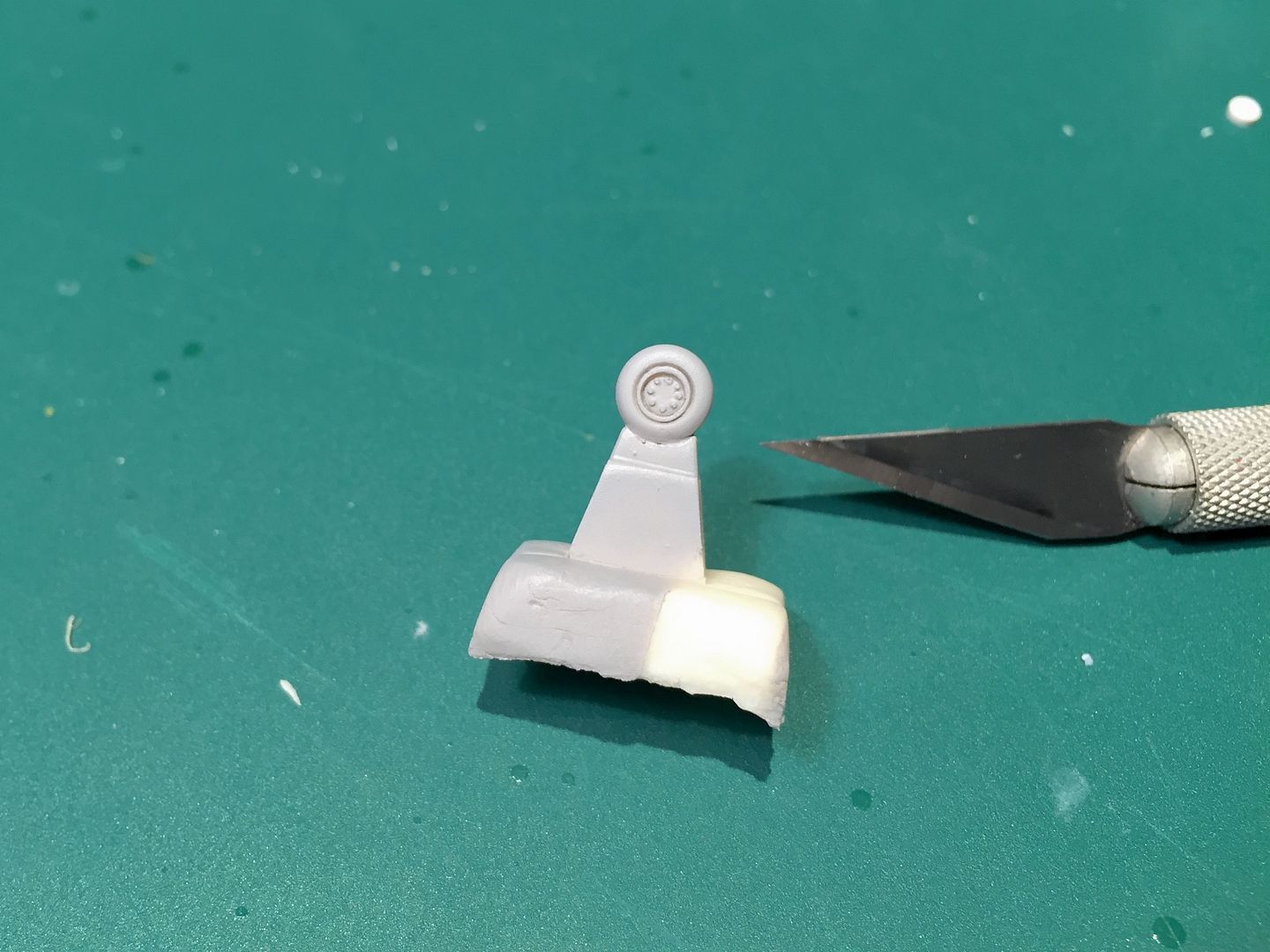

Fritag Posted April 30, 2015 Author Share Posted April 30, 2015 Have you decided whether to overeg the pudd'n or just rest and be thankful with eight tidy and very acceptable holes Steve? This is definitely one of those modelling blind alleys Bill - that is absorbing a wholly disproportionate amount of time and attention. Trouble is it's a bit of a challenge - pointless really given that it's only a bloomin' nose wheel - and frankly the hub is hardly noticeable at that! - but it's been fun..... I had a go gluing some stretched sprue into the drilled holes but I found it impossible to trim them neatly enough to look good. It would definitely work on larger wheels but I couldn't make it work on my little nose wheel. Actually I'm pretty sure the most effective and the neatest look will be simply to leave the hub plain However: I like the idea about using perfect plastic putty - I see where you're coming from Bill - and in a similar vein I had thought maybe I could make a template and spray Mr Surfacer 500 through it to leave little raised stubs. Dunno tho' - the working area is just so small...... I did have another play last night whilst watching telly..... This time I tried punching raised stubs from behind 0.1mm plastic card: Started with a marked guide: Punched a 2mm disc of 0.1mm plastic card, and then popped it into the guide, and then pushed some dents in it: And then reversed the disc and popped it over the wheel hub: Well - it gives 8 little raised circles and it ain't bad - but not really as crisp as I would like. I'm not sure it's any better than leaving the hub plain. 10 Link to comment Share on other sites More sharing options...
perdu Posted April 30, 2015 Share Posted April 30, 2015 Seems to me that after a dash of primer or finish colour and a wash of 'dirty' that would be the ideal 'job done' job How about drilling the eight holes into a harder plastic like formica so the holes get a more defined edge when you impress them? Then doing the same business with the template to get the accuracy... Just another thought from the research arm of BM Link to comment Share on other sites More sharing options...
hendie Posted April 30, 2015 Share Posted April 30, 2015 I think I'd be tempted to call that one a win and move on to the next wholly disproportionately time consuming task 5 Link to comment Share on other sites More sharing options...

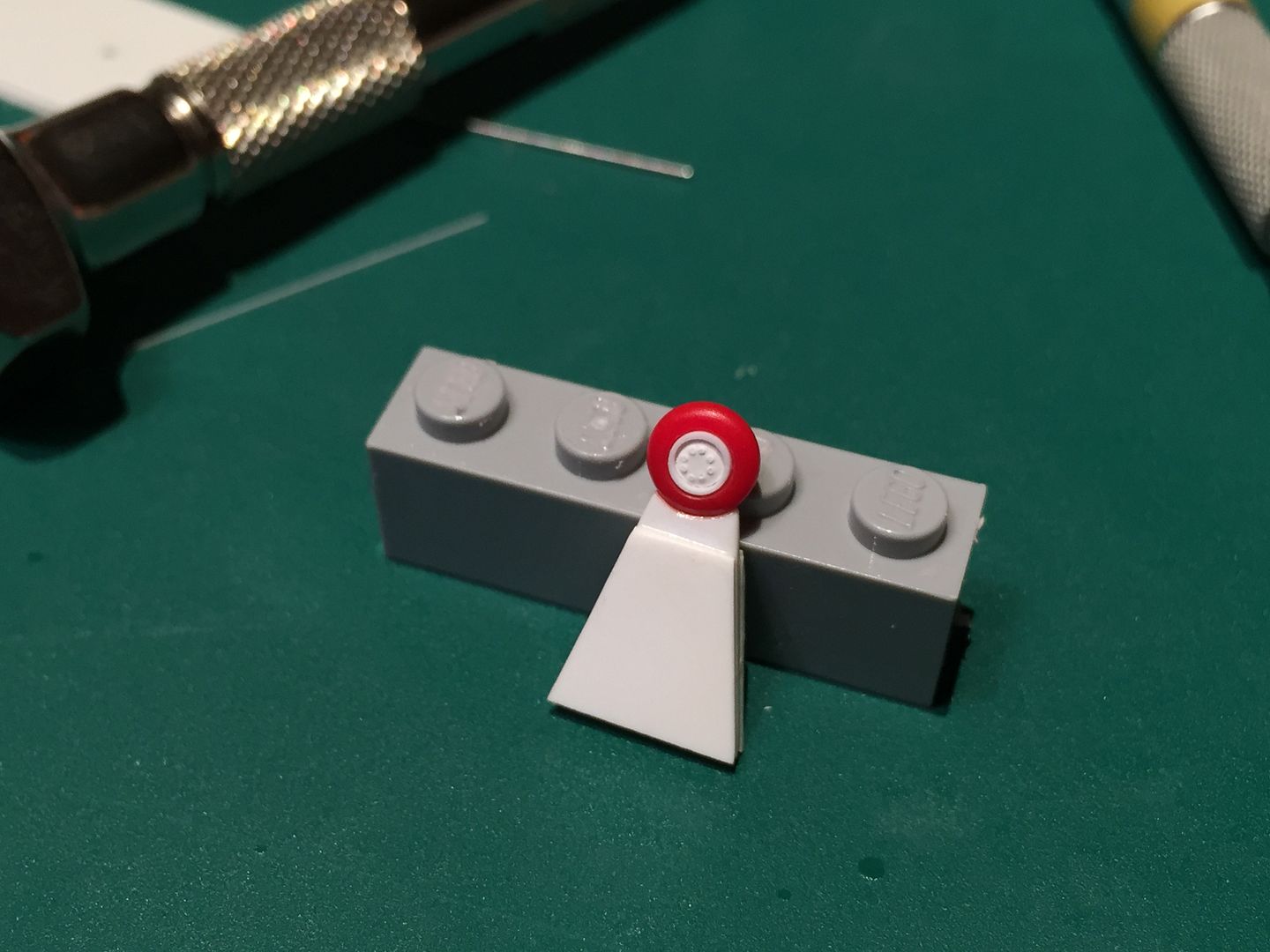

Fritag Posted April 30, 2015 Author Share Posted April 30, 2015 I'm fed up with it anyway - as I'm sure all of you are It's been more of a displacement activity than proper modelling Garth - thanks for the pointer towards the Studio 27 nuts/rivets - they are lovely - I couldn't hope to match the crispness and neatness of those. The smallest I could see were 0.4mm - very useful (may will invest in some)- but even then too big for my little nose wheel. 1 Link to comment Share on other sites More sharing options...
Ex-FAAWAFU Posted April 30, 2015 Share Posted April 30, 2015 Job done! Outstanding. I think you should leave the tyre red, though; it has a sort of American Graffiti, 50s Chevvy with white wall tyres / tires vibe. Jan & Dean on the dansette. I'm losing it, aren't I? 3 Link to comment Share on other sites More sharing options...

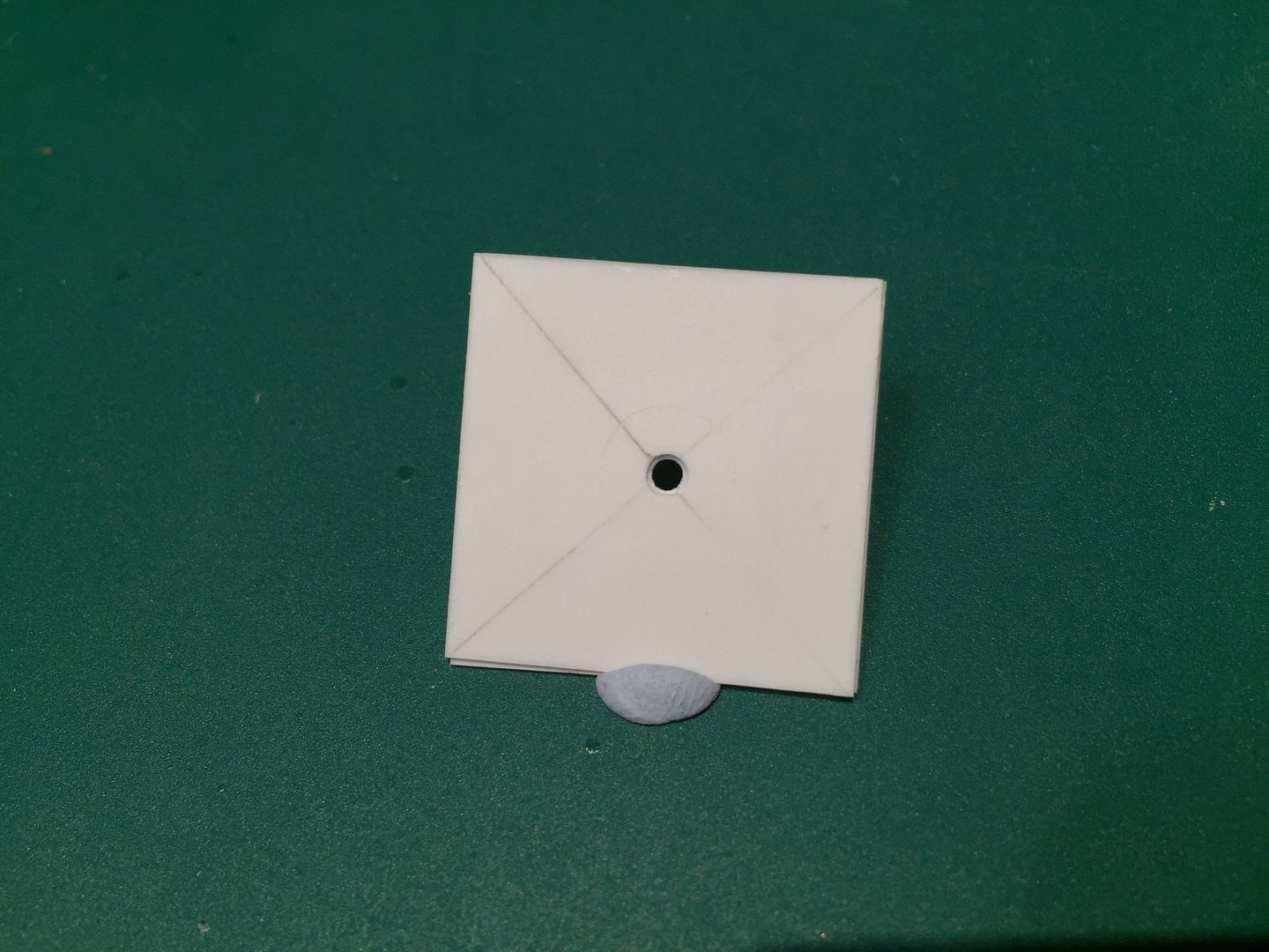

Giorgio N Posted May 1, 2015 Share Posted May 1, 2015 Love the way the rivets are showing, even if the definition may not seem perfect. The same technique seems to give better result if used on metal foil, maybe this is an alternative ? Link to comment Share on other sites More sharing options...
Ex-FAAWAFU Posted May 1, 2015 Share Posted May 1, 2015 As for WAFUs they are just bloody odd! (but not as odd as fish-heads) No disagreement with either part of that! Oddity is good... It's still better to stop and then land than to land and then stop. And jets are for kids. I know; I held over on 899 1 Link to comment Share on other sites More sharing options...

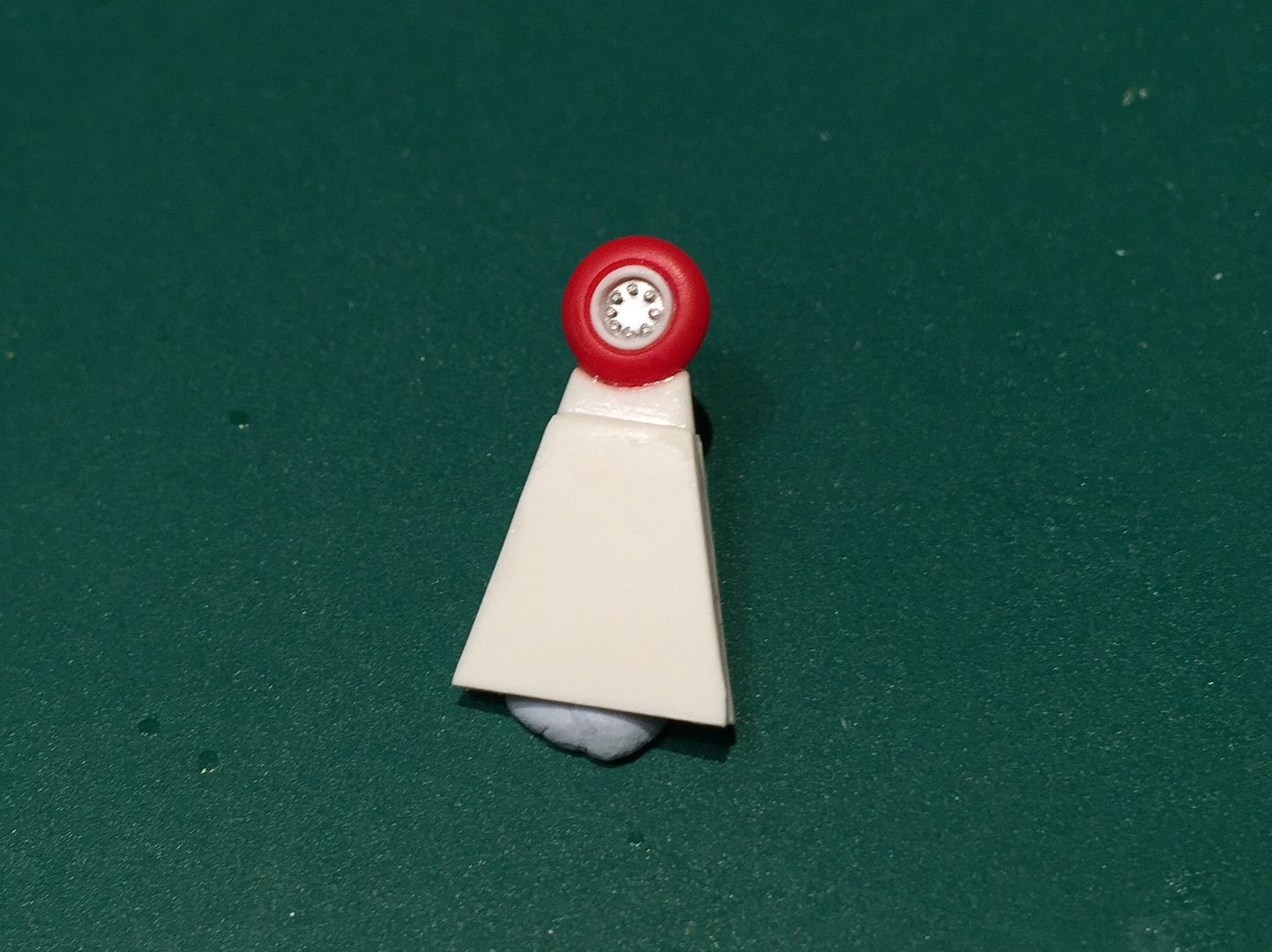

Fritag Posted May 6, 2015 Author Share Posted May 6, 2015 (edited) Love the way the rivets are showing, even if the definition may not seem perfect. The same technique seems to give better result if used on metal foil, maybe this is an alternative ? You're a genius G N. It made such perfect sense that I even tho' I haven't had any real time to give to man's favourite hobby recently - I thought I'd give that a go: The next time the gods see fit to grant me time to model - it ain't gonna be wasted on that stupid wheel A long way around to a really simple technique - but ain't that part of the fun? Edited May 6, 2015 by Fritag 15 Link to comment Share on other sites More sharing options...
perdu Posted May 6, 2015 Share Posted May 6, 2015 well done you two perzackkkerly the way to do it (both sides I hopes Steve) Link to comment Share on other sites More sharing options...
Leonl Posted May 6, 2015 Share Posted May 6, 2015 "The next time the gods see fit to grant me time to model - it ain't gonna be wasted on that stupid wheel" That said, it does look very good, well done. Link to comment Share on other sites More sharing options...
