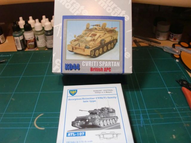

Dads203 Posted January 27, 2015 Posted January 27, 2015 The next project starting. This one is a bit of light hearted fun, not so many parts as the Chieftain so hopefully a bit quicker. Dan 6

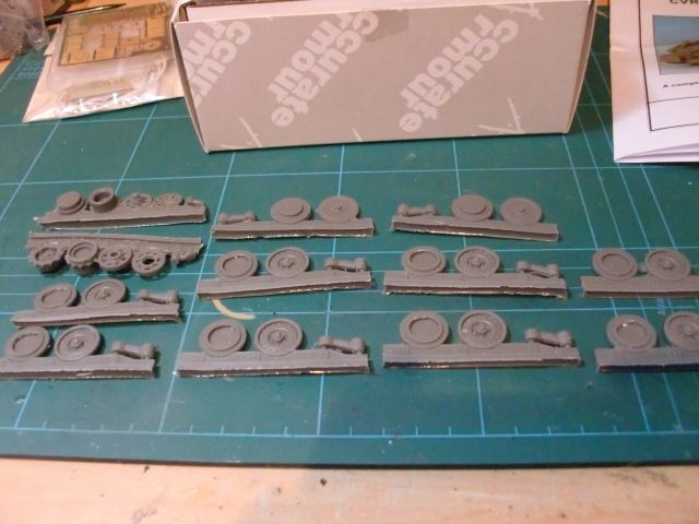

Dads203 Posted January 29, 2015 Author Posted January 29, 2015 So the big parts clean up begins, thick and thin CA glues to be used with some 5 min epoxy for some of the load bearing parts. Thinking of brass pinning the suspension swing arms and the rear track adjuster just to make sure. So a question for those who got up and personal with this vehicle, the L37 GPMG, how were the belts fed? No external ammo box in the kit so I'm thinking that it was stored inside the commanders cupola and fed up to the gun? But I can find no pictures of the area that gives it away? Help !! I'll probably convert a live resin GPMG to fit the mount, these babies are light years away from anything else I've seen for a kit. I'll have to stock up on them ! So the running gear, lots to clean up, I won't bother with the resin tracks as they are a right royal pain to fit, Fruils all the way. This is going to take some time Cheers Dan 2

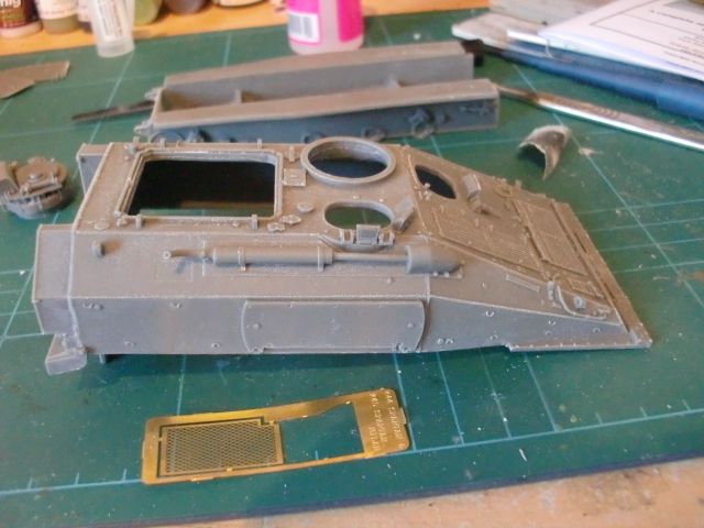

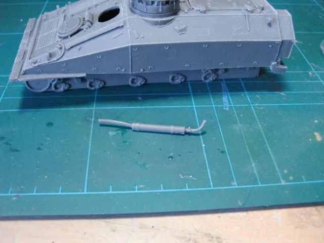

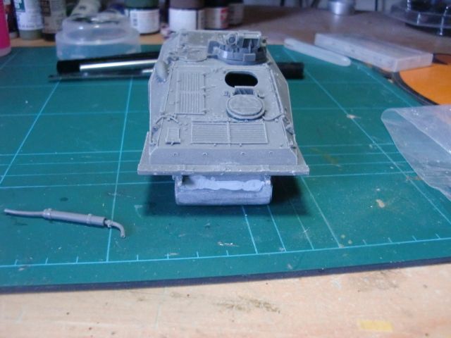

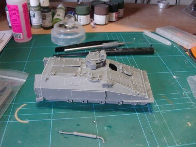

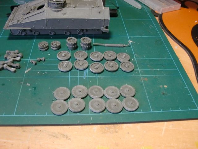

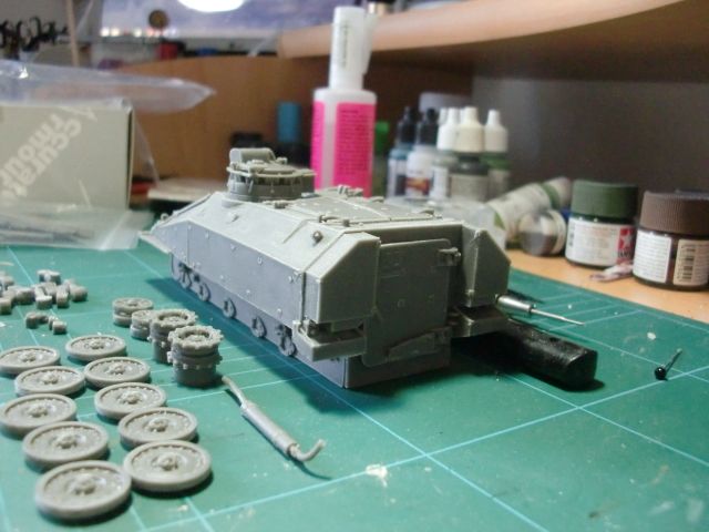

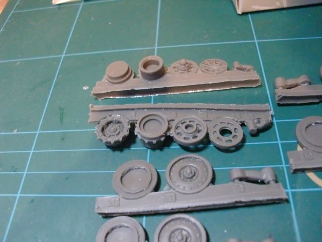

Dads203 Posted February 1, 2015 Author Posted February 1, 2015 Onto business then, loads of cleaning up to do on this kit, it's date stamped 1991 and think that some of the moulds need a bit updating TBH. A big seam on the front that requires attention, nothing drastic that Mr Surfacer won't sort. The running gear , the sprockets are worst part of this kit, you'll notice that one is missing a few teeth they were awkward to clean up as the casting lug is almost now part of the moulding. the missing teeth will be hidden by the tracks. Still for an old kit the detail is still very nice. Next up is pinning the swing arms and getting the road wheels on. Cheers Dan 3
Wogga Posted February 1, 2015 Posted February 1, 2015 Is there any interior detail on this kit Dan? I got my 43 in the stash and it has a fair bit of interior detail, so much so i am tempted to make 3 Triffid stations to fit in (Well if everything else goes together and i don't launch the thing out of the window) Not looking forward to the wheels myself i have ordered some Airwave razor saw frets especially. Thanks for pathfinding ....... again
Dads203 Posted February 1, 2015 Author Posted February 1, 2015 Nothing included interior wise for this kit but it wouldn't take much to do, but I'm not going to before anyone asks :-) The wheels are fine with little or no issue, it's the sprockets and rear idlers that require much care in removing. The swing arms are showing a little sign of mould wear and require a touch of filler to put right. The rest of the kit is fine just care is required removing the parts. Cheers Dan 1

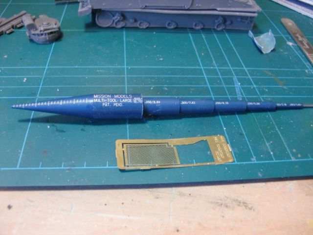

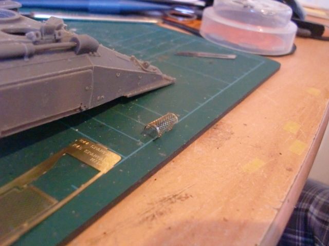

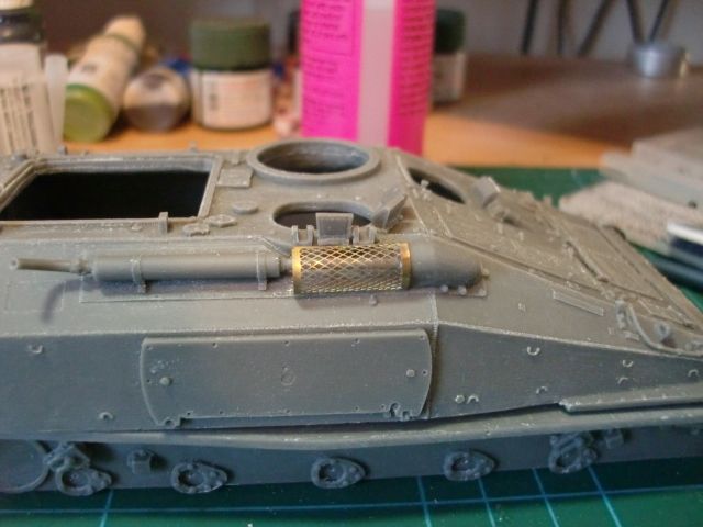

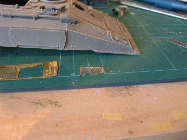

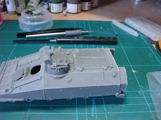

Dads203 Posted February 1, 2015 Author Posted February 1, 2015 Starting to add bits to the hull, First up the exhaust and guard, I've tacked the guard in PVA glue so I can remove it for painting. The PE part was annealed to make it curve easier. The guard first part. fitted Enjoy Dan 1
