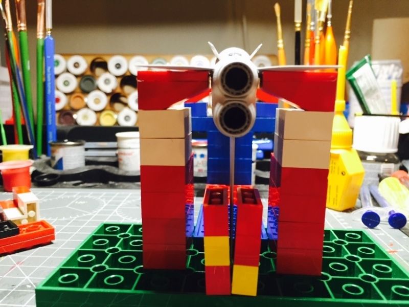

CedB Posted January 23, 2015 Author Posted January 23, 2015 Found the Lego! and knocked this up... Like the eyes, making sure things are level. I'm almost happy for you guys to get your T squares out on this... Note how the 'flex' in the blocks lets you adjust with quite fine tolerances and they're stiff enough to stay put. Thanks 'Space Ranger' - sorted now and really happy this will cope with different sizes, angles, dihedrals (with Bluetak) etc etc. Chuffed. 2
Space Ranger Posted January 23, 2015 Posted January 23, 2015 Glad to see my suggestion was helpful. 2
