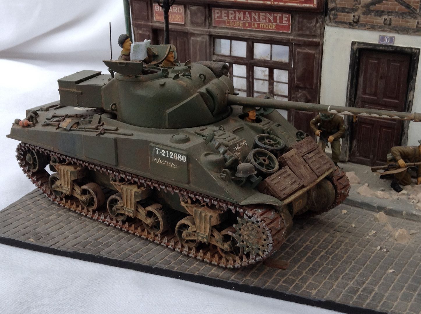

Ozzy Posted February 11, 2015 Share Posted February 11, 2015 Don't know if this is of any assistance? I paint all my british armour in Tamiya's XF 67 NATO green, it looks a little bright at first, but with a bit of weathering looks pretty good I think. I find that olive drab is a little to dark. I've added a photo, as a picture paints a 1,000 words. Ozzy 1 Link to comment Share on other sites More sharing options...

SleeperService Posted February 12, 2015 Share Posted February 12, 2015 Be very careful when comparing photos. The Churchill above is exposed more than the Sherman (look at the crew figures). The mix Shermaniac refers to is a match for the real colour so needs to be knocked back with some light grey to look right on a scale model. When i did 76 scale I used between 10% and 20% depending on the general condition of the vehicle. I'd suggest mixing a tiny amount and brushing it out on a grey base to see what you think. Link to comment Share on other sites More sharing options...
