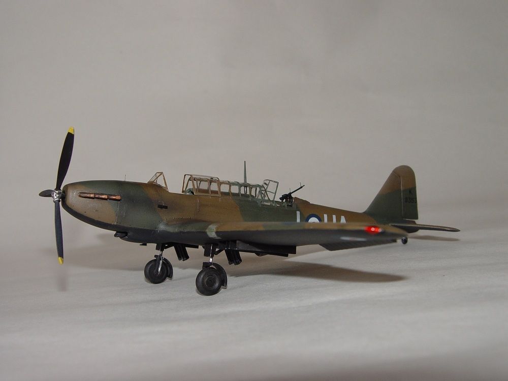

woody37 Posted December 23, 2014 Share Posted December 23, 2014 Putting a plug in the nose is quite a simple affair, no need to buy a new nose. That's all I did with this one. I never corrected the wings, so can't comment on them. 1 Link to comment Share on other sites More sharing options...
