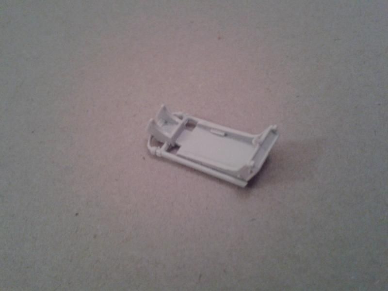

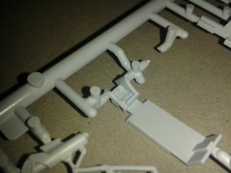

Col. 11,915 Posted November 5, 2014 Author Share Posted November 5, 2014 Here's that lovely cockpit details; Made a start to one of the seats - three parts together so far; Will, however, need to sort this out before the second one takes shape; Not a great photo but the intake section goes back to the trailing edge of the wing and the join is seamless. Rather nice fit so long as you clean up the sprue attachments completely. Alas the three parts for each wing tanks are a poor fit and have needed a lot of work to get even this rough a fit; More filler required here 6 Link to post Share on other sites

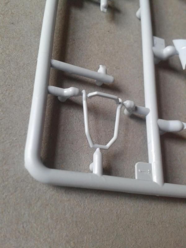

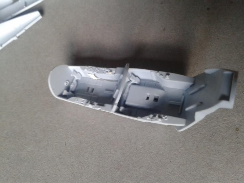

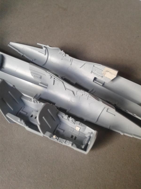

Col. 11,915 Posted November 8, 2014 Author Share Posted November 8, 2014 Right gang here's the results of an evening working in the 'pit... As you can see I've not had to add much. A couple of small bits including a more refined map holder on the right hand side of the front office and a similar one on the left then some wires here and there. The rear office got some sidewall detail on the right hand side that was not included and this also hides an ejector pin mark. The short shot in the seat headbox was also repaired. Time for paint I guess. Now, anyone care to guess what this is; Part number one. It isn't mentioned anywhere in the instructions. At first I suspected it was part of the cockpit/canopy detail but now I'm wondering if it's the smoke generating pipes for for a Red Arrows boxing. Bit overscale and simplified it so. 2 Link to post Share on other sites

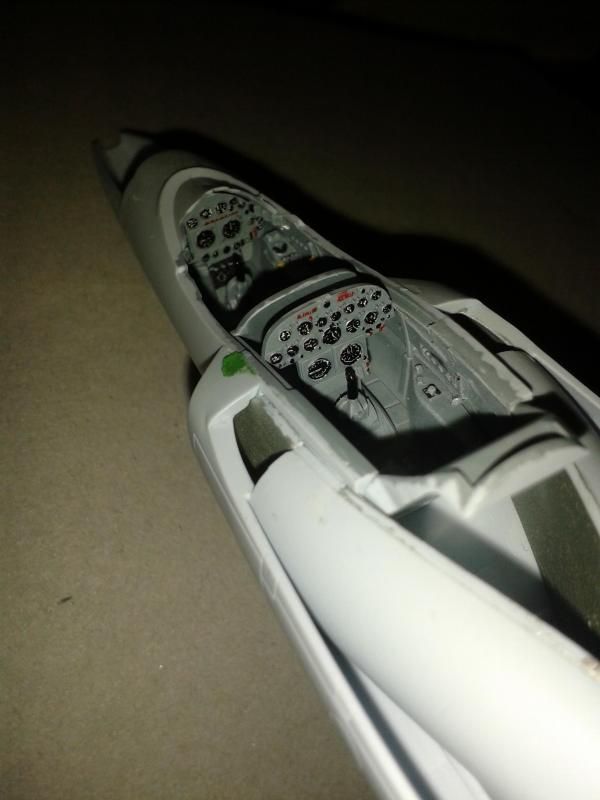

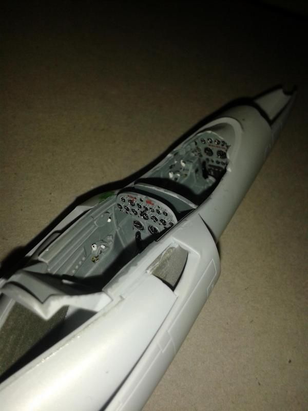

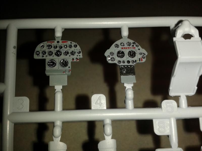

Col. 11,915 Posted November 10, 2014 Author Share Posted November 10, 2014 Decided that, rather than use the perfectly good kit instrument panel decals, I'd try an experiment to represent the details on the instrument dials. First of all the cockpit parts were painted in their base colour then given a drybrush of lighter grey to accentuate the moulded detail. Then the instrument faces were painted in white and left to dry for 24 hours; Then they were repainted gloss black and a blunt old knife blade was used to push away the black to reveal the underlying white; Looked alright to me so with all the other detail painting done the jet pipe was installed and the fuselage halves joined; After joining I had a thought - the jet pipe can probably be left off until after the fuselage painted to avoid having to mask it off so long as the rear plate that supports it is installed square as there is plenty access from the upper fuselage where the wing will fit. Ho hum maybe next time. Everything fits great and next to no filler will be required apart from on one annoying section; This bulge is moulded off-center on one of the fuselage halves and has a low section behind it that will need filling up to get a smooth join. Pity the bulge wasn't a separate part to avoid that but not a big task to rectify. 11 Link to post Share on other sites
Low flyer 185 Posted November 10, 2014 Share Posted November 10, 2014 looking good col, good recovery on the bang seat 1 Link to post Share on other sites
Biggles87 7,601 Posted November 10, 2014 Share Posted November 10, 2014 Those instruments look great. How come I can never get results like that when I try the same method? 1 Link to post Share on other sites
