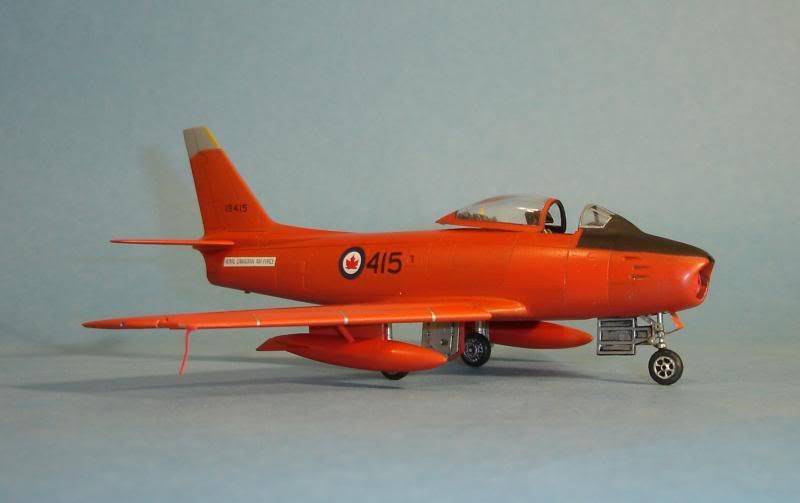

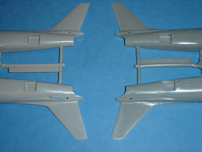

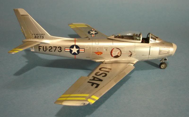

Tony Edmundson Posted November 1, 2014 Share Posted November 1, 2014 Hobbycraft Mk6 to F86A conversion: Hobbycraft Mk6 to Mk2 conversion: Cheers, Tony 1 Link to comment Share on other sites More sharing options...
Courageous Posted November 1, 2014 Author Share Posted November 1, 2014 Very Nice Tony, especially the F-86A. I've got a couple of Pavla canopies for the 'A'. Was it difficult to modify the tail section? Link to comment Share on other sites More sharing options...
Tony Edmundson Posted November 1, 2014 Share Posted November 1, 2014 Very Nice Tony, especially the F-86A. I've got a couple of Pavla canopies for the 'A'. Was it difficult to modify the tail section? Nope, first drew a rough outline with a sharpie then slowly ground away what was not needed, and backed up the reverse side with some super glue as it gets mighty thin at that area. F86A wingtips have a different nav light location, and the boat tail under the rudder is narrower. The wing is the easiest to mod--I just reversed what the 6-3 extension added. The Sabre 6 wing is unique as it is a 6-3 wing with slats. 1 Link to comment Share on other sites More sharing options...
