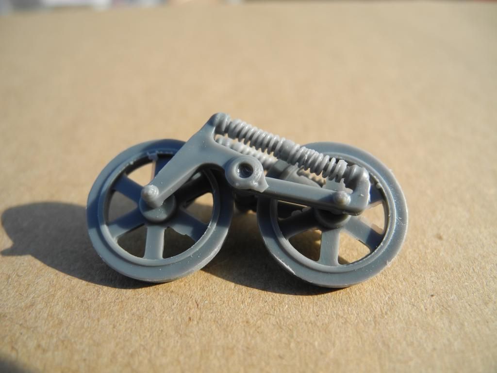

le wombat agile Posted November 23, 2014 Author Posted November 23, 2014 Trying to understand how to upload the pictures I attach this one withe the Sovereign upgrade set used ops, I'have to reduce the size for the next one.....

le wombat agile Posted December 19, 2014 Author Posted December 19, 2014 Oh Jack, what episodes of the Story I've lost during my absence from this post. Very nice job. You've caught completely the appeal of this old little tank. I looked also at the flickr page and it's very interesting. I'm not yet begun to assemble my kit because I was waiting for the Osprey book you signalled me and because I had on the workbench a couple of Swordfish. I mounted only the wheels to give you an idea of the Sovereign upgrade kit. I've also bought the DOA colours for European scheme and for the Caunter one Any way I have two boxes on the stash and I'll begin with the European version. My final target will be thiis one. 13th/18th Royal Hussars (Queen Mary’s Own). Ezio
